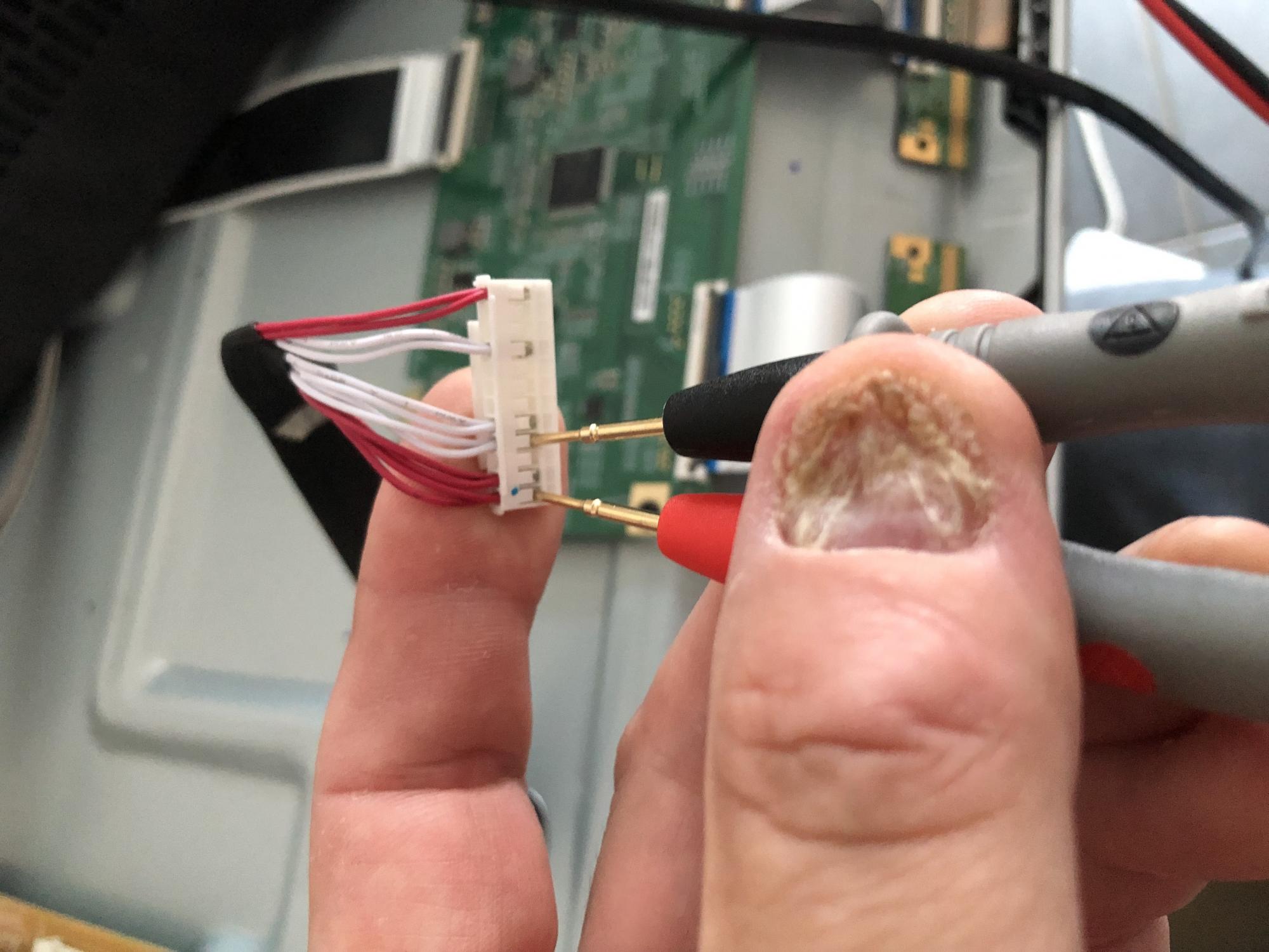

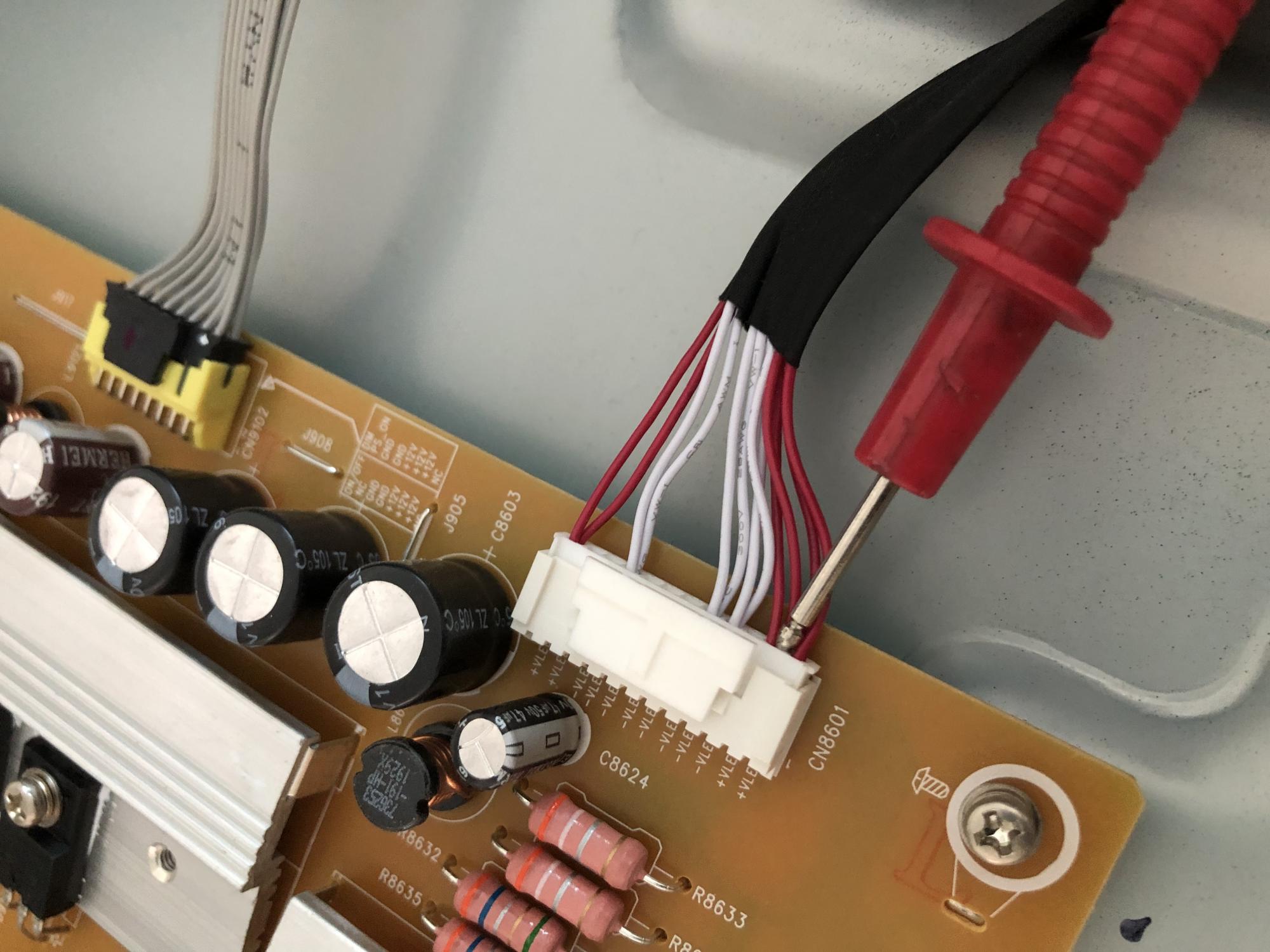

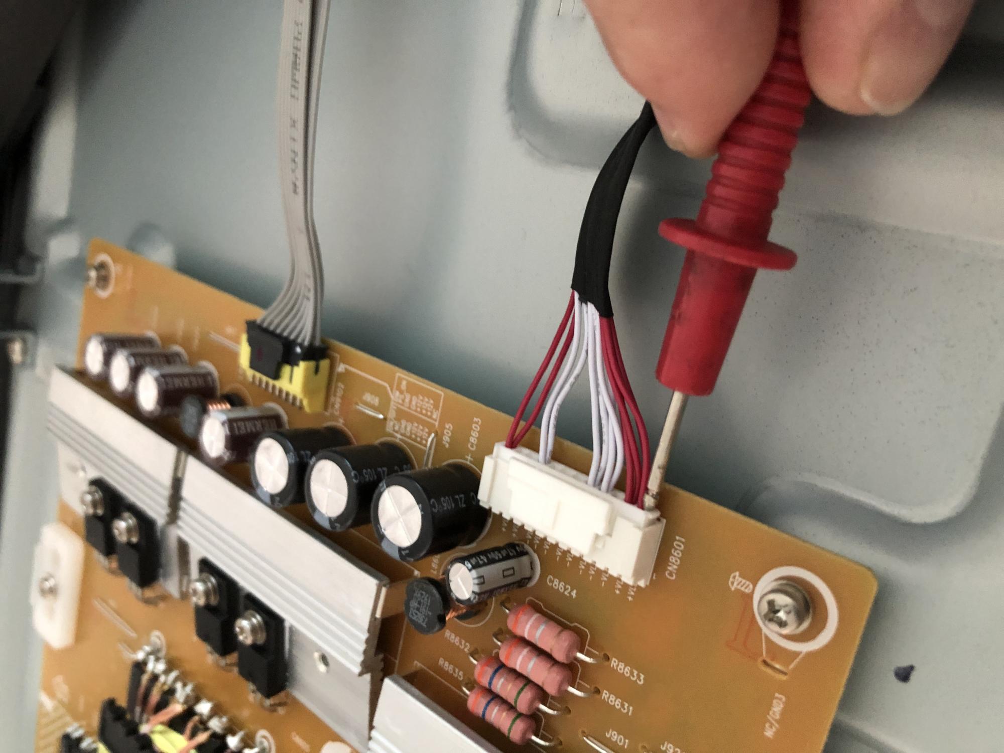

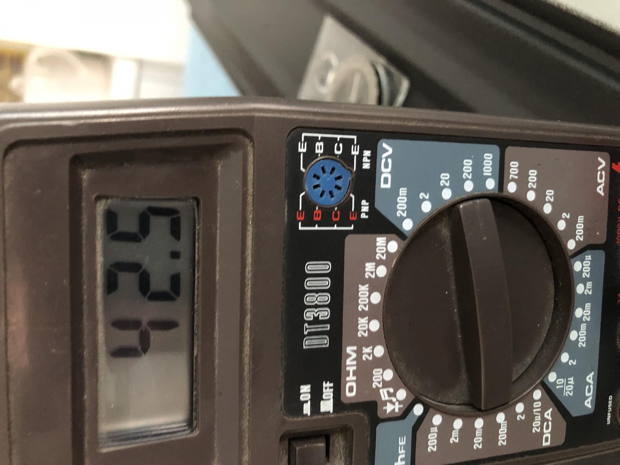

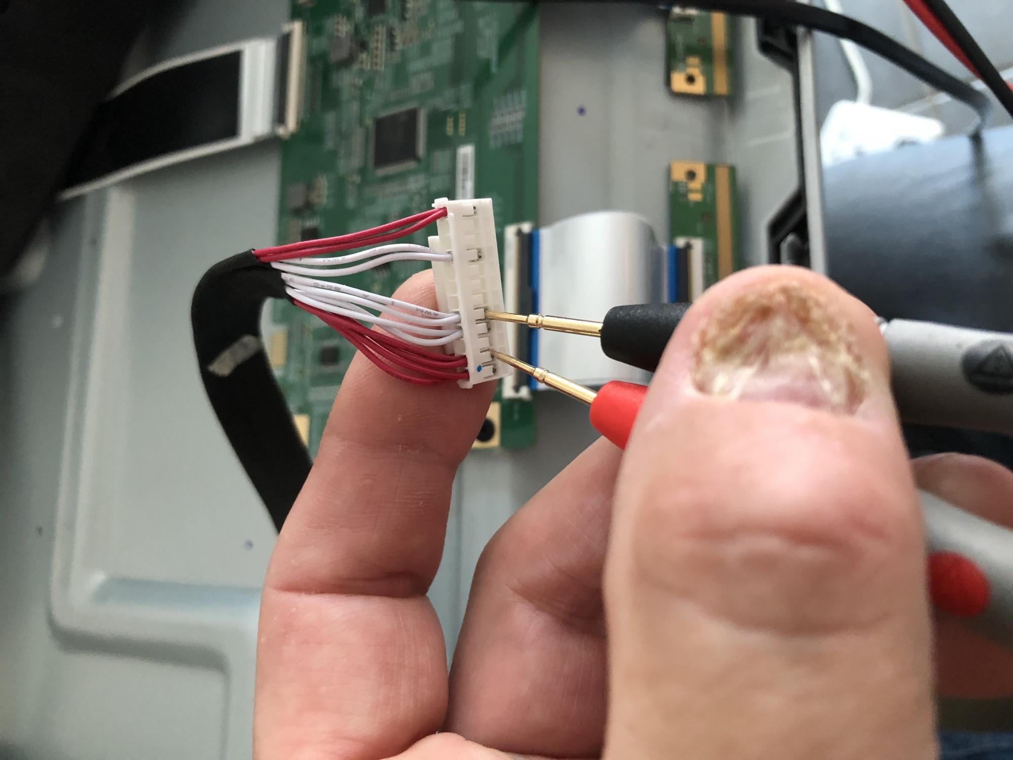

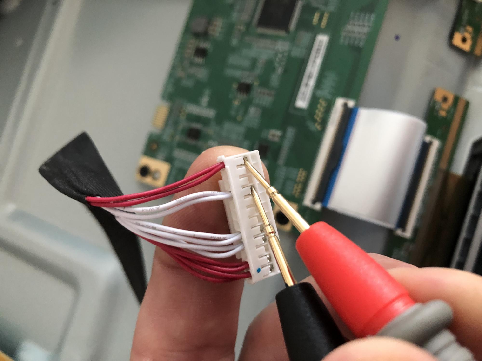

    Hi everyone.
    I have a problem that I would appreciate some expert advice on.

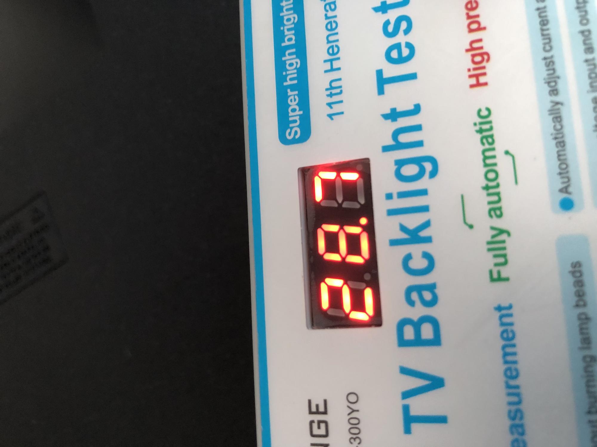

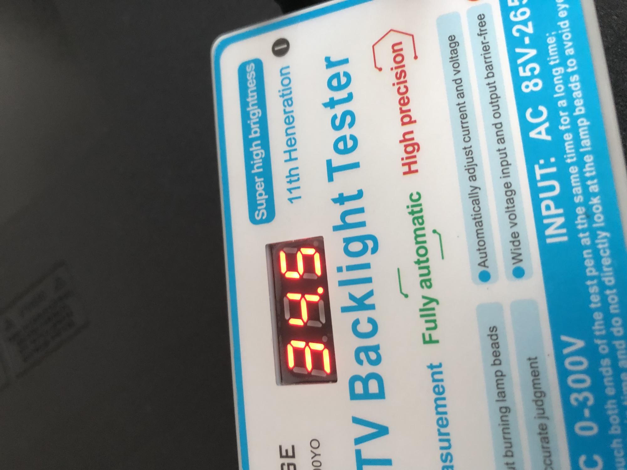

    I have a 65” Philips television which powers on, has sound but but no picture. Usually this would lead me to believe an open circuit was present on the backlights. However, if I disconnect the mains power cable to the television and test the power cable going to the backlights using a LED tester, no open circuits are present. If I reconnect the backlight cable to the power board and replace the mains power cord to the tv the device fires up perfectly and displays a beautiful picture. It's almost as though the LED needs need “priming” before they will work. Has anyone come across this before?
    I've attached some images showing the voltages of my LED testing (between 32v and 35v) and the voltages when the television is operating correctly (42.5v).
    Any help is greatly appreciated.

      Almost surely you have a single bad fluctuating led..
      try this simple test, cool tv, warm up the leds power supply area (elevator), turn on tv normally, if 100% working then it's so..

        Bad LED on 28.7V line

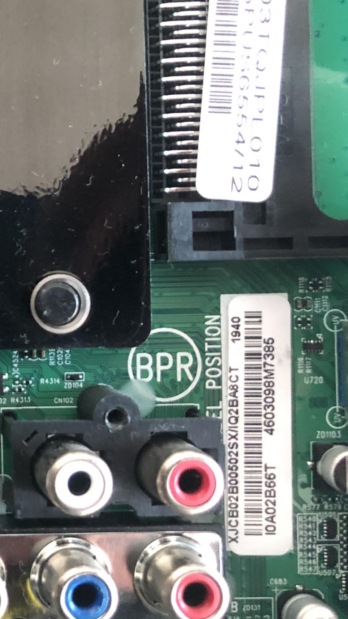

          Re: Philips 65PUS6554/12 - only powers on if you prime backlights first

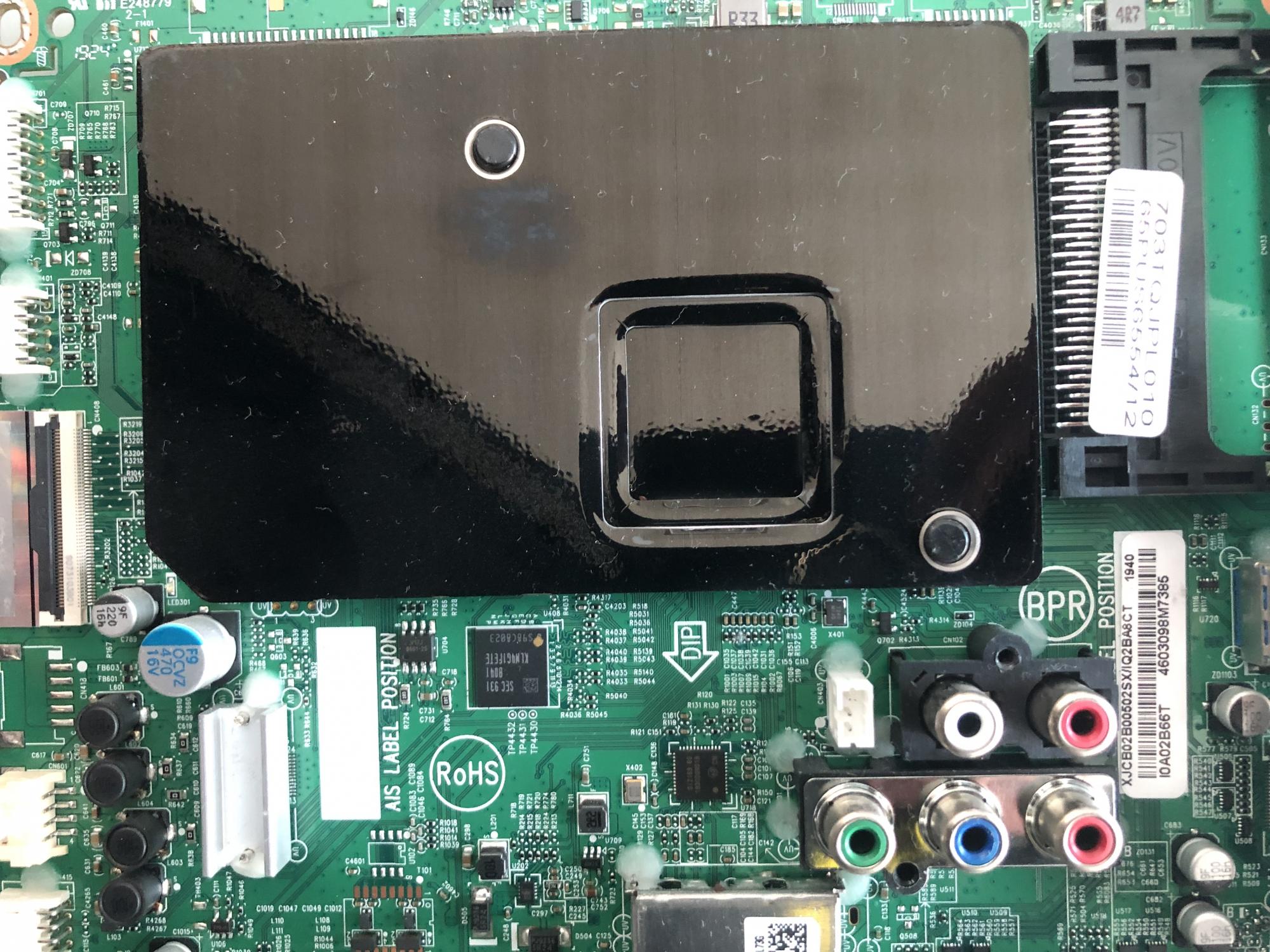

          what's your board model?
          • djmka
            • Aug 2021
            • 35
            • England

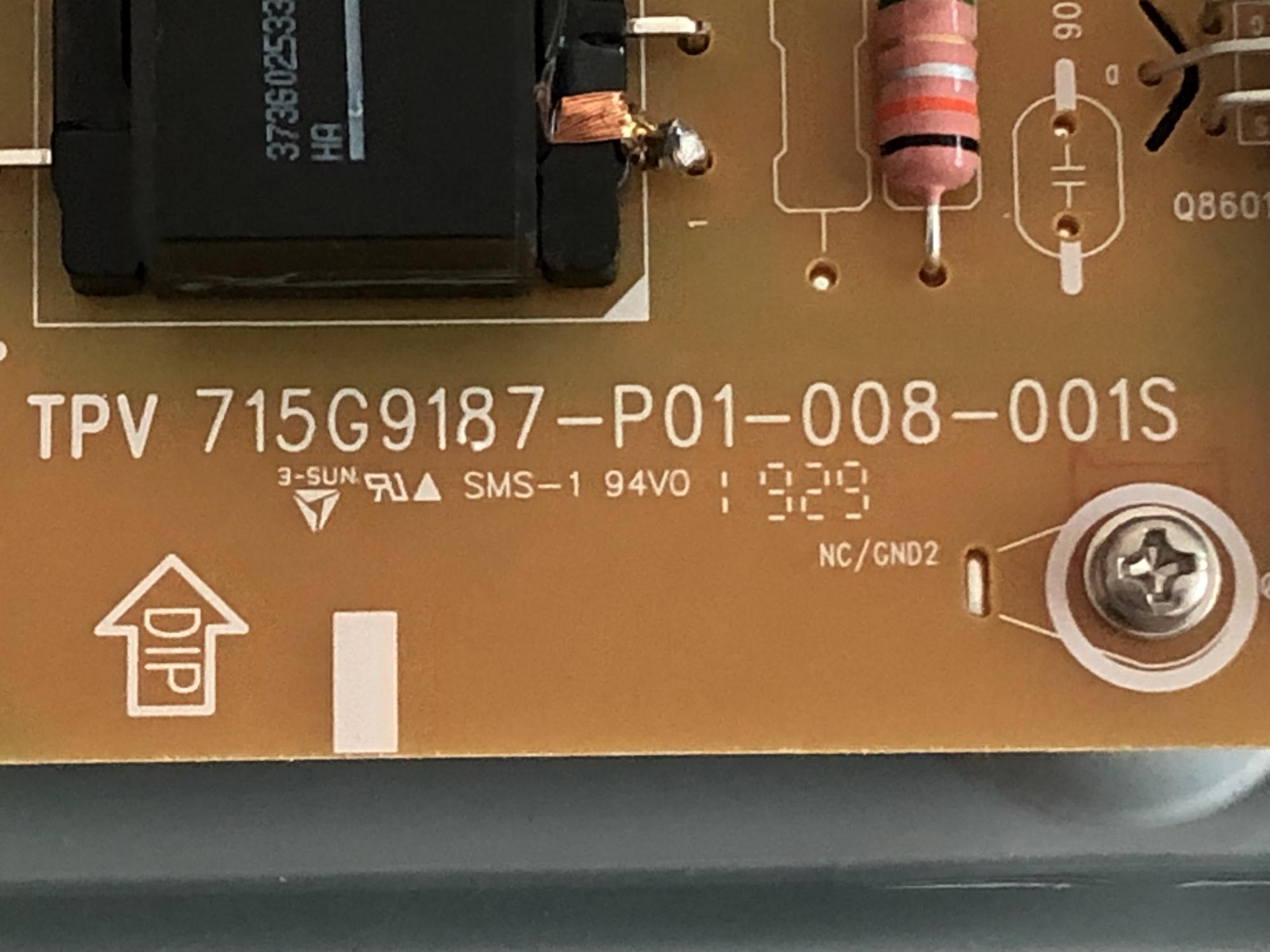

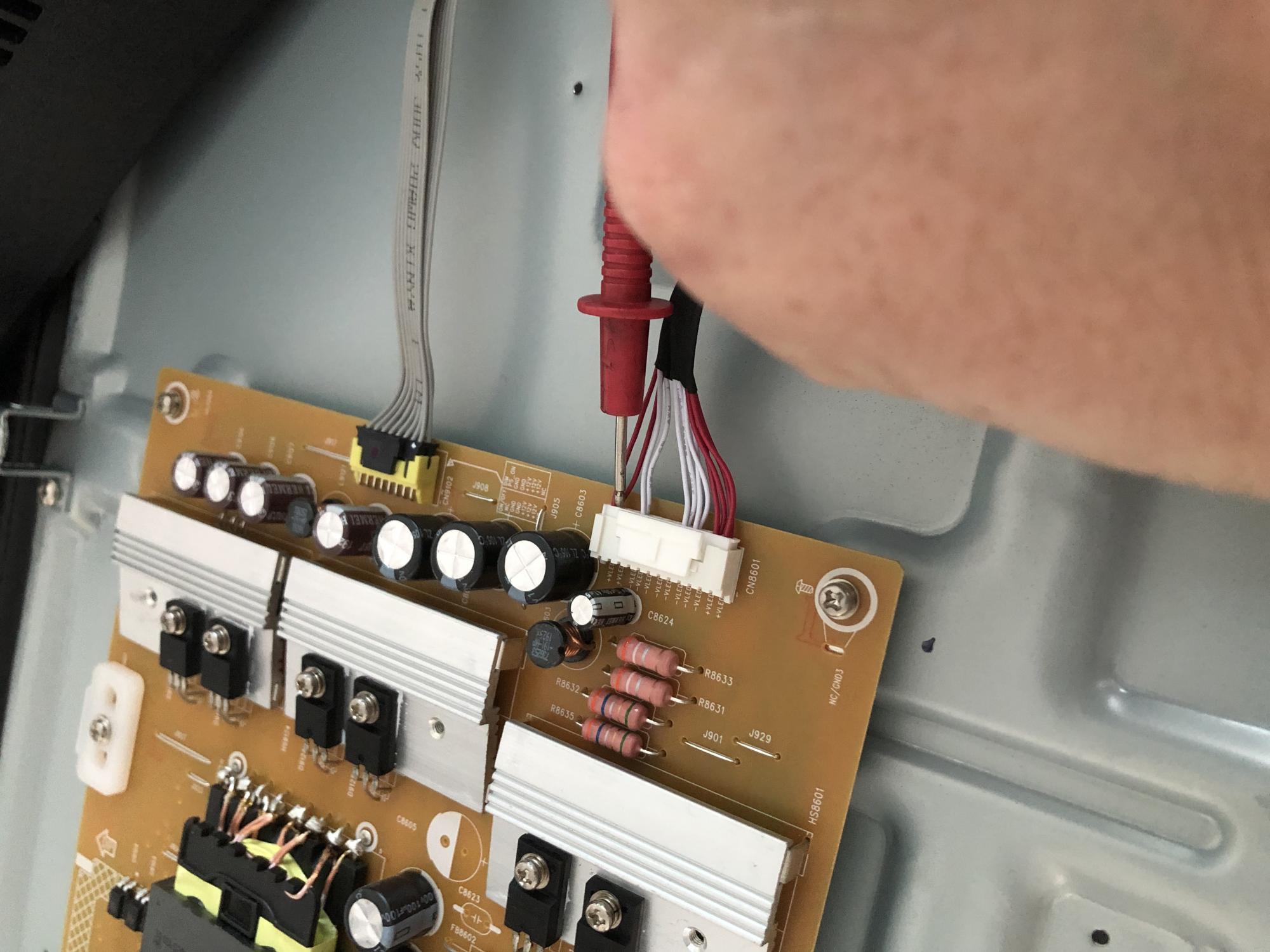

            Thank you to everyone that has commented. Please see attached pictures of the power board and main board.

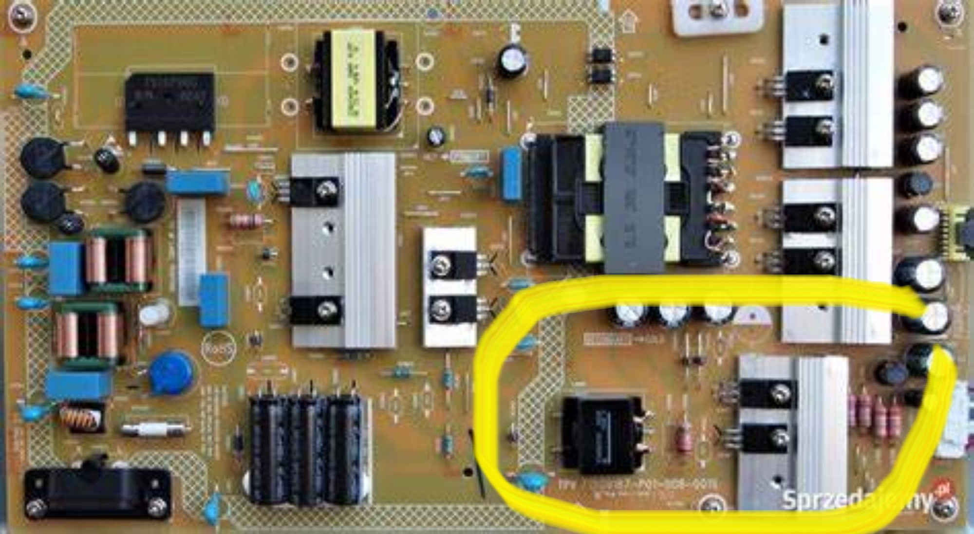

                i mean the are near the leds connector, from the big inductor to the connector..
                • djmka
                  • Aug 2021
                  • 35
                  • England
                  Would it be possible to circle the area on one of the images I've submitted?
                  • Davi.p
                    Hobbist Tech
                    • Sep 2009
                    • 4286
                    • Italy - Milan

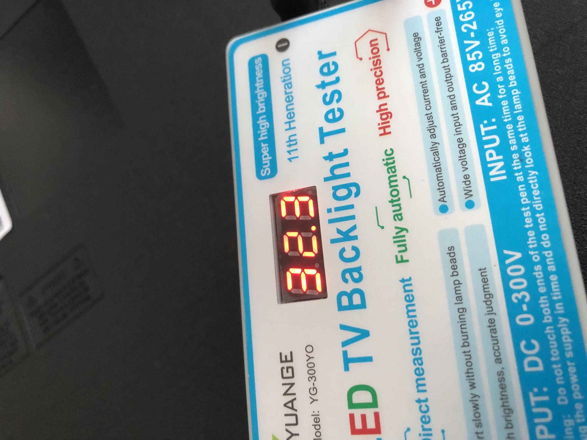

                            Update -
                            I finally dismantled the television to get to the LEDs and found each strip consumed varying voltages using my LED tester:-
                            Strip 1 - 29.1v
                            Strip 2 - 29.2v
                            Strip 3 - 33.5v
                            Strip 4 - 31.5v
                            Strip 5 - 29.2v
                            Strip 6 - 32.5v
                            Based on the above, I have decided to purchase a new set of backlights and shall let you know the outcome. Hopefully, with new lights in, the television should operate correctly.
