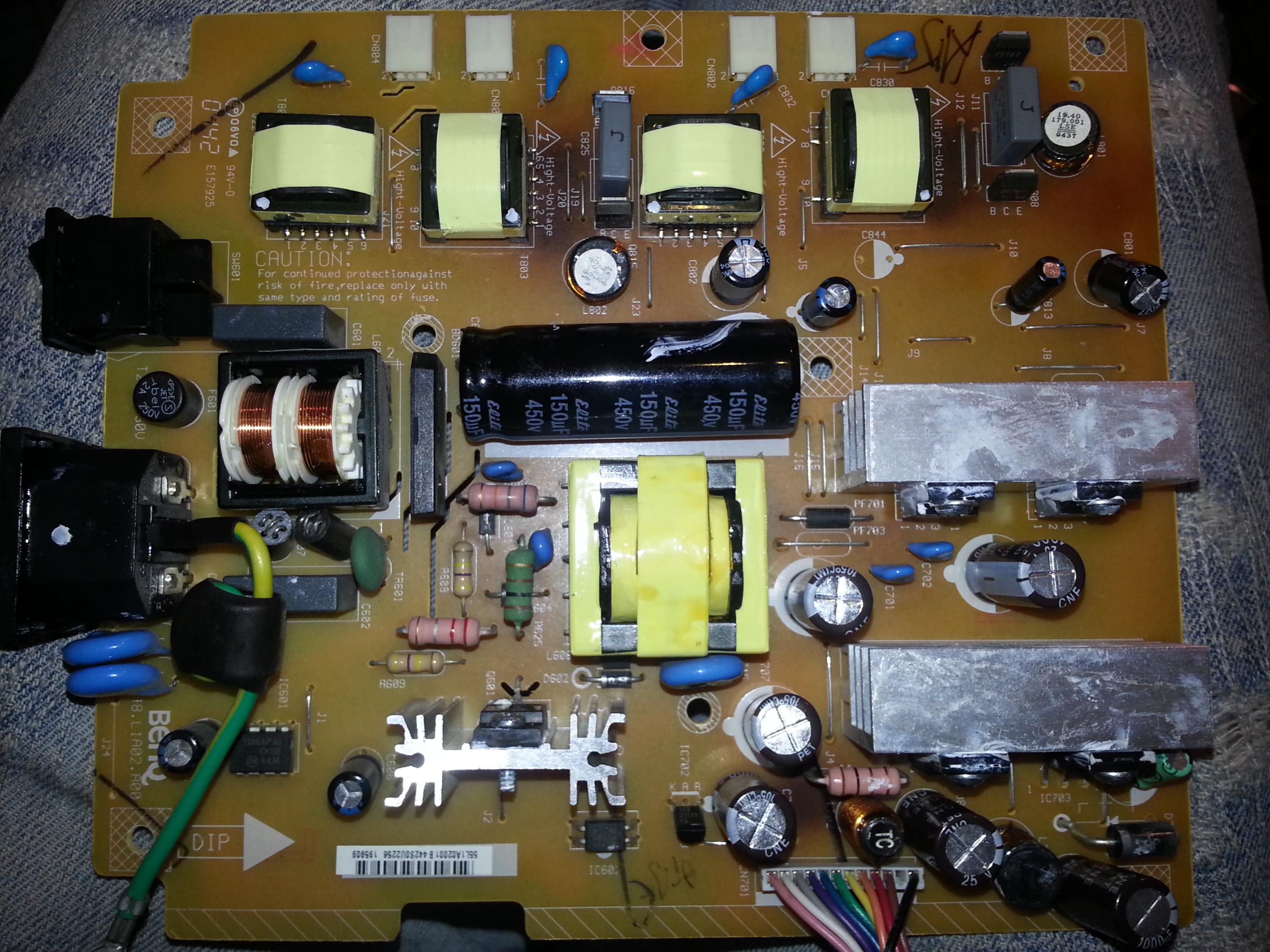

    Hello, I've known of this forum for a while but never browsed or posted on it, but now I have an excuse to.
    I also have a HP 1955 monitor, that I got because it had been thrown away, but my problem seems to be a little bit different. Even though the monitor will power on and display an image, the backlight does not come on at all. Which I think would indicate that the fuse is open.
    The fuse is a bel brand fuse and is rated for 2.5A 250VAC, I think this is because I'm in Britain where we use a 240VAC 50Hz electrical system.
    I looked at the components and found a C5707 that looked as if it had a small hole blown in it. I do not own any test equipment so I couldn't check the resistors, capacitors etc. to see if they were out of tolerence.

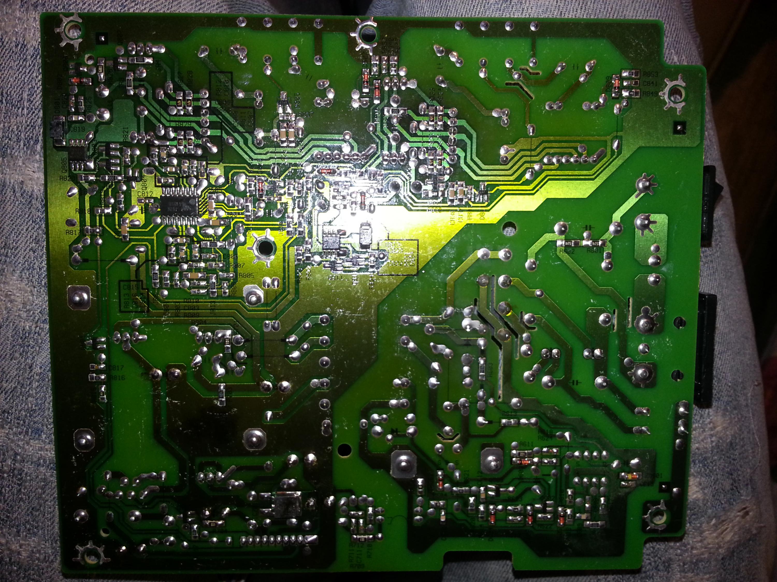

    I also looked at the solder joints on the underside of the PCB and some of them don't look exactly right, for example the solder joints on the IEC power socket are loose. And the grey capacitors feel loose. I couldn't reflow or touch up any of the joints as I don't own a soldering iron.
    I mentioned above that I don't own any of the proper equipment that should be used to repair this power supply board. The point of this post is to get some good feedback on what might be wrong with this and ultimately the goal is to possibly take the board to a professional to have it repaired.
    I am new to repairing electronics in this way, so forgive me if I'm not being detailed enough.
    Thank you in advance for any feedback.

      Probably typical problem with blown 2SC5707 transistors, blown fuse.
      If you'll go to somebody, have him check all the inverter transistors, also the grey capacitors between them.

          These 2SC5707, every time two pieces around the gray foil caps in push-pull configuration.
          Also there are two 2SJ598, one for every invertor, these turn it on and off. Just posted problem with one of these on page 6. It was also shorted making the invertor stay on all the time (even when display was turned off).

              Guys. Sometimes not the transistors, fet or such is the problem only the "bolting". Happend to me once that the power input bolting (all three) were "lazily" connected and it made my screen go black after 1 sec. I have rebolted it and wunderbar, All working. TRy that first to see if there is any loose bolting.

                  No, the soldering at the condensator etc. At the AC it's typical it gets loose but it can happen to any part on the motherboard so check them out carefully. If you havent seen any at the electricity part then check out the computer motherboard.

                      Cracked solder joints at AC inlet: Example of Dell and HP
                      http://s807.photobucket.com/user/bud...tml?sort=3&o=7
                      http://s807.photobucket.com/user/bud...tml?sort=3&o=2
                      At transistor C5707:
                      http://s807.photobucket.com/user/bud...tml?sort=3&o=0
                      At inverter transformer:
                      http://s807.photobucket.com/user/bud...tml?sort=3&o=8

                            Well actualy problem was that almost all caps were bulged and it stopped powering on, this was just a bonus…

                                          Also, I pulled an original Microsoft XBox out of a neighbors bin and it worked the first time then stopped. When I inspected the insides I bumped a capacitor and it moved too easily to make me take a closer look at it. I wiggled it gently and one leg on the capacitor broke. Close inspection revealed so much corrosion around the capacitor pins and that it had been falling off the board. The board itself looks fine so have bought a replacement cap for NZ$9 and hoping the high price will pay off.
                                          So perhaps check the pins on all the capacitors on the board.
                                          Input Elite caps tend to do that, I've seen two bad already (one here on picture, one in real life). One (another brand) was having some salts around one leg, electrolyte already started leaking.
