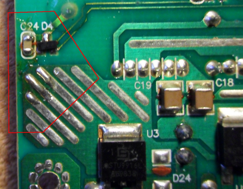

                  (1) I am having this same issue (black screen on power up then green light stays on) and have gone through and replaced the three caps on the inverter and the four (within red circles in lucky's picture). All where visually identified as bad, except for one on the logic board (replaced anyway).
                  I was given the monitor as it wouldn't work. When I got it, pushing the front power button would: turn on the LED to an amber color, then turn on the LCD and back light with the LED switching to green, display desktop while making hissing sound from inverter area(?). Back light would then power off and LED stay green. I was able to see the LCD was still active by shining a flashlight into the LCD to dimly illuminate it.
                  After replacing caps, the same thing happens but there's no image displayed at start up. LCD is still active when I do the flashlight test. Does this mean I improperly soldered the caps? Did anyone else have the weird hissing sound?
                  (2) After ordering and soldering the caps I found this forum/topic and have noticed that there are a few issues with the caps I used (didn't know about ripple or ESR). For the caps on the inverter, I used the same ones as splinter (EEU-FC1v181) which have a lower ripple current rating than the originals, but he seems to have not had any issues with his yet and got his monitor working. On the logic board, the three 330uF caps I used are within spec but the 6.3V 1000uF cap (EE/U-FC0J102) is about 200(units?) lower on the ripple current rating and was too fat to fit (d'oh!) so I soldered it in a raised position which allowed it to fit. How much of an issue is ripple current rating and how would this effect the monitor?

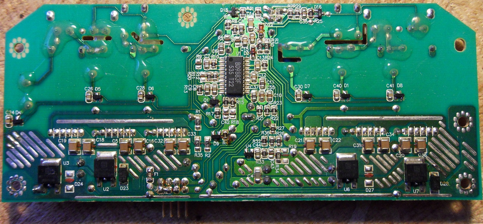

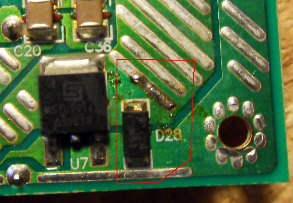

                              OK, I bought a multimeter and have checked a few things.
                              - F1 seems to be alright.
                              - I checked the diodes in the areas of interest and they're behaving as expected.
                              - All other diodes on the inverter were checked and it seems that D15 and D16 behave differently (they are both high speed double diodes A7W: ) Using diode testing mode I measured the following values:
                              For D16:
                              Anode +probe, CommonConnection 0.626V, Cathode 0.354V
                              Anode -probe, CommonConnection 0.977V, Cathode 0.354V
                              CommonConnection +probe, Cathode 0.622V
                              CommonConnection -probe, Cathode 0.975V
                              For D16:
                              Anode +probe, CommonConnection 0.628V, Cathode 0.354V
                              Anode -probe, CommonConnection 0.981V, Cathode 0.356V
                              CommonConnection +probe, Cathode 0.627V
                              CommonConnection -probe, Cathode 0.980V
                              If you take these values and compare them to D6(A7W):
                              Anode +probe, CommonConnection 0.613V, Cathode 1.044V
                              Anode -probe, CommonConnection OL, Cathode OL
                              CommonConnection +probe, Cathode 0.614V
                              CommonConnection -probe, Cathode OL
                              and D6(A7W):
                              Anode +probe, CommonConnection 0.120V, Cathode 0.735V
                              Anode -probe, CommonConnection 0.120V, Cathode OL
                              CommonConnection +probe, Cathode 0.619V
                              Do these values seem right? I couldn't follow the traces very well since the silk screening obfuscates them in the densely populated areas.

                                  Can you check your post again for typos? I can't understand why D16 and D6 are listed twice?
                                  Also be aware that sometimes "in circuit" testing can be affected by surrounding components and give false readings.

                                    Sorry about that (I was copy and pasting). The order of the diodes measured are: D16, D15, D6, and D9.

                                      I think comparing the readings of D4, D5, D6, D7, D1, and D8 would be more "apples to apples".

                                        (1) The backlight looks to turn on for about one second (makes hissing sound), but there is no image. Doing the flashlight test after this shows the LCD to be working.
                                        Before replacing the bad caps, the desktop image did show briefly before backlight turned off.
                                        There are two sets of connectors on the inverter board that if unplugged, eliminate the hissing sound on start up. If just one of the pairs (either one) is plugged in, there's no hissing and backlight still turns on then off.
                                        (2) F1 reads 0.2 ohms.
                                        (3) I may need to replace the 3 caps on the inverter board and the 6.3V 1000uF cap on the logic board because they have a lower ripple current rating than original cap (didn't know about this when I soldered them in)
                                        Teapo SM 6.3v 1000uf 8x15mm 850 Ripple 0.053 ESR
                                        replaced with:
                                        Panasonic EEU-FC0J102 6.3v 1000uf 10x12.5mm(too fat) 755 Ripple 0.090 ohm imp
                                        CapXon GF 35v 180uf 8x16.5
                                        replaced with:
                                        Panasonic EEU-FC1V181 35V 180uF 10x12.5mm 755 Ripple 0.090 ohm imp
