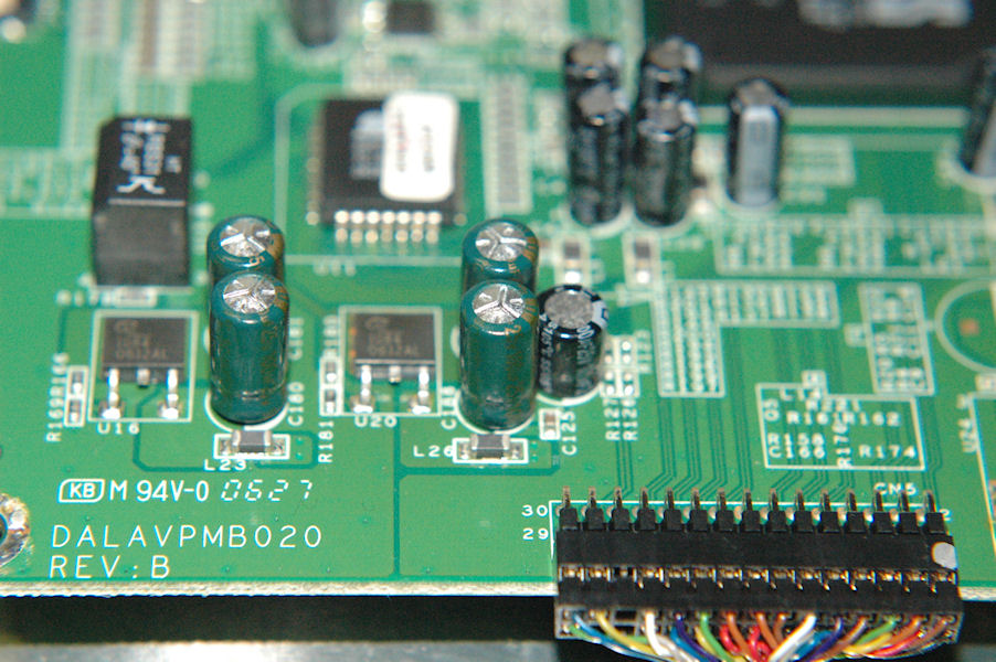

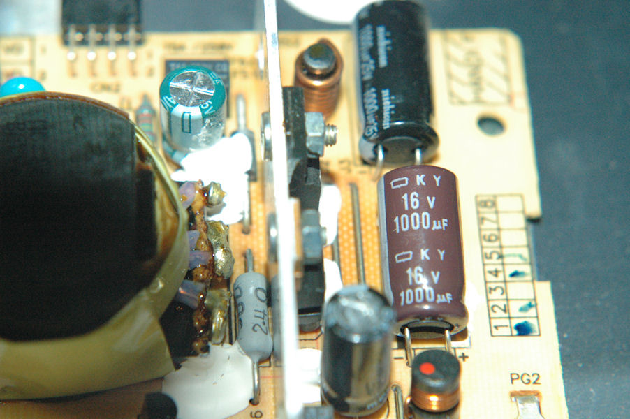

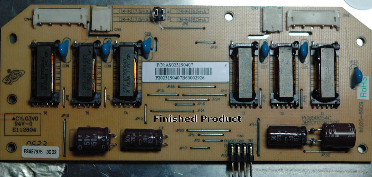

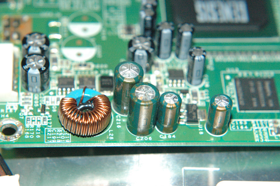

    This is to solve the monitor slow start 1.5minute problem on vp2130b, cracked open and a heap of bad caps were found.

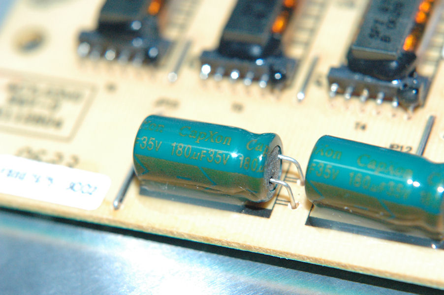

    Ok here goes, on the inverter board are 3 CapXon GF 35v 180uf 8x16.5 caps, the CapXon datasheet for GF series does not show ripple max or anything for the 35v 180uf caps as if they never existed.
    I was looking at chemi-con LXY series 50v 180uf caps, as it has higher ripple support for the 220uf vs 220uf on GF vs LXY (compared the 220's because I cannot find data on the 180's), anyone else have any input?
    Also there is a Taicon (PW)P cap (not bad but don't trust) on the powersupply that I cannot identify due to glue which took the label with it, the top of the cap I can see what looks to be the tail end of *5v 220uf, it measures 8x12mm and bright green. Could it be 25v? Nichicon PW series 25v 220uf 8x11.5 @ 555 ripple seems closest?
    Also for anyone who runs into this monitor (same guts as 2030b from what I understand), on the mainboard, all green Teapo caps are blown, 6x 25v 100uf Teapo SC 6.3x11mm and 2x 6.3 1000uf Teapo SM 8x15mm. USB board had no blown caps but I've read all six 25v 100uf 6.3x11mm Teapo SC series go on the usb board, so I'll be replacing those as well.
    List as follows,
    12x Teapo SC 25v 100uf 6.3x11mm 250 Ripple 0.220 ESR
    2x Teapo SM 6.3v 1000uf 8x15mm 850 Ripple 0.053 ESR
    3x CapXon GF 35v 180uf 8x16.5 ???? ????
    1x Taicon (PW)P *5v 220uf 8x12mm ???? ????
    Pictures included, and any cap replacement advice would be appreciated.
    (psu1 and psu2 images show the green cap, inverter shows the 180uf 35v, and the mainboard images show the 6 bad 25v 100uf's and 2 bad 6.3v 1000uf's)

      Update found the capxon 35v 180uf info, 810ripple low impedance. the chemi-con lxy 35v 180 has only 550 ripple and the 50v is to large, kze is no go aswell.
      Any suggestions on a 180uf low imp cap with 810 or better ripple that fits in the department of 8x16? Perhaps a LXZ 50v 180uf 10x16 ELXZ500ESS181MJ16S?

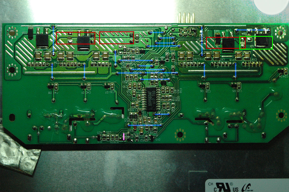

                  Space wise 8x15,10x12.5,8x15,10x12.5 setup works best. Again I'll have photos posted once I have the replacement caps.

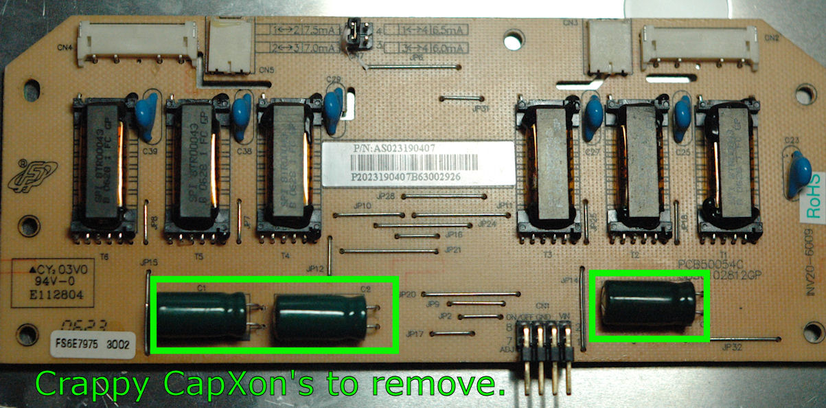

                  Here is a picture of the proposed augment in mind, back of the board of course, red is existing cap positions, blue lines are bridges on the top of the board, green is the augment cap location, pink is the jumper setting the 7.5 rating for the ccfls.

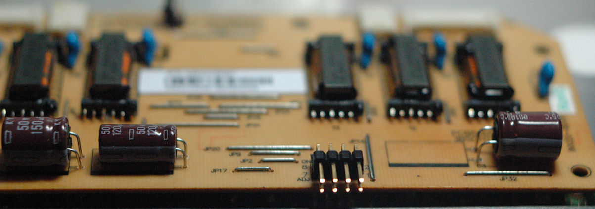

                                    Re: vp2130b cap help
                                    Monitor all fixed and works like a champ kicking on nearly instantly without any oddities.
                                    Here is "a" fix using cap's that you can actually buy in the states.
                                    Alternatively if you can get them, Rubycon ZLJ's work as perfect replacements with much better ratings for the inverter.
                                    I will cover the powersupply, usb, and mainboard recap info on following posts. The job in total involves 21 caps to be replaced that's including the 4 on the inverter.
                                    This fix is specifically for inverter board INV20-6009 found in the Viewsonic vp2130b and vp2030b monitors.
                                    It involves using 4 caps in place of the original 3x CapXon 35v 180uf caps with a rating of 810ripple support and 91miliohm, all 3 caps are run in parallel.
                                    The CapXon stock ratings for these particular GF caps is as follows,
                                    3k hour rated
                                    810 ripple ea, 2430 ripple total
                                    98 miliohm ea, 32.667 Milliohms total
                                    Freq Ripple
                                    0.72@120hz, 0.90@1k, 0.98@10k and 1.0@50to100k

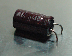

                                    Cap's used in fix, NCC (Chemi-Con) KY series
                                    2x 120uf 50v and 2x 150uf 50v
                                    2x EKY-500ELL121MH15D 50v 120uf KY
                                    2x EKY-500ELL151MJC5S 50v 150uf KY
                                    digikey part#'s
                                    565-1602-ND
                                    565-1603-ND
                                    120uf Stats
                                    7k hour rated
                                    730 ripple ea, 1460 total
                                    150uf Stats
                                    7k hour rated
                                    760 ripple ea, 1520 total
                                    2980 ripple total from all 4 caps
                                    All 4 caps have are 120 miliohm
                                    But total at 30 Milliohms being in parallel @ x4 instead of x3
                                    Freq Ripple
                                    0.40@120hz, 0.75@1k, 0.90@10k, 1.0@100k
                                    All in all you get 30miliohm instead of 32.667 and slightly higher Ripple support, lower ripple frequency multiplier and a longer life span while maintaining the same capacitance.
                                    Now for the pictures, Original has the crappy green GF CapXons, following will be board with 3 new KY caps (150,120,empty spot,150), then a picture of a single cap with bent legs and lastly a couple images showing the finished bridge to make it a 4 cap repair job. The back of the board shot is also included so you can see the parallel circuit.
                                    When you put the 8x15 cap on the 10x12.5 cap on the right side to make the bridge, bend the legs just right so you get as much contact as possible for a good joint, also wire wrapping with some 30awg silver kynar wouldn't hurt.

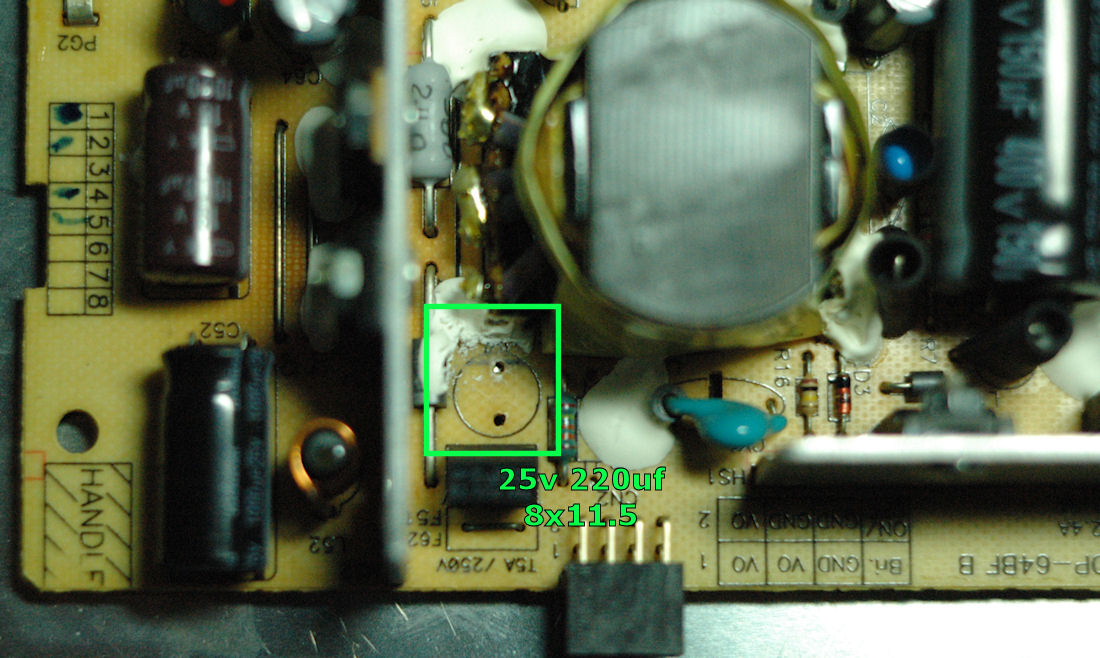

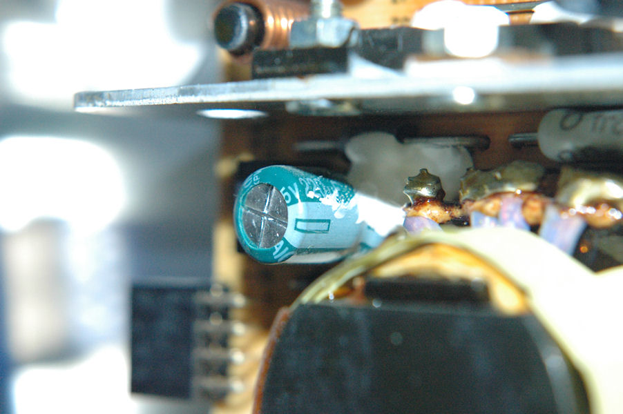

                                      Ok for the Powersupply, all my caps were good, however A Taicon existed that I did not trust, so I replaced it. Other powersupplies have been known to have bad caps however mine did not, but you can find those searching these forums.
                                      This is for powersupply EADP-64BF on the Viewsonic vp2130b, may also be the same powerboard in the 2030b.
                                      Cap replaced
                                      Taicon PW(P) 25v 220uf (Best info I could find anyway)
                                      8x11.5 234miliohm 555 ripple 3k hr rated
                                      Ripple Freq
                                      0.65@120hz, 0.85@1k, 1.0@10k+
                                      Replaced with
                                      1x EKZE250ELL221MHB5D 25v 220uf KZE
                                      Digikey part#
                                      565-1674-ND
                                      8x11.5 72miliohm 760 ripple 3k hr rating
                                      Ripple Freq
                                      0.50@120hz, 0.73@1k, 0.92@10k 1.0@100k
                                      Removing the old cap will require using a dental pick or something of the sort to pick off the white nasty glue and scrap it off for clearance for new cap.
