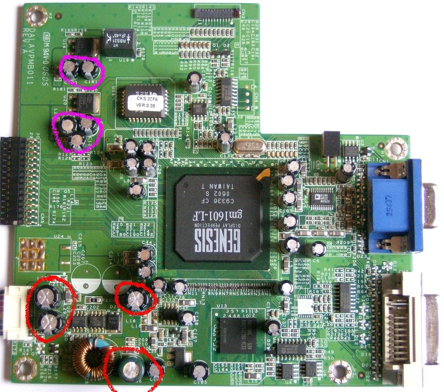

        Splinter,
        I beleive your problem has more to do with the caps on the Main Board (the green one).
        Replace the red circled ones. If that doesn't fix it, replace the purple cicrled ones.

          lucky13, thanks for your advice. I'll order the caps you have highlighted with those for the power board.

              lucky13, I got the caps and have replaced the ones you circled in red. I now have the display running without the rear cover in place so that it won't have to be removed if I have to replace the purple circled ones as well. So far, after a week of use, the "off/on" problem has not reoccurred, so it's looking hopeful that the new caps have fixed the problem. Thanks for your timely advice!

                  Okay, its now some three weeks since I replaced the red ringed caps on the logic board of my VP2130b display. It's running fine so have decided to replace the back cover. I guess this will tend to raise the temperature of the three boards by a few degrees. I'll see how it performs over the next month.
                  Once again, thanks to all at Badcaps for help in understanding and fixing the problem.

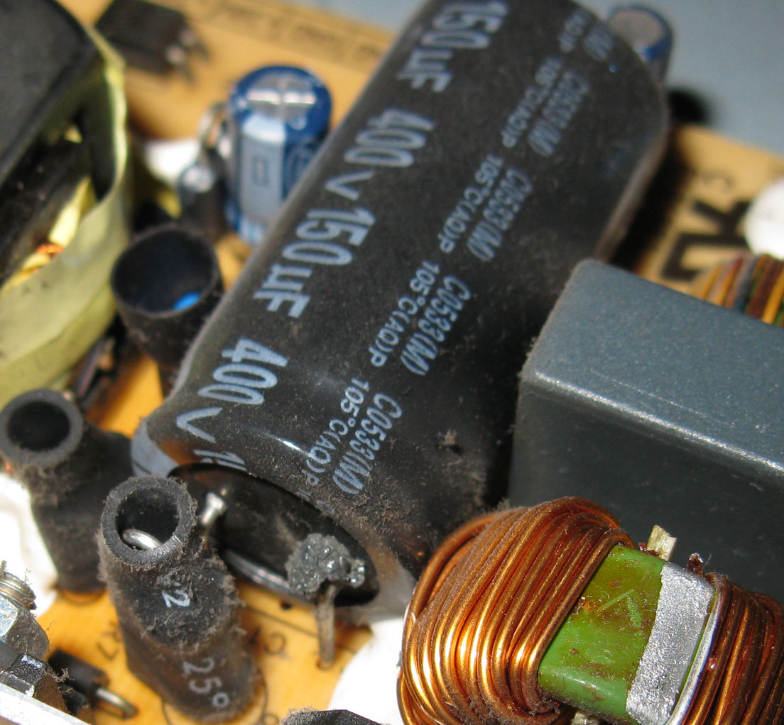

                    Re: vp2130b cap help
                    Hello folks
                    I also have a broken vp2130b. The problem is sort of like Splinter's: it will turn on fine but after a couple of minutes the display will start to flicker and tear (not really sure how to describe it -- it looks like a bad signal or something) then go off.
                    I opened it up and found some obviously bad caps:
                    - The CapXon ones on the invertor board (or at least I gather that's what it's called from reading this thread) -- two are bulging, one has blown out the bung on the bottom
                    - The green 1000uF one on the main board is bulging
                    - The big one on the power board has some stuff leaking out by the leg (at least I assume this is bad, see attached pic)
                    I think there's enough info in this thread for me to go and replace the caps on the main and invertor boards, but I don't know about the big one. Should I replace it? If so, what with? The writing on it says TAICON / C0533(M) / 105oC(AQ)P / 400V 150uF. I can't find the relevant stuff on the Taicon site
                    btw Thanks to all for the great thread + forum!

                      It doesn't look too healthy. Although the large caps rarely fail, this one is the exception. Go to digikey.com and type in the part # 493-2074-ND. It's a Nichicon PW series cap rated @ 100uf 450V. Compare the length and diameter to make sure it will fit. As a matter of fact, order all your caps from digikey. Panasonic FM series would be a good choice. Select USPS First Class shipping for the best rate.
                      • retiredcaps
                        • Apr 2010
                        • 9271
                        #71
                        I took a quick look at
                        http://www.taicon.com.tw/product/product_index.htm
                        and couldn't find anything. C0533 means the cap is made in 2005, 33 week. I believe (M) means +/- 20% tolerance of the capacitance. AQ might designate the series, but I don't see AQ in their product catalog. It could be an obsolete series now?
                        I would replace the big one in addition to ALL the caps (big or small) given how many caps are bad and the age of the monitor (5+ years). If you use quality low ESR caps, you should get another 5+ years use.
                        Caps do not have to be bulged in order to be bad. They can have high ESR (ohms) or be out of tolerance. For example a cap can measure 8 ohm ESR which is really high whereas a good one might measure 0.2. A 1000uF cap might meausre 220uF which is way out of tolerance.

                          The big 400v cap doesn't have to be low ESR because it isn't under much stress. For that matter you can use even an 85 degree Celsius rated cap (although it would be better if you can find a 105C one), just make sure the voltage, capacitance, and size all match.

                            Do you have a meter to check the voltage on the big cap when it is live?
                            I have yet to see a bad 150uf/400v cap on this series (yours might be the 1st).
                            You might want to post more pictures from the p/s so we can tell you if more caps need to be changed perhaps.
                              Oops! Disregard what I said. I looked up the wrong value. 100uf vs 150uf.

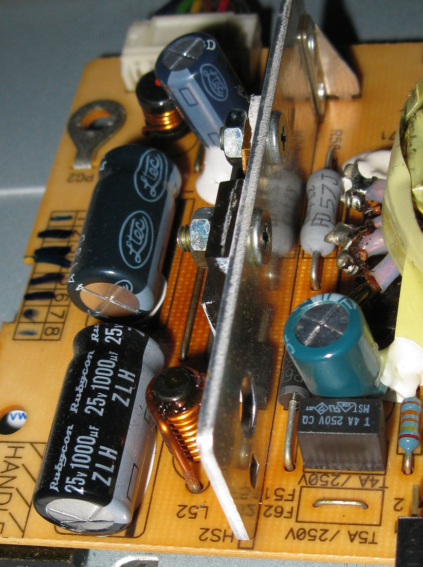

                                On the power supply board, there are:
                                - 400V 150uF, Taicon something. Digi-key 565-1471-ND looks good to me (voltage, capacitance, temp rating match. A little longer than the taicon one, but that doesn't look like it should be a problem)
                                - 25V 1000uF, Rubycon ZLH. Ripple 2250, ESR 0.018. 10x23mm. Digi-key 565-1681-ND has 2360 ripple, 0.021 ESR, slightly fatter
                                - 50V 22uF, Ltec LZG. Ripple 190, ESR 0.68. 5x11mm. Digi-key 565-1703-ND has 238 ripple, 0.34 ESR, same size
                                - 50V 47uF, Ltec LZG. Ripple 272, ESR 0.395. 6.3x11mm. Digi-key 493-1896-ND has 300 ripple, 0.43 ESR, same size
                                - 16V 470uF, Ltec LZG. Ripple ~800, ESR ~0.1. 8x15mm. Digi-key 565-1524-ND has 840 ripple, 0.087 ESR, same size
                                - 25V 220uF, Taicon PW? Digi-key 565-1674-ND recommended by endevite
                                - 16V (I think) 1000uF, Ltec LZG. Ripple ~1400, ESR 0.046. 10x20mm. Digi-key 565-1528-ND has 1400 ripple, 0.046 ESR, same size
                                I've attached a pic of the 4 that weren't visible in the original pic. I bunged up the 2 small blurry ones in the original pic when trying to pry up the big one so I could read the text on the bottom. Woops :P
                                On the invertor board, there are just the 3 35V 180uF Capxon GF ones. 2 * 565-1602-ND and 2 * 565-1603-ND recommended by endevite

                                lucky13: I don't have a meter, though I really should get one. Kinda worried I'd zap myself if I started poking around while it was turned on tho
