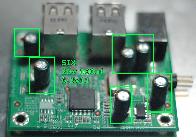

    Ok for the USB board, again my caps had not failed here, but others had them fail, and Teapos are just bad news. So the deets on the recap.
    This is for the USB board in the Viewsonic vp2130b, may be identical to the vp2030b.
    The Old
    Teapo SC 25v 100uf
    6.3x11 220miliohm 250ripple 2k hr lifespan
    Ripple Freq
    0.70@120hz, 0.90@1k, 0.95@10k, 1.0@100k
    The New
    6x EKZE250ELL101MF11D 25v 100uf KZE
    Digikey part#
    565-1673-ND
    6.3x11 130miliohm 405ripple 2k hr lifespan
    Ripple Freq
    0.50@120hz, 0.75@1k, 0.90@10k 1.0@100k

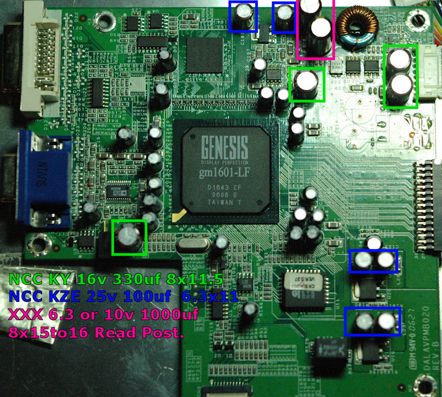

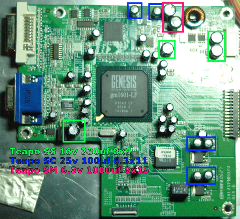

      Last post hope it helps anyone who is working on a vp2130b or vp2030b.
      Ok the fun one, biggest pain to recap, but the working product is well worth it.
      This is for the Mainboard/Motherboard on the Viewsonic vp2130b, may very well be the same as the vp2030b.
      3 cap types to replace on this bugger.
      All Teapo, and one is a hard to find replacement.
      Just like on the USB board another 6 of these.
      6x Teapo SC 25v 100uf
      Ripple Freq: 0.70@120hz, 0.90@1k, 0.95@10k, 1.0@100k
      So of course, they get replaced with 6 of these.
      Digikey part# 565-1673-ND
      Ripple Freq: 0.50@120hz, 0.75@1k, 0.90@10k 1.0@100k
      Next,
      These have gone on other monitors with the same motherboard, so good to change them out.
      The Old
      4x Teapo SS 16v 330uf 8x9 1000 hr lifespan
      miliohm unknown, 155 ripple
      The New
      NCC KY 16v 330uf 8x11.5 7k hr lifespan
      4x EKY-160ELL331MHB5D 16v 330uf KY
      Digikey Part# 565-1522-ND
      130miliohm 640 ripple
      Ripple Freq: 0.50@120hz, 0.85@1k, 0.94@10k, 1.0@100k
      The last 2 caps are difficult to find because of the limited space, it can be no wider than 8mm and no taller than 16mm, so generally looking at 8x12's to 8x16's.
      (might be able to squeeze 18 but who makes 18)
      The Pain to find (Marked in the pink boxes in the images).
      The Old
      2x Teapo SM 6.3v 1000uf 8x15 2k hr lifespan
      53miliohm 950 ripple,
      these caps work in parallel giving a total of 1900 ripple & 26.5 Milliohms
      Ripple Freq: 0.75@120hz, 0.90@1k, 0.98@10k, 1.0@100k
      The what you can use for new just have to find,
      I used Sanyo WG's, identical stats to Panasonic FJ's (had some on hand)
      (IF YOU BUY ON EBAY MAKE SURE FROM OTHERS THEY AREN'T HONG KONG FAKES)
      Sanyo WG/Pani FJ 2k hour Lifespan
      8x11.5 6.3v 1000uf 30miliohm 1140 ripple
      Totals 2281 ripple @ 15 Milliohms
      Ripple Freq: 0.50@120hz, 0.85@1k, 0.95@10k, 1.0@100k
      Alternative you can try but good luck getting
      (they all have acceptable ratings and fit),
      Rubycon MCZ 10v 1000uf 8x16
      Rubycon MBZ 10v 1000uf 8x16
      Rubycon ZLH 10v 1000uf 8x16
      Samxon GD 10v 1000uf 8x16
      Samxon GE 10v 1000uf 8x16
      Samxon GA 6.3v 1000uf 8x12
      Samxon GC 6.3v 1000uf 8x15 <--badcaps sells this one ( -> LINK <- )
      Raitings for the GC 6.3 1000uf -> 20miliohm 1700ripple
      Final Note: If you want to be adventurous and find another cap to use in place of these suggestions, make sure the ratings are better or equal to the originals, this is the motherboard we're talking about, don't go slapping in 200ripple 400miliohm caps just because they fit and are 6.3v 1000uf.
      Now for the pictures.
