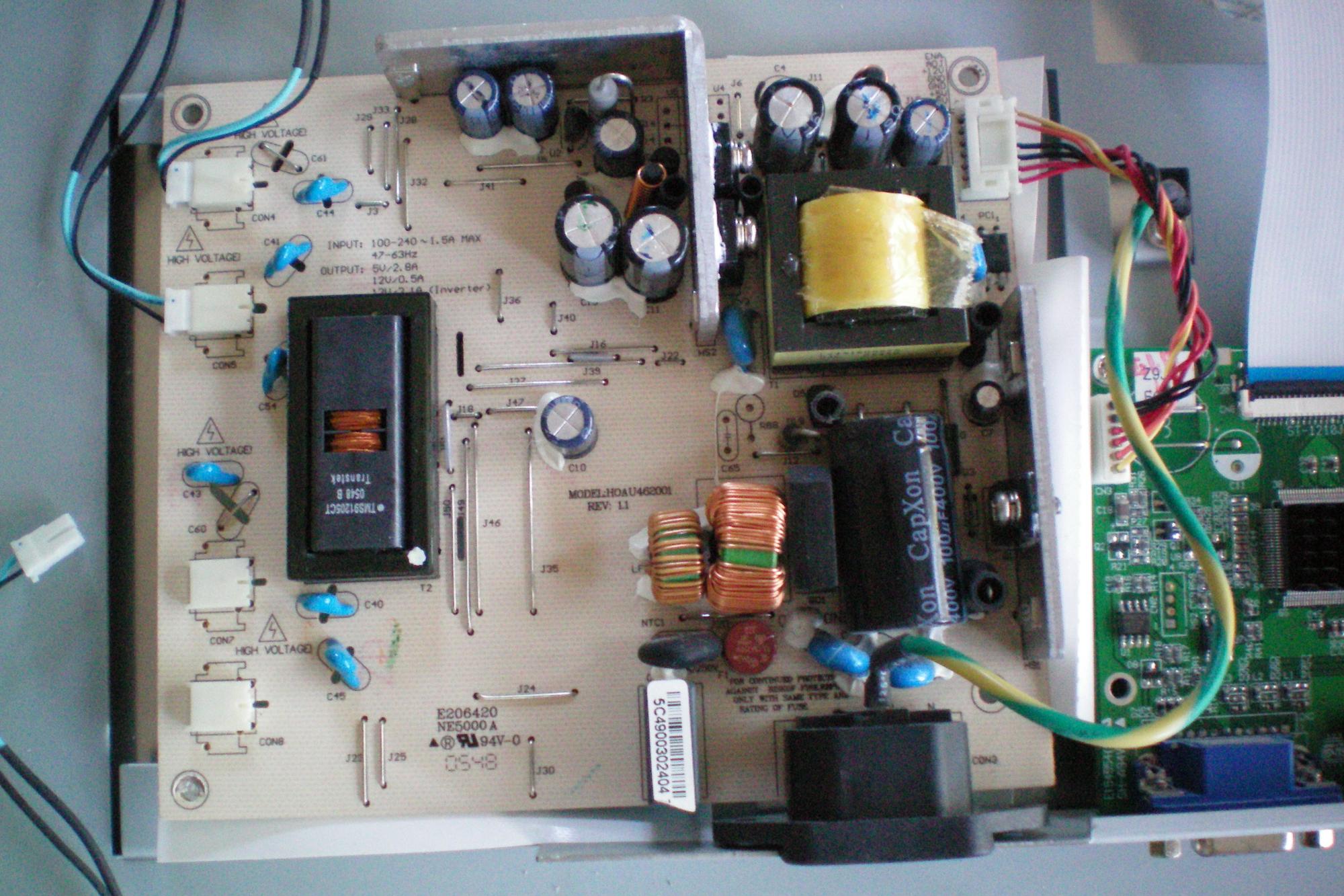

                    I looked through all the threads to try & find my problem, but no luck. So, here goes... My DCLCD 19" "died" a couple of days ago. I noticed that after coming back to it after a while, it would not "wake up". I tried pressing the power button, but that didn't work. What did work (a few times) was to unplug it and then plug it back in. Eventually, the entire screen would be white. That's all I get on it now. The other observation was that as I was plugging it back in, the front panel power led would be momentarily purple before going to red, at which point I had the white screen, and again, the power switch is ineffective.
                    Thank You in advance for reading this and any comments concerning my display!

                      (Sigh). Open up the monitor, take pictures of the power supply (top and bottom) and the signal card. Attach them to your next post using 'Manage Attachments' - below the text entry area.

                        Sorry about that.... here are 2 pictures. One of the signal board, the other is the bottom of the power supply board. I don't know why it won't let me load the third one, I'll post the top of the power supply in the next post...
                          Re: Need help DCLCD 19" LCD Monitor - I already replaced caps
                          Here is the top of the power supply board...

                            You power supply looks like it's of a newer design.
                            You have some budging capacitors just above the large transformer with the yellow tape on it.
                            Replace all the capacitors with the exception of the really big on.
                            I have to warn you there is the possibility of damage to the logic or signal board from low voltage, but it's worth a shot to replace the capacitors.

                              Sometimes the site is just obnoxious. I'll give you a C+ on the pictures - grading on the curve, of course. A couple of things are apparent.
                              1. You have at least two bad caps. One has obviously vented.
                              2. The monitor was built with Capxon caps.
                              Capxon caps aren't the worst possible caps, but they aren't far from it. I suggest replacing all 10 of the electrolytic caps (with the exception of the large one) with Panasonic FM or FR series caps. There is a good chance that is all it will take to repair the monitor. You may be able to dig the values from this thread. Double check that against the actual capacitors in your monitor.

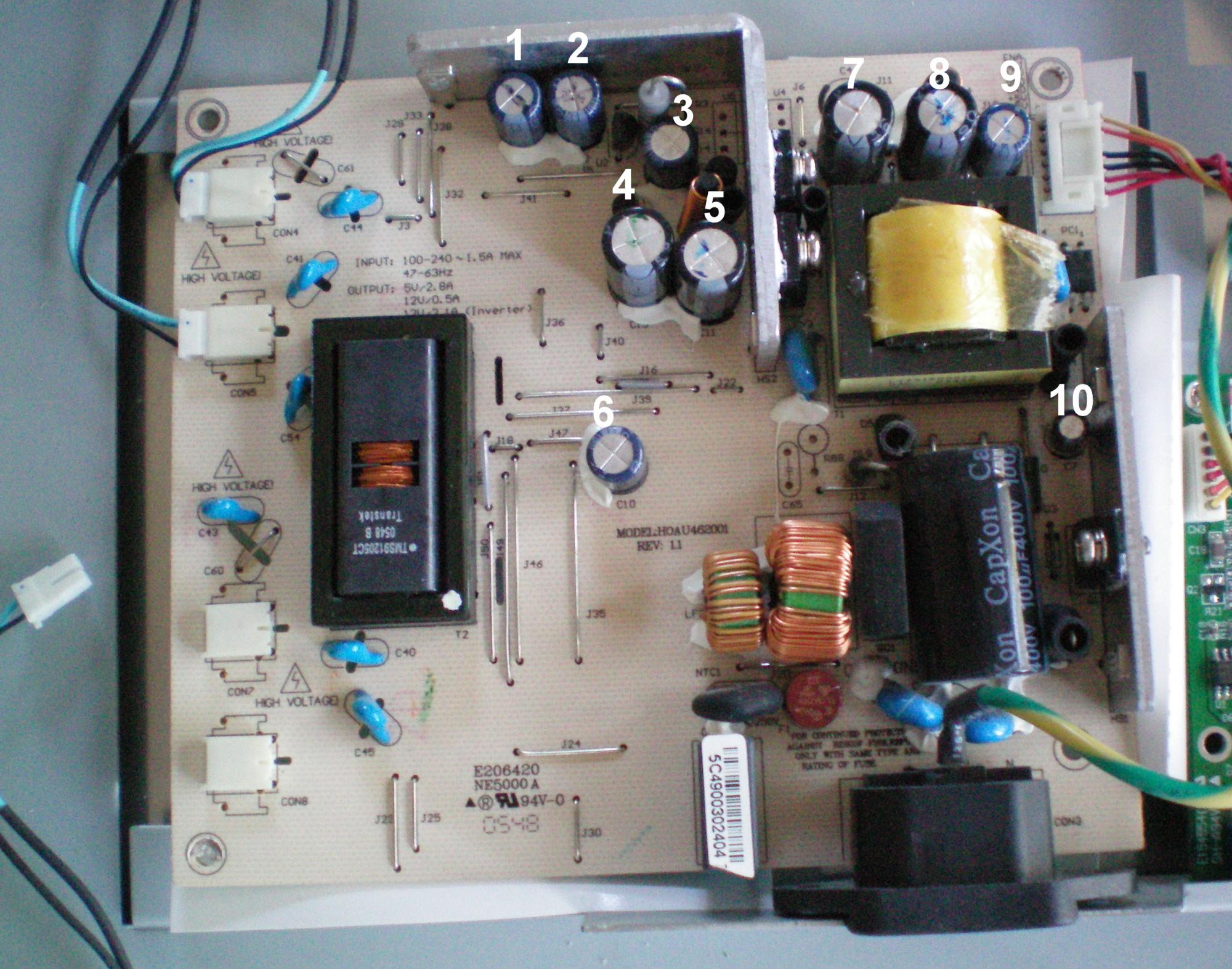

                                    As requested, I removed the caps and have them listed for verification. Ok, here's what I have for info. I'm posting a new picture, with number labels above each cap. first number is picture label, second is ps board part# third is capacitance fourth is voltage....
                                    1 C33 220uF 25V
                                    2 C72 220uF 25V
                                    3 C14 220uF 25V
                                    4 C13 470uF 35V
                                    5 C11 470uF 35V
                                    6 C33 220uF 25V
                                    7 C12 1000uF 16V
                                    8 C12 1000uF 16V
                                    9 C33 220uF 25V
                                    10 C7 10uF 50V
                                    First column is quantity, 2nd is capacitance/voltage third is digilink part # fourth is panasonic #
                                    5 220uF/25V P12383-ND EEU-FM1E221
                                    2 470uF/35V P14440-ND EEU-FR1V471L
                                    2 1000uF/16V P14398-ND EEU-FR1C102
                                    1 10uF/50V P11250-ND EEU-FC1H100
                                    Once again, Thank You for your time, consideration, and great technical advice!
                                    Don

                                      Could you also measure the capacitor sizes, along with the volt and UF values?
                                      The diameter and height of the capacitors are a critical measurements,They need to fit where you want them to go.
                                      Example #7 and #8 look to be 12.5MMx20MM.Or 10mmx20mm?
                                      #9 looks like 10mmx20MM.

                                        Yikes !!!!!!!!!!!!!! Thank You !!!!!!!!!! I had the wrong stuff.. my 10 & 220 uF were ok, but you hit the caps right on the head!!!!!!! my 1000 & 470 were both the wrong size....10x20 on both sets...
                                        Now my updated order list looks like this....
                                        2 470uF/35V P12415-ND EEU-FM1V471
                                        2 1000uF/16V P12366-ND EEU-FM1C102
                                        Nice catch... I once again bow to the geniuses...

                                          One point that should be made - it's not necessary the replacements match the original dimensions. The only criteria is they must fit in the available space.
                                          If originals were 15 mm in diameter and 20 mm high, 12.5mm x 25mm would be acceptable IF you had enough height.
