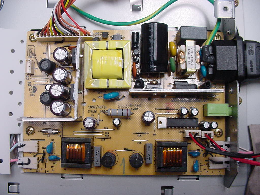

                    I have two dclcd 19" lcd monitors and one of them died a few months back. I was going to throw it out, but i decided to try to fix it. I did some research online and found that the capacitors are typically the problem, so that is why i am here.
                    The first thing i did was switch out the entire inverter board for the one in my monitor which already works. Once the working inverter board was put in, the broken monitor worked again - i therefore know the problem is on this board somewhere!.
                    The board is loaded with elite caps which i guess can go bad.
                    I ordered 5 caps from digikey (all exact voltage, uf specs as the ones i replaced) in hope that it would be on of the 5 larger caps. I swapped them in with no luck. I then got determined and swapped the other caps between my working and broken board. The board which was originally working still works, and the broken one is still broken.
                    i swapped all of the caps with the red x's on it.
                    What else should i do? I'm out of time today, but maybe you guys can give me some guidance

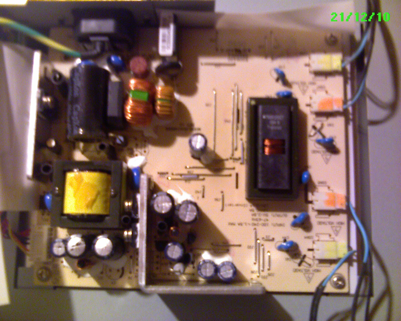

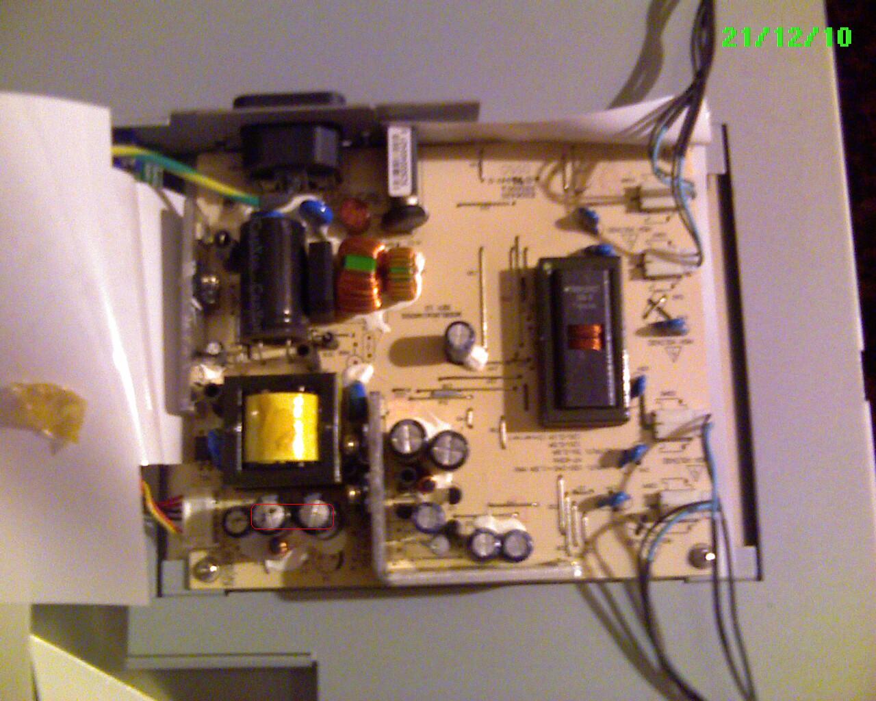

                          I had problem with my similar DCLCD 19" monitor, anyway, I scavenged 2 capacitors (TEC, 16V, 1000uF) from a bad power supplies, test them out, and the monitor is work like new, the color is vivid.
                          Symptoms:Monitor began color shifting a while back(a year ago), greenish mostly, I didn't bother fix it, until it die out on me yesterday, open her up, find bad brand capacitors all in, didn't bother replacing all of them, just these 2 popped(CapXon, 16V 1000uF). anyway, I have been using it for like about 4 years. now it is like new, just want to share my experience, hoping it will help other. Great site though.

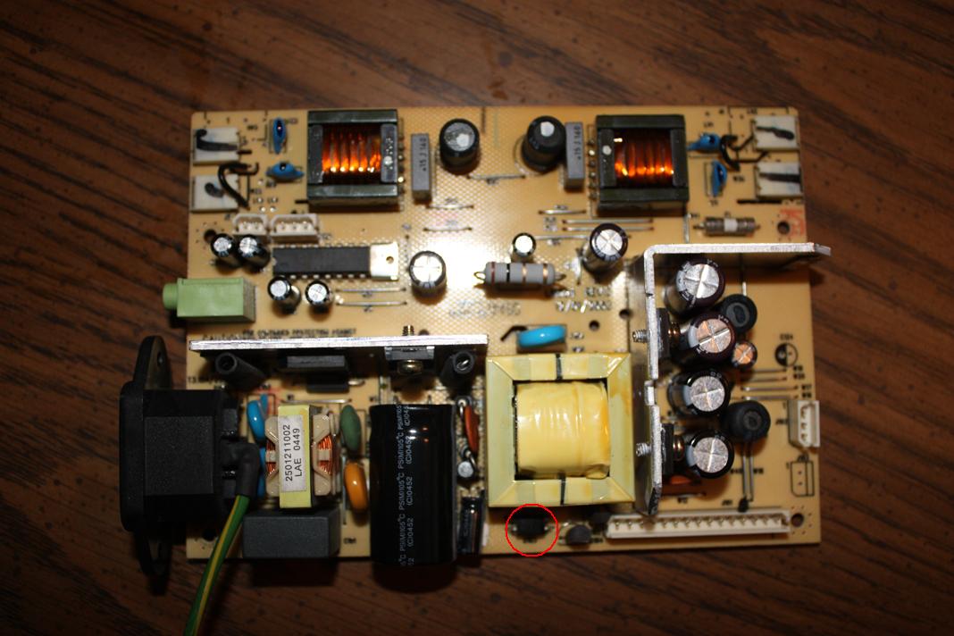

                                    1) If the power LED does not come on at all, measure the all the pins on the connector (just right of the optoisolator). Use a ground screw for the black probe. The red probe goes to each pin. Put your multimeter on 20V DC. List, measure, and record each pin. You are looking for DC voltage. At minimum, you should see 5V DC on one of the pins.
                                    2) You are using the incorrect GND if you are getting negative voltages. To test the large cap, put your multimeter on 200V DC (if manual). Put your black probe on the negative leg and red probe on the positive leg. If you have 120V main voltage, the big cap should read 120 x 1.414 or roughly 160V to 165V DC. It should be a stable voltage. CAREFUL, this is high voltage.
                                    3) The pulsing voltage is a clue. The small cap lying on its side just right of the big cap could be bad without bloating. That cap is critical to the SMPS startup process. So if you do not see any secondary voltages from #1, this small cap could be the culprit.
                                    4) Can we clear and focused picture of YOUR board? Reusing other people's pictures (especially without telling us) doesn't help us diagnose YOUR problem. Your board could have unique characteristics not shown in someone else's photo. It is not uncommon for manufacturers to make changes on their boards. Also try to get the resolution as close to 2000x2000 as possible.

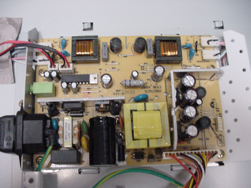

                                          Re: Need help DCLCD 19" LCD Monitor - I already replaced caps
                                          This is the best I can do today. The better dept camera is not available. I think just about everybody is out for Xmas.
