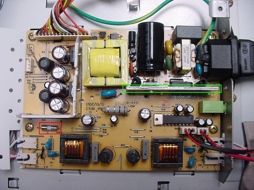

    I see the same voltage pulsing on what looks like a fuse (red). I also see a pulsing -85V on the metal piece framed in green. Isn't that a heat sink?

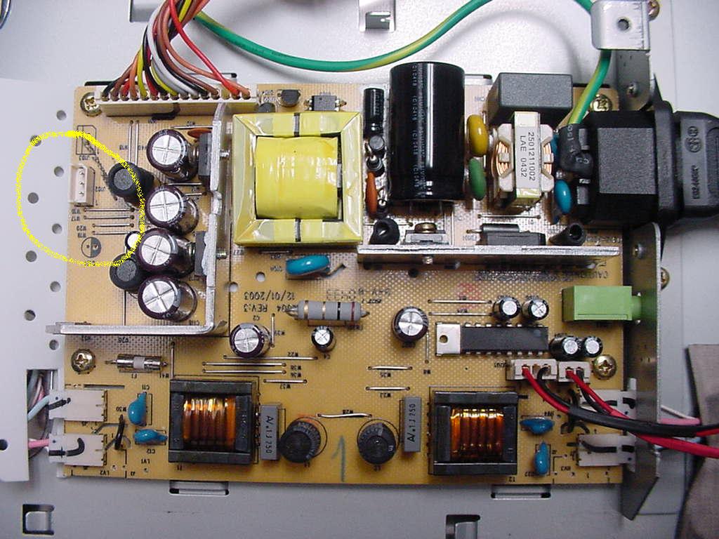

        A few questions:
        1) Looks like the power supply is not running by the looks of the outputs at the wiring harness. When you took the voltage readings, was everything hooked up? Some power supplies require a load before they will start.
        2) I circled a connector on your photo. Was it connected to anything?
        3) The small cap that's next to the large cap. Try to measure the voltage across it. Please report what you see. Be careful of the high voltage cap next to it.
        4) If you can post a photo of the entire bottom of the board, it would be helpful.
          F on the pcb denotes a fuse. A good fuse should measure less than 1.0 ohms (with power off and lcd unplugged).
          The metal piece is a heatsink. -85V again means you have the wrong GND point.
          Change out that little cap first and then we can proceed.

              A few questions:
              Everyting is/was connected. Double checked all of them.
              Nothing was connected there.
              11V-14V varies like the rest
              I returned the dept camera. I can get it again tomorrow.
              Also the heat sink. I had the black on the PCB screw connector (just right of the optoisolator) and touched the red to the sink. I would think I should not register anything, but I do. I also tried it with the black lead connected to the green ground wire on the screen frame. -80+V.
              The fuse is good.
              REV 3 not J on the board.
              I can change them both out. The big and the little. The pulsing voltage looks to me like a cap building then leaking down over and over. I usually only ramp them until breakdown on our structures on wafers.
