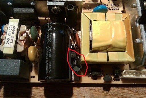

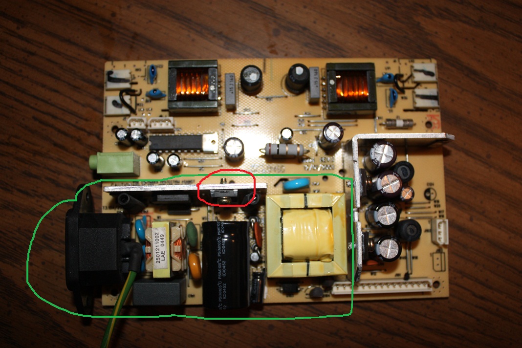

                  Hi, all. My first post on this forum. I already read some threads here and I have found tons of useful information. Great forum.
                  I also have same monitor, with little bit different symptom. Monitor will not turn on. The power LED will flash on and off. There also clicking sound coming from the area colored green. I suspect that the K2645 MOSFET is the problem. But can not tell for sure.
                  No leaked caps on the board. Four transistors on the bottom of the board seems to be working.
                  Any ideas?
                    Are you getting any stable secondary voltages like 5V or 12V DC on the connectors to the logic board?
                    If not, are you getting mains voltage * 1.4 across the big filter capacitor?
                    Did you test the fuses to see if they are open?
                        What is the good way to test the voltages? Put the power/inverter board on the desk, plug in the power cord in and test
                        I would not dare to try that way. I'd make sure that whole circuitry is correctly connected to LCD before trying to measure any voltages. That ensures that you have ground where it's supposed to be.
                        I always try to make sure that I can't short any 2 connections accidentally so I usually connect my multimeters black wire in some safe ground position (away from measurement points) before getting into measuring voltages. It's easier and safer to measure when you operate only one measurement point at a time.

                          Re: Need help DCLCD 19" LCD Monitor - I already replaced caps
                          blinking pled clicking noise?
                          Try replacing the small cap.Thats next to the large cap.Use low E.S.R.
                          Also look real close at all solder joints.
                          Al.
                            Al.
                            I checked all solder joints - they seems to be fine. I can not read if the little cap is 22uf 50v or it is 2.2uf 50v.
                            Does anybody know what it is?
                              The one on my board is 22uf 50v
                              Al.
                                Just to expand, from what I have learned, the little cap is sometimes called a startup/run cap.
                                It helps the SMPS startup. The SMPS provides your secondary voltages (5V, 12V, etc). If the startup cap is bad, sometimes you will hear the SMPS start/restart (or click).
                                My questions about the secondary voltage and mains voltage and your findings may have eventually lead to this startup cap, but alexanna just took the shortcut to it!

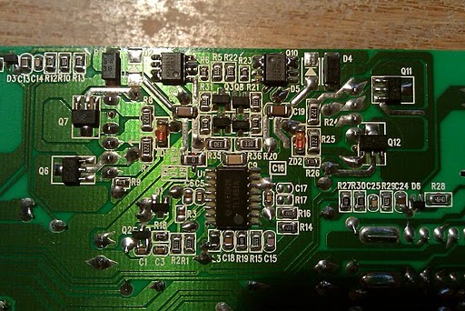

                                    wenter.
                                    is there any you could post a good close up of the back of your board around the area of Q6thru q12.Something with the so-8 apm9435 mosfets dose not look right on my board. I just need to verify
                                    Thanks Al.
                                      I ordered new startup cap - will post when it'll be installed
                                      Which one?
                                        wenter.
                                        Thanks Al.
                                        Here is the best shots I can make with my camera
                                          Which one?
                                          Did you ever test for secondary voltages?
                                          I believe the small one in the red circle is a startup cap.
                                          No, I did not try the voltages yet, I'll wait for cap to come, solder it in and assemble the monitor together to check all things out.
