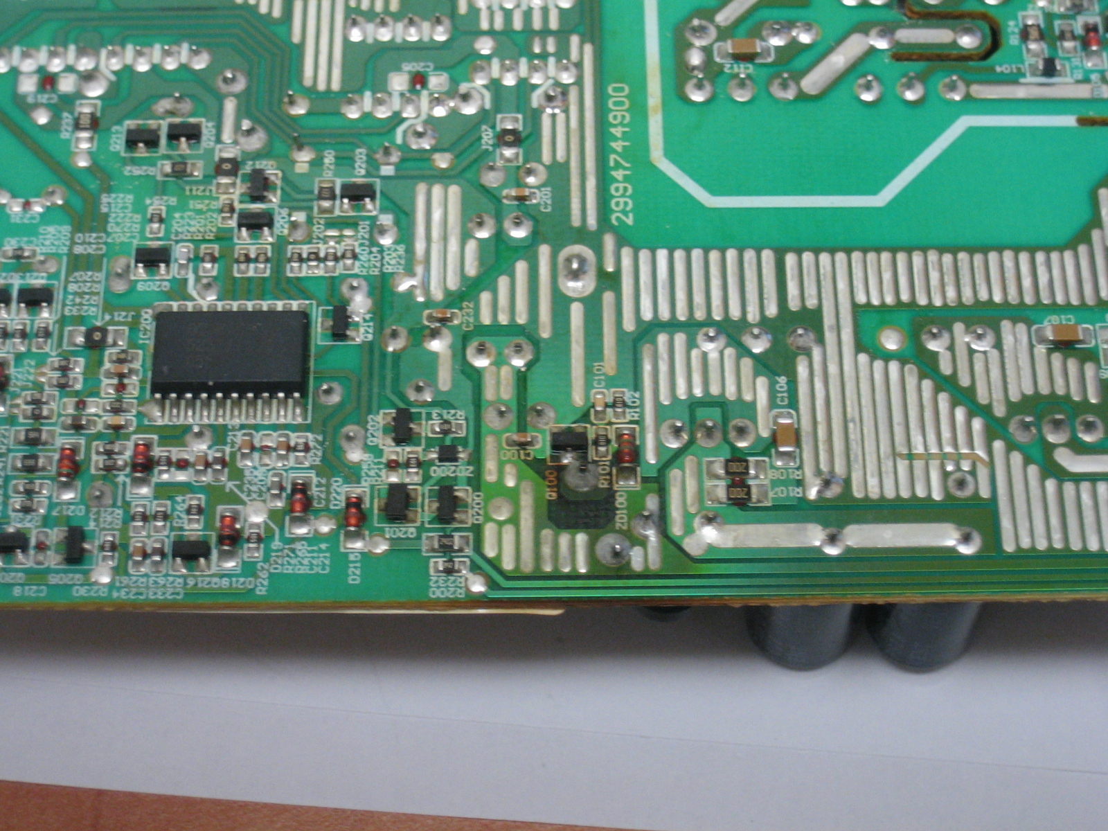

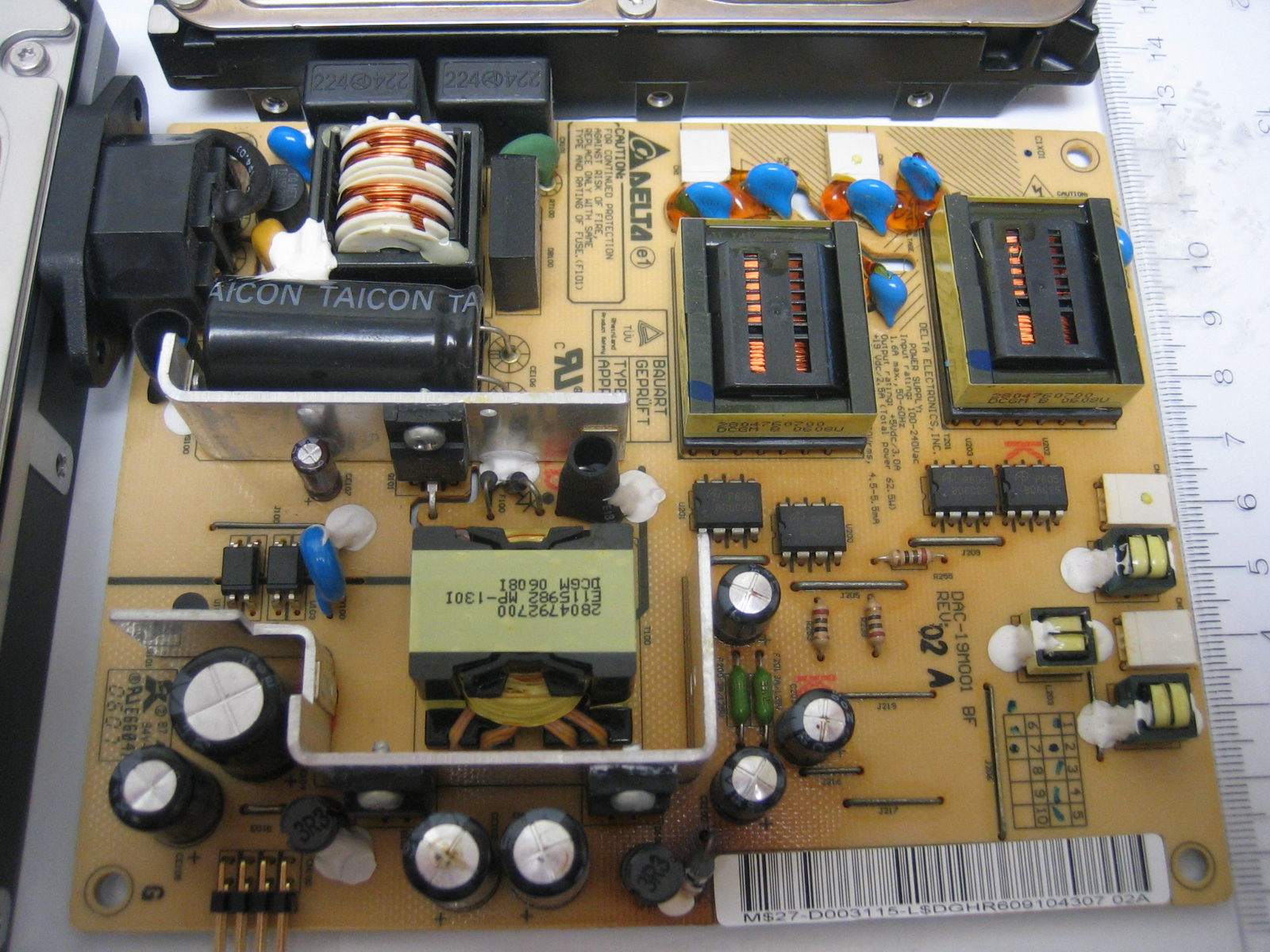

    I believe this Westinghouse 19" widescreen is a rebranded Optiquest. Won't power up when plugged in. A lot of the parts inside say ViewSonic or OptiQuest. The Power/Inverter board is a DELTA, which outputs both 5Vdc, 3.0A and (inverter) 1250Vrms, 4.5 to 5.5 mA.
    This unit has 5 bulging CapXon capacitors (hmm, beginning to see a pattern here), a likely blown fuse (3.15 A, 250 V radial button-type fuse), and a potentially blown resistor (and possibly the neighbouring inductor). A majority of the bulging CapXon capacitors have date code P608, so 8th week 2006. Here's the list of bad caps:
    1. CE100 _220uF 25V KF/105C 8 x 13 mm
    2. CE101 1000uF 25V KF/105C 10 x 21 mm
    3. CE102 1000uF 25V KF/105C 10 x 21 mm
    4. CE104 2200uF 10V KF/105C 13 x 20 mm (no bulge)
    5. CE105 1000uF 10V KF/105C 10 x 15 mm (no bulge, date code P608)
    6. CE107 __22uF 50V GL/105C 4 x 11 mm
    7. _C200 _220uF 25V KF/105C 8 x 13 mm
    8. C203 _220uF 25V KF/105C 8 x 13 mm
    9. [FONT=Courier New]Resistor Violet-Blue-Violet-Silver, which, if memory servers is 76 x 10^7 Ohms or 7.6 MOhm with 10% tolerance - I think
      Pics are worth 1000 words, and will follow soon.

    Re: Westinghouse 19" Power/Inverter
    Here are the pics.
    Last edited by PincushionMan; 12-09-2009, 09:40 AM. Reason: Adding promised pictures.
    • Bobdee
      • Jun 2008
      • 461
      You also have 2 axial fuses (green) in between those blown caps
      • PincushionMan
        • 22
        Confirmed. Those are F200 and F201, respectively, they are 3A 125V fuses (according to silkscreen)
        Good eye, Bobdee!
        • PincushionMan
          • 22
          Surprisingly, none of the fuses were blown, and with a bit of soldering some new Panasonic FM/FC series to replace the CapXon caps the monitor works again. Well, not exactly - I had to then fixing my poor cold solder joints - tin solder is no fun. I seem to remember getting tested in electronics class. If the teacher could pick the board up by the resistor after soldering with no joints snapping - pass. If either of the joints snapped (or worse, the board fell) - fail.
          Thanks for the help everyone.
