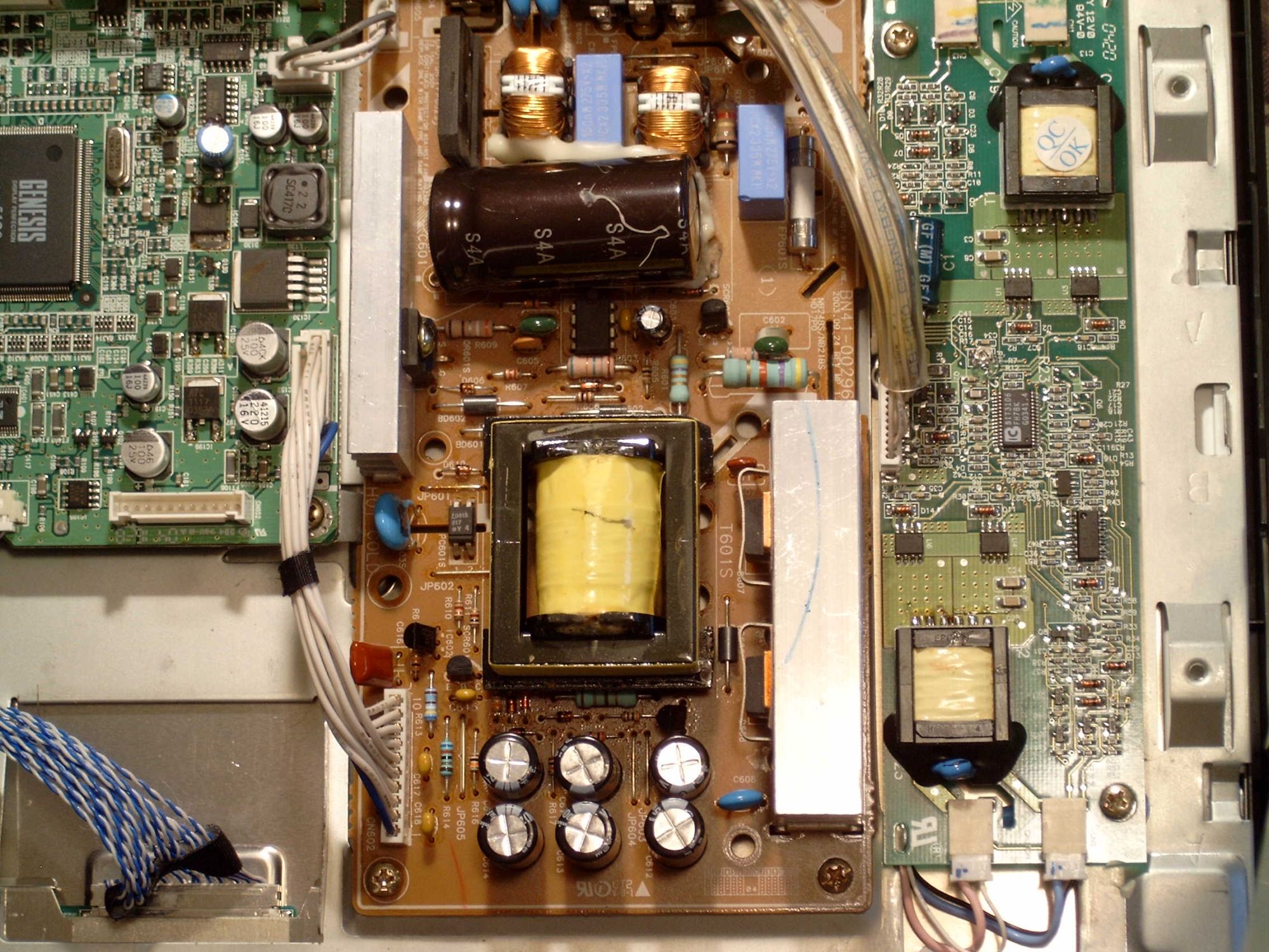

            Here is a photo of the power and inverter boards. I found that a connector on the power card is marked "14v" and "5v". My 5 volt supply is pretty close (5.1) but the 14 volt supply is high.

              I just bought this same exact monitor and it has the same exact problem. The power board is the same as above. It had 3 X 1000uF 25V and 3 X1000uF 16V. Recapped to all six new 1000uF 25V caps. Same problem exists still. I have yet to go through the checklist of "2 seconds to black" procedure. Has anyone ever found a solution to this problem with this monitor?

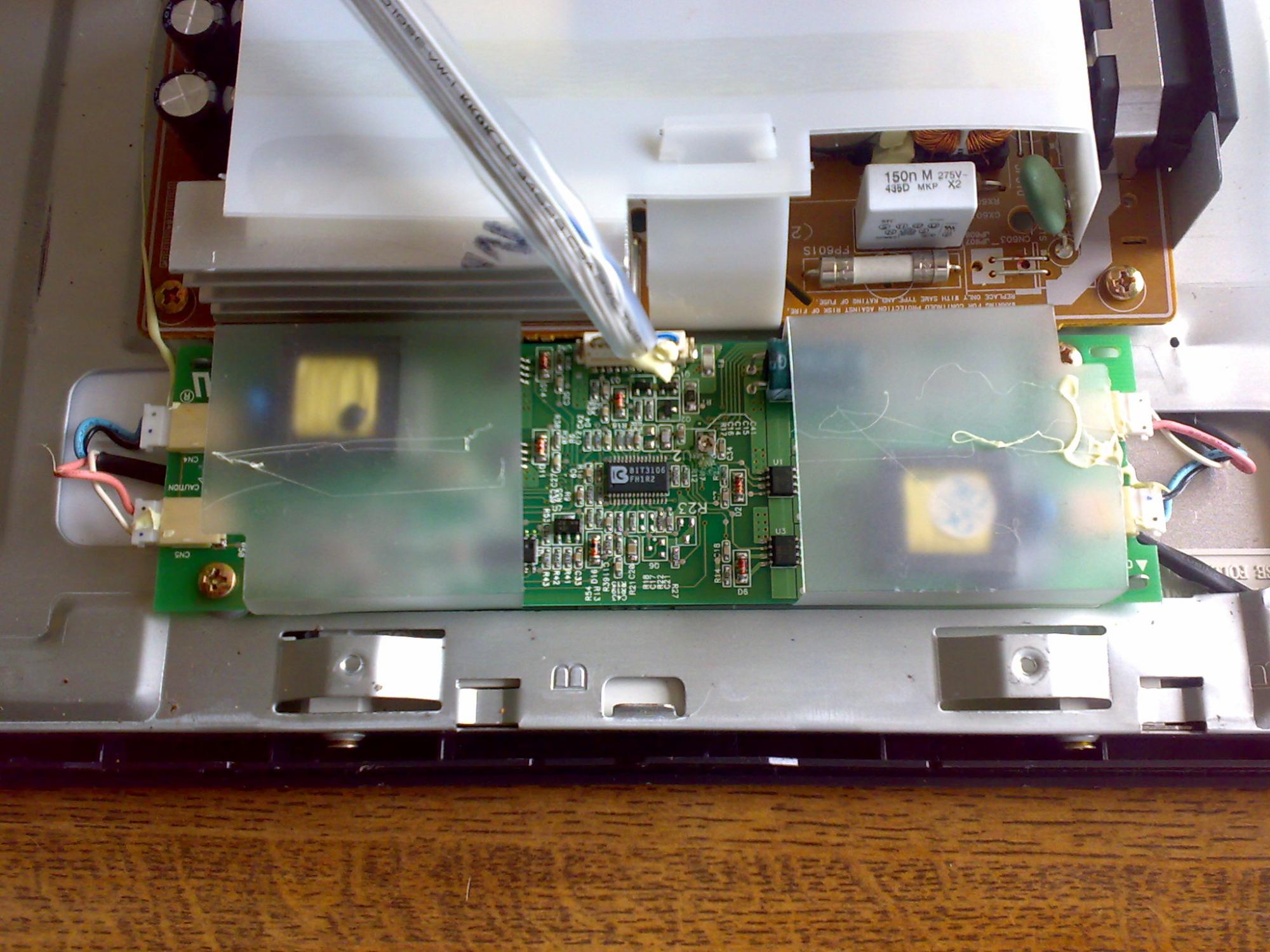

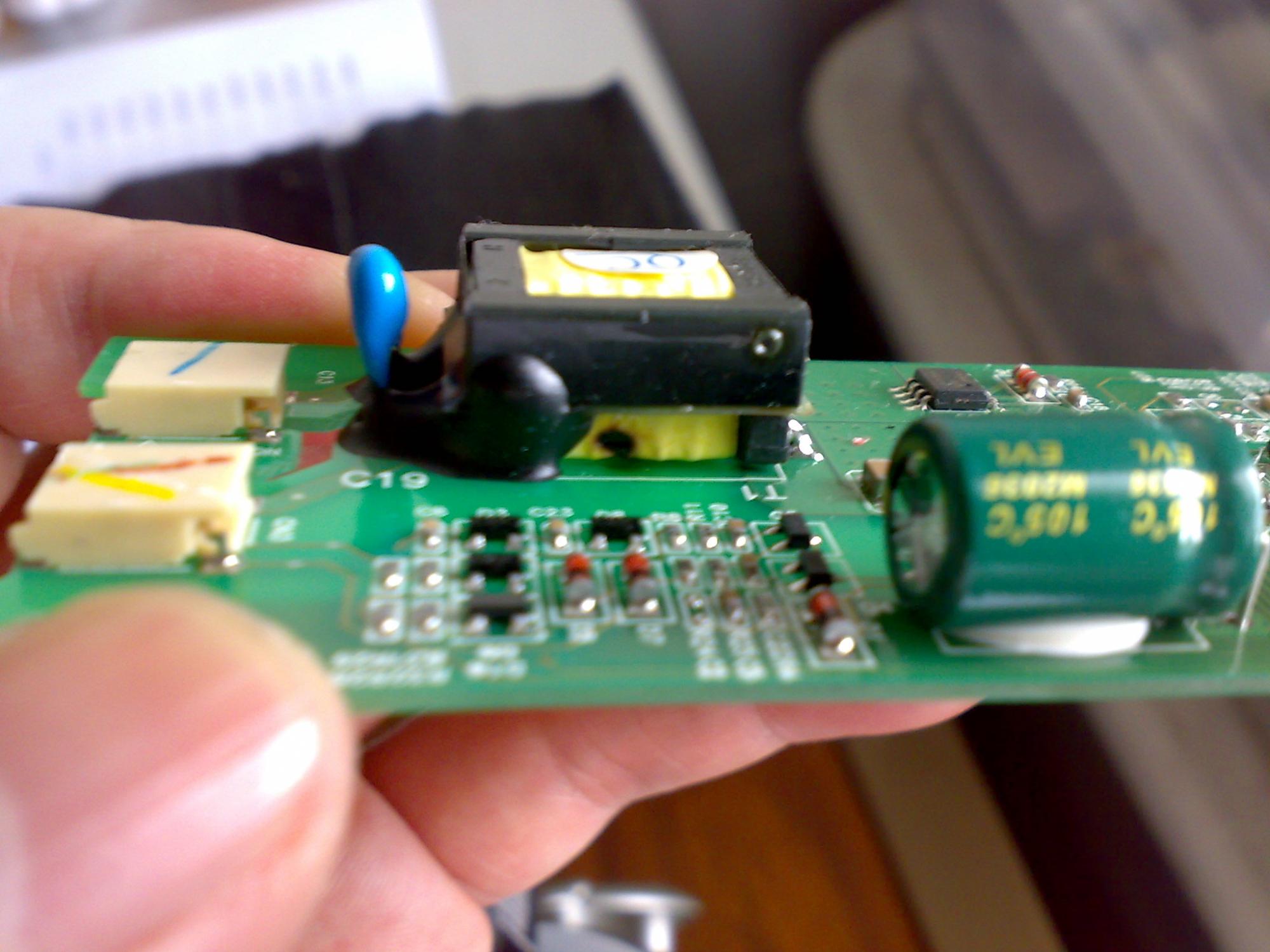

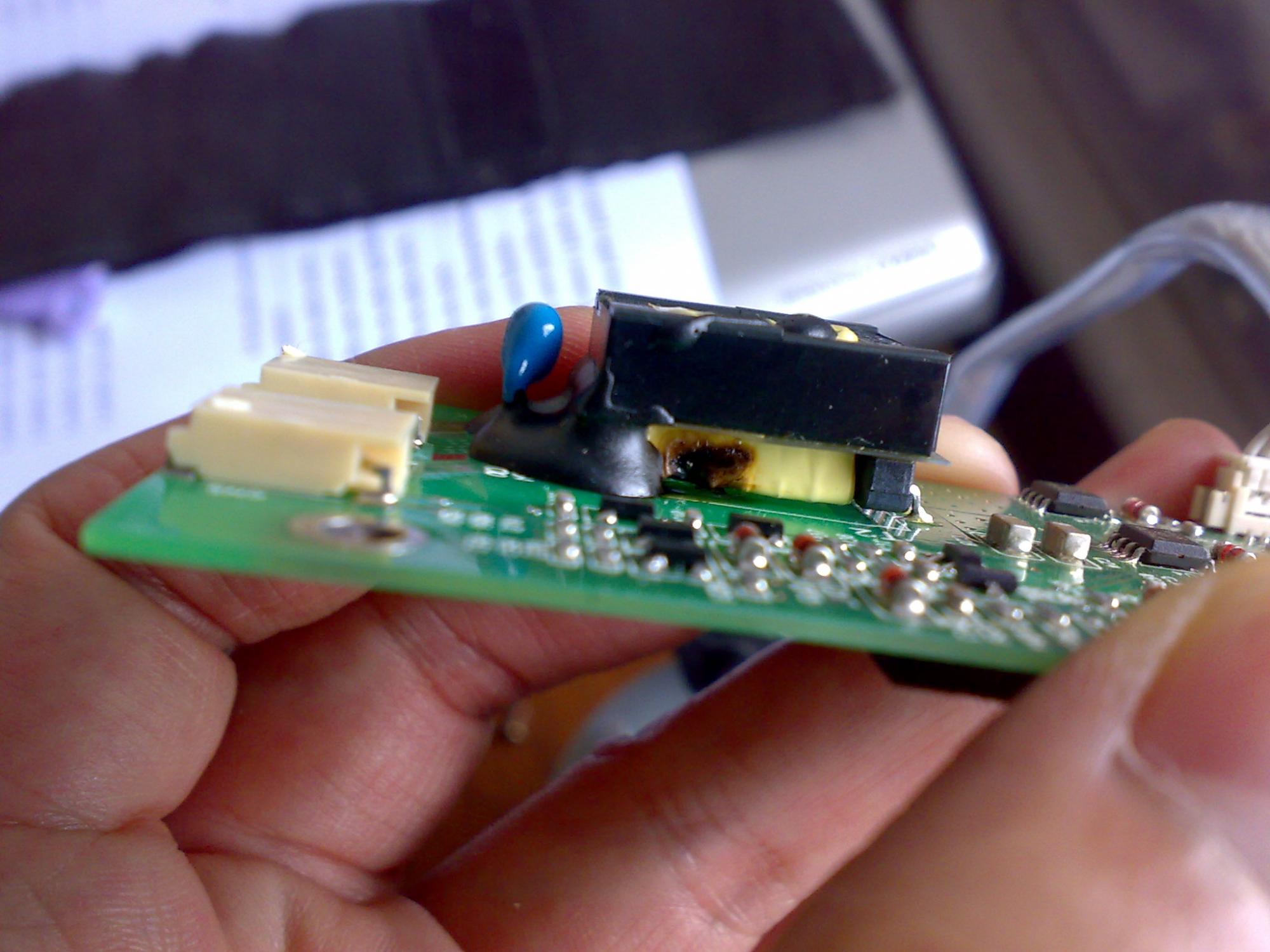

                                  I have two 1703FPs, 2 secs to black symptom, both of them have Li-2070, with a burned transformer on each, took out a SIC1803 inverter from a 1702FP, and did fix the problem.
                                  Those transformers have some tough plastic glue really difficult to disolder.

                                    Dude, very nice pics. Great job. That will indeed help people. As for myself, I now hate Dell monitors more than Samsung.

                                      Strange that the transformer that has burnt out on the firt pic is the exact same one that i had to change be interesting to hear from others if the transformer is the one that has gone on theirs not that it probably makes a lot of difference but its the one closest to the psu board
