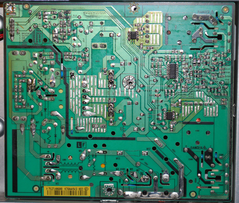

                  Hi guys, much searching and some testing and I'm a bit stuck. I have this monitor and the backlight goes out after a 2 seconds.
                  Here's what I've done so far:
                  I think I eliminated a bad CCFL by unplugging one at a time and turning it on. Same problem.
                  I've followed this flow chart in the service diagram and it all seems to check out.
                  I'm not sure if my results are any good though as I've not desoldered anything from the board, and I'm getting a 1.7ish volts reverse voltage on a couple of the diodes and transistor junctions.
                  Also when it said about instantaneous pulse I just stuck the dmm on dc and there was definitely some "pulsey" potential going on in there.
                  Am I going about this all the wrong way? Not done any electronics for quite a while and most of that was telecomms based.
                  p.s. I'm using a Fluke 25 I can get a 'scope from work but I'd rather not lug it home and set it up on the dining table if I can help it!
                  As an afterthought, I'm testing this with the CCFLs and the panel NC, is that going to put a spanner in my works? And there is no green light! I have a blue/orange one on the bezel but I thought there may be one on the PCB somewhere. Should there be?
                  Errr... I'm poking holes in my testing quite a bit here, I measured the inverter transformers just for resistance, they were the same and not a large number.

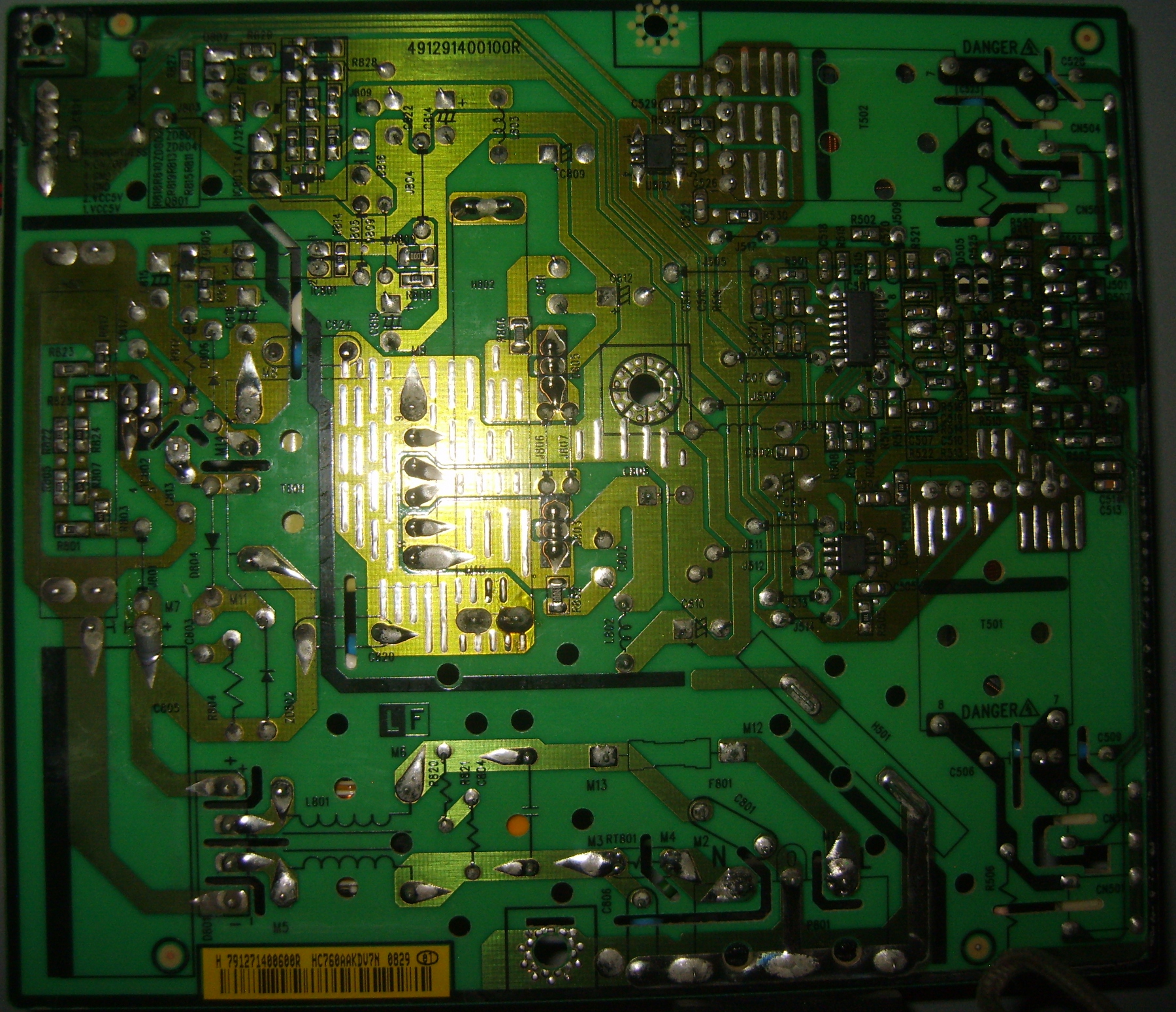

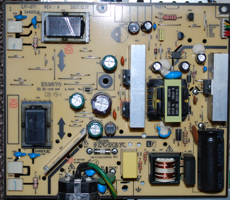

                          • woody_294
                            • Jan 2011
                            • 2
                            #53
                            Re: inverter problem in LG 1934S LCD flatron
                            Thanks guys for pointing me to all that useful stuff! I think I'll make much better progress when I get going this time!
                            For reference and any further questions I ask, some photos and info:
                            Also the ICs, IC501 is an OZ9938GN
                            U501 and U502 are both a P6006HV
                            I have the photos in a much larger resolution but I though 800px wide would be enough, let me know if it's not
                            Thanks again all, great replies!!

                              If you haven't done so, try measuring the resistance across the inverter transformer secondaries (marked 7 and 8 on the circuit board) for transformers T501? and T502? Should be no more more than 3% difference in your readings.

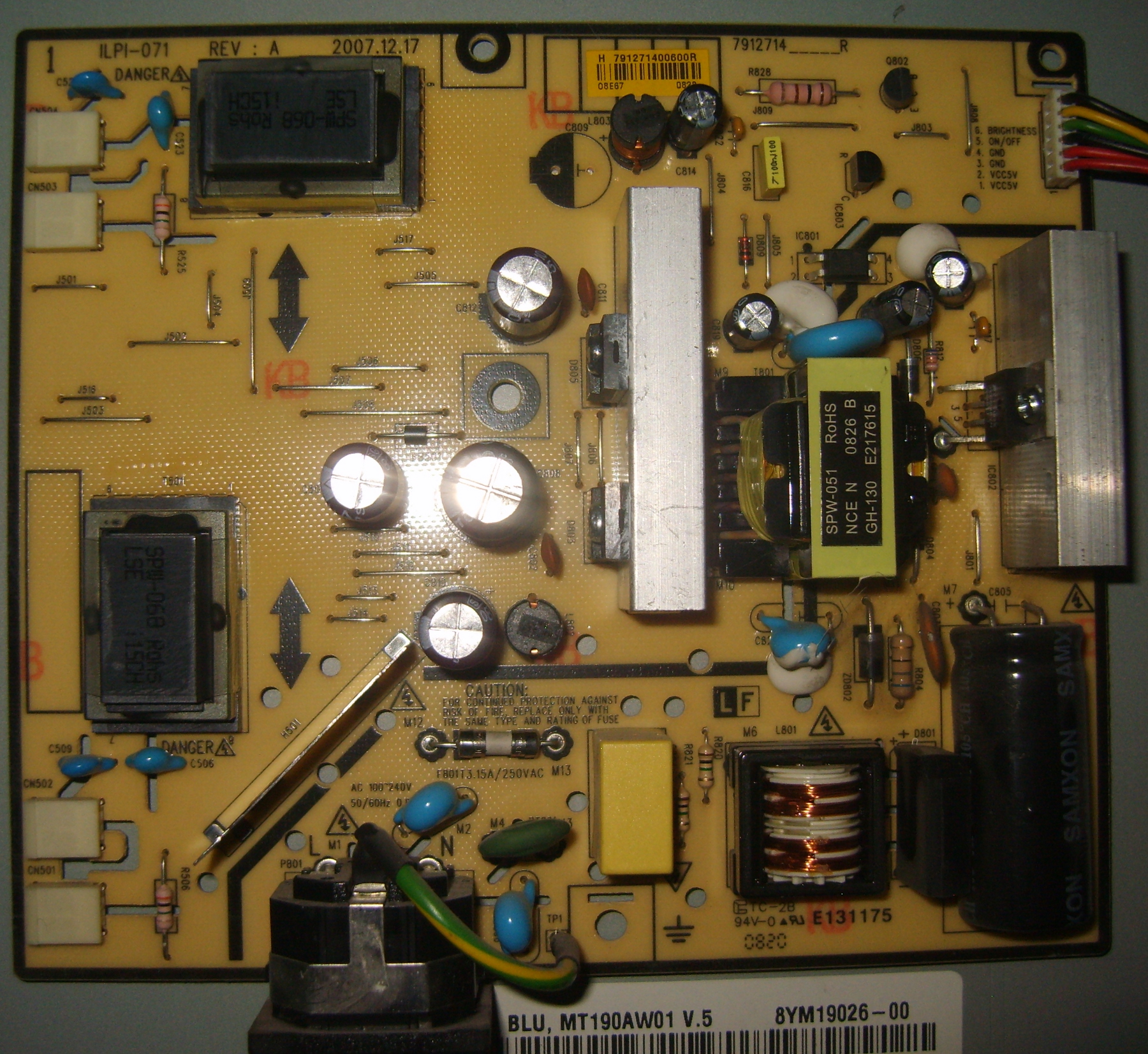

                                I have the similar problem with the monitor mentioned it the first post of this thread LG Flatron W1934S.
                                Few days ago it suddenly went black while the blue light still lit indicating that it is turned on and connected to power and video source. I tested it with different cable and different machine, different OS, but the result was the same. So it is definitely a monitor problem.
                                In detail:
                                After turning the monitor on it goes fine for about 15-20 min. and then goes black. It usually goes black when bright colors are displayed. Also I noticed that when I set brightness (in the monitor settings) to the lowest value, it will work then for 1 to 3 hours. But after that it still goes black with blue light at the bottom still shining. Then if I turn it on again it displays for a few seconds flashes (bright, low bright and again bright) and goes black again. If I wait about 20 mins I can use it again for 1 to 3 hours at lowest brightness.
                                I think it could be a component that heats up too much and then shuts off. I haven't tried to take it apart yet.
                                So I am waiting for any help anyone can offer.
                                Thank you in advance

                                    Ok. I have disassembled the monitor. It was a bit tricky to open it up even after looking at the service manual. So, the board seems to be without any visible damage.
                                    I have already looked through the troubleshooting guide from the "jetadm123" post. I noticed then, that the 2nd pin of IC501 has not 5Vdc but 6.6Vdc. Is this normal? If not then what should I do next?
                                    If it is normal then I faced another problem. I checked the pin10 of IC501 for high level voltage? it is 4.2Vdc. The thing is that I am not sure what "high level" actually means

                                      While the pictures aren't great, they are good enough to confirm the caps LOOK good; of course appearances can be deceiving. They probably aren't the problem because of the time lapse between initially turning the monitor on and the backlights failing.
                                      I'm afraid the next most likely suspect is the CCFLs, but let's try an easy test first. T501 and T502 are the inverter transformers. Pins 7 and 8 are the secondaries on each one. Measure the resistance between pins 7 and 8 of T501 and between pins 7 and 8 of T502. They should be about 1K, and must match to within 3%. Report the numbers.
                                      I'll look up the information on the voltages at IC501. That may well be a clue as to what is going wrong.
                                      I just reviewed the schematic; that clears it up slightly. Pin 2 is the Power pin of IC501, pin 10 is Enable. In this context 'high' means 2.2 volts or higher. The problem is the troubleshooting guide covers NO backlights, you have a variation of 'two seconds to black', so we know most of the test points (Power, Enable, are good).
                                      One additional simple test. Does the screen have a pinkish tint when it is first turned on, particularly if it's been sitting off for more than an hour? This tint may last for only a few seconds.
