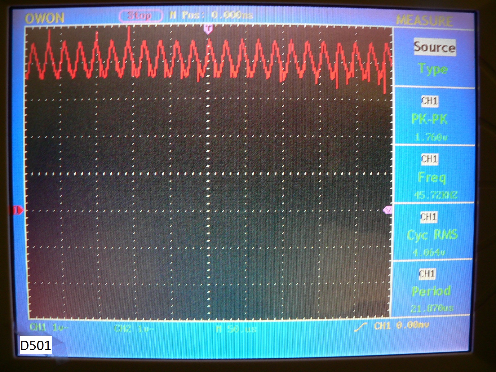

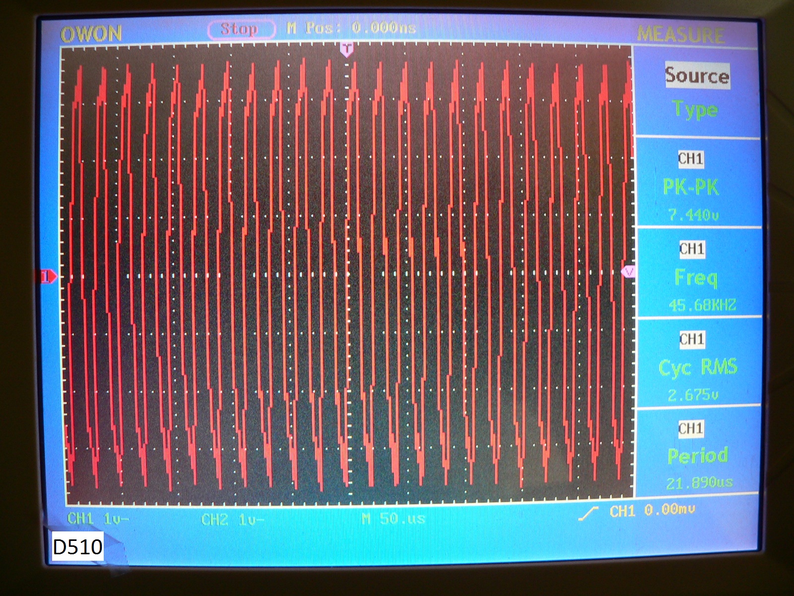

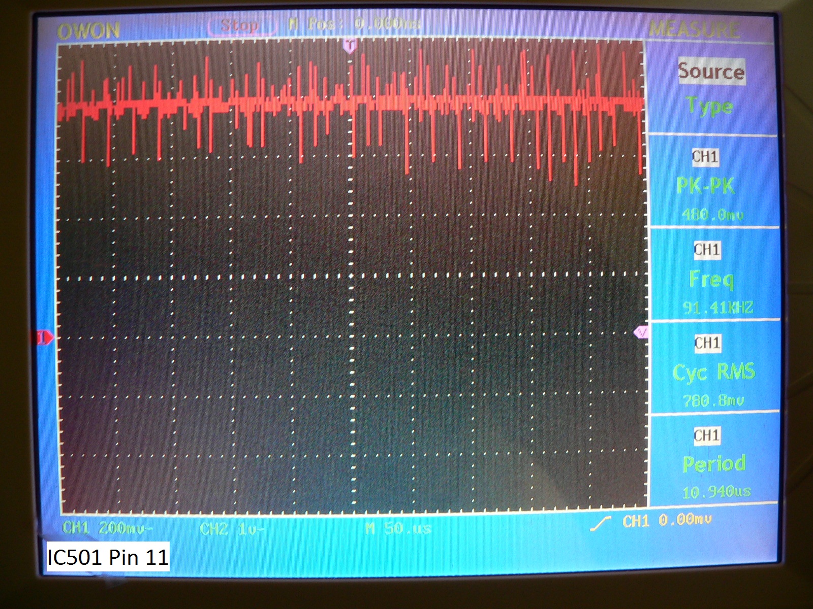

      Here are the results:
      • D501: Pk-Pk = 1.760v, Freq = 45.72KHz, RMS = 4.064v
      • D506: Pk-Pk = 2.400v, Freq = 45.56KHz, RMS = 663.3mv
      • D510: Pk-Pk = 7.440v, Freq = 45.68KHz, RMS = 2.675v
      • IC501 pin 11: Pk-Pk = 480.0mv, Freq = 91.41KHz, RMS = 780.0mv

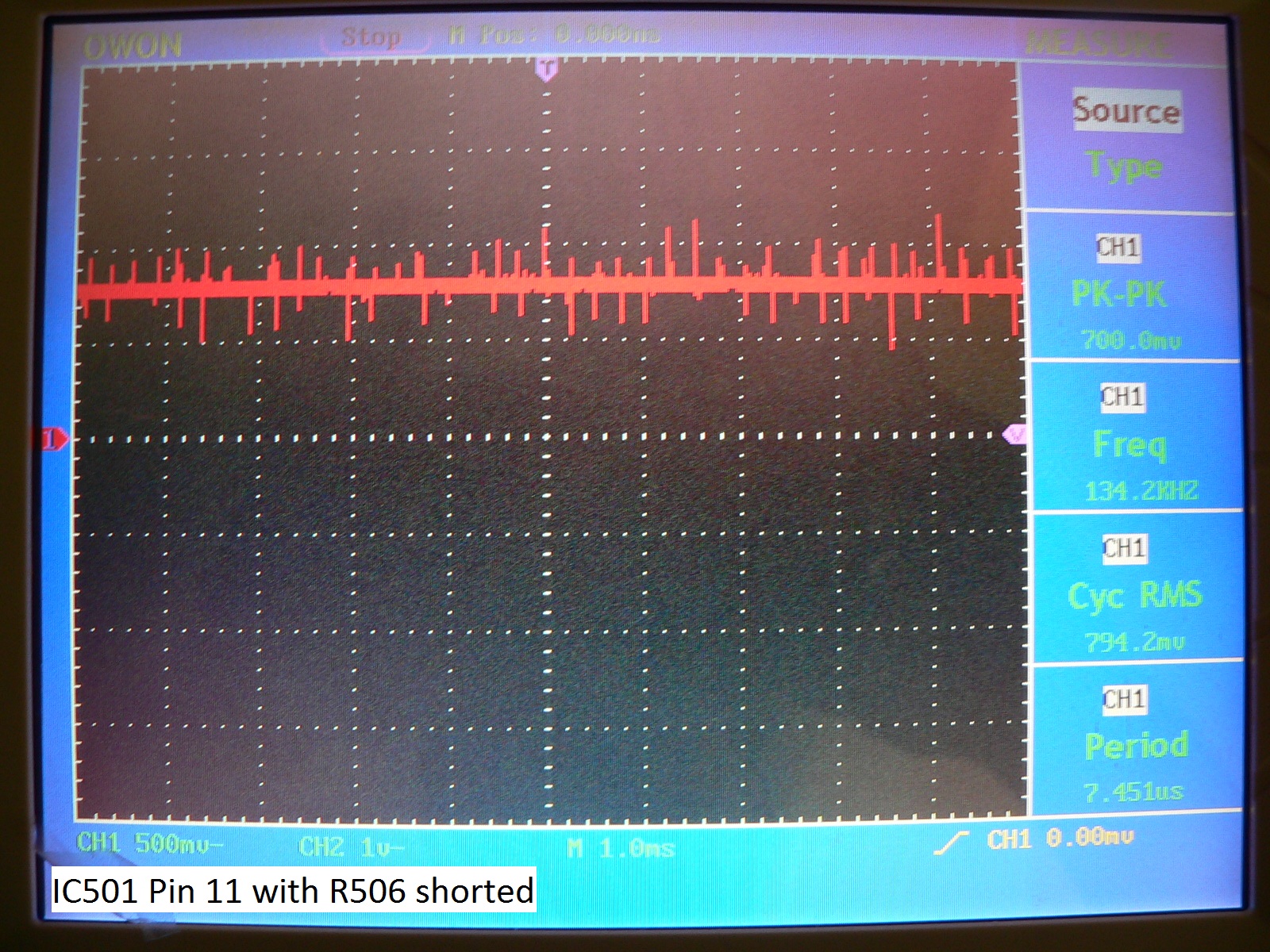

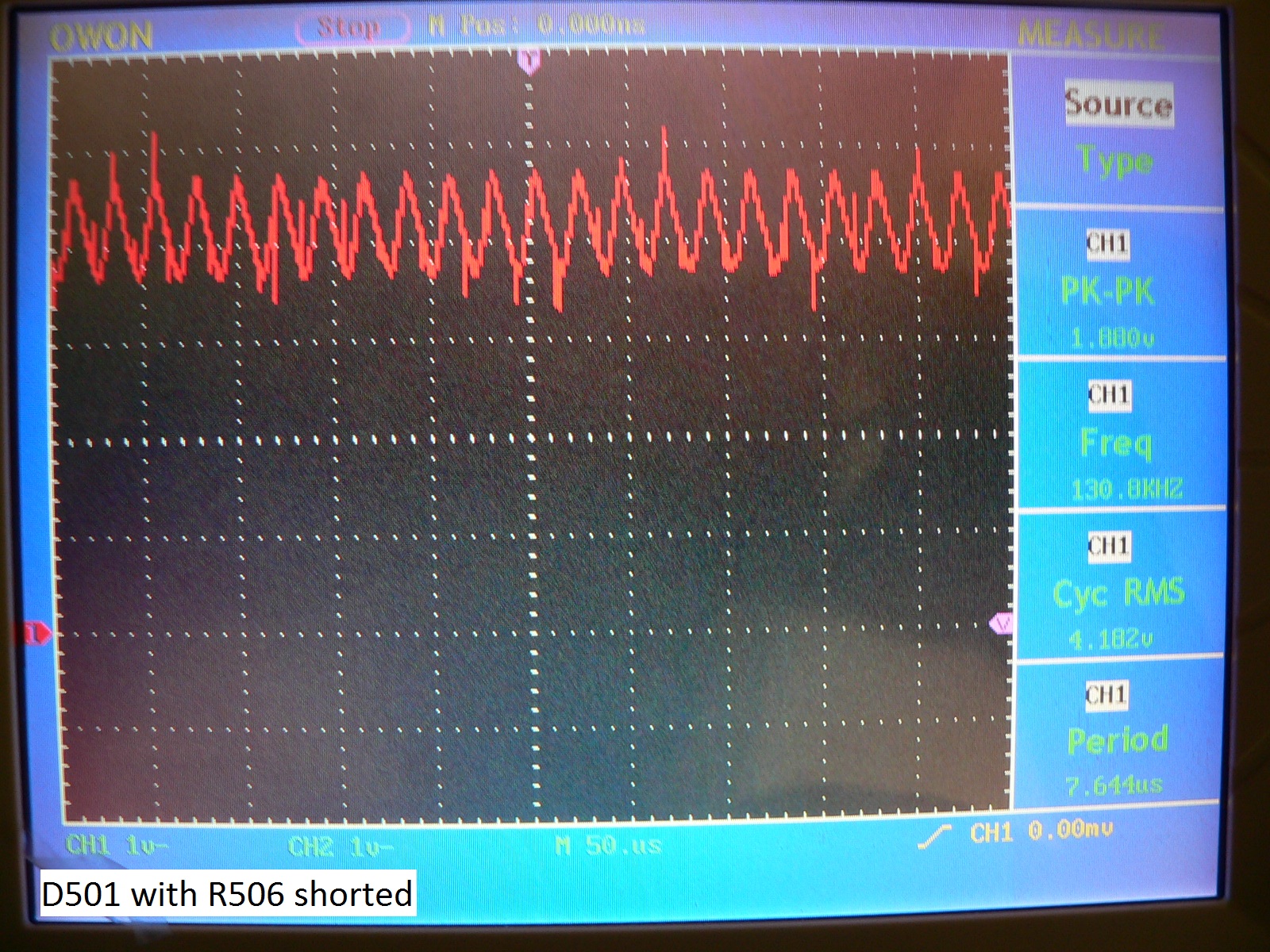

      Again, this time with R506 shorted:
      • D501: Pk-Pk = 1.880v, Freq = 130.0KHz, RMS = 4.182v
      • D506: Pk-Pk = 2.240v, Freq = 66.25KHz, RMS = 700.9mv
      • D510: Pk-Pk = 7.920v, Freq = 45.63KHz, RMS = 2.889v
      • IC501 pin 11: Pk-Pk = 700.0mv, Freq = 134.2KHz, RMS = 794.2mv
      Images are again attached for reference. The view settings are not all the same, if you're looking at the waveforms; I think the offset ones are only offset by 1 div. I'm not sure what to make of the differences in frequency measurements between having the end of resistor R506 shorted to ground, and leaving it alone. The scope seems to have trouble measuring the frequency of the short pulses the backlight stays on for when the resistor is not shorted, but it's possible (maybe?) that the frequencies actually are different during that very short time right after the inverter turns on.

        These numbers seem to confirm what I suspected, D506 (OP1) and D510 (OP2) should have approximately the same voltages. Compare the resistances across R524 and R527; they should match to within 5%.
