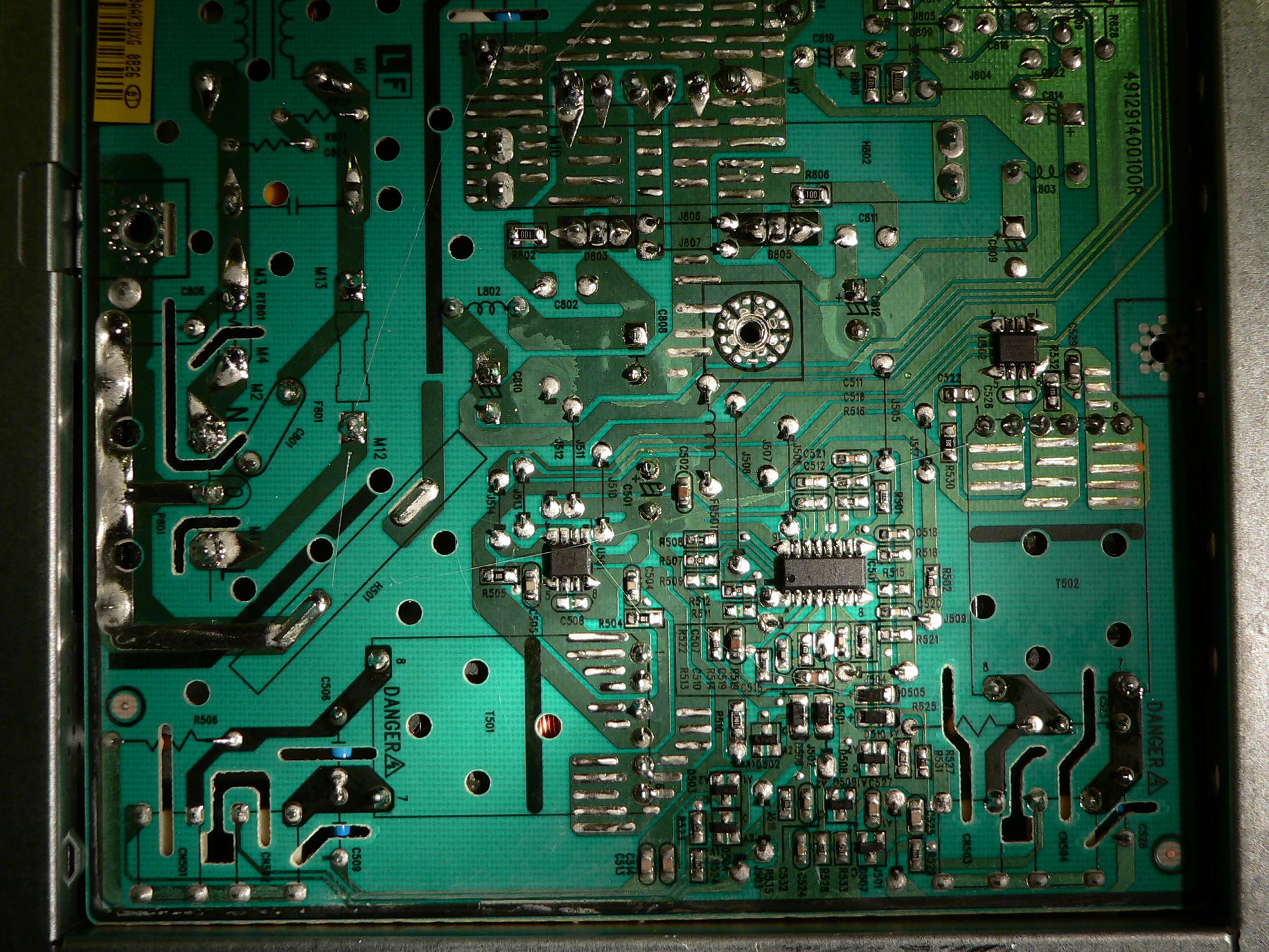

                    You've done an excellent job of troubleshooting . You've established the problem lies with the inverter, not the CCFLs. You are also correct, it's not due to a problem with a fuse.
                    Breaking the problem down, there are two possibilities. The drive voltage to one set of CCFLs is wrong, or the circuitry sensing the voltage / current has a defect.
                    Your troubleshooting of the inverter controller was good, but you did not go far enough. If you look at figure 1, the protection logic control turns off the FET, allowing the cap on Timer (pin 3) to charge, shutting off the inverter. If you look at the application drawing (figure 2) in the OZ9938 datasheet you will see that the voltage at Pin 6 comes from the circuits feeding D2 and D4. C22 filters the pulses, R25 provides pull down. Unfortunately, while the picture of the bottom of the board is excellent, I can't quite trace the actual circuit. However, there is another approach. Note that D2 and D4 in the app note form an OR circuit. The voltage at pin 6 will exceed 3 volts only if one (or more) of the voltages at the anodes of D2 and D4 exceeds about 3.5 volts.
                    Referring to the picture of the bottom of the board, with the CCFLs operating, measure the voltage at the following points:
                    Left end of R506
                    Bottom end of C509
                    Left end of R525
                    Bottom end of C528? (blue cap, lower right hand corner of the picture).
                    If you are unable to measure the voltages reliably, instead ONE AT A TIME short each of these points to ground. The one which results in the backlights staying on is the culprit. Report the results, we'll carry on from there.

                        Thanks for the suggestions. The backlight comes on and goes off again twice after I push the power button. The first time the enable signal to the inverter IC goes low and the backlight turns off. A second later, the backlight turns on again for about half a second then turns off; the enable signal to the inverter IC stays on this time (this is where I think the problem is). Also I did find a surface-mount fuse near the connector to the display board (CN801). It's F802 (4A, 32v) and it's fine. I checked U501 and U502, and found that none of the pins are shorted.
                        Thanks PlainBill. I think I sound like I know more about this than I actually do. I went back and took some more readings and found that the voltage from the power supply is about 13.7v when the inverter is running, which is pretty close to the 14v mentioned in the service manual. I also re-measured the voltage at the CCFL returns, and found that two are higher than the other two.

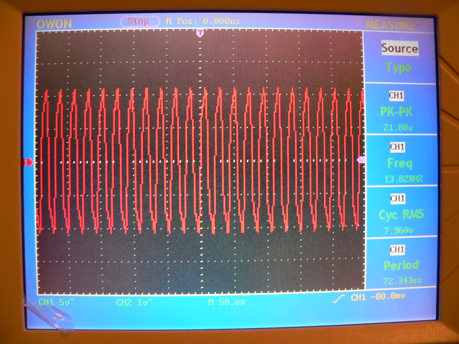

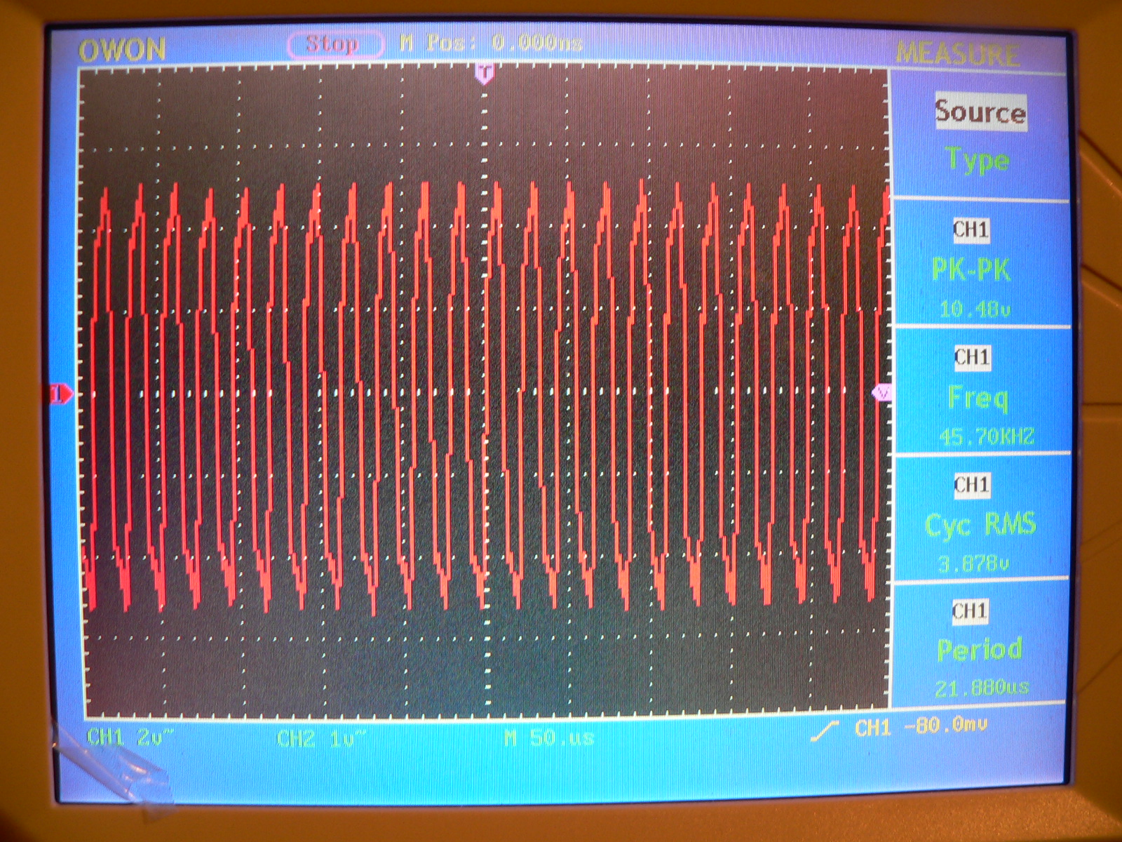

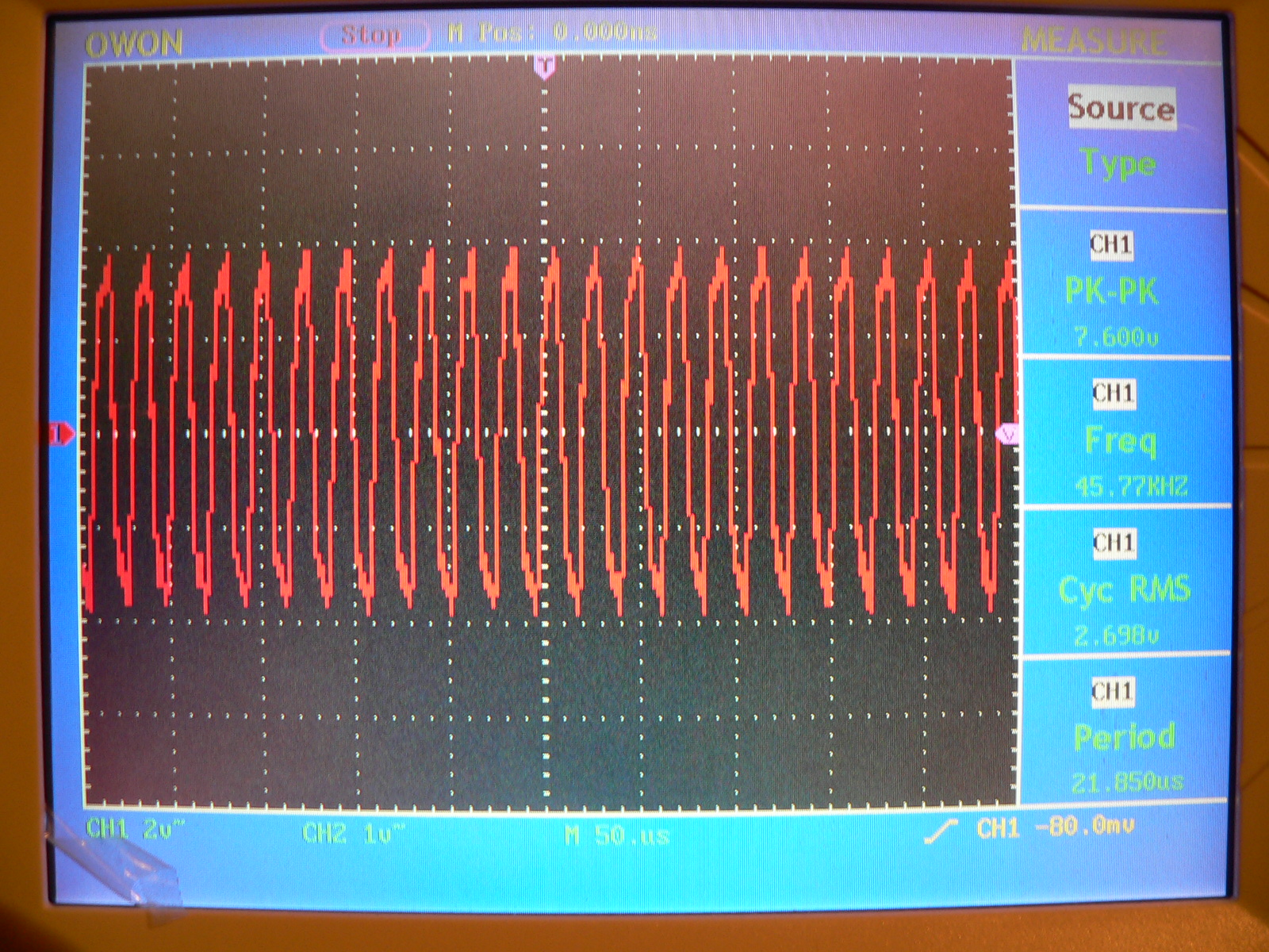

                                    I re-measured the connectors with my scope tonight, and I don't quite believe the readings. Hopefully this is due to my less-than-stellar job of re-attaching R510, but everything except CN501 measures really high. I had 32mv, 2.3v, 58mv, and 600mv for the 4 connectors last night. Tonight (after removing and replacing R510):
                                    • CN501: Pk-Pk = 2.280v, RMS = 687.0mv
                                    • CN502: Pk-Pk = 21.80v, RMS = 7.960v
                                    • CN503: Pk-Pk = 7.600v, RMS = 2.698v
                                    • CN504: Pk-Pk = 10.48v, RMS = 3.878v
                                    I'm attaching pictures of the scope screen for each, which provides a little extra information.
                                    I'm beginning to wonder is Shakespeare was right. "The fault lies not in the stars, but in ourselves." Or something like that.
                                    That could absolutely be true. Don't discount the possibility of a case of operator error somewhere in here - I haven't had any training. I do this stuff as a hobby and most of the monitors I fix (Samsung) just require capacitor replacement and they're fine. I've got two models giving me trouble right now (this one and a Samsung Syncmaster 940T), and I've been dragging my feet about getting them fixed because I had no idea how to go about troubleshooting them.

                                      Re: inverter problem in LG 1934S LCD flatron
                                      Yes, it does, and it provides plenty of questions, too. I hope you don't mind, but we are going back to the basics on this for a few minutes. The most significant thing I see is the frequency on CN502 is shown as 13Khz, it's about 45Khz on the other connectors. From what I think I know about inverters, 45Khz is possible, 13Khz is flat out wrong.
                                      So to start at the beginning, what model Owon oscilloscope do you have? What kind of probe are you using, and where are you connecting the ground lead for the probe? And it appears you are using AC coupling, switch to DC coupling.
                                      Next, I would like to see the traces at OP1, OP2, OP3. Probe the cathode ends of D506, D510, D501. Also, I'd like to see a trace for pin 11 of IC501. Clip the scope ground as close as reasonably possible to that area. Soldering a short piece of wire (resistor lead) to a ground point is a good idea.
                                      Hmm, another problem with SMD technology. No ready source of short lengths of pre-tinned wire.
                                      I had to go back to school to figure this out, but the impedance of C532 at 45Khz is 540 ohms. With the parallel resistance of R535 I'd expect the voltage at CN502 to be roughly double the voltage at CN501.
                                      By the way, the purpose of the waveform at pin 11 of IC501 is to get a reference.
                                        The scope is an Owon PDS5022S (http://www.owon.com.cn/eng/pdsSeries.asp). The probe is a P6060 with both scope and probe set at x10. I just switched to DC coupling. I was attaching the ground clip to the case of the monitor, as the center screw hole is attached to cold ground and the board is screwed in to the case. I can try using another location, though it may be a little tricky.
                                        I took new readings but I don't have time to post the values right now; I'll get that done later this afternoon. I moved my ground position to the negative leg of C501 and used DC coupling. I have two sets of measurements, one with and one without shorting the end of R506 to ground to keep the inverter running long enough to properly adjust the scope and let it get a good reading.
