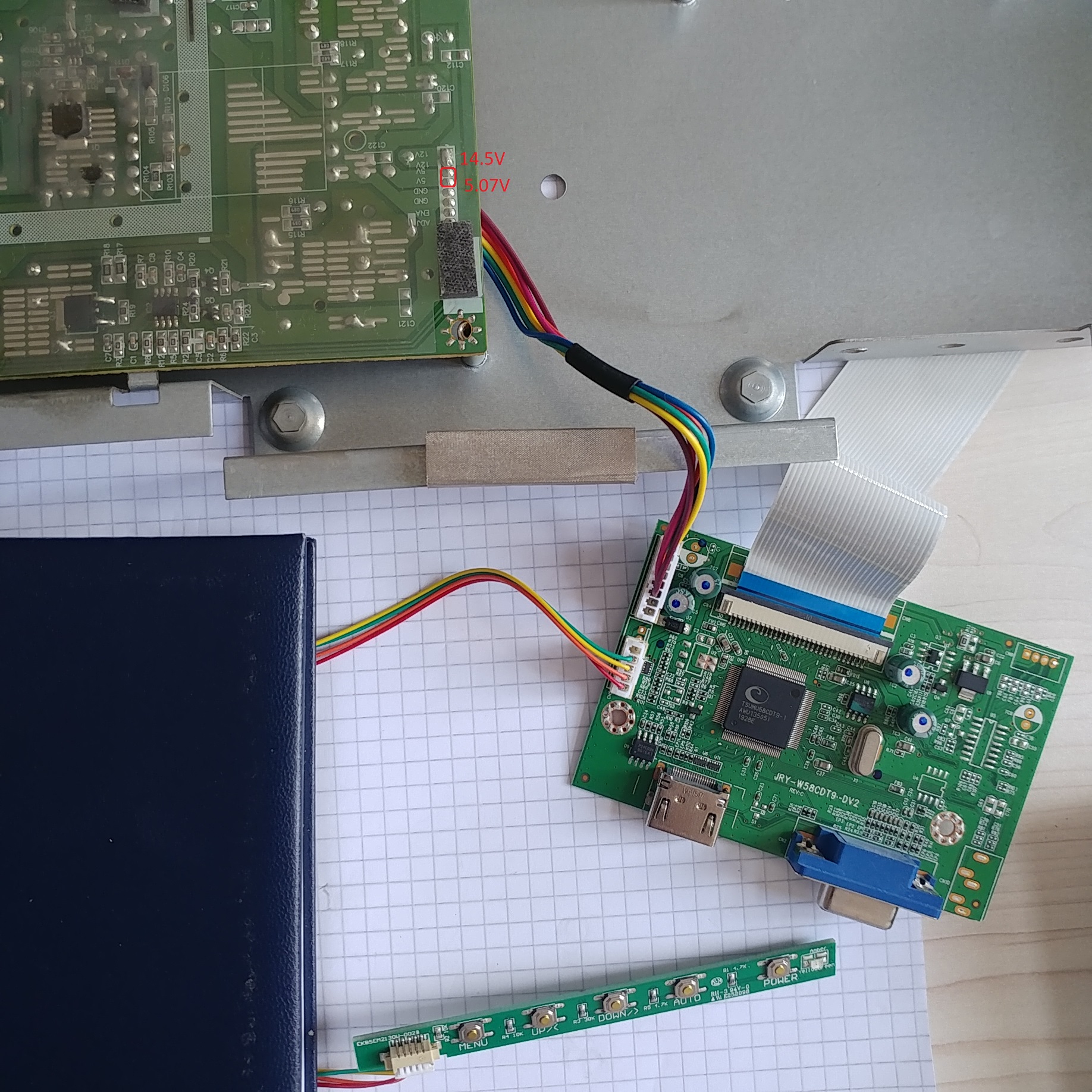

    Hello to all,
    I have a problem with monitor that is delivered together with CCTV system.
    The monitor appears to be completely dead, there is no LED power diode and it doesn't react to pressed power button.
    I have disconnect display and check many components on the power supply part of the board. There is no anything obvious and monitor is about 3 years old. There are no bulged caps. When measuring voltages on the output connector to VGA board I can measure stable 14.5 V on 12V pins and stable 5.07V on 5V pins. So I assumed that this part of the board is OK.
    I have found that on the power LED I have only about 1.4V and this voltage is not stable, it seems to fluctuate between 1 and 1.4V.
    I guess problem is somewhere on the VGA/HDMI board.
    Is there anything else I can check?
    I have attached the picture of the boards.
    Thank you.

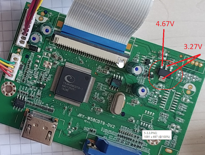

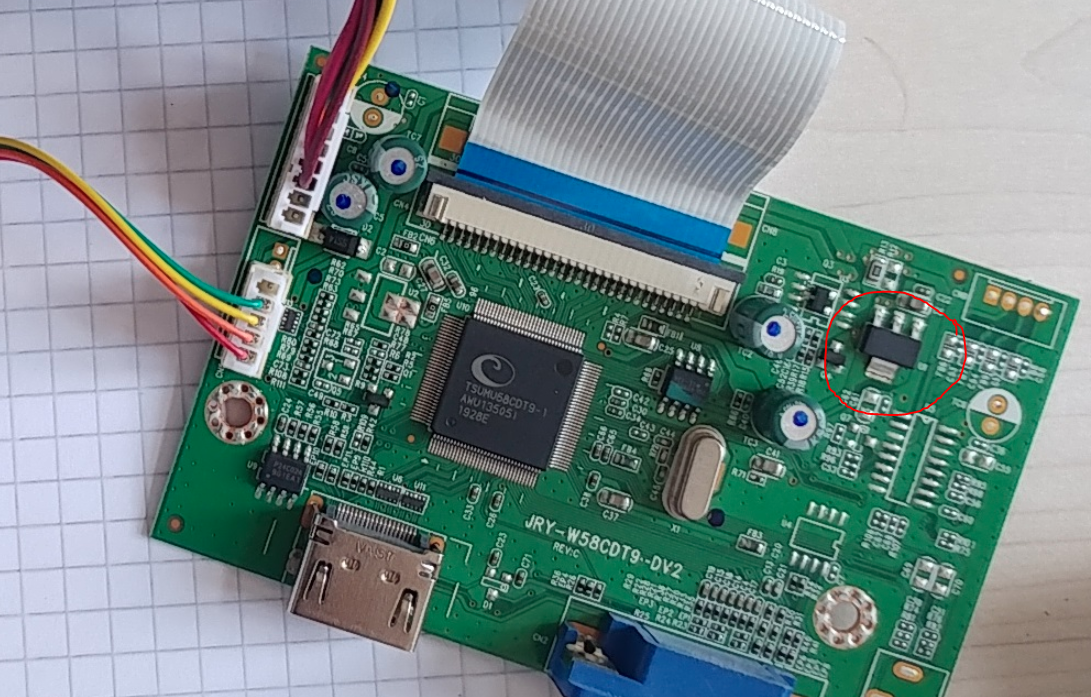

    There is a 3.3v converter on the board, 5v will come to it, and 3.3v should come out of it, is it there?

      Hi lotas,
      yes, input is 4.67V (not really 5V) and output is 3.27V just as shown in the attachment.
      Do I need to have a small LED light next to power button even if display is disconnected?

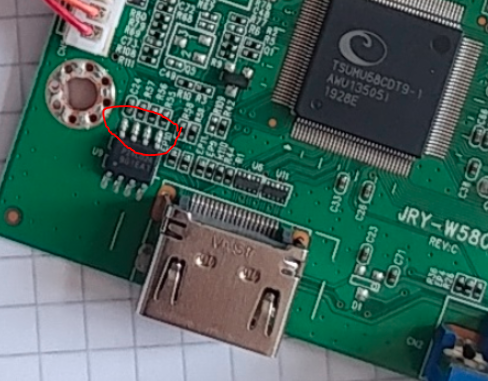

        The firmware can be built here, as well as the processor, if a discharge has arrived via hdmi, check for short leads on the protective diodes (TVS)

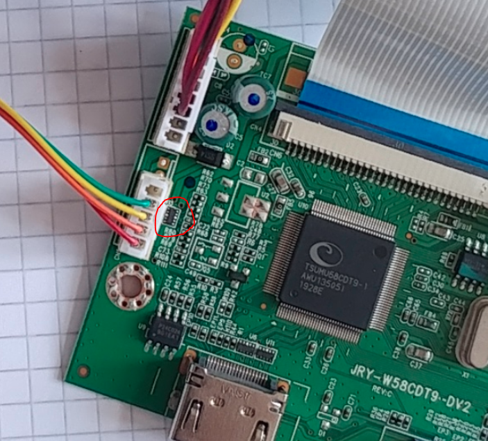

          This one can also suffer from static and the buttons will be in short ....

            Is there any way I can check these components you marked on the board (check resistance or check for short in the diode mode)?

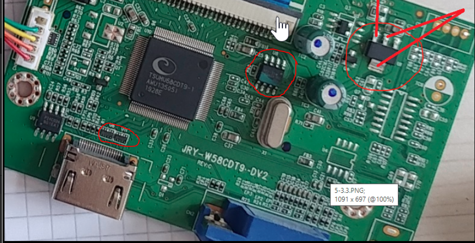

              There you can see the tracks that go to the processor (8 lines) for these diode assemblies, conclusions 1,2,4,5 relative to gnd in diode mode, you can also check for resistance.

                Also check these conclusions with respect to gnd.

                  Re: Problem with monitor DS-D5022QE-B
                  Thank you lotas for your advice, I have noticed that main processor becomes really hot if hdmi/vga board is connected to the power supply board. So for sure this board is dead. I have ordered a replacement board from ebay.
                  Thank you very much for the help.
