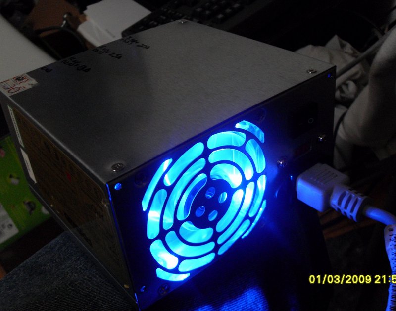

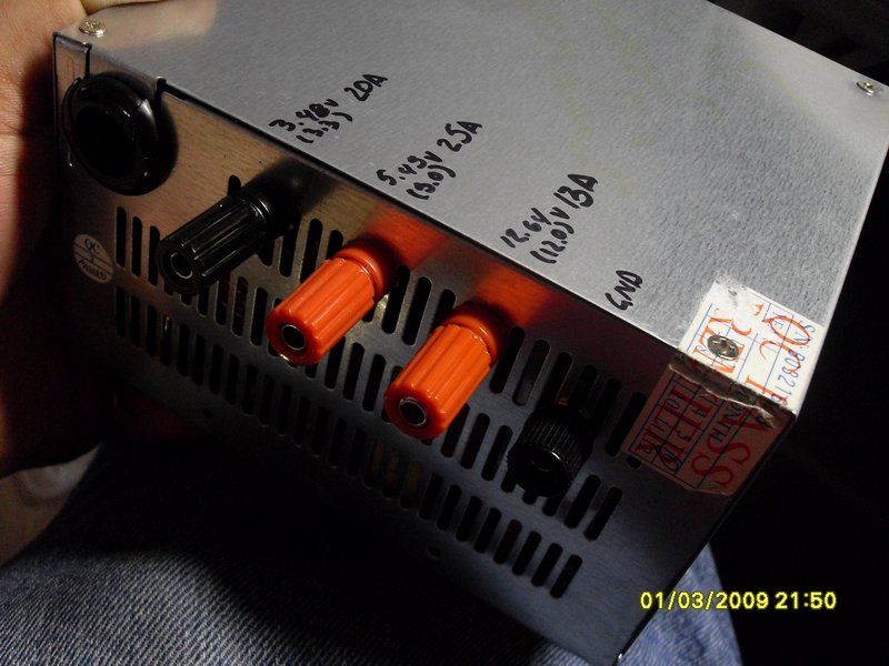

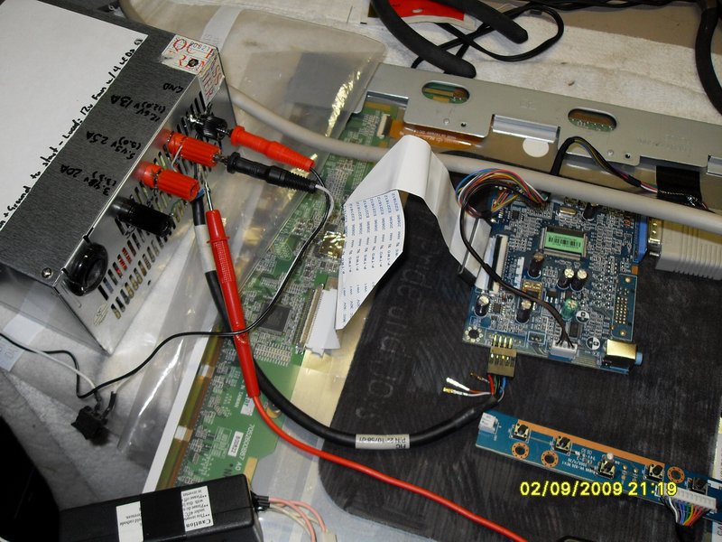

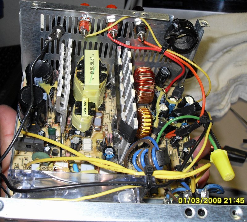

      Re: DELL e196fp 19" - Screen goes blank
      Originally posted by cmccul002
      Wow. lol
      What did you do to that power supply?
      1.- Recaped.
      2.- Removed all the output wires except the following ones:
      Black,Red,Yellow,Orange and Green.
      3.- Replaced the Standard fan with a 4 blue LED one, to provide a "LOAD" for the SMPS to work
      4.- Wired the ground and green wires together so when the switch is turned on, the PSU "starts".
      5.- Wired the 5v,12v,3.3v and GND to a corresponding banana post so voltages can be used.
      I use it to power on LCDs, use my "CCFL tester", and other applications. Due to the (somewhat) high amp rate of the output, it is really useful.

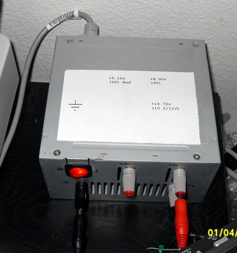

        nice psu i built one using an old ibm AT 200w psu. put 10 ohm 25w res across the 5v rall to act as load used 25w as its in a fined ally case and panel mounter so the case works as heatsink used AT unit as then no need to worry about the power on wires
        loads of stuff on the web
        ***** just remember no current limiting on pc psu's **********
          I have another one built from an AT PSU.
