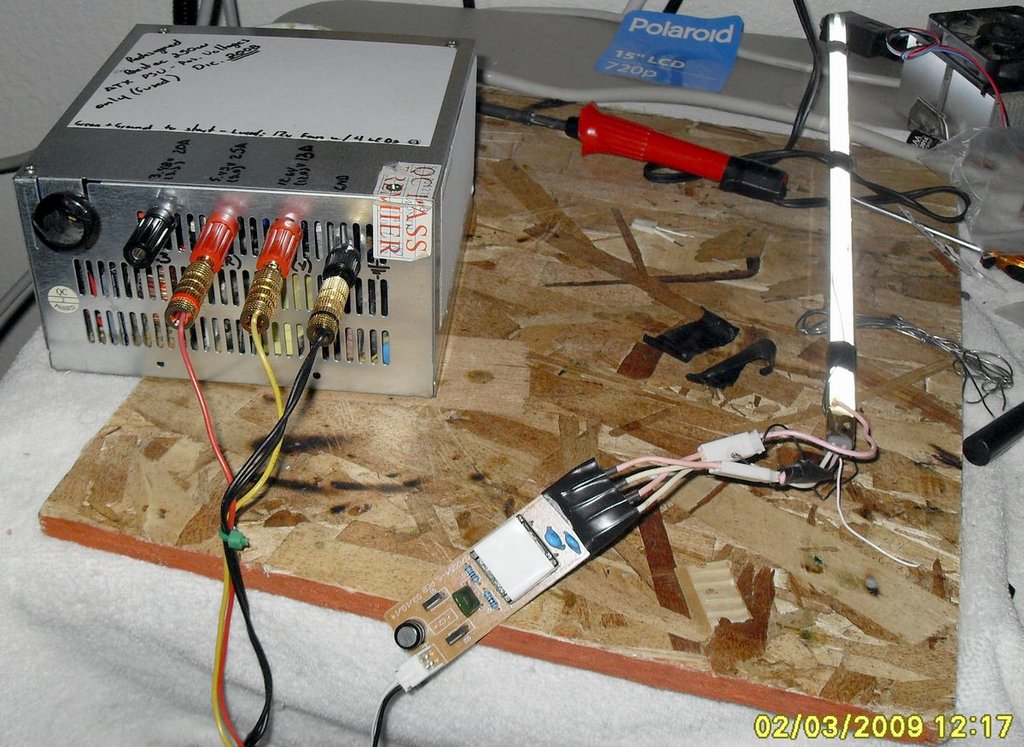

    This is a common problem. It is sometimes called the 'two seconds to black' problem. There is no one cause. A brief description of the operation of the inverter and backlight will explain the problem.
    When the monitor is powered up the logic board turns the inverter on. For the first few seconds the inverter controller runs the CCFLs at full power. It then begins to check for fault conditions. Possible faults include CCFL voltage too high, CCFL current too low, CCFL current too high. If ANY CCFL exhibits any of these problems the controller turns off the backlights.
    Possible causes include bad capacitors in the power supply or the inverter, broken CCFL, open or shorted transformer in the inverter, failing CCFL, shorted diode, bad transistors, bad solder joints, etc, etc.
    One possible approach is to buy a case mod light kit (2 CCFLs and an inverter) and use the inverter from the kit to test all of the CCFLs in the monitor. The CCFLs from the kit can be used as test loads to check the monitor's inverter.
    Finding replacement inverters tends to be difficult, and expensive when you do find them. Posting better pictures (front and back) of the inverter would help us help you.

                                You may have bad lamps in there. Try suggestion in post #2 - I test the CCFLs that way.

                                      Will any case mod light work? Like this one?
                                      http://www.crazypc.com/products/8240W.html
                                        That's almost the same model I have - dual output, pass-thru molex connector. I just modified it a little bit
