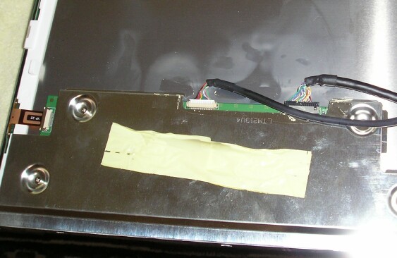

    I picked up this oldie as a Freecycle freebie. Replacing an open fuse in the inverter fixed most of the problems, so I put it to work on my desk. Gradually I became aware that the display was not working properly. Specifically, on a dark green background two broad (about 1") lines ran 2/3rd of the way across the screen. It was not noticeable on a white background, but was barely visible on a blue background. The first cause that came to mind was the CCFL backlights (something had to blow that fuse, right?)
    Opening up the case and isolating the LCD panel itself was easy, but now I'm into unfamiliar territory. The panel seems to be built on a stainless steel frame. Everything seems to be held in place with a white plastic back frame with four 'catches' on each side. These latch into slots in the front frame. There are four screws of unknown purpose on the front of the metal frame. Of course, there is also the cover over the electronics section of the display.
    So how do I disassemble this without breaking something?

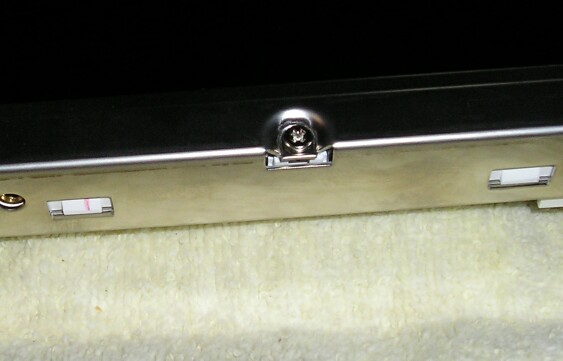

            if problem is with backlight unit, you can disassemly carefuly, but be aware any dust will easily stay inside backlight films
            face down lcd on soft cloth, remove four crews, and the cover
            then use flat screwdriver to unlatch catches
            then turn over lcd and carefuly remove metal frame
            lcd panel is probably sealed together with plastic frame, you can carefuly try on edges with flat screwdriver to pull, try to avoid touch panel with fingers inside but you must remove lcd from plastic frame
            then you have only backlight assembly (diffuser thin plates and one thick), i have reassembled many but always was dust reamined inside them
            i had only problems with bad ccfls
            sorry for bad english, if i can help with some photos i can help tomorow at job...

              maybe this picture can help you
              middle chassis is plastic frame, be aware that this is for lcd tv panels but with lcd monitors you only have two pair of ccfl, up and down

                  No need for pictures, etc. I figured it out nearly a month ago. I'm using the monitor right now.

                        This is the first LCD panel I disassembled, so I don't know how others do it. Samsung makes this panel. It uses 6 CCFLs, three at the top, three at the bottom. The CCFLs are arranged side by side inside a C shaped 'cartridge'. This is a piece of light steel that has been painted white for reflectivity. They are held in place by running the leads through silicon rubber fittings at each end of the cartridge, and several spacers along the length of the tubes. The leads from the 'hot' end of the tubes goes directly to the inverter. The leads from the 'cold' end of the tubes run along the back of the cartridge, then are bundled with the hot leads inside heat shrinkable tubing, where they connect to the inverter. By removing 4 screws on the front of the frame, carefully loosening the latches holding the plastic and metal frames together, then removing a very tiny screw which anchors the cartridge to the metal frame, it is possible to remove the cartridge as an assembly.
                        When I pulled the bottom cartridge from my monitor I discovered that the end of the cartridge was discolored under two of the tubes. On the back side of the cartridge the silicon wires were obviously overheated, and there was a 1/4" length of uninsulated wires that could contact the metal. When I replaced it with a cartridge from a monitor that had a few nicks in the covering the dark lines were greatly reduced. It's not perfect, but it works very good for a $12 monitor.
