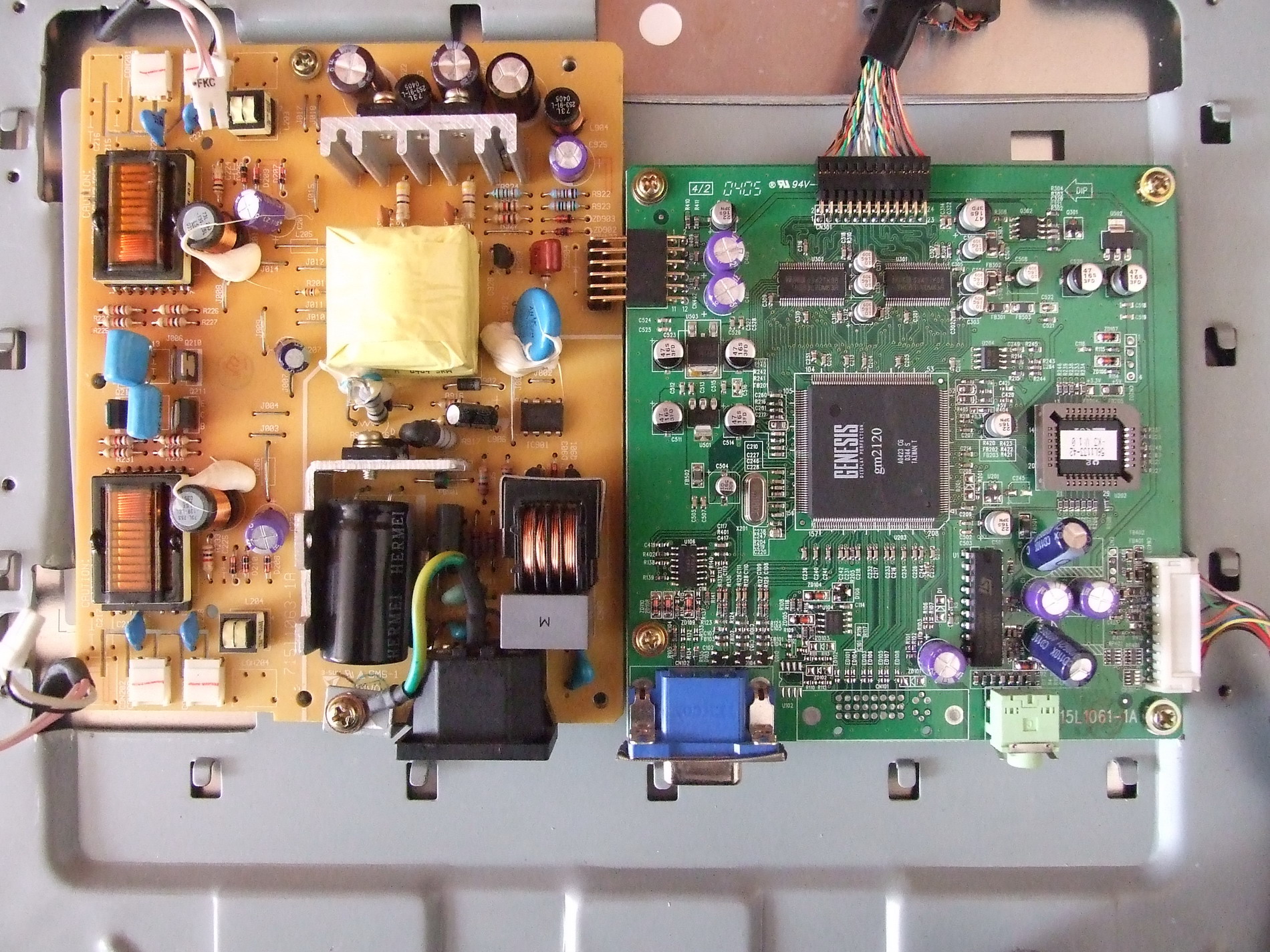

    Hi guys,
    I have recently got Fujistu-Siemens monitor named “LCD Color monitor B17-1”.
    Main problem is that when I trun it on, it shows Fujistu-Siemens logo and sometimes after that dimm picture. Power led the truns green, but with no picture. Even if I shine strong light on the screen Im not able to see anything. Maybee Im wront but it seems to me that it is signal board problem. Have you some suggestions what to do? Is it really bad signal ICB? I have opened it, but there weren't badcaps at all (not swollen nor vented). The 5706's were ok. No obvious solder cracks.
    Pictures of boards included.
    I'm quite hopeless, so I would be glad for any suggestion.

    Re: Fujistu-Siemens LCD Color monitor B17-1 strange problem
    Promissed pictures.

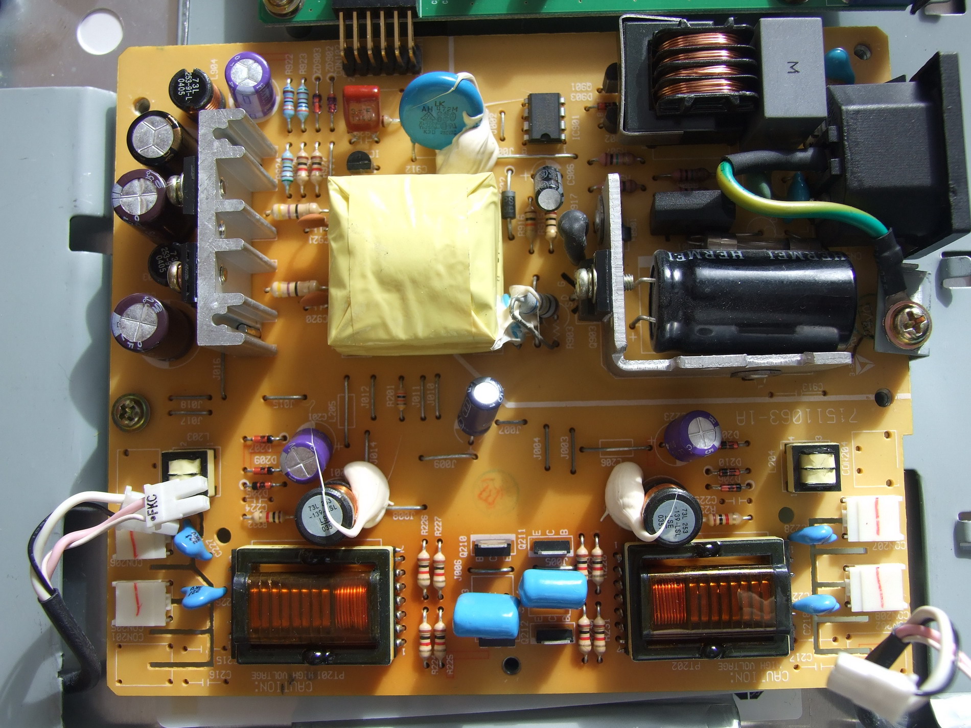

      Hmm - Hermei and Su'scon caps. They can be bad, especially the larger ones near that heatsink. It wouldn't be too surprising if they measured high ESR even though they aren't bulged. I'd replace the 4 caps next to the heatsink, even if they aren't bad now, they will be soon.
      • kc8adu
        • Nov 2003
        • 8832
        • U.S.A!
        change the 4 around the secondary heatsink.
        change all the purple hermei on the power board.
        esp the 2 close to the inverter.
        resolder the ccfl transformers and the 5706/7's
        and the 2 blue caps in between.
        • dvorav
          • Oct 2008
          • 43
          Hi to all,
          here is conclusion of this case: I have changed almost all caps, with exception of those purple ones near transformators. Surprice! It worked!
          Thanks a lot! Your are really pros, guys.

              Same here, just fixed two FSC P17-1 showing exactly the same symptoms this thread is about. Thanks a lot for offering such profound information
              I actually replaced C922 & C923 with 1000 uF / 25V as well as C924 & C925 with 470 uF / 25V (all were HERMEI ...) and resoldered as adviced. Works like a charme now with just a minor problem left: one screens OSD says 'locked' - which for sure wasn't before. Any ideas on this ???
                    Check Q210,211.212,and 213 as these are the normal cause of problems, as a pair of them normally go short circuit.
                        this picture shows the card of my monitor
                        thanks to all
                                  One of the tuning caps (blue caps next to the C5706/5707) looks like it is bulging from the side, you should check its value and for any resistance leakage, if it is bad, it will take out the transistors.
                                        Forget the 7c. you need 180nanofarads(184) 5% tolderance(J) at 250Volts.
