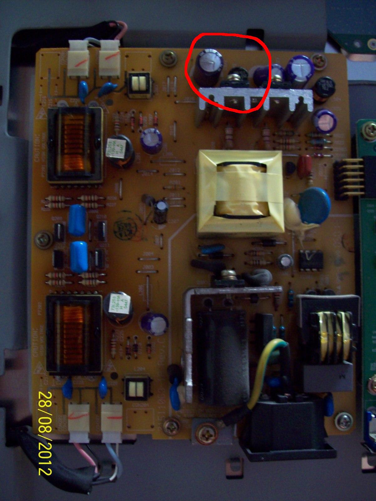

                                  #36
                                  Re: Fujistu-Siemens LCD Color monitor B17-1 strange problem
                                  You will be using this section to power the lamp tester inverter.
                                  Can you post the picture of the bottom side of the board in that red circle?
                                    Hello budm! Thank you for your answer. Soon I will buy the lamp tester. I changes the 4 caps (in red circle), 2 caps and 4 transistors but the monitor's imagine is black. What would you suggest me to control?
                                      So ..... I did just a beautiful mistake ....... but proceed with caution.
                                      Having 3 monitors identical (the same brand and model) and having one repaired successfully thanks to your support to try to repair this one I felt so proceed, namely:
                                      Removed the card working power and put under another monitor I'm trying to fix and everything works fine.
                                      I did this test to see if it was a problem of lamps or the video card, but fortunately it is only a problem on the Power Supply board.
                                      I reinstalled the power supply board monitor in its original and does not work!!! and as if trying to turn on but it goes in a loop and feels ta ta ta .....
                                      What have I done??
                                      thanks
