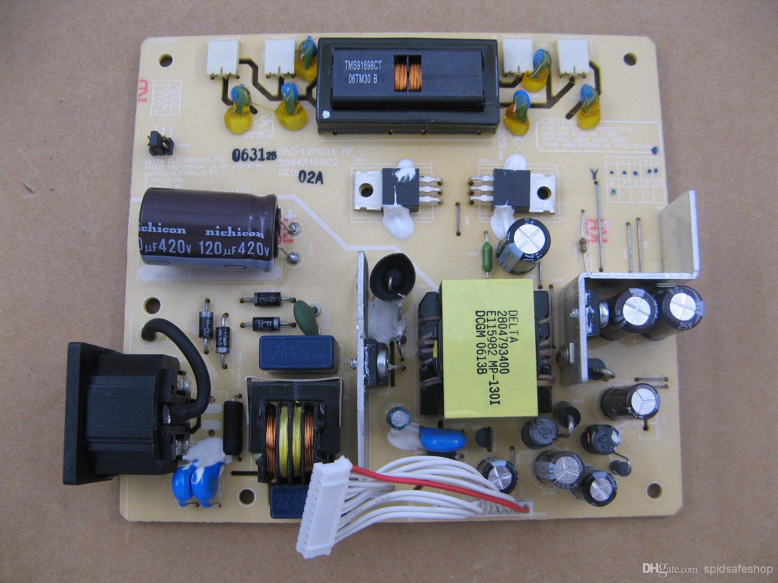

          Attached Image of My board
          Taken from google
          Looks the same
          I don't see any burn marks or burnt components
          checked the fuses
          all ok
            Re: GNR TS902W no power , help please
            Taken from google
            Looks the same
            checked the fuses
            all ok
            No we can't do much with a photo of another board taken from Google. We actually need the photos of YOUR board, both sides.
            Which fuses did you check, please mark them on the photos you will upload.

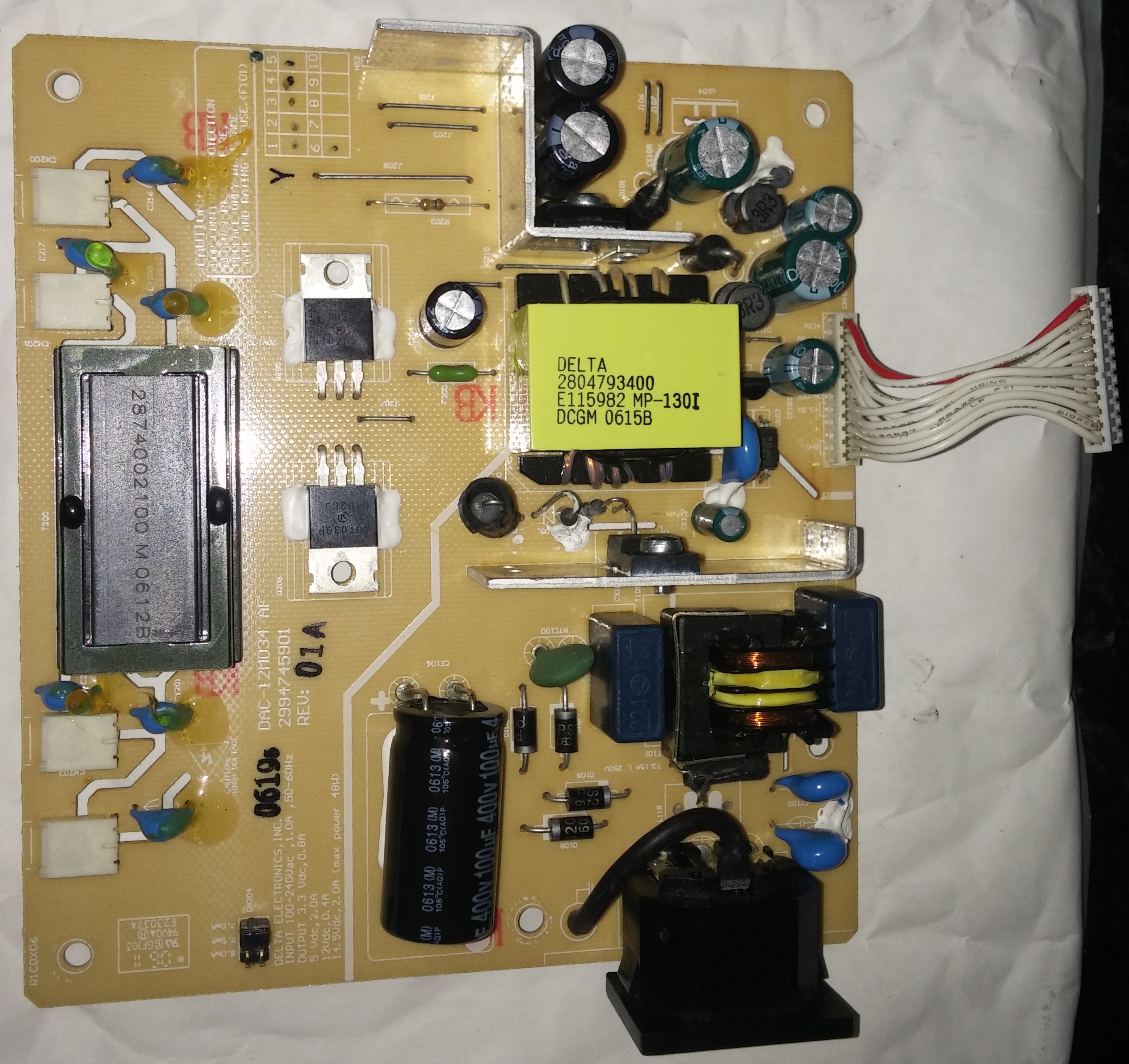

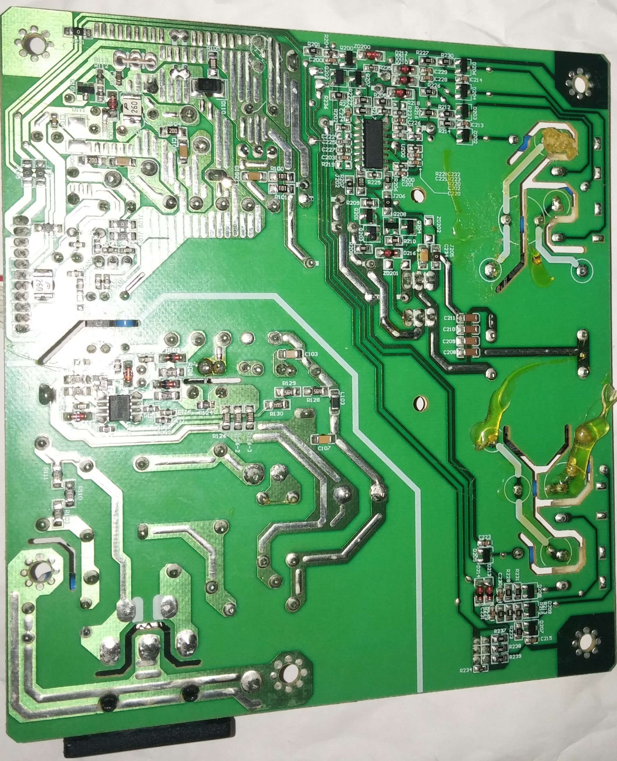

                                    Attached are photos of My LCD Monitor Power board
                                      As Momaka suggested, have you changed or checked the startup cap? Can't really tell from the photos but it looks a bit bulged?
                                      Also, when you say there are no output voltages voltages, what are you using for ground for checking? You can't use the same ground as on the hot side of the power supply (do you see the line separating both sides of the PSU) ? Use a ground on the cold side of the PSU and measure the voltages that are on the connector (they are printed on the circuit board)....do you get anything?
