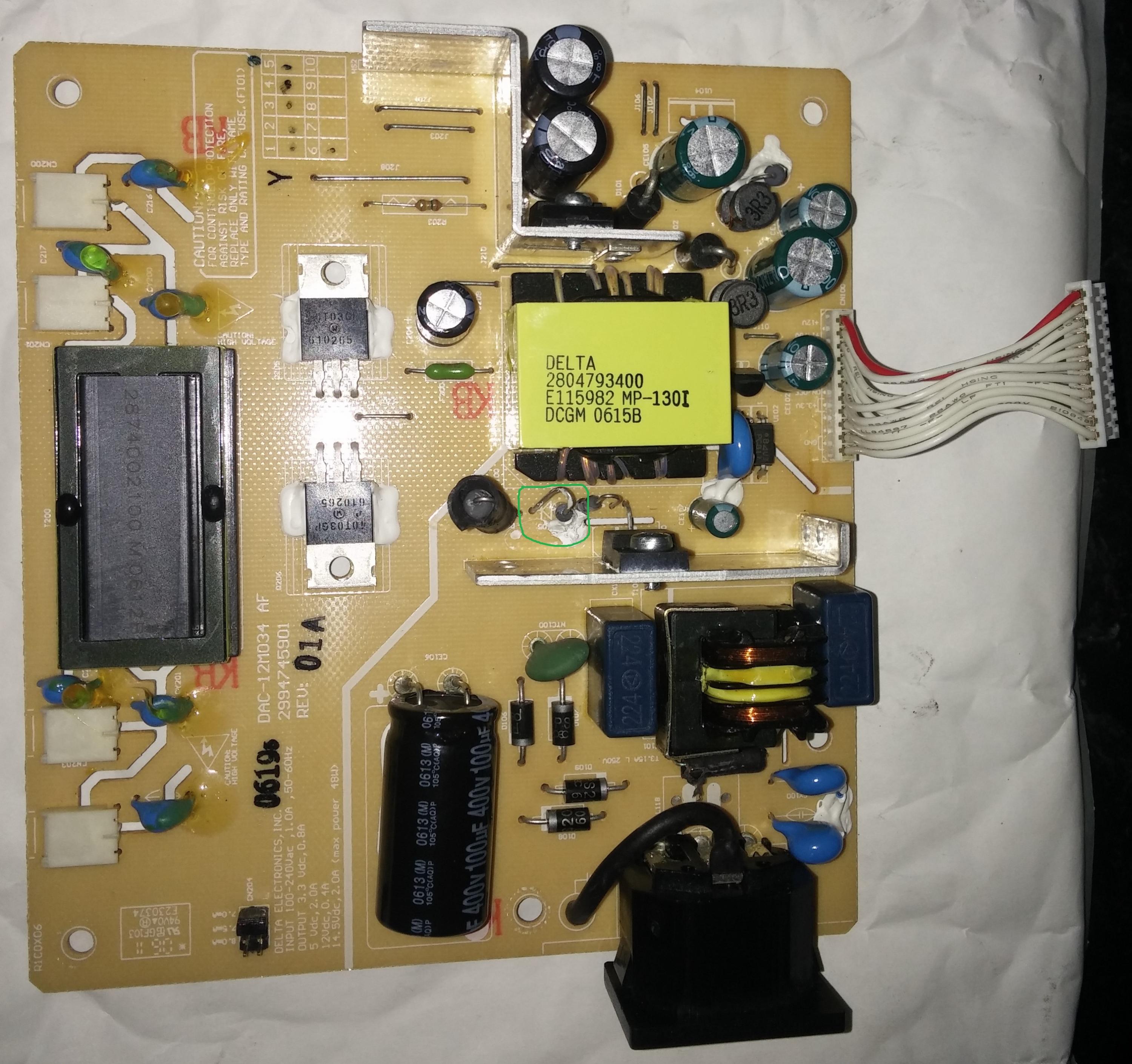

          Ok so more of an update, I was going through the diodes again and found a small one,
          I tested in diode mode and got 0.001 v both ways using diode mode
          I have highlighted the diode in a pic attached but i dont have one this to replace, can i replace with another value one
          please can someone advise
          otherwise i will have to order that will take some time
          thanks in advance

            #45
            Re: GNR TS902W no power , help please
            That's your snubber diode. Definitely not good if you get a short-circuit across it. Take it out of the circuit and verify your readings, then post what you got.
            If that diode shows bad readings out of circuit too, remove the two resistors next to it from the circuit as well, then check and post their values as well. Also check the small SMD ceramic cap, C103, on the solder-side for short-circuit (it's in the area of that snubber diode).
            As for replacement of that diode... yes you can use a different part number. It just has to match specs of this one. Most likely, it's a 1 to 1.5 Amp ultra-fast diode, rated for 1000V DC reverse voltage. But post the part number of your original diode so we can find out what specs it has.

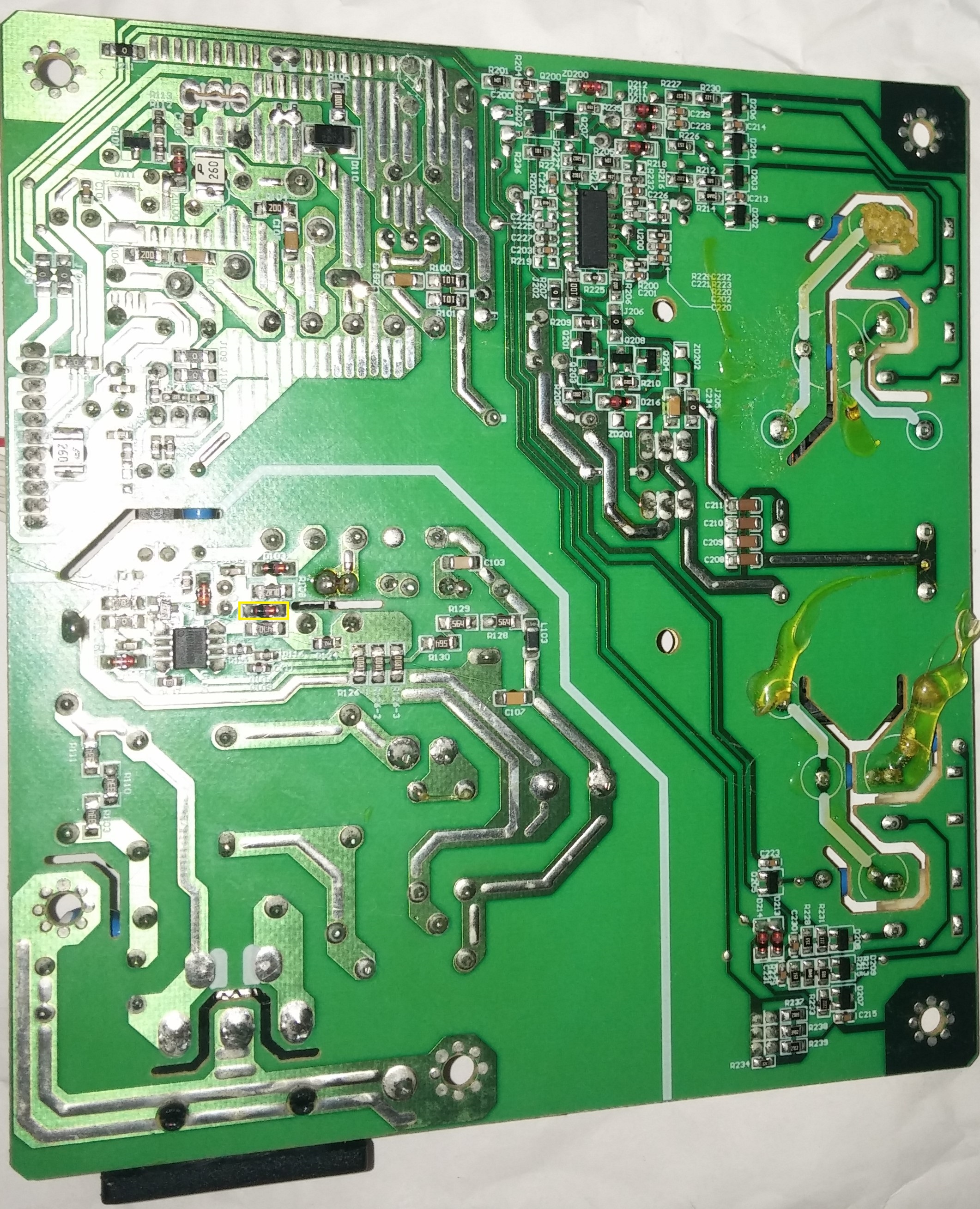

                      Hi
                      I have done all the checks you mentioned
                      22.68V pin 3
                      0001.7 mV and climbing
                      tested SMD Caps surrounding SG6841 chip
                      all read above 30 ohms
                      all resistors read ok
                      one resistor, r130 i dont know what the reading should be
                      its a h95
                      there is one resistor, R108. high lighted in attached pic
                      rating is 2.7 ohm and i get 3.7 ohm, tested in and out of circuit but the same value, is this needed to get this working ?
                      q103
                      diode voltage reading
                      0.632v
                      All diodes are ok, non are bad
                      tested all in diode mode
                      I am using a esr meter, one similar to bob parker design

                        #51
                        Okay, good. Anything less than 100 Ohms, though?
                        its a h95
                        Heh, that's cause you're looking at it upside down. Turn it around, and it should look more like "564", no? It's the same value as R128 and R129 - i.e. 560 kOhms.
                        In any case, since you're getting about 22 Volts on pin 3 of the PWM chip, I don't think that R130 resistor is open... but it doesn't hurt to check it again.
                        Sound to me like your multimeter has offset at low resistances. This is typical with cheaper/budget multimeters. When you touch the probes of your multimeter together on the lowest resistance scale, what resistance do you get? If it's 0.5 to 1.0 Ohms (some cheaper meters even read as high as 2.0 Ohms), that would be the reason why your 2.7 Ohm resistor reads as 3.7 Ohms. If that is the case, you shouldn't worry.
                        Also, 3.7 Ohms for that resistor still shouldn't prevent the circuit from working.
                        q103
                        0.632v
                        Alright, that looks like it's okay too.
                        Welp... at this point, I think the problem points to a faulty PWM chip then. So time for a new SG6841. Then we can continue from there if the problem still persists. I don't think there's anything else we can test until that's replaced.
                        On that note, maybe buy two of these PWM chips, in case one turns out a dud or somehow gets blow up while repairing the PSU.

                                ok i think i might have found a shorted diode that i missed but im sure i tested before
                                I checked again but seems that its gone
                                its d104
                                0,055v, diode mode both ways
                                what can i replace this with, can i used one from a old power supply
                                attached is a pic shown
                                please help again
                                thanks
                                • R_J
                                  • Jun 2012
                                  • 9588
                                  #56
                                  It looks like the 47Ω resistor is in parallel with the diode. if it is, thats throwing off the reading
                                  • lcdcaps1
                                    • Oct 2011
                                    • 322
                                    #57
                                    does it mean i need to replace
                                    i dont think it should show a reading in both directions, right ?
                                    what can i replace with because i cant find any datasheet for it
                                    please
                                    • lcdcaps1
                                      • Oct 2011
                                      • 322
                                      #58
                                      Can i run this power supply board without this diode
                                      i dont have one like this to hand
                                      If i cant run this without it then can i use something else as a substitute please
                                      Please help some one, anyone
                                      please
                                      • rddube
                                        Aspiring Expert
                                        • Jun 2013
                                        • 950
                                        #59
                                        What R_J is telling you is that the 47 ohm resistor that is in parallel with the diode is going to give you wrong readings on the diode. To test it fully, you would have to remove it from the circuit.
                                        Also, I am a little curious on how fast you got that SG6841...did you buy it new somewhere or did you take it off a scrap board?
                                        Finallly, I think you need to do what Momaka suggests in post #54 and give us the results because we seem to be hitting a dead end.
