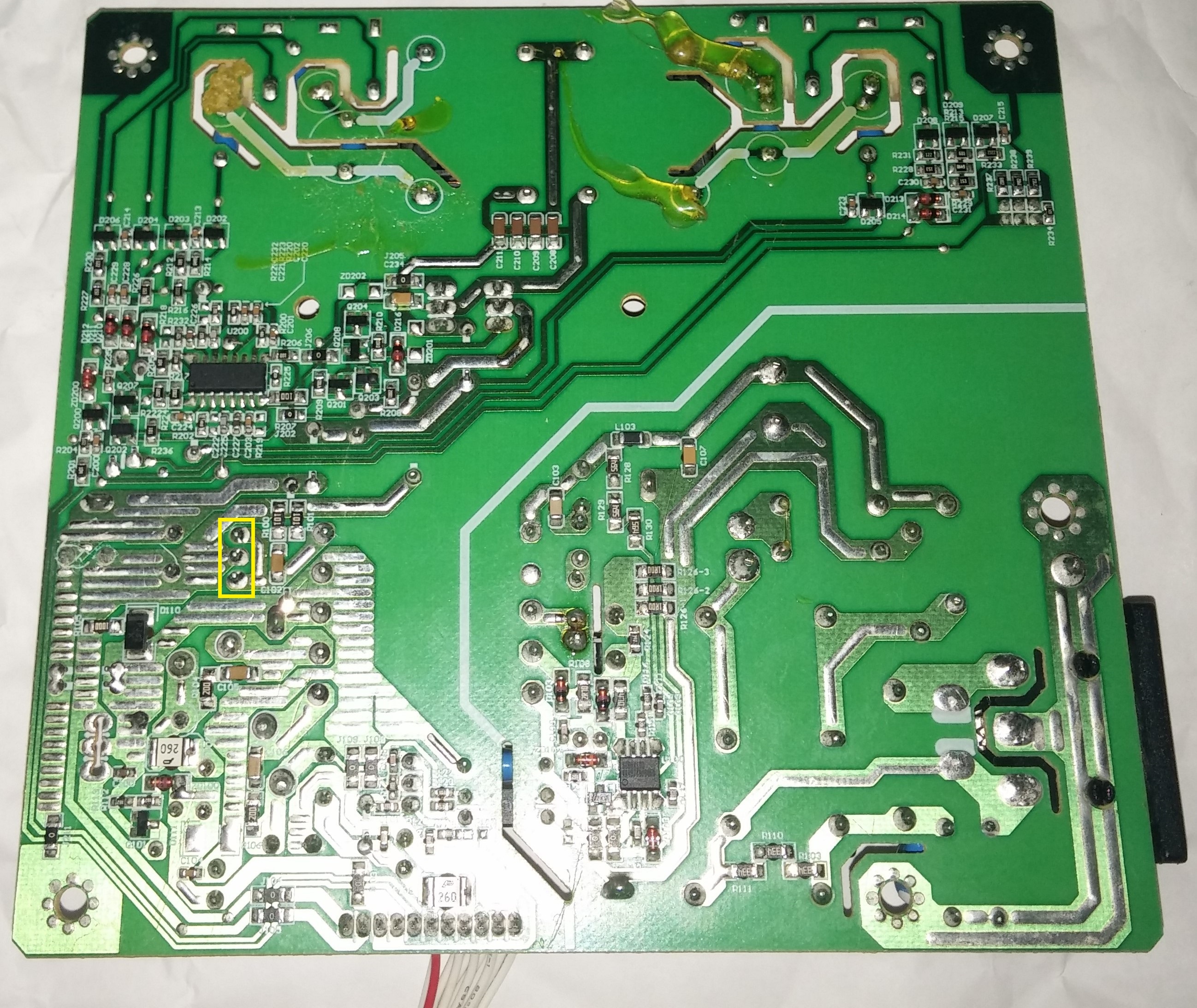

          Ok so i replaced the diode rectifier, highlighted in attached pic
          i tested it in diode mode and outside and it was not working as a diode
          one side was working but other so i checked outside of board and also
          so changed it out with a new one and still no voltage on the startup plus no output voltage still
          No pwm controller chip voltage
          is it possible that the pwm chip is gone dead again or is it a capacitor or a mosfet/transistor
              How did you test it? What readings did you get?
              Rectifiers like that have the middle pin as a common-cathode. That is, the leftmost and rightmost pins are the anodes of two diodes, and their cathodes join in the middle pin (hence the term common-cathode).
              To test a rectifier like that (out of circuit), put black multimeter probe on middle pin (cathode). Then check that you get a diode reading when you put the red multimeter probe on the left pin and then the right pin. Both should show similar diode readings. If you reverse the probes, you should get no reading (open-circuit).
              Well, it's also possible that you new PWM chip is bad too. Very small chance, but I just don't see why else you wouldn't have a voltage on the Vdd pin. Also, if I remember correctly, you said after putting the new PWM controller, pin 3, Vin had no voltage on it. Can you check that again and post what voltage it has? If there's no voltage on that pin, then nothing would work.
              In any case, before you go plug in your power supply again after you replace something, first build yourself a series incandescent bulb device and connect it like this:
              https://www.badcaps.net/forum/showpo...4&postcount=70
              That way, if something is wrong with the power supply, it won't blow up your fuse or any other parts and should keep things like your new PWM controller fairly safe.
              Because I forgot to post here that you should use the series incandescent bulb every time you power the PSU, just quickly re-check all your components on the primary side again, like the main fuse, bridge rectifier, and MOSFET. You don't need to post their values.
              For the MOSFET, just make sure it had a diode reading when you put black probe on Drain and red probe on Source. Reversing the probes should show open-circuit after a few seconds (as the mains cap can fool your multimeter while the meter is charging it). Resistance from Gate to Source or Drain should also be fairly high in circuit and completely open-circuit if the MOSFET is removed from the board and measure that way.

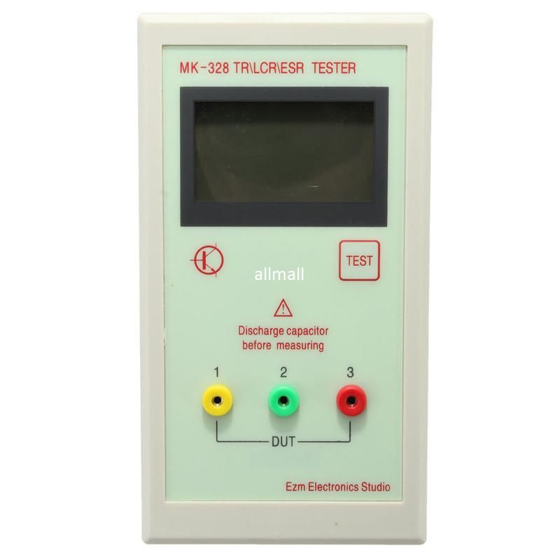

                  The way I test transistors is out of circuit with a transistor tester - it actually gives you a drawing of the transistor so you know it's good. Do you have one of those?
                  Something like this: https://www.ebay.com/itm/Transistor-...QAAOSwsXFZE0dC
                  At some point you mentioned that you have voltage on one of the legs of that transistor, what about the other legs?

                    Re: GNR TS902W no power , help please
                    hi thanks for the reply
                    i have one of these
                    https://www.dhresource.com/0x0s/f2-a...inductance.jpg
                    Its similar to the link you provided,
                    Maybe different model number

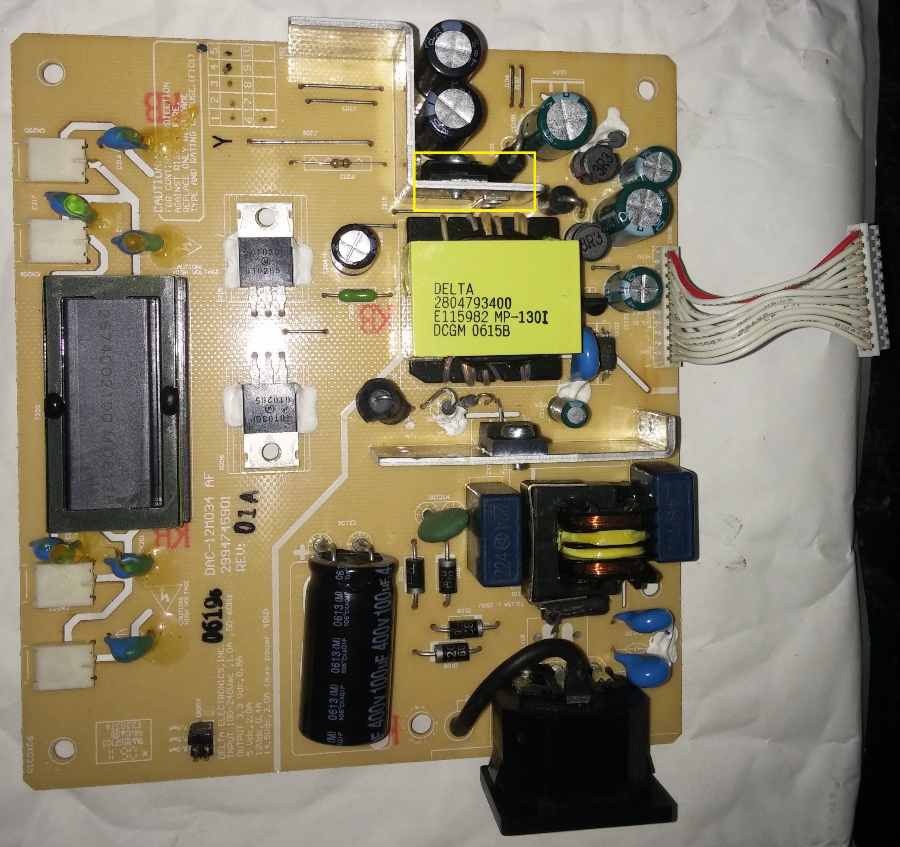

                                        Attached is pic that has high lighted in yellow the pins i get voltage on. This is one side of the yellow transformer that has delta writing on top. Also high lighted other pins where i get voltage
                                        i get 328 v dc on the pins mentioned above
                                        but nothing on other side
