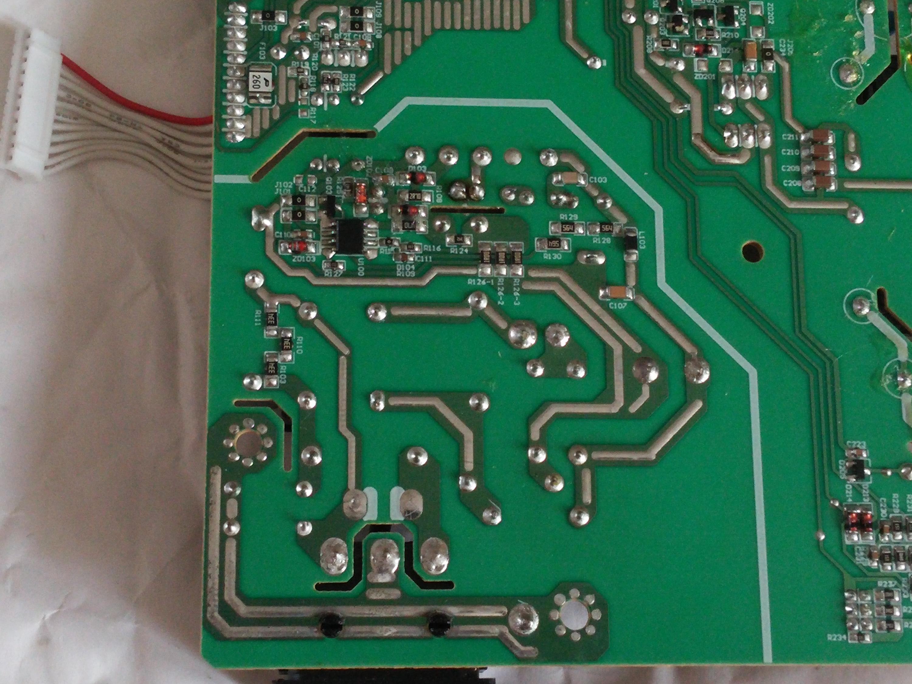

                  • rddube
                    Aspiring Expert
                    • Jun 2013
                    • 908
                    #29
                    Re: GNR TS902W no power , help please
                    I think you might want to take a look at the components on the other side of where I marked it in the picture. It's hard to tell from the photos, but it looks as if something heated up here on the other side, probably the mosfet bolted to the heatsink.
                    Please let us know what resistance readings you get on that mosfet. Also, I am attaching a manual for a power board that is similar to yours, not exactly the same model but very similar...it might help.

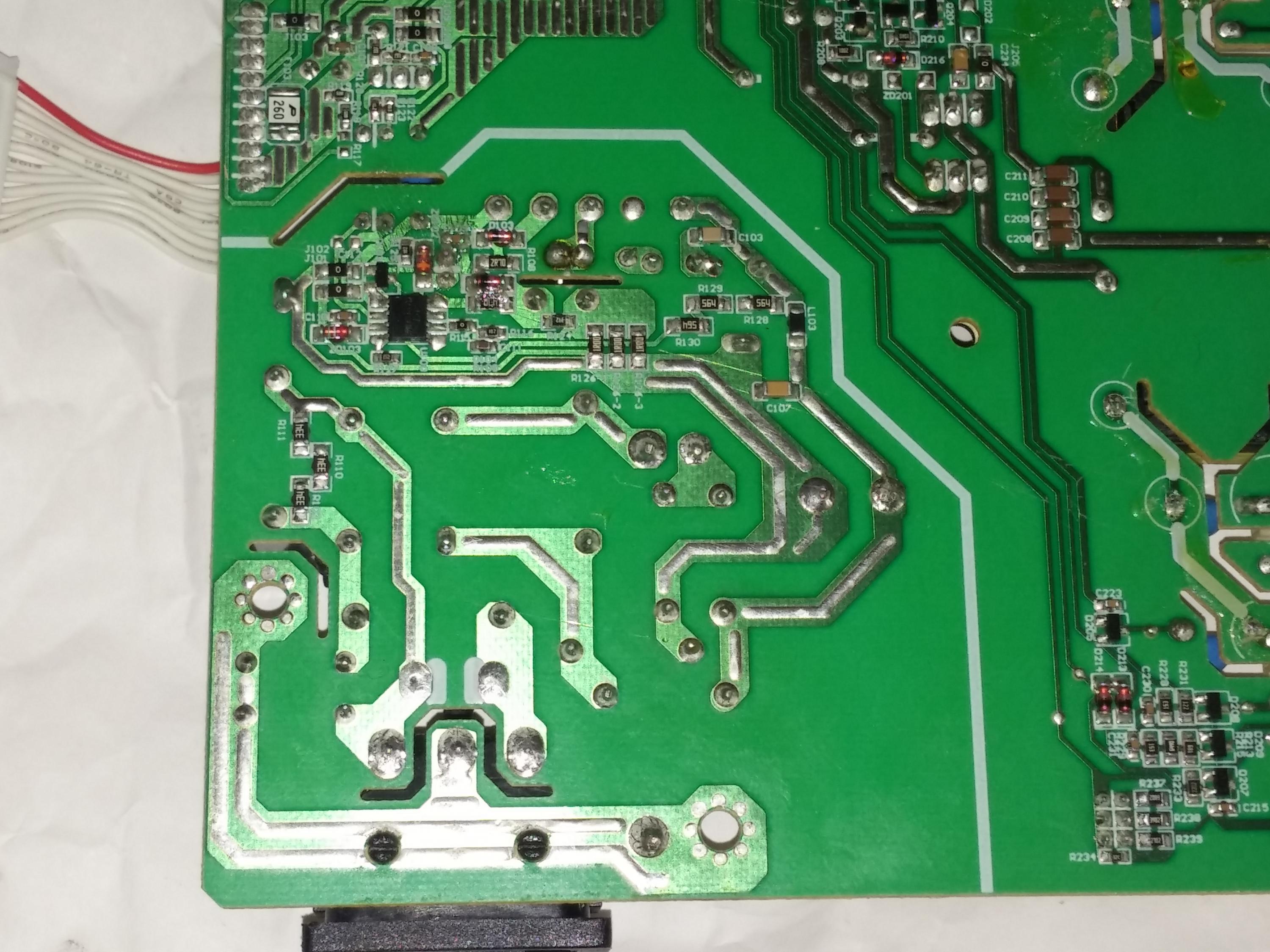

                                • rddube
                                  Aspiring Expert
                                  • Jun 2013
                                  • 908
                                  #36
                                  Ok, so if you have no voltage at the startup cap, that means that something before it is not working.
                                  However, what are you using as ground to measure voltage on the startup cap? Your best ground on the hot side of the power supply is the negative side of that big main cap. Again just to make sure, be very careful in that area because you are playing with 324 V.
                                  Can you take a photo of the section I highlighted in blue without the glare hi-res?
                                  You'll have to trace the + side of the startup cap to see what is not delivering voltage. I marked the + side of the startup cap in the photo.
                                  Also could you check L103. Check voltage on each side or resistance of L103.
                                  • lcdcaps1
                                    • Oct 2011
                                    • 322
                                    #37
                                    Ok so I measured the voltage on the startup cap as you suggested using the ground/negative from the main cap and i get nothing
                                    I am considering to replace the startup cap
                                    as the esr is out of spec
                                    I tested the power mosfets and they seem ok
                                    I tested L103 and i got 318 V on both sides
                                    Attached are photos from the back, I am using the highest setting on camera and took a few shots
                                    Hope they are ok

                                        • rddube
                                          Aspiring Expert
                                          • Jun 2013
                                          • 908
                                          #40
                                          Ok, check J101 and J102 for resistance they should have no resistance (they are fusible resistors). Also, check i you have any voltage (again be careful) at any of the 3 pins of the mosfet (or transistor) mounted on the heat sink.
                                          Could you also tell us what is the markings on U100?
