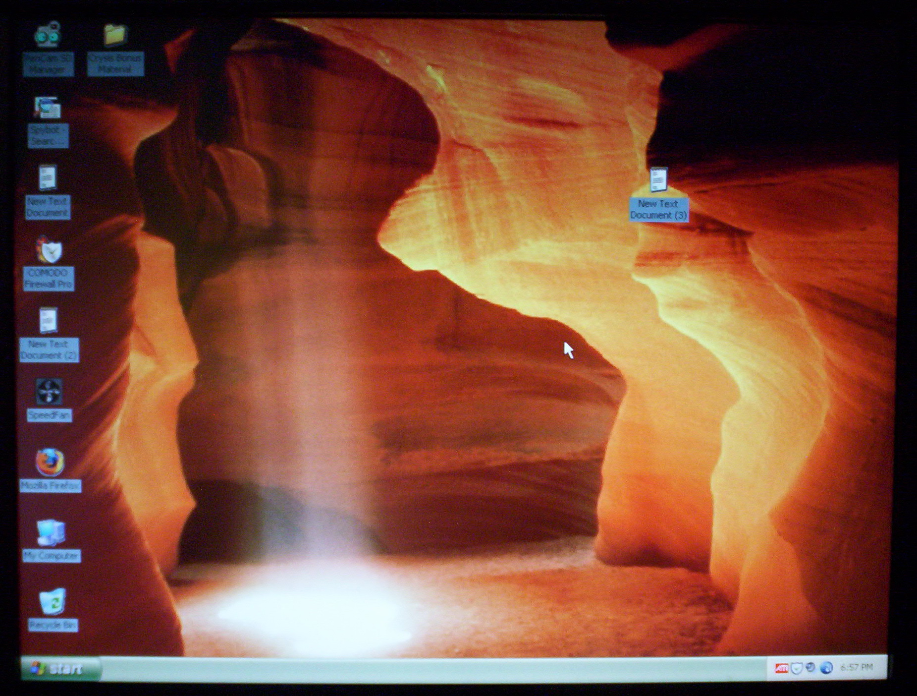

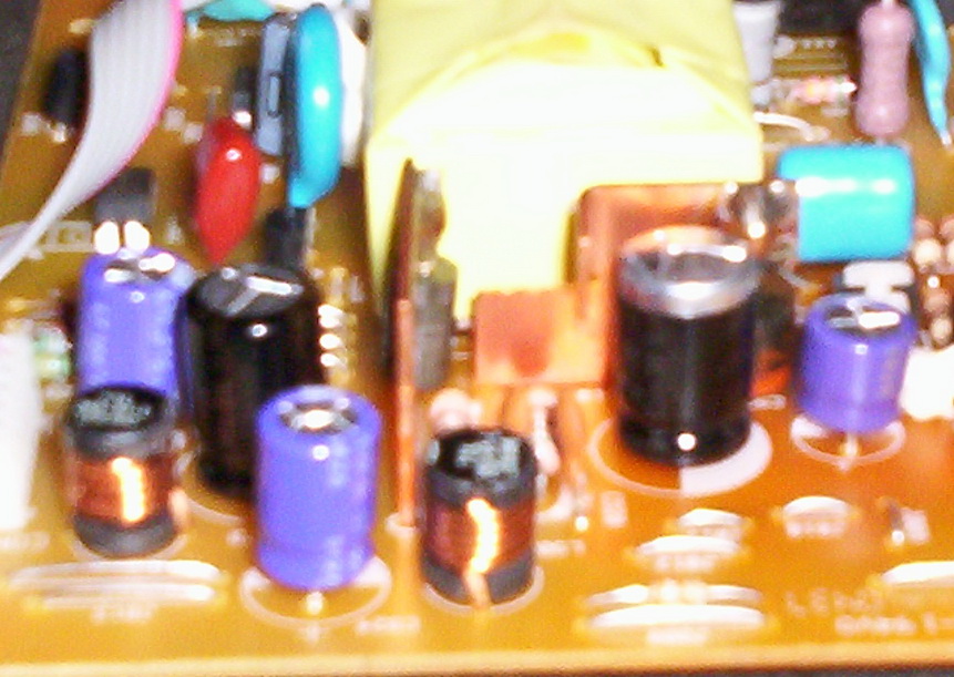

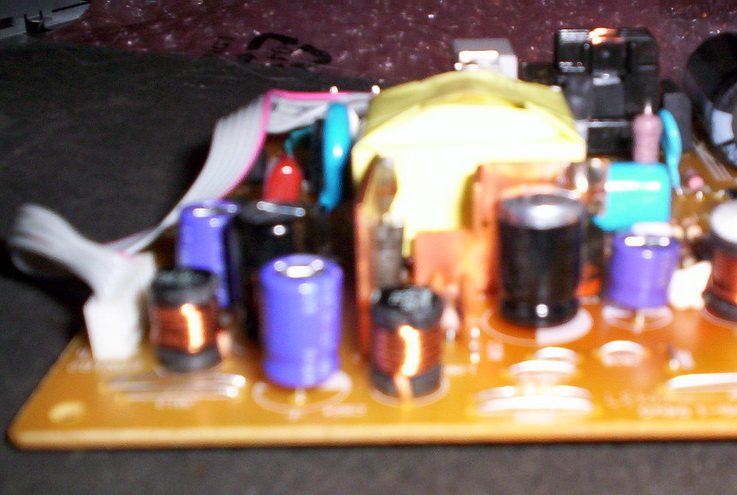

              I got the project finished about 1:30am Sunday. I now have a nice bright lcd, and a jealous son-in-law since he didn't have time to fix it and passed it to me .
              Sorry for the bad quality photos, I can't find my mini-tripod and I was unsteady when taking the shots.
              Thanks to all who offered suggestions and tips.
