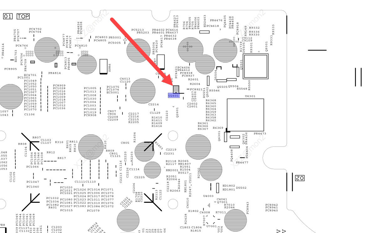

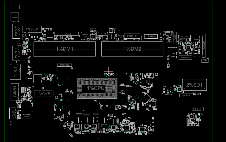

            unfortunately, i don't have the boardview to find the points...
            • mon2
              • Dec 2019
              • 14544
              Is this your board?
              Click image for larger version  Name:	bv.png Views:	0 Size:	180.8 KB ID:	3477895
              Review U2601, pins 7 & 8.

                yes it is!
