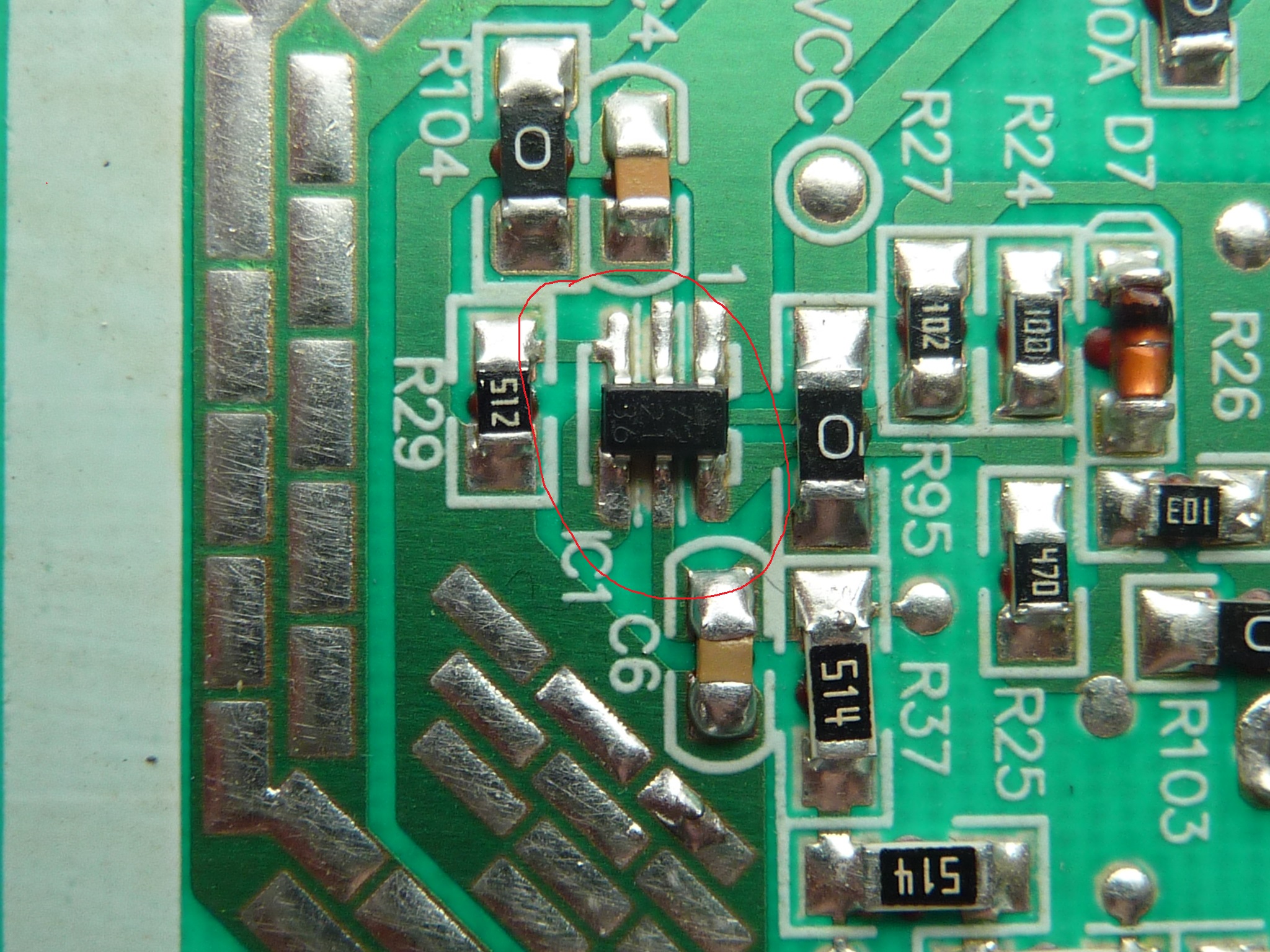

    I have a Hanns-G HL272 27" monitor with a dead PSU. Can any one the me what this part is and where I can get a data sheet on it.

    Sorry here is the picture
      Re: Faulty Hanns-G HL272
      That is SMPS IC. What are numbers as printed on top? It looks like ????2136?
        It looks like 722136

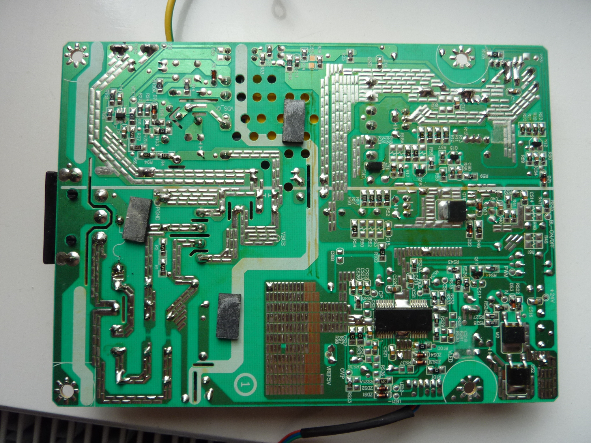

          Nothing I can find. Can you zoom out a little so I can see how it is connected to other section of the board?
          Also the pictures of whole board both sides.
            Here are some more pictures, Thanks for your help.
              What readings do you have to suggest IC1 is bad?
              Any secondary DC voltages or voltage across the big filter capacitor?
                fuse looks too dark,
                flash-mark near R28
                  Originally posted by stj
                  flash-mark near R28
                  Yes, I noticed that too, but forgot to mention it.
                    I would expect that the fuse is already been checked by the OP.
