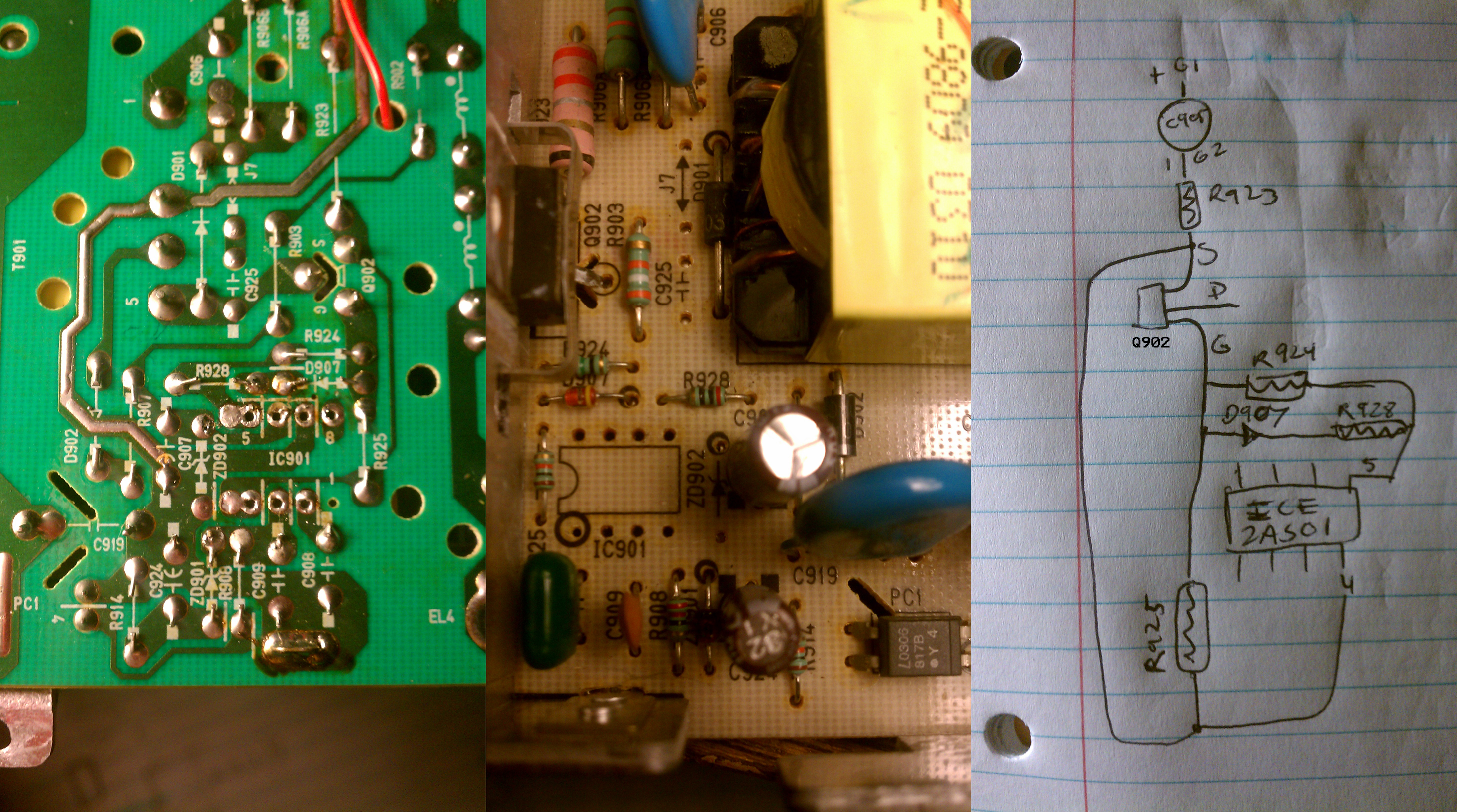

                                For you to learn, trace out the connection on the Gate pin of the MOSFET to see what it is connected to and draw out the Diagram on a piece of paper, you will learn that lots of the Gate drive circuits are basically the same.

                                  ok i will try that.. i have a hard time seeing where the traces go but if its for my education i will get it done. as for replacing it, i do have lots of old power supplies i could scavenge parts from. what are the odds on finding this 11n60c2 in my pile of junk?

                                    ok i dont fully understand but i think it was helpful to do this. bit by bit it starts to make a little sense. but first of all, can you tell me if my interpretation of the resistor network connected to the gate pin is correct?

                                      i can see that the drain draws its power from the positive leg of the main filter cap and that it flows through the source pin to the resistor network and the ICE chip and eventually back into the negative leg of the main filter cap.... but i still dont quite understand... it kinda looks like it splits up and goes back into the negative of the filter cap and also to pin4 of the ICE

                                        pin 5 on the ice activates on the gate of the 60n11
                                        then the 60n11 completes the circuit through the source and drain
                                        kind of like a light switch
                                        this system is working on switching the neutral/ return of power side
                                        the reason you can read + power on the drain pin is because it travels through the transformers coil
                                        a lot of time the power mosfet (in this case 60n11) shorts or leaks too much power through the gate and it gets to the controllers and damages the controller chips
                                        so you just need to check that all the resistors in that area are showing ok resistance wise
                                        and that the diodes are also working in the right direction drain pin of the 60n11 i
