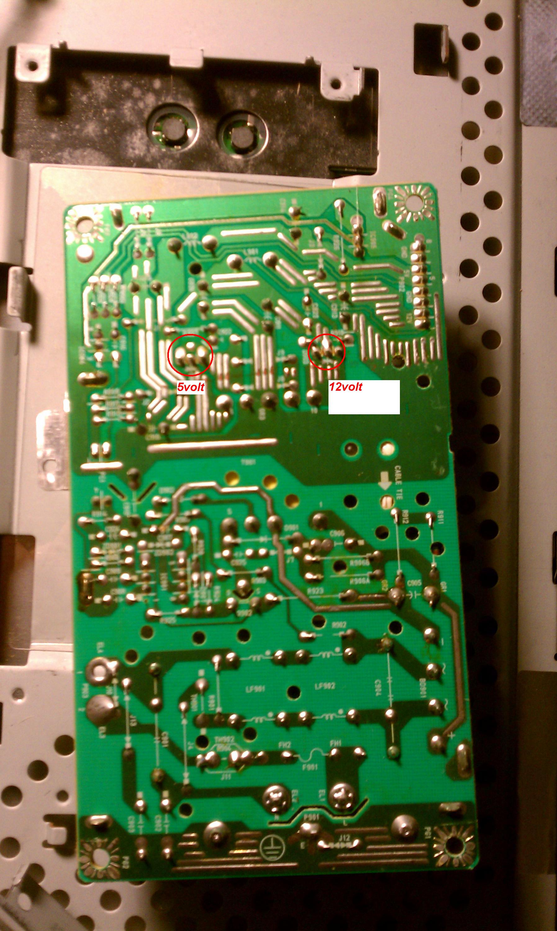

            rectifier diode locations from bottom

                    can you post a clearer picture of the bottom of the power board targeting the center section ??
                    the other picture gets too fuzzy when I try to get in close on it.

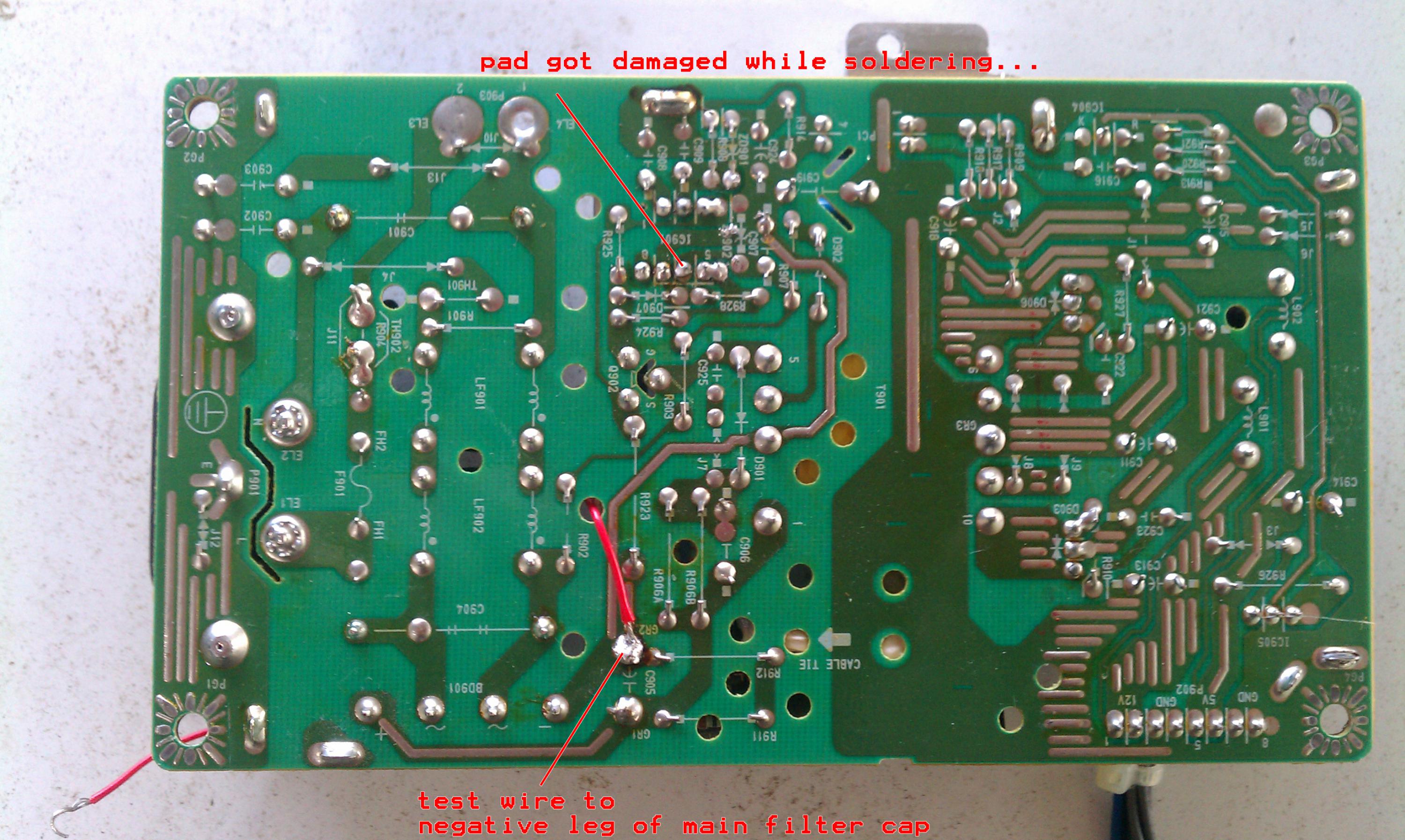

                      ok heres a better picture of the back of the board.
                      also i guess i should mention that while changing the IC, one of the pads got a little damaged... it still looks like it would be making a connection...but is this really bad?

                          so you have no voltage between pin 6 and pin 7 ??
                          If not, check to see if pin 6 is grounded with an ohm meter
                          then check the diode at D902 to see if it shows zero resistance in one direction
                          then check resistor 907 to make sure it is not open (no resistance)

                            just to be sure, to check if pin 6 is grounded i put my meter to ohms setting and put black probe on chassis ground and red probe on pin6?

                              pin 6 is VCC and pin 7 is ground... also pin 6 is the one the pad got damaged on.. how likely is that to cause a problem?

                                oh wait this is in the primary side of the psu so i have to use negative leg of main filter cap as ground?
                                Don't fear the repair...
                                • triplefour
                                  • May 2014
                                  • 1747
                                  #36
                                  Re: Dell 1800FP no 5v standby.
                                  ok using the negative side of the main filter cap as ground ref, i get 0.3 ohms resistance on pin 7 (GND) and 3.1 ohms on pin 6 (VCC)
                                  if pin 6 were grounded would that mean it should be 0.3 like the ground pin? and that would be bad, right?
