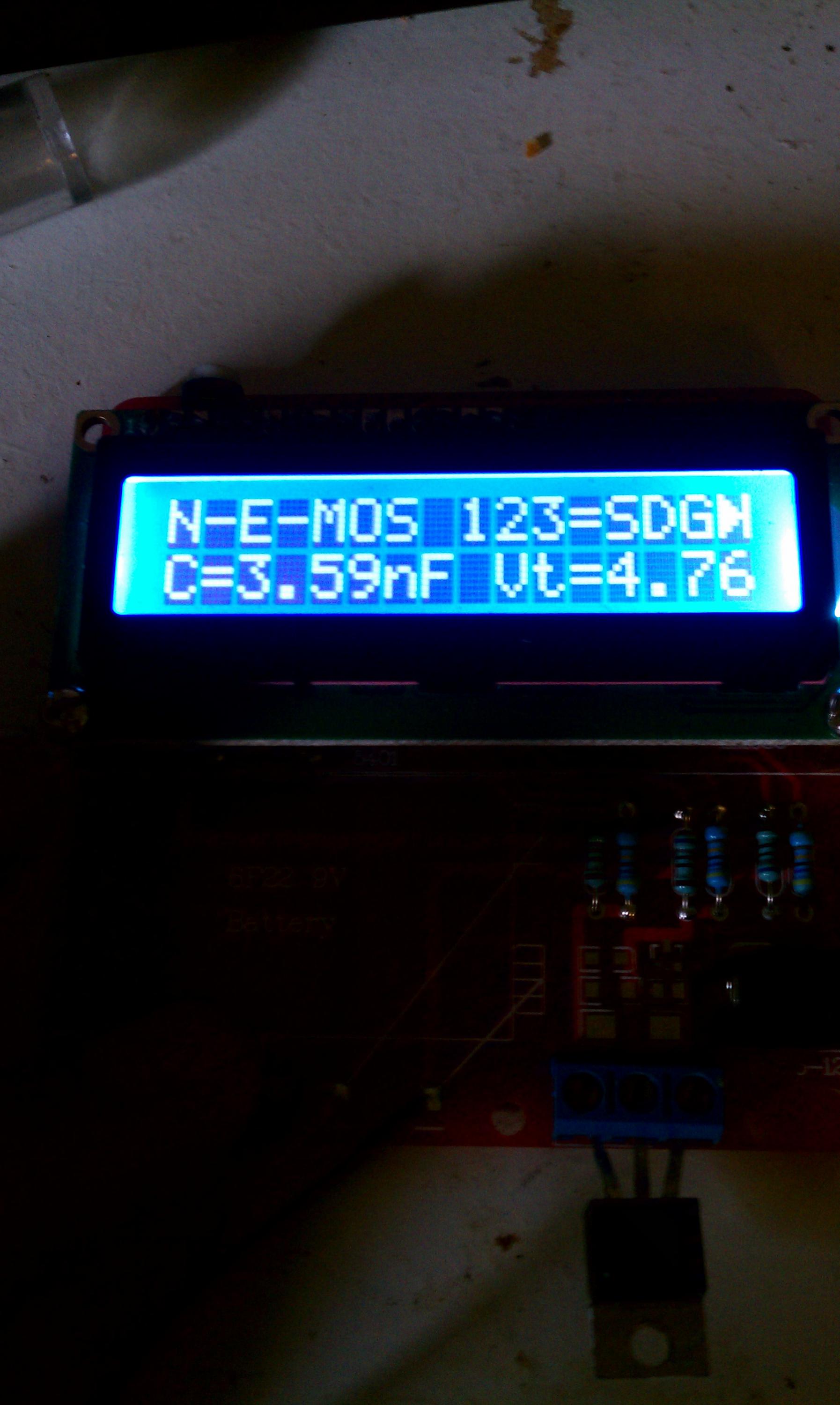

                                    ok using my ESR meter (which tests other things too...mosfets included...i hope) this is the reading i got.
                                    c= 3.59nf
                                    vt= 4.76
                                    it does identify the Source Drain and Gate pins correctly
                                    and seems to call it a N-E MOS
                                    what is an N-E MOS?
                                    and what does it all mean? would i need some info from the datasheet to compare against?
                                    Don't fear the repair...
                                      #78
                                      Re: Dell 1800FP no 5v standby.
                                      "so then that resistor is fine? how can i figure out the color code though? orange orange silver gold black" 0.33 Ohms, just remember that your meter test leads also have resistance so you you have to subtract the test leads resistance from what you read.
                                        #79
                                        It telling you that it is N-Channel MOSFET.

                                          #80
                                          ok i see how the color code makes .33 and how my meters internal resistance of .3 would add up to make .6 so i am sure that resistor is fine. but what of the readings c=3.59nf is this capacitance?
                                          and what does vt stand for?
                                          basically is this mosfet good or bad, or can i even know from these readings?
