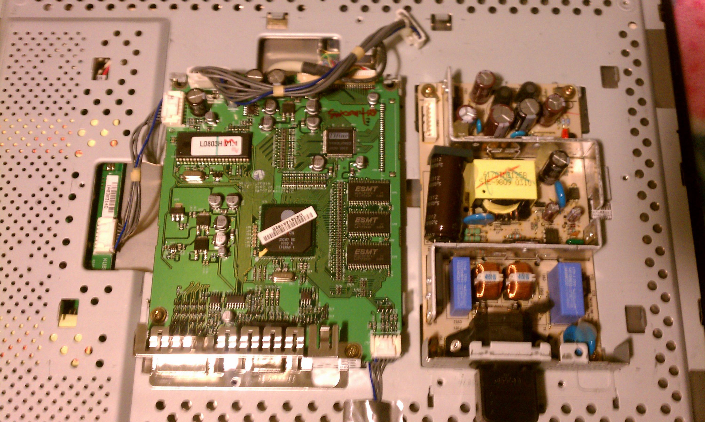

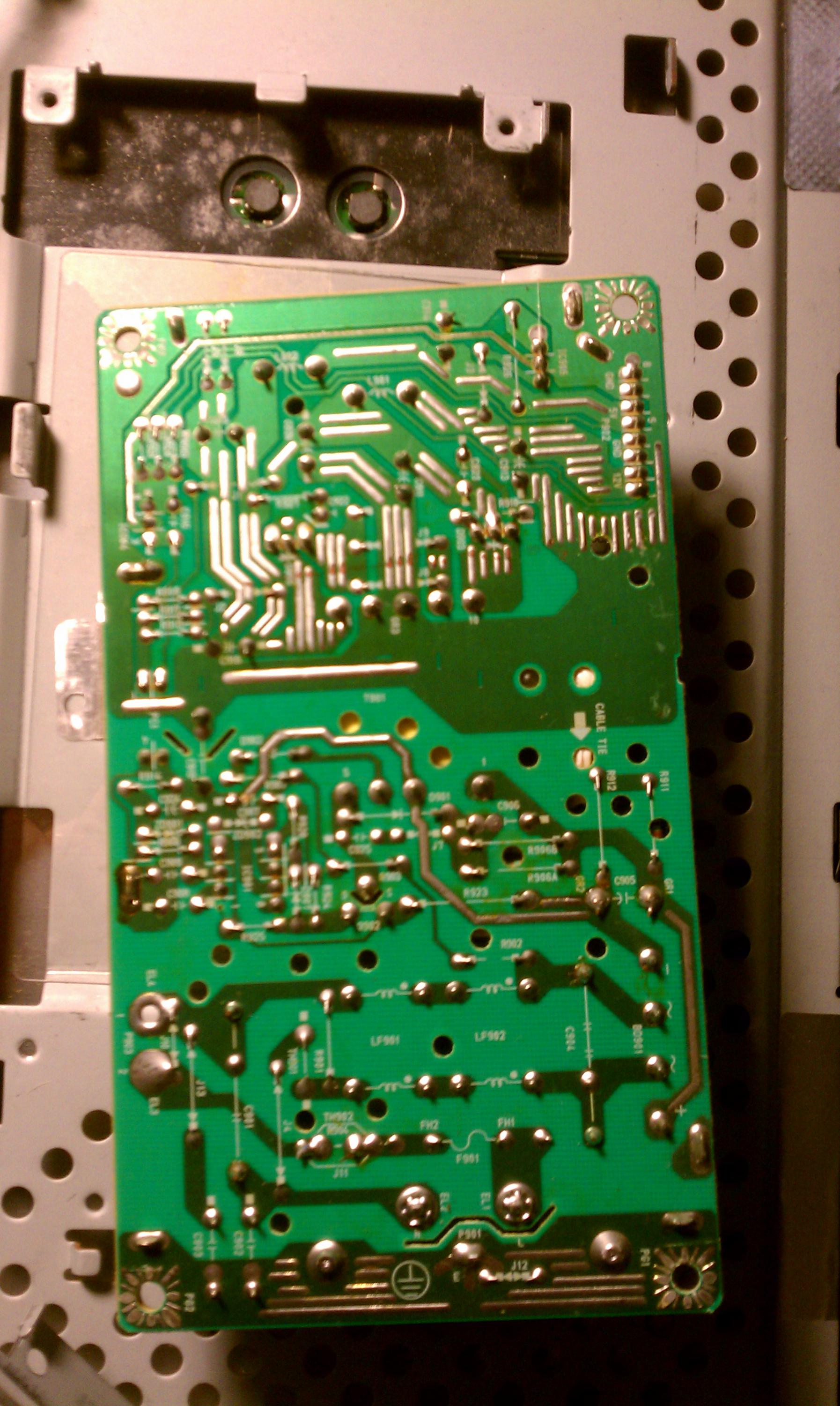

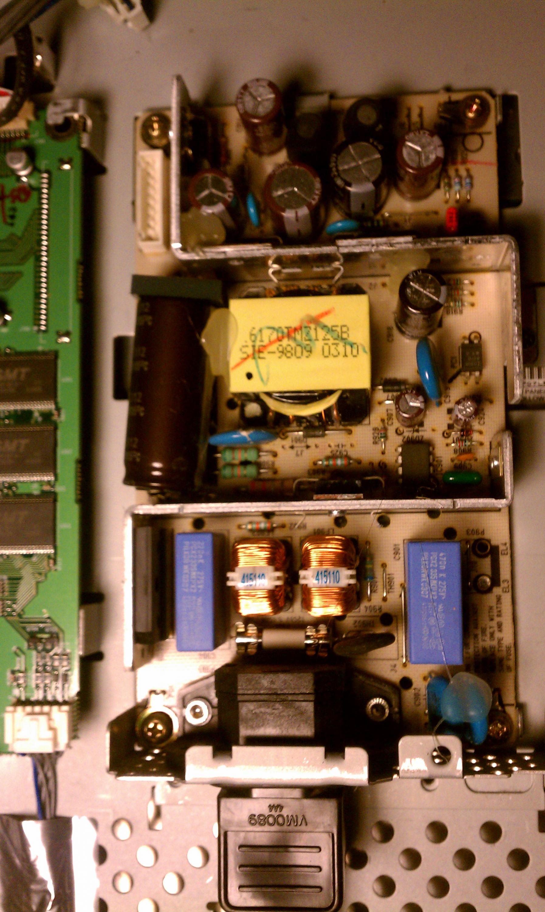

    got another monitor on the workbench here...this time its completely missing standby power. so we automatically know theres something wrong with the PSU, right?
    i measured 120v across the fuse
    and 68v on the big filter cap.
    theres a small 4 legged umm... IC? mosfet? chip? sorry i dont really know what to call them...it says L0306 on it...anyway 2 of the legs read 68v but the other 2 are zero. does that mean anything or are they just zero cause theyre both grounds?
    heres some pics.

    Re: Dell 1800FP no 5v standby.
    hmm according to this ebay item, its usually the 8 legged chip that fails. its the inverter chip apparently. http://www.ebay.com/itm/DELL-1800FP-...item2574ad02a0
    i know i could save myself some time by just buying this but i'd really like to scavenge the parts for free. where else might i find such a chip? oh and how should i test to make sure it really is this chip that is wrong instead of taking some ebay guys word for it?

      "i measured 120v across the fuse and 68v on the big filter cap"
      You are using the correct ground ref point, when you work in the primary side, you use the Negative leg of the main filter cap as the Ground ref point for the primary DC voltage testing.
      So check the DC voltage right at the two legs of the cap.
        BTW, this power supply is an always on power supply so the 5V and the 15~18Vdc are always present. You are correct that the SMPS IC is the commonly failed IC. If you check the resistance of the VCC pin and the Ground pin, you will find that it has very low resistance, the later version has added Zener diode so the startup voltage cannot exceed the VCC spec of the IC.
              First, you are working the primary side of the circuit, the chassis/safety ground is not the ground ref point for the meter to test the DC voltage in the primary side. The secondary side of the circuit, the negative legs of those output filter caps are the ground ref point of the secondary side and 99% of the time are tied to the chassis.
              The primary side ground ref is the negative leg of the main filter cap and it is not tied to the chassis, it is isolated from the secondary side for safety. You need to look at the typical power supply circuit to understand what the ground ref points are and how they are used. If you do not use the correct ground point, your voltage readings will be no use to us to tell if you are getting the correct voltages or not. I hope you understand the difference between the primary and the secondary side of the circuit since primary circuit is the DEADLY side and you must be careful when making voltage measurement in that section.
                    Most of the time, the PC designer will put the thick lines to show the separation between the Primary and the secondary side, or if you work on stuff long enough then you can tell.
                    For example:
                    https://www.badcaps.net/forum/showth...752#post453752
