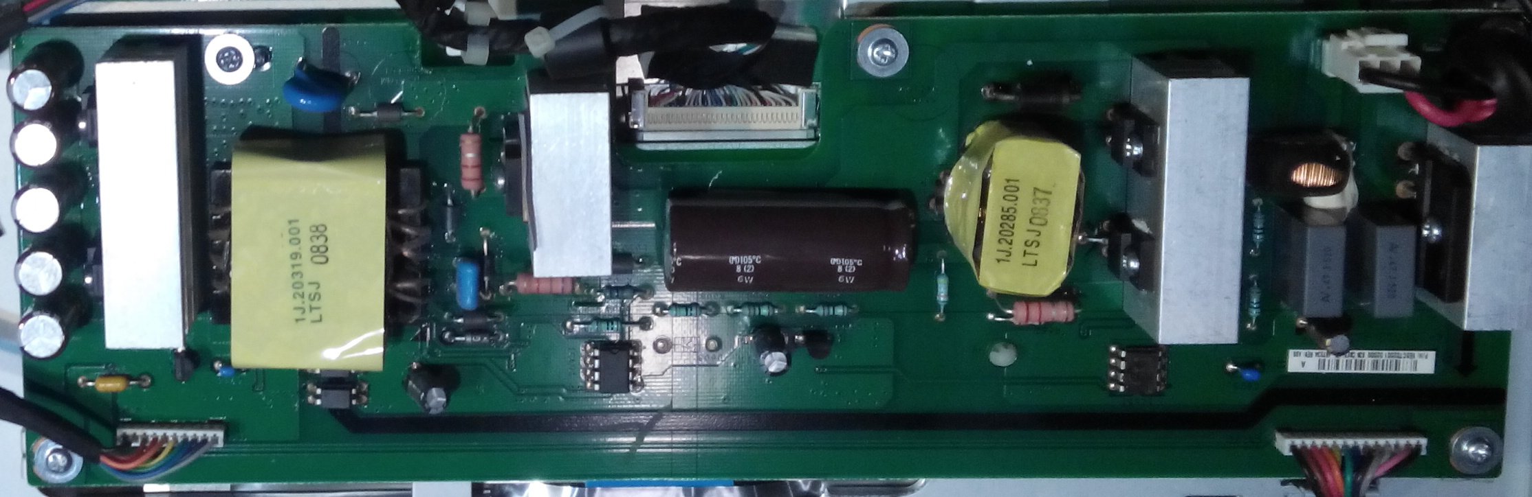

    Got this one for free as broke, therefore i do not what did this do it. The monitor did not do anything on startup, I suspected bad caps as always. This was not the case. The power board is defect, the Power Factor corrector is blown and a diode is odd looking.
    Basically: am i correct that the PFC is a L6561D (from these schematics https://www.badcaps.net/forum/attach...7&d=1359307560 in this thread https://www.badcaps.net/forum/showth...hlight=2408WFP However, the blown chip does not look like a ST to me.)
    Which other components should i test?
    Can someone confirm which chip it is?

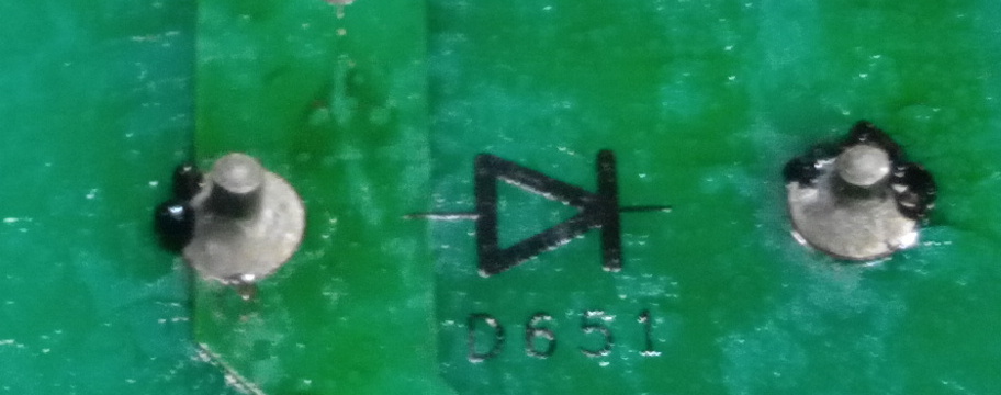

    The diode is a IN5406. It conducts both ways and is physically cracked.

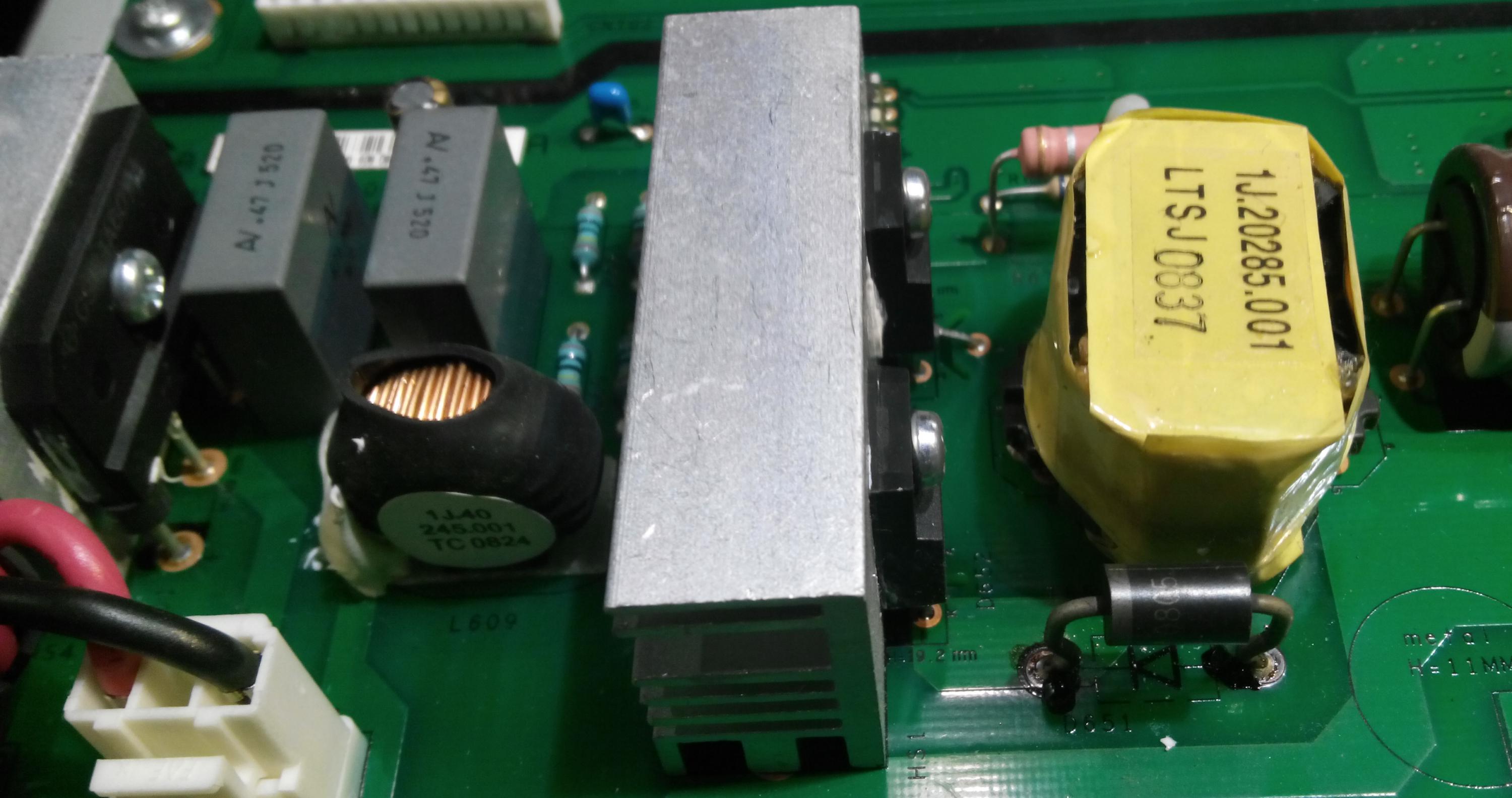

      you are going to need to also check the two diodes on that heatsink that is right next to those two parts to see if either one of them is shorted out in any direction. You should remove the bad diode and the 8pin 6561 before you check for shorts on those
      I can not see what those parts are but one if probably a 3 pin and one might be a two pin
      the 2sk3502 is probably one of the numbers of the two that I mentioned

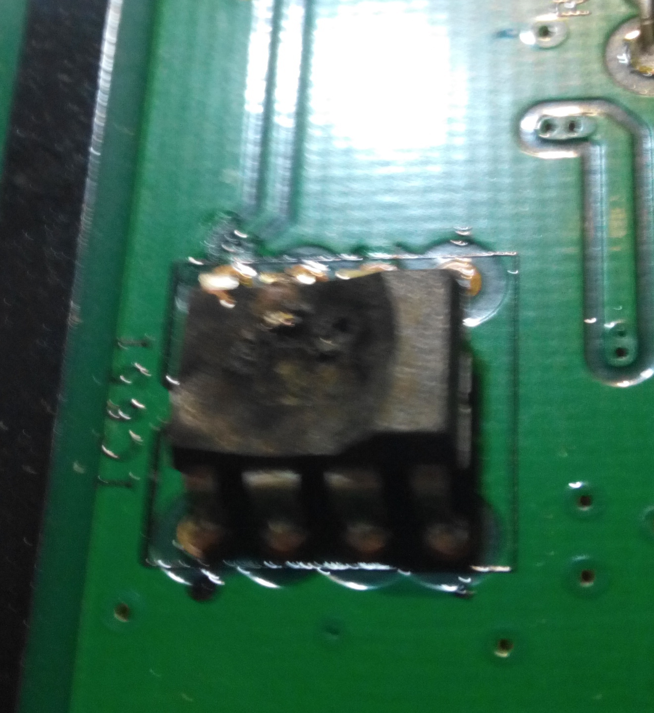

            Yes, there are two DIP-8 chips in this circuit and the 1203 is still there. The chip for the PFC is blown and as L6561D is a PFC chip, i assumed that this would be the blown chip.

              your k3502 is almost definitely toast and that is probably what killed the diode and l6561.
              Again, it may have taken out the other 2 leg diode on that heatsink. I would change all 4 and the fuse.
              check the 4 leg bridge rectifier on the smaller heatsink on that end of the board for resistances from + to - once those parts are removed

                  Status report:
                  Rectifying bridge - OK
                  N_MOSFET K3502 - drain shorted to sources, charging gate does nothing, replaced with K2543
                  TO-220 diode - works
                  L6561D -replaced, now socketed
                  IN5406 - shorted, replaced
