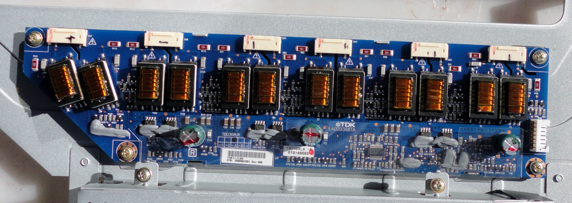

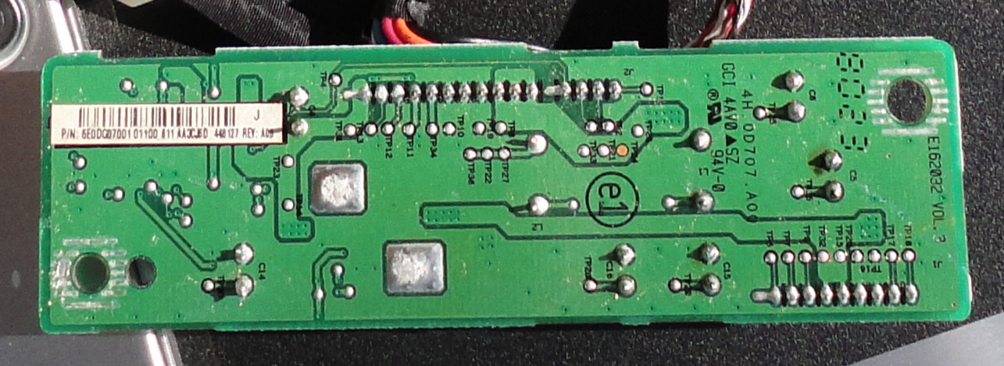

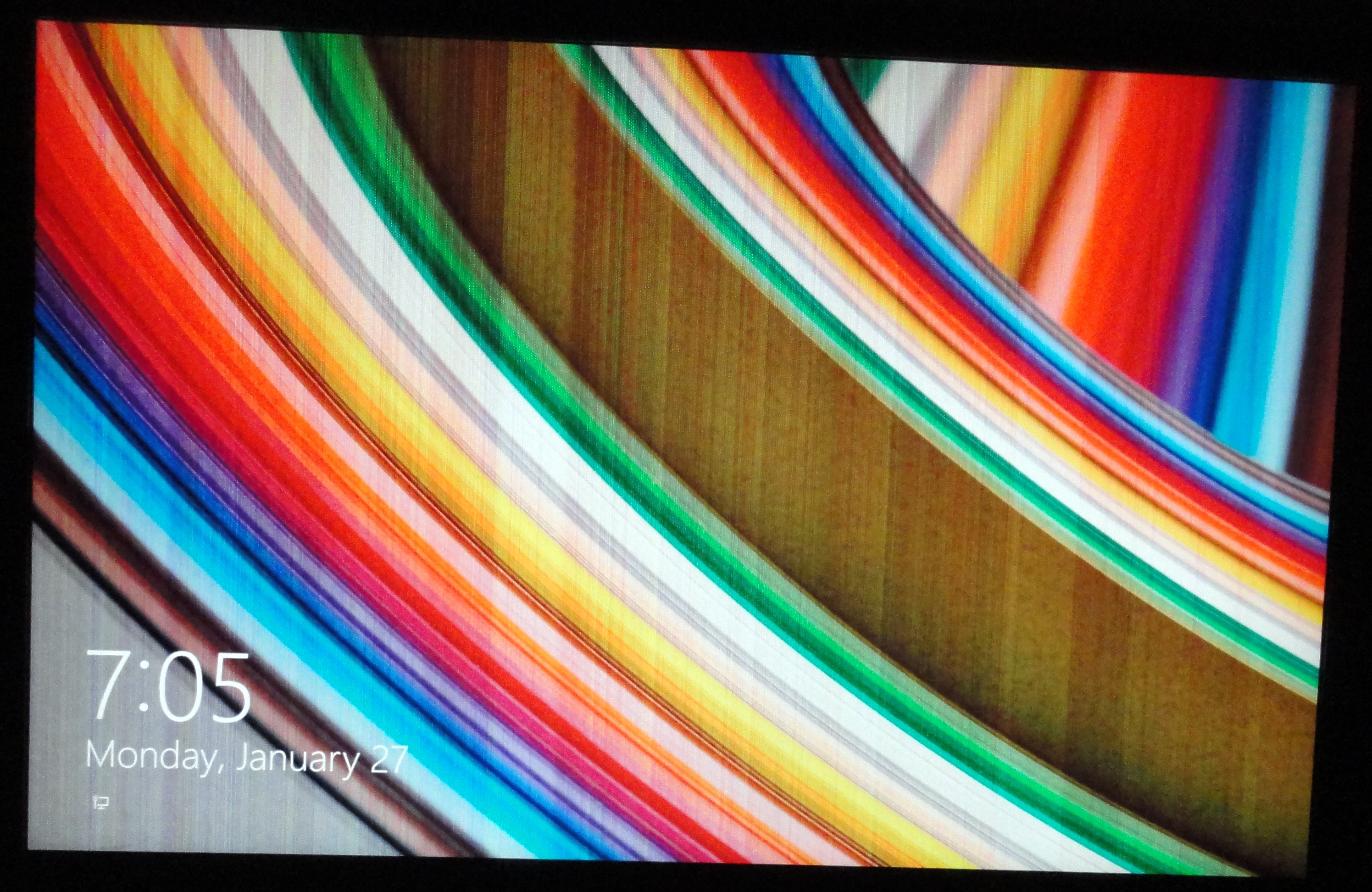

    I have a Dell 24" monitor with vertical lines. Tearing it down, I don't see anything obvious. Can anyone give me some ideas to check?

    Try unplugging cleaning and replugging all cables between video board and
    panel.
    If you unplug J3 you might get a plain white screen - backlights only.
    Any lines showing?
    EDIT Unplug with power off

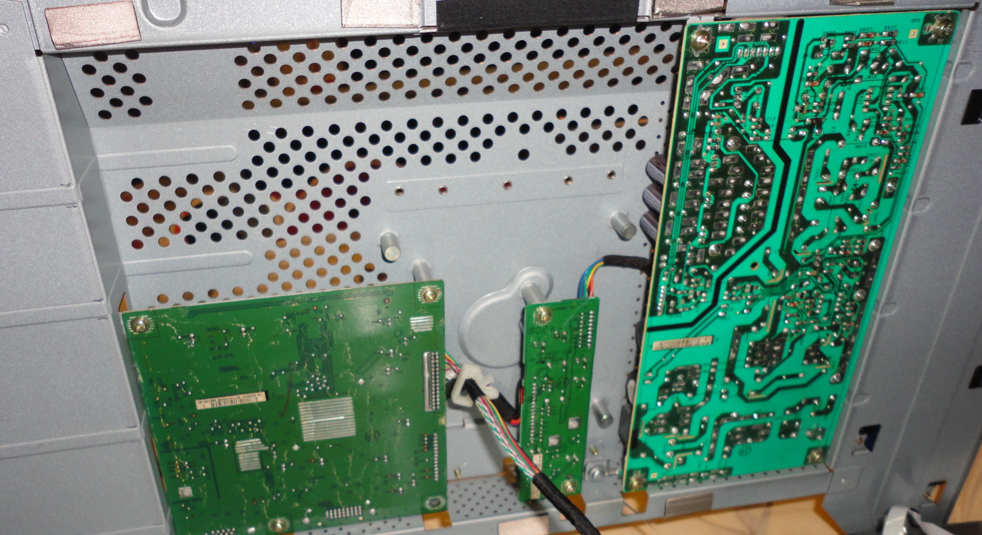

    What is that little board between the main and the power

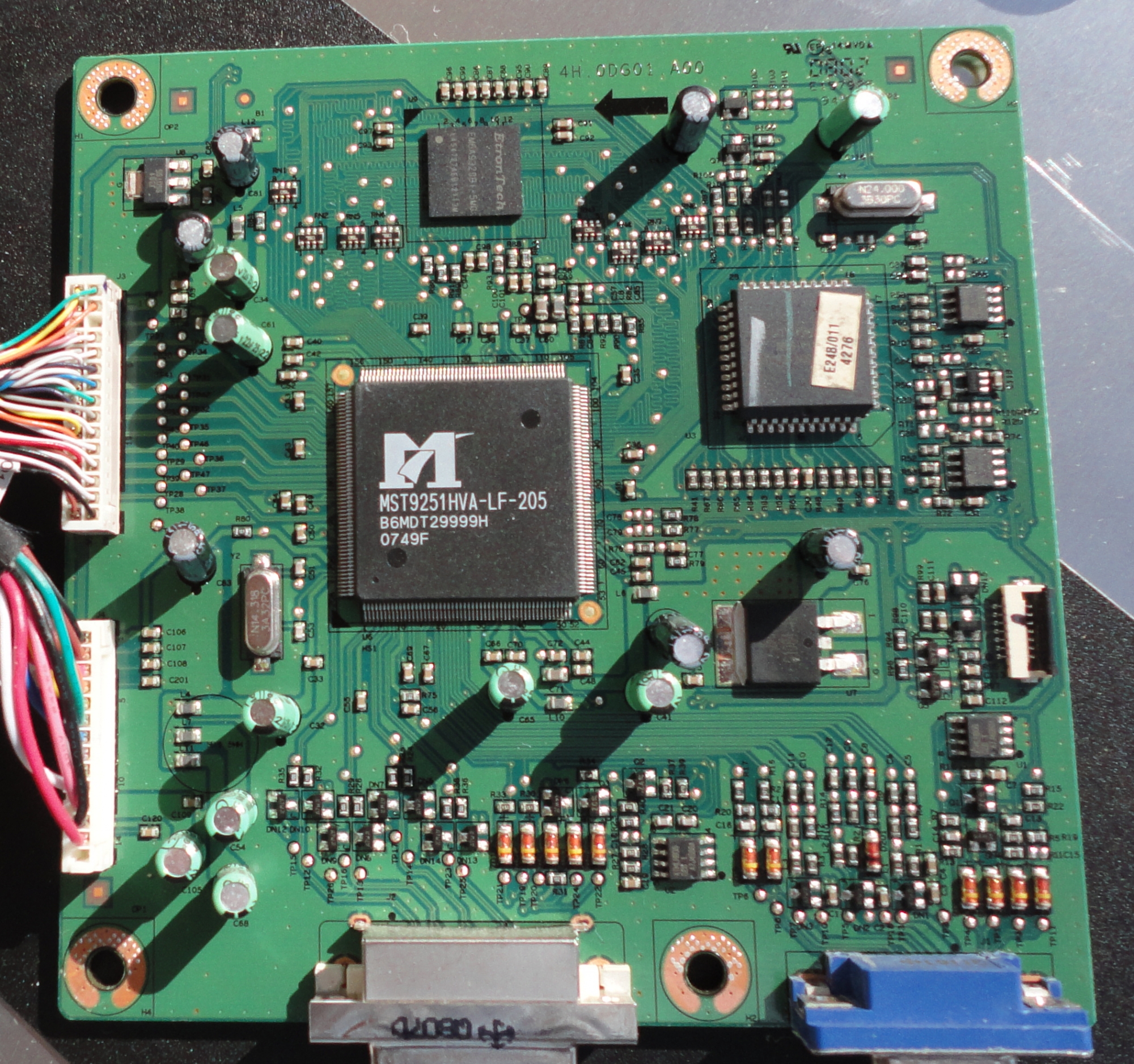

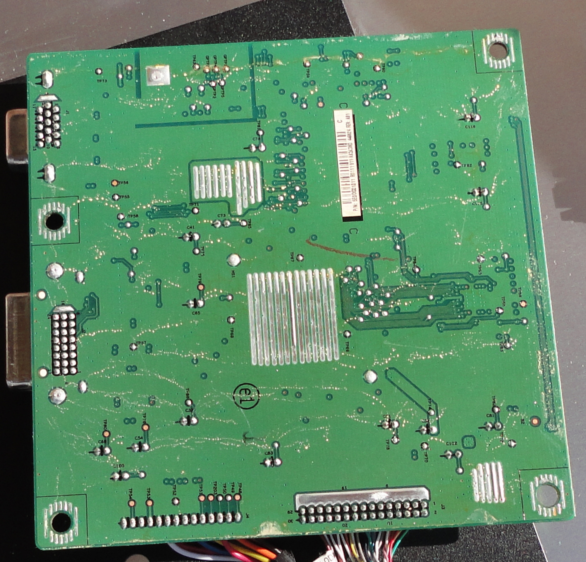

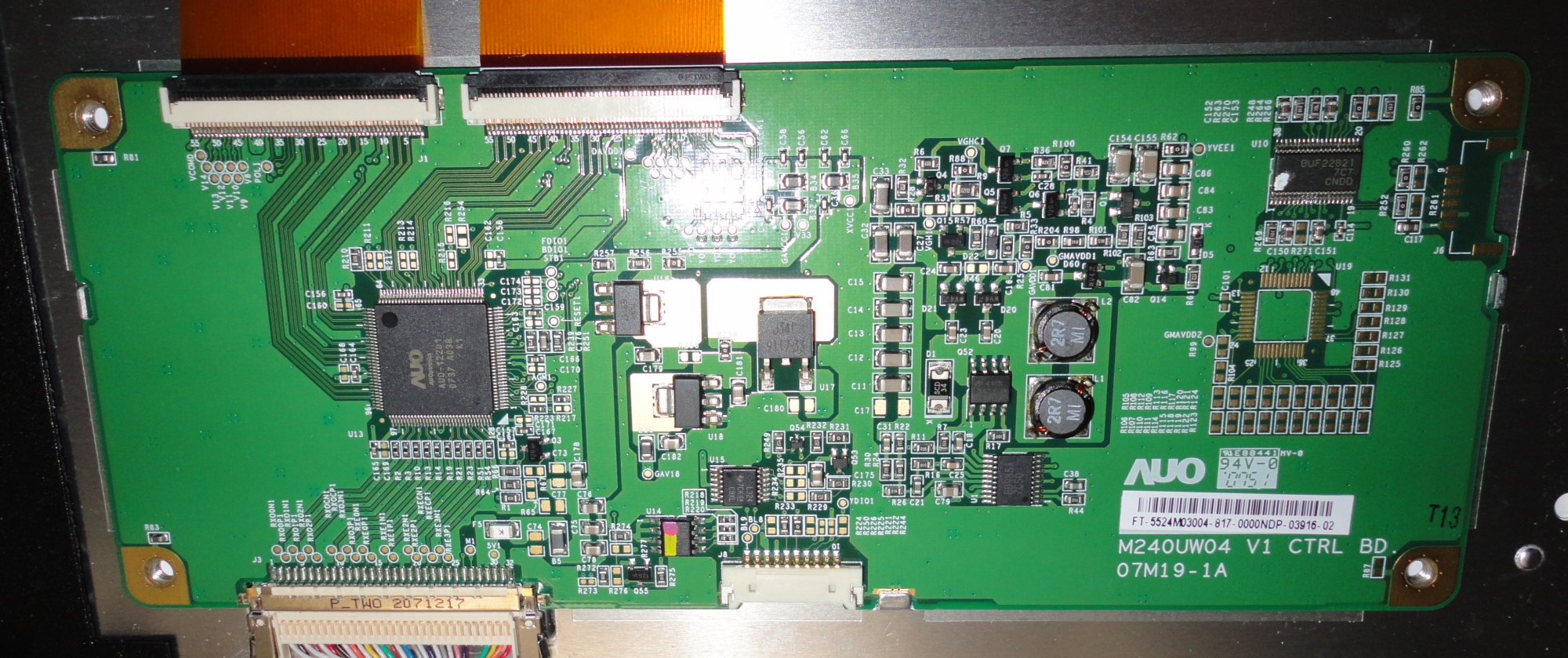

      Somehow I left a picture of the tcon board off, and I suspect it is the most likely culprit!
        Re: Dell E248WFPb lots of vertical lines
        It does not look like panel problem, either T-CON or the main board. How are the voltages on the T-CON?

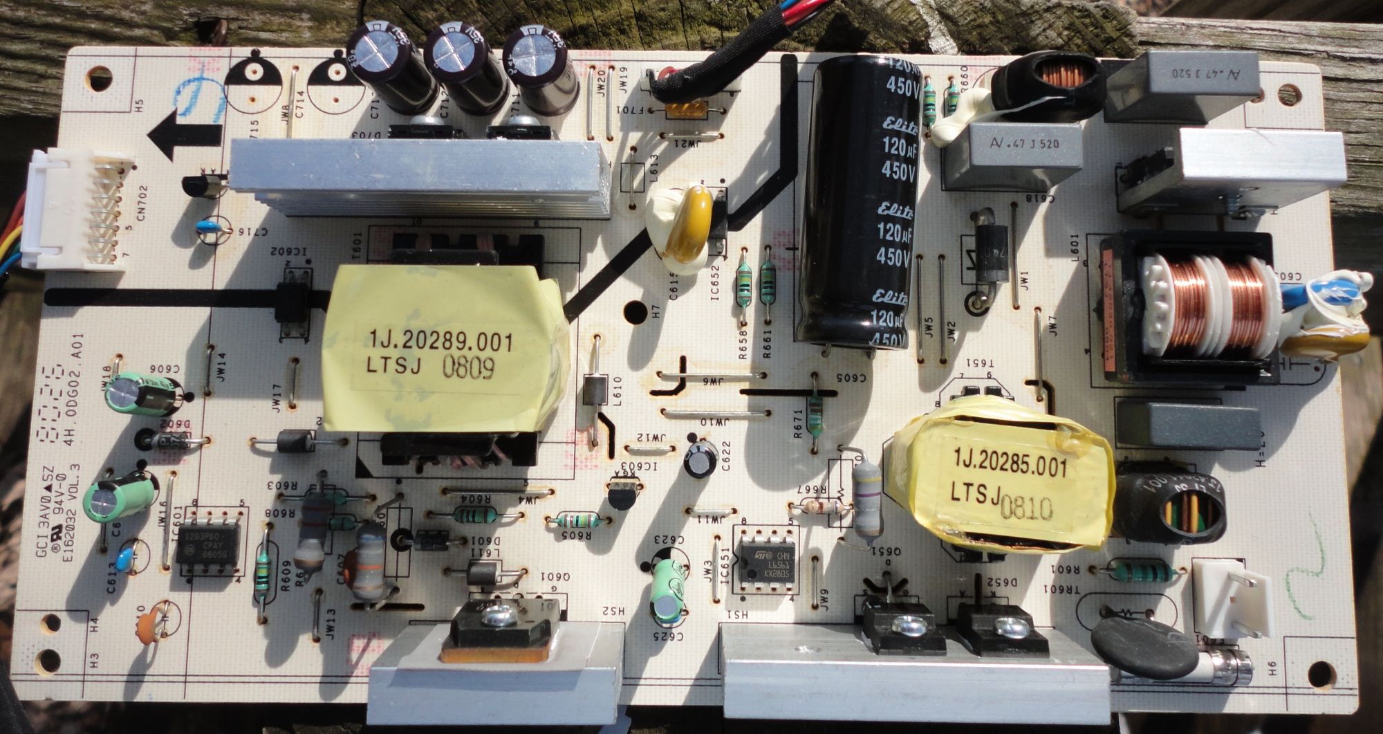

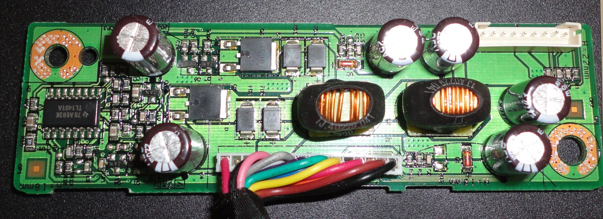

          Voltage across the legs of the main capacitor on the power supply is 164v plugged up, but not turned on. With the monitor turned on it is 303 v. I pulled the main cap and checked it and it's uf value was good. I pulled, tested (they were ok) and replaced the 3 small caps on the main board. Started it up and it still has the vertical lines.
          Working upstream, I will now pull and test the caps on the 2 small boards that are between the main board and the tcon.

            I pulled and checked all the caps on the small board that connects to the main board; all were good. When soldered back in, the same problem persists.

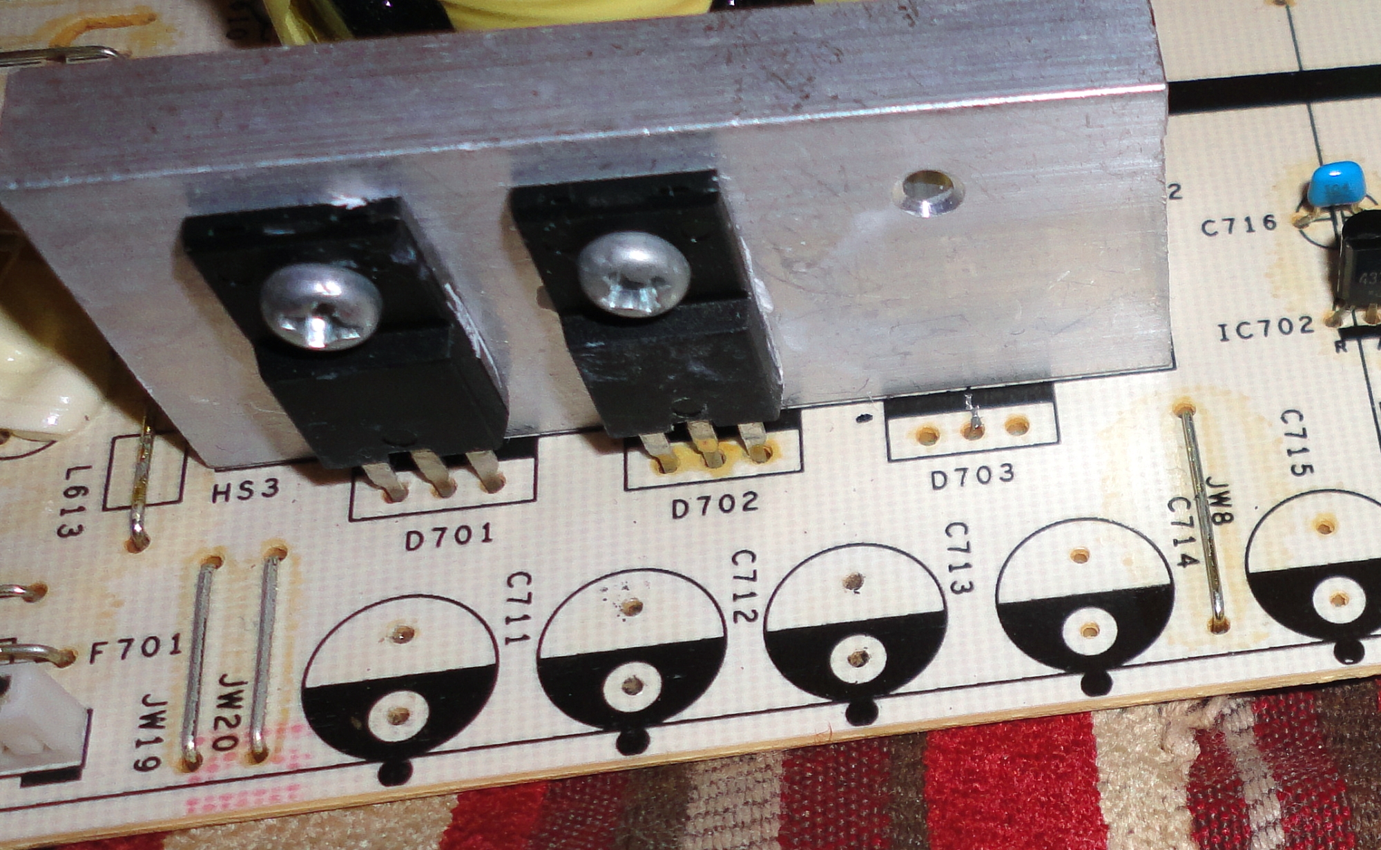

            While replacing caps on the main board, I did notice a discoloration around D702 (picture); I don't know if it is significant and I don't know how to check it. Any help would be appreciated.
              No no no wait... that is not main board, please stop dismounting all the things without a reason, budm, YOU and i suspect the T-con especially and main/scaler board, the little board contains for what i can see 1 or 2 switching dc-dc reg. so if you want to suspect power issue test this board's outputs and report, after test also the T-con testpoints especially GMAVDD2, VGHC1, GAVDD1, GMAVDD1, VGH1, XVCC1, GAV1, GAVCC1, DAVDD1, V33, 5V1, VcomD, after search the web for the keywords -one of previous and the model of the panel- for example "(GAVDD1 OR GMAVDD1) LTM240T1-V2" so you can find places where someone, for example other users, post their voltages, bye!
