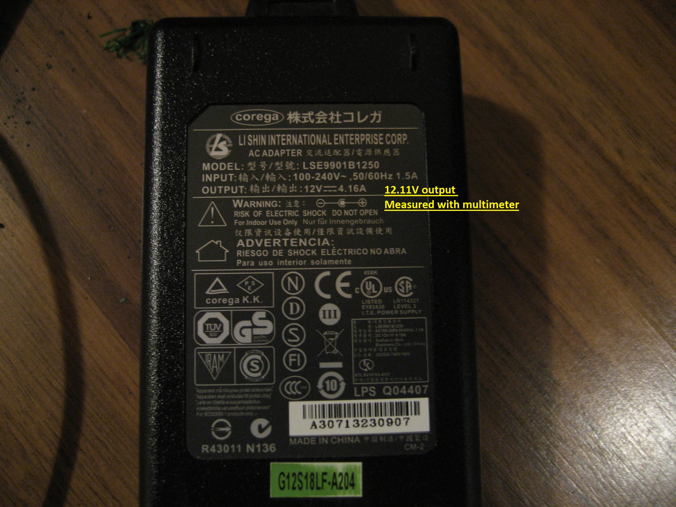

    • Measured output of external power supply with a meter and am getting 12.11V. External power supply is rated for 4.16A @ 12V DC (as shown in attached photo)
    • Connected the Monitor with different power supply (lab PS high quality) and the same issue occurs. PS was measuring only 0.6A draw @ 12.11DC setting.

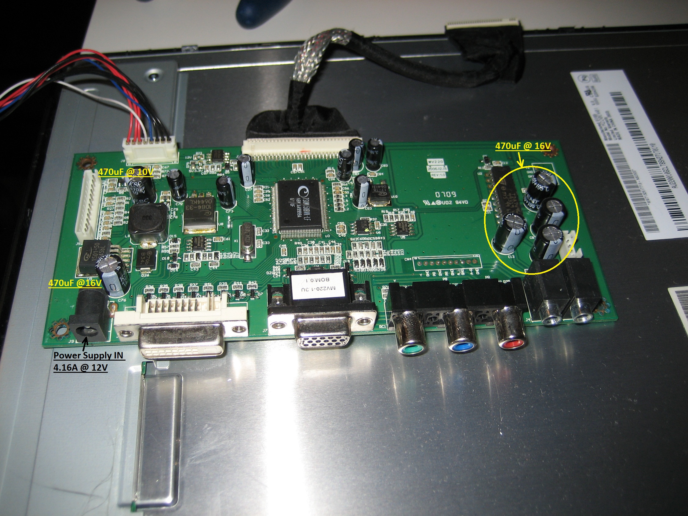

    • Opened up the monitor and checked the main board and inverter board. No signs of burns, boards look clean, no signs of capacitor bulging or leakage as shown in the attached photos.
    From what I have read it seemed logical (and cheap) to replace all caps and retest. Before I did this I was hoping someone with experience could tell me where to start with replacement first (identify which caps could be the culprit and replace first) or any tests that I can do to identify if any other part may be problematic.

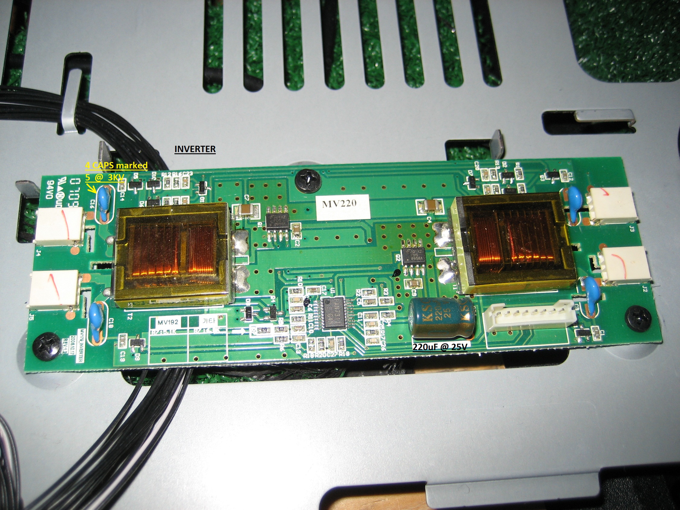

    You probably have 2 seconds to black - click on troubleshooting computer displays above and there is a sticky guide by retiredcaps. Start at post 19
    On the inverter board test the secondary windings on the two big transformers.
    Cant be sure but looks like the joints are going to be straight in line with the
    lamp sockets. Report results - if they are ok then suspect that KSC cap

      Thanks for the quick reply. Measured winding on both transformers and am getting resistances of 905 and 915 ohm. I would think they are ok?
      Connected another capacitor of the same value in parallel with the KSC (essentially making sure that I get the capcitance required) and it made no difference. Perhaps this cap needs to be replaced...
      Checked the screen with a flashlight and I can see the computer icons (very dim) so definitely this is a 2 seconds to black issue type. It seems like the CCFL are not lighting up. This can be on the inverter, safety shutdown mode due to other components or the CCFL themsleves (one is fried? and the rest will not light up).
      I am reading the guide by retired caps to learn more about potential issues and how to test each...Meantime will order a replacement for the KSC cap...
      Any ideas on what to do next are welcome...

        Connected each CCFL one by one and this time I would get a short flash and then they would turn off. It was the same for each of them so I am assuming CCFLs are ok.
          Re: Hyvision by Megavision MV220 LCD monitor goes blank after 0.5-1 second
          Replaced the KSC Cap in the inverter with Panasonic EEC-FC1E221BJ and the monitor is working now. Thanks for your help.

                Can you tell me which cap or caps you replaced in the picture? Is it the 470uf/16V one?

                  Can you tell me which cap or caps you replaced in the picture? Is it the 470uf/16V one on the lower left corner?

                    220uF 25V Panasonic FC series low ESR. You can use FM instead.
