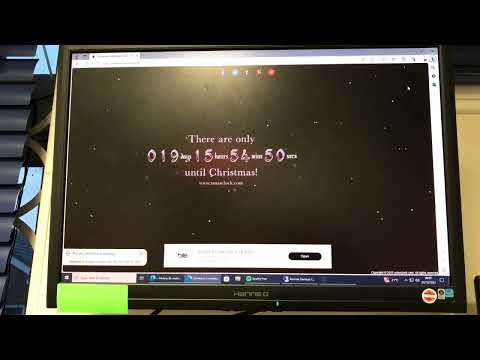

    I've got a Hanns.G Hi221 Monitor that works for a moment and then the display goes off but the power LED indicator remains on. If you power it off and back on again it does the same thing, it comes on and then the display goes blank. From a cold start it takes 10 seconds or so before the display goes blank but if you turn it off and then back on again after it already being on it goes blank a lot quicker so I'm assuming something is getting hot which is causing the display to go off.
    I've uploaded a video of it happening on YouTube:
    I've taken the monitor apart and have inspected the main board:
