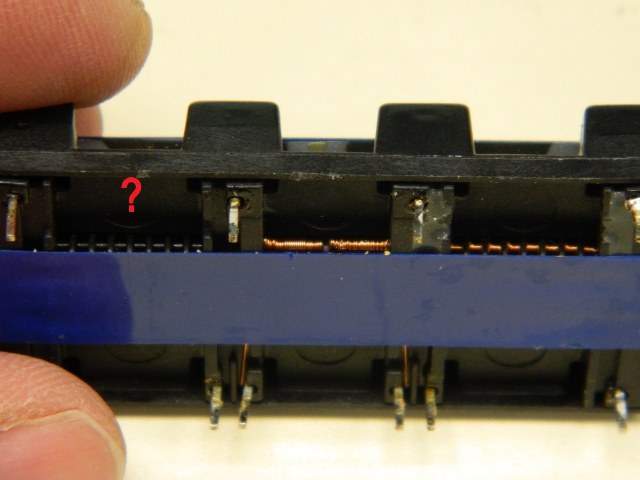

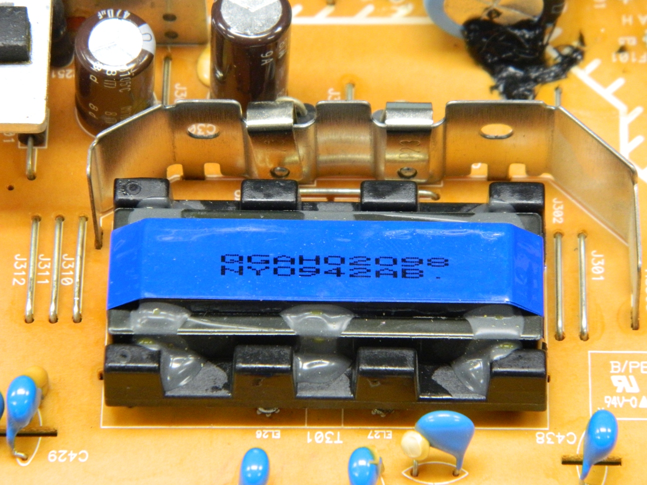

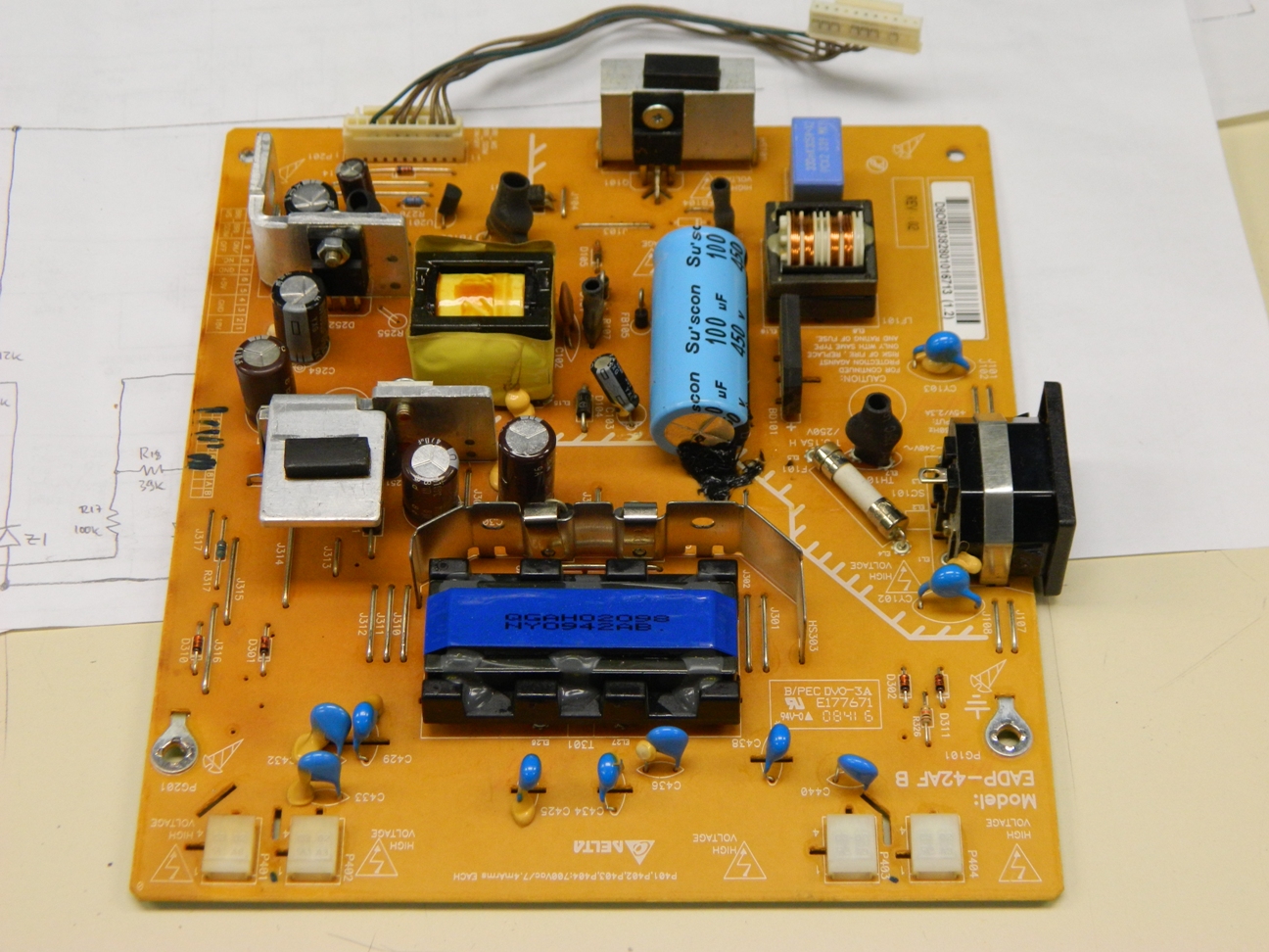

    maybe somebody can help me with this. I got a W2252TQ monitor from someone whose backlight doesn't turn on. I was told somebody has already tried to repair it but had no success.
    The monitor turns on very dim for about half a second and then goes black, when shining light on it I can see that it is just the backlight that is missing, the picture is there.
    On the attached pictures you can see the transformer which is a QGAH02098. The transformer has apparently two output windings, there are cables connected to all four connectors that go inside the screen.
    Now something strange. The transformer measured open on one output side. I took it out to see if the winding is visibly burned. The corresponding (open) output doesn't even have a coil (see picture)!!
    Why would they connect cables to an output winding that doesn't exist?
    The transformer has already been soldered and my guess is maybe that the person who tried to repair it put the wrong one in.
    Can somebody with the schematic at hand tell me what's the correct transformer for that board or how many output windings it's supposed to have?
    thanks for reading

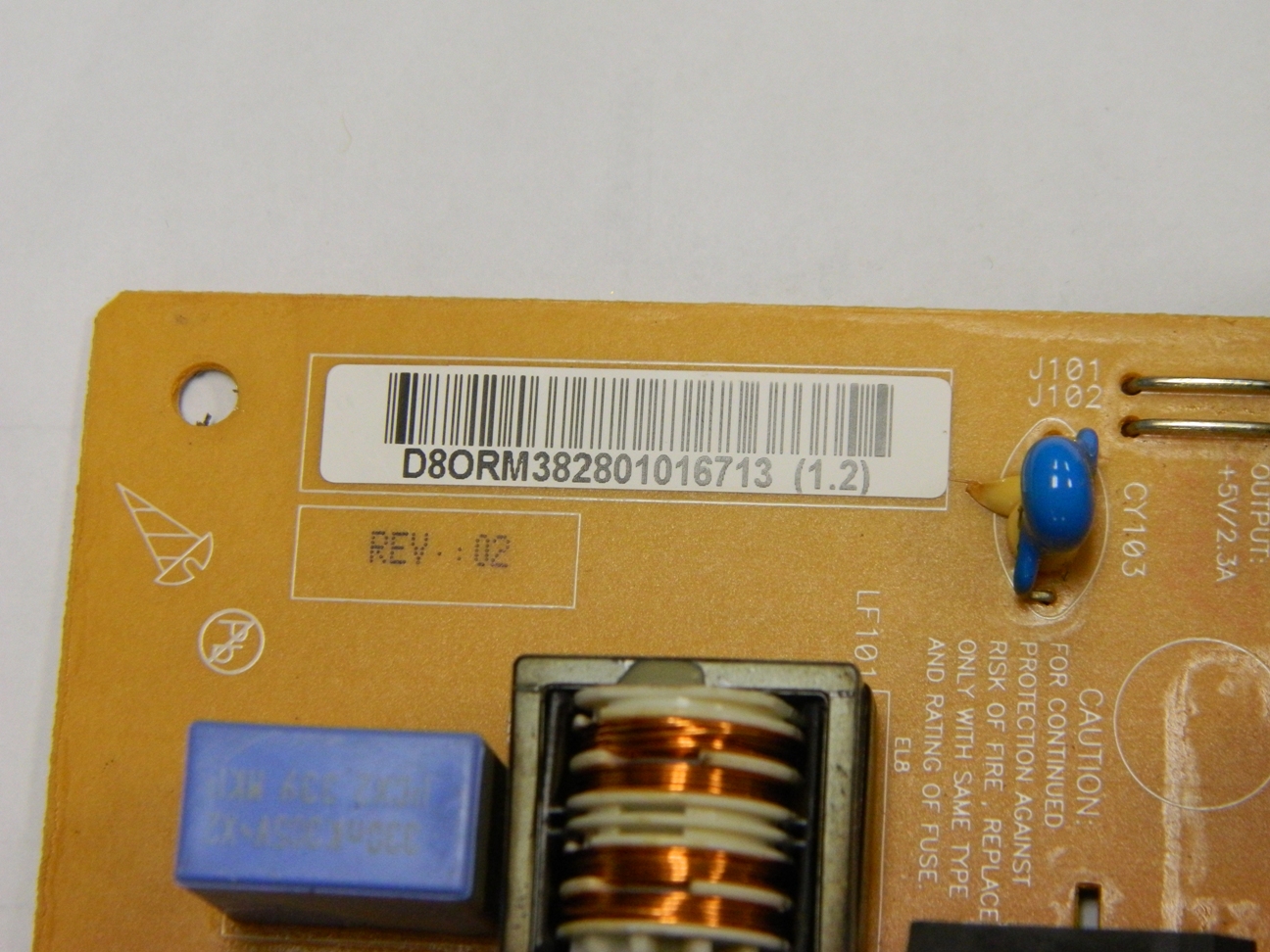

    I dont have time right now but board number is EADp-42F if you search for that you will find images and see what transformers they have.
    Look for your transformer on lcdparts.net. click on buy it now (it doesnt )
    My guess would be its a hard to find one and someone has taken it off to see if they could rewind it, failed and just put it back.

      The transformer looks like new though. I also find easily some on ebay and amazon for 10 to 15 bucks.
      I'm not particularly experienced with computer display repairs, do these transformers have in general two secondaries?

        The pins are there for mechanical reason, to hold the transformer firmly into place. It is possible that there was no winding there in the first place.

          The transformer is being offered as a replacement for Samsung BN44 00264B.
          Now, I did find the schematic for BN44 00264A. The transformer definitely has two secondaries.
          I get the impression that the cheaper options we get over the internet are fake components. So the person that replaced the transformer bought one of these and put it in and it didn't work.
          I don't see why any manufacturer would put in extra unused components (the cables) into a $200 product.
          Maybe I open the display itself to see if the cables are indeed connected to something.
          I still would appreciate if anyone has a schematic for that board or at least part of it, the part with the transformer.

              Ok, after some more research I've seen that the transformer is obviously not the right one. The board EADP-42AF uses the TMS93137CT. And this one has two secondaries. And the TMS93137CT is sold on ebay as the right one for the W2252.
              So my guess is the person repairing it was confused and put the wrong transformer in. I'll order the TMS and see if it works.
              Thanks for your input.

                Correct - its this one

                          Thanks I'll have a look at it later. What is strange is that there are wires connected to the in-existent transformer winding. I think somebody tried to repair it and put the wrong one in...

                            That`s what happened, I was right. Someone tried a repair and put the wrong transformer in. The monitor works with the transformer TMS93137CT.
