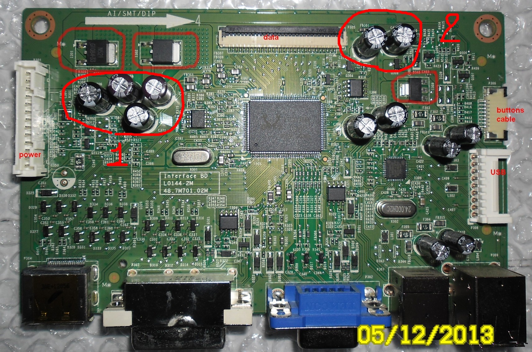

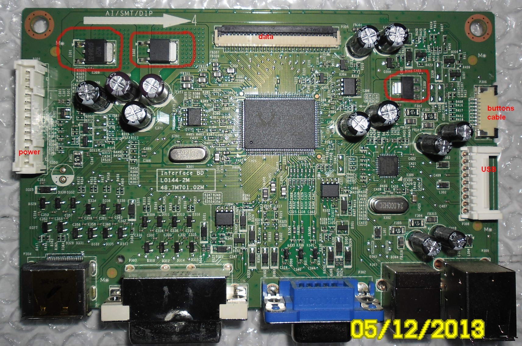

    Can you post a picture of the garbled screen? There's a lot of trained eyes on this forum and the actual picture you see is important. This might also be a T-Con board problem.
    You could start by checking the voltage regulators on the main board. I circled them in red. Retiredcaps has an excellent guide on this. https://www.badcaps.net/forum/showthread.php?t=22231

      I will assemble the monitor in the morning to take a picture and check out the voltage regulator readings.
      regulators:
      UTC
      LD1117AG
      12A01PAT2
      http://html.alldatasheet.com/html-pd.../2/LD1117.html - supposed to be the 1.2V 1A variant.
      N521
      G1084-33
      http://html.alldatasheet.com/html-pd...4-33T43UF.html - 3.3V 5A
      this last one (the smallest regulator) I can't find:
      D || 2GF <-- cant figure out what the first, second/third characters are
      17-33

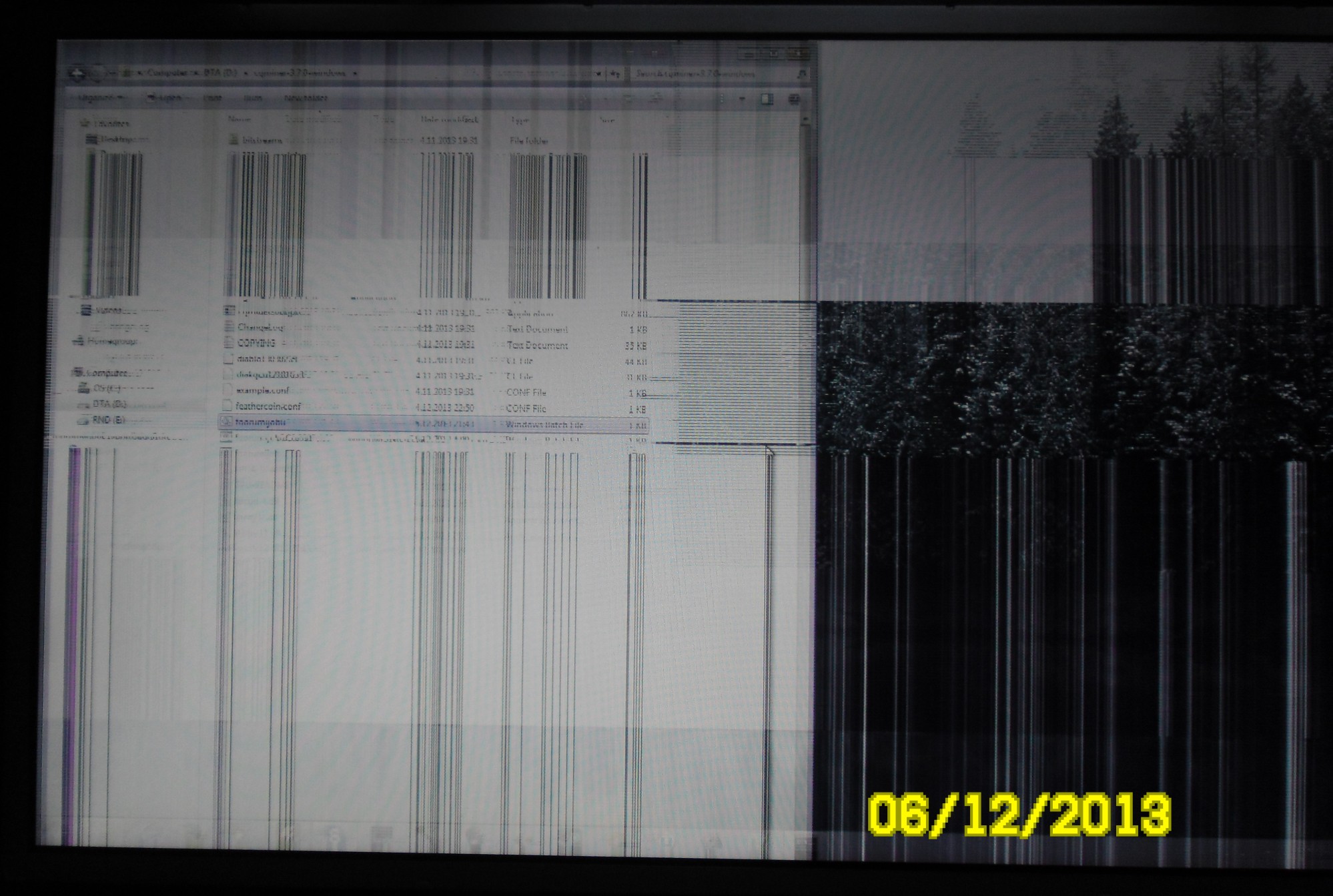

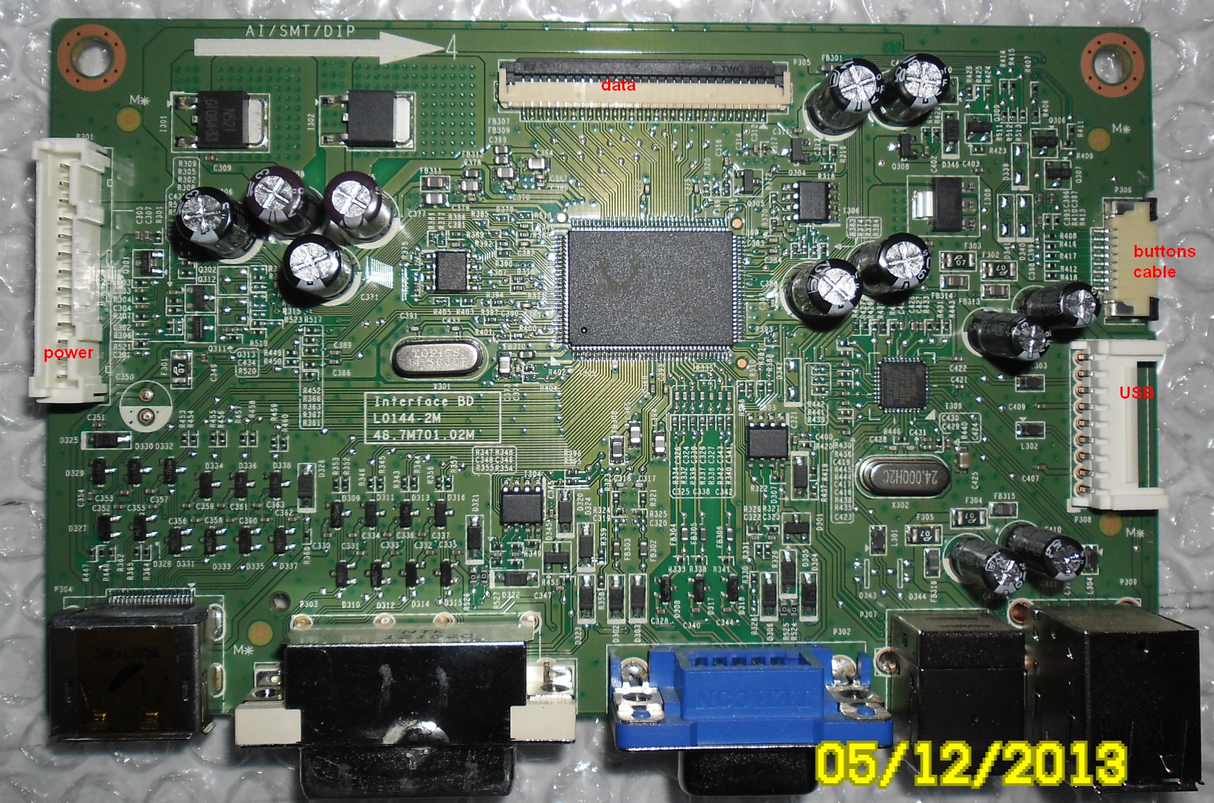

              I recorded a short video:
              https://www.youtube.com/watch?v=yCXnIvf5IRM
              I have also attached a photo:

                That video helps a lot! You need to do what budm said and heat the capacitors on the main board and see if the picture gets better. Post #4. If you are lucky its one of those caps on the main board. Next would be the voltage regulators. Selldoor figured out the 3rd one. Excellent work Selldoor.
                Here's a video for everybody on fixing a main board with a bad voltage regulator. Norcal is an excellent technician and teacher. https://www.youtube.com/watch?v=cNFzBJELFoU
                If you are lucky it will be a cap, or a regulator on the main board. Otherwise you are looking at T-Con or even worse.....bad LCD panel. Good luck!

                  i tested the regulators:
                  N521
                  -- 0V
                  - 3.3V
                  -- 5.16V
                  UTC
                  -- 0V
                  - 1.2V
                  -- 3.3V
                  the supposed 1177-33
                  - 0V
                  - 0V
                  - 0V
                  Am I doing something wrong with the 3rd one? I couldn't get any readings from it at all.
                  I measured the regulators several times.
                  Also, the image stabilized after a while, then occasionally became garbled again and then stabilized again.
                  How much heat are we talking about with the caps?

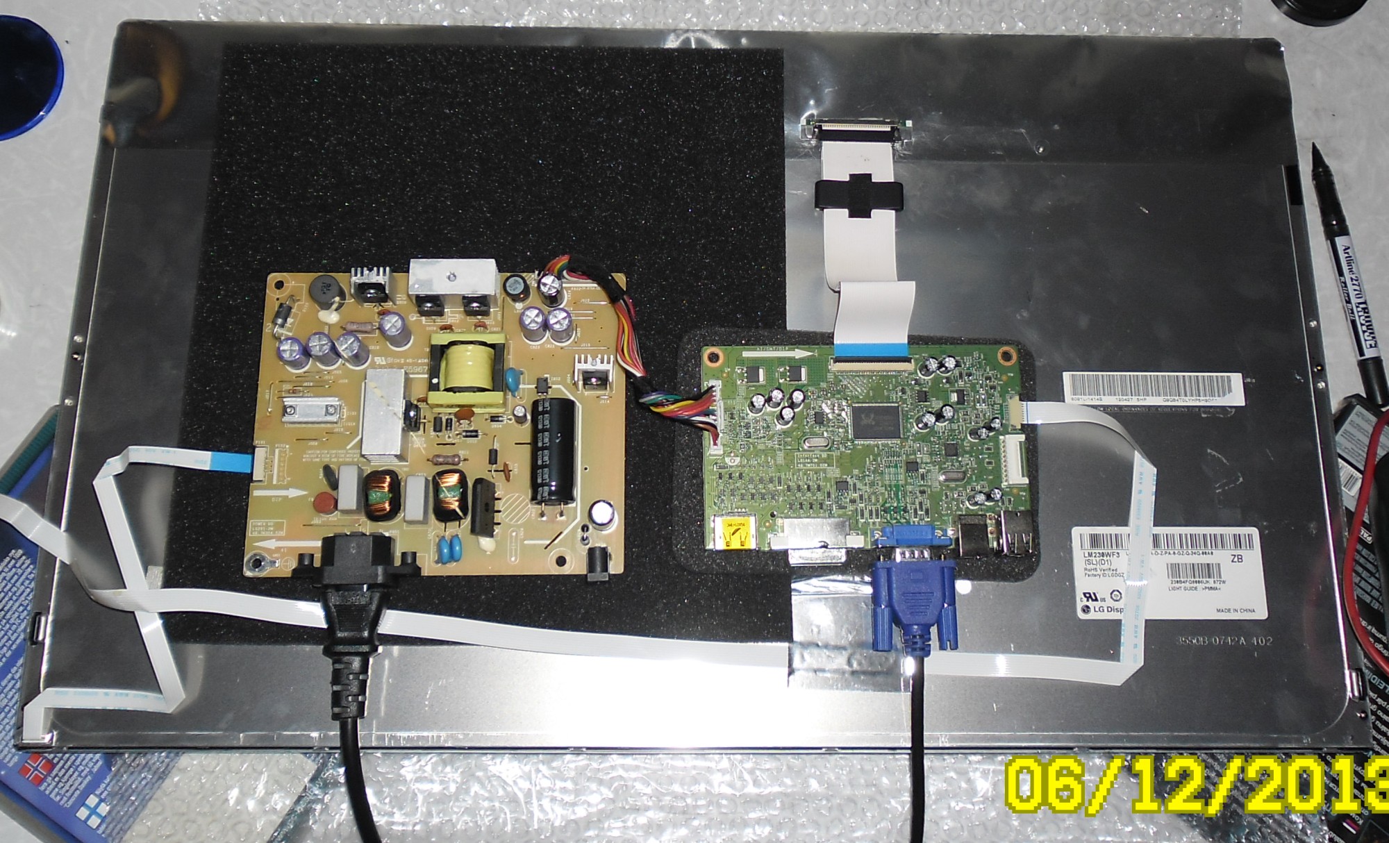

                  the room temperature was ~25C when I was testing, this is what it looked like:

                    Re: Dell U2312HMt garbled display

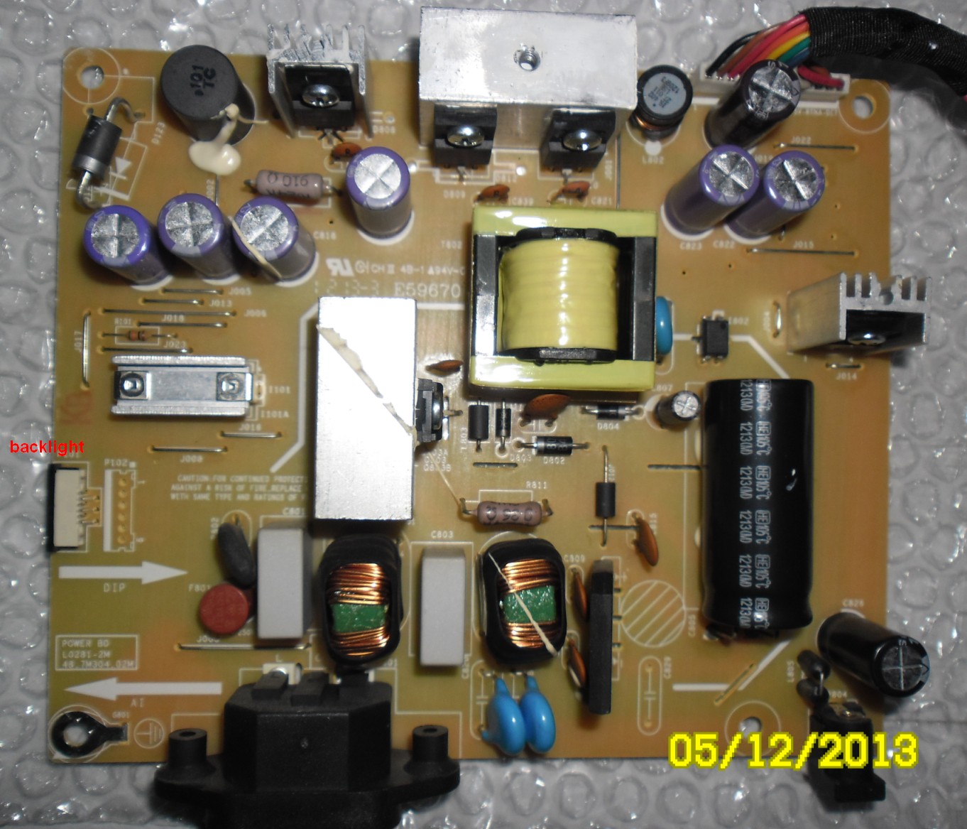

                    As it is working as well as it is I find it hard to believe they will be bad
                    but can you test the two fuses below (in your Picture) the 1117-33 regulator.
                    Test resistance with power off and with power on voltage on both ends
                    Heating caps - use a hair drier - not too hot though.

                      The 0,0,0 volts to the 3rd regulator is very good news. And here I thought you might have a bad lcd panel *whew*!!
                      If you are saying the image stabilized after you heated that area; then the most likely culprit is a bad capacitor in that area around the regulator.
                      You should definitely test those 2 fuses F303 and F302 underneath it like Selldoor said. But it's probably at least one of those 6 capacitors around it.
                      I'm not an expert on reading circuitry from the top. Maybe you can isolate it, by heating them 2 at a time (together) like budm mentioned.

                              The fuses are ok, no resistance (monitor off) and 5.15v when USB device was plugged in (monitor on), so they're only there for the USB.
                              The 1117-33 regulator is okay too, it only works when USB was plugged in, the readings were:
                              - 0V
                              - 3.3V
                              - 5.15V
                              So I guess the only thing left to do is to check the caps by heating them, but that only works when the display is garbled, right? When the image stabilizes, I cannot test it?
                                      I would concentrate on those two set of caps I redlined. Group1 are for the input and output of the two regulators, Group 2 are for the voltage feeding the T-CON board.
                                      This problem remind me of the HannsG 281 monitor with problem caps for the two regulator on the main board.

                                        I tried heating the caps just a bit by touching them with the tip of a soldering iron. They got warm, but didn't seem to stop the glitching. After that, I had no luck getting the screen to glitch for a whole day or so. I put the protective metal case back on and it started glitching again after 10 minutes.
                                        I also noticed that "cap group 1" on budm's picture got slightly warm (when monitor was turned on), while all the other caps seemed cool to the touch.
