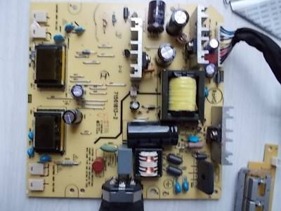

        What is the part number on the power supply may be 715G1813-1 or something like that
        • thestigp11gt
          • Jun 2013
          • 30
          • Scotland

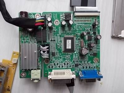

          Re: Phillips 170B Screen goes Blank after 1-2 seconds
          Model Number: EADP-43AF A
          This is the PCB

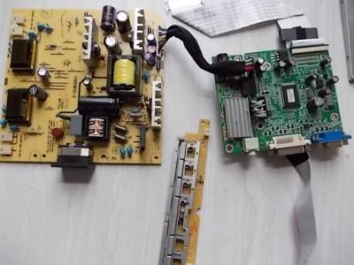

            Ok I will have a look at the pic though we normally require a straight down
            and a pic of the back.

                  Just by chance I have a complete set of working boards for this monitor,although like a lot of monitors with the same model number the insides can be totally different.My lot include the PSU/Inverter 715G1813-2 and the Logic 715G1767-1 VB,the latter having a little plug in PC for the Audio.
                  I set it up on a Dell 17"Test Screen and it all works fine,BUT I did noticethat like yours the LED stays on Green as soon as the Power is connected, AND stays on irrespective of whether there is a PC signal or not,so I think yours is acting the same and is correct.As you do get a 'flash' of Screen initially,for the moment I suspect it is getting a PC signal,and what you need to do is eliminate the PSU/Inverter AND the Backlights !!.
                  On the Power supply connector that goes to the Logic board is there any markings to indicate what should be on each pin ???,and have you a set of test backlights from another monitor ??.I have added photos of my boards,and the same from you may be helpful !!
