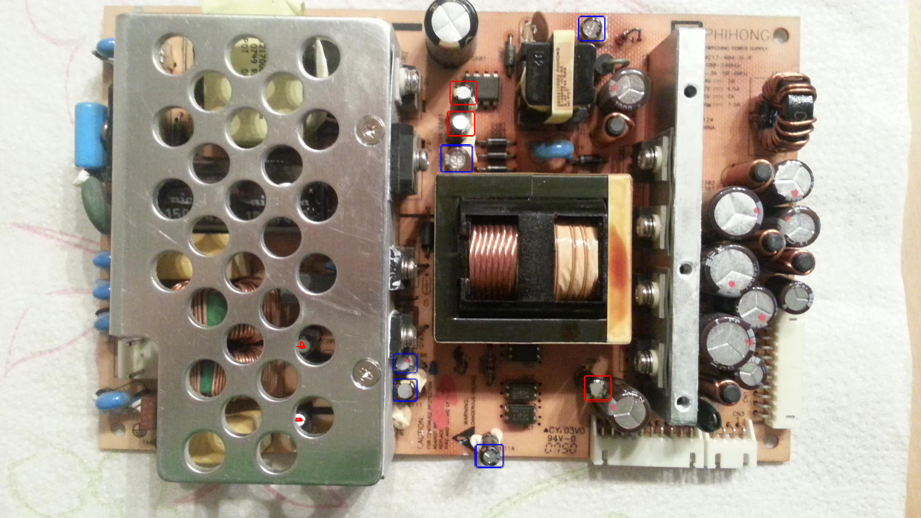

    From the symptoms you describe I would suggest it is bad capacitors on the PSU causing this. Remember bad capacitors might not show any visual signs (indeed ones causing intermittent problems like this are more likely to be still working but on their way out). Your best bet is to test the voltages coming from each pin outputting from the PSU when it is on (be careful!) and reporting them here for the experts to see. But the black probe on a grounded screw and the red probe on each output pin and note the voltage. Take special note of any pins producing fluctuations in voltage. The artifacts could be from a voltage ripple to the a/v board and/or tcon.

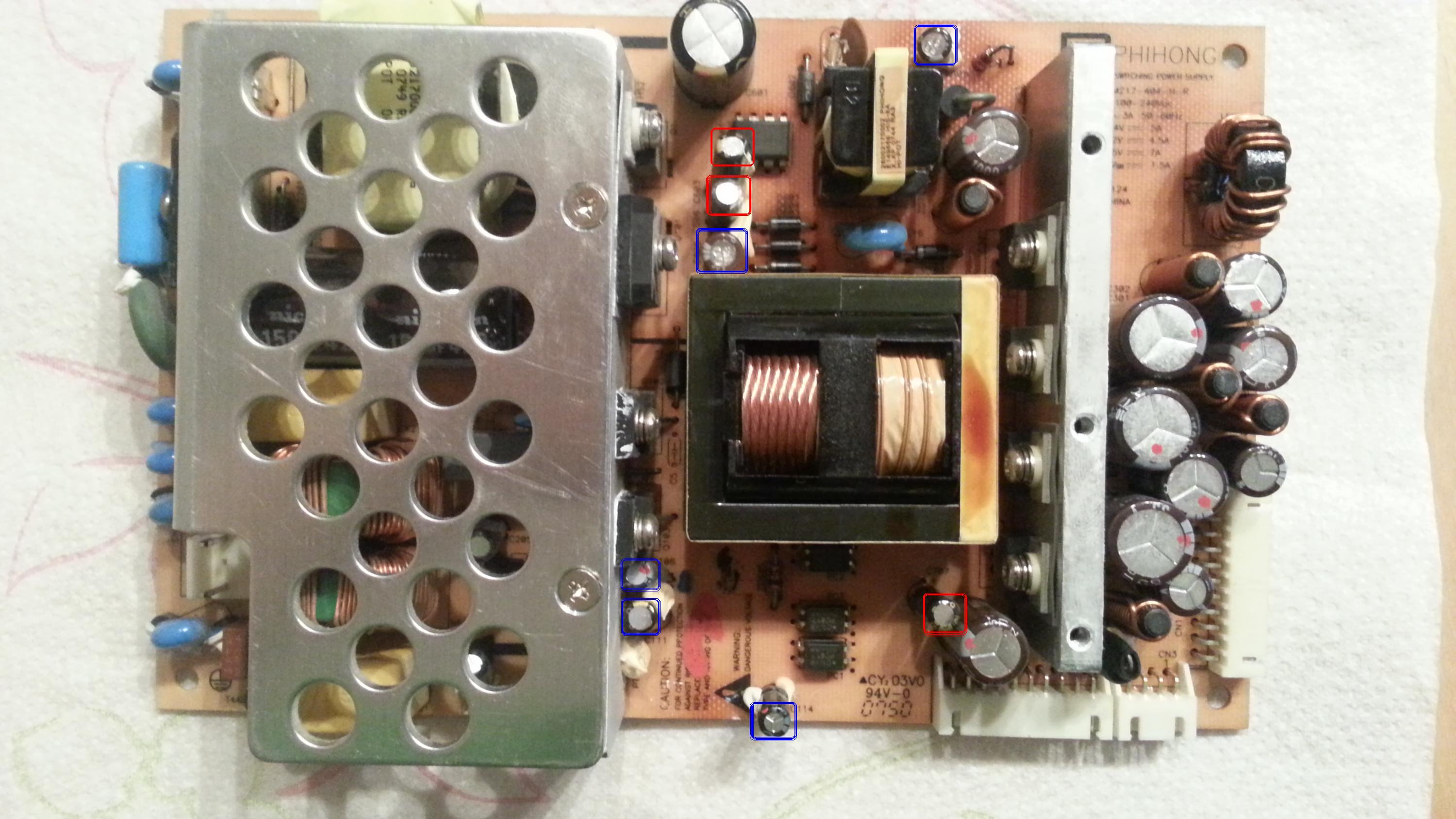

      Correct, in fact in this monitor the small capacitors in the power supply tend to dry out with no signs of bulging.
      Hey Lex. If your power supply looks like this you need to replace the 3 caps circled in red on my attached photo.
      Then on the main board replace the 2 caps budm suggests in this photo.
      http://s807.beta.photobucket.com/use...62664929957295
      That should take care of both problems you are having. Fixed 4 of these. The problem was always the same 5 capacitors. 3 on the power supply and 2 on the main board.
        I would also change caps in red under heatsink

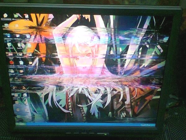

          Seen this before. Besides possible badcaps, the most obvious source of this problem is the LVDS section. Try cleaning the FFC/FPC connectors (on both Tcon and Dscaler board side) and contacts on the LVDS cables first.
          Example of a severe dirty LVDS connection (see attachment). On areas with lots of identical colors, the effect is not apparent. The shimmers and noise becomes more apparent as they appear randomly and gets worse on lines/rows with more picture details (e.g. more color changes per pixel, fine lines, dithering patterns, etc). That's an old ancient Acer AL1717B, by the way...
