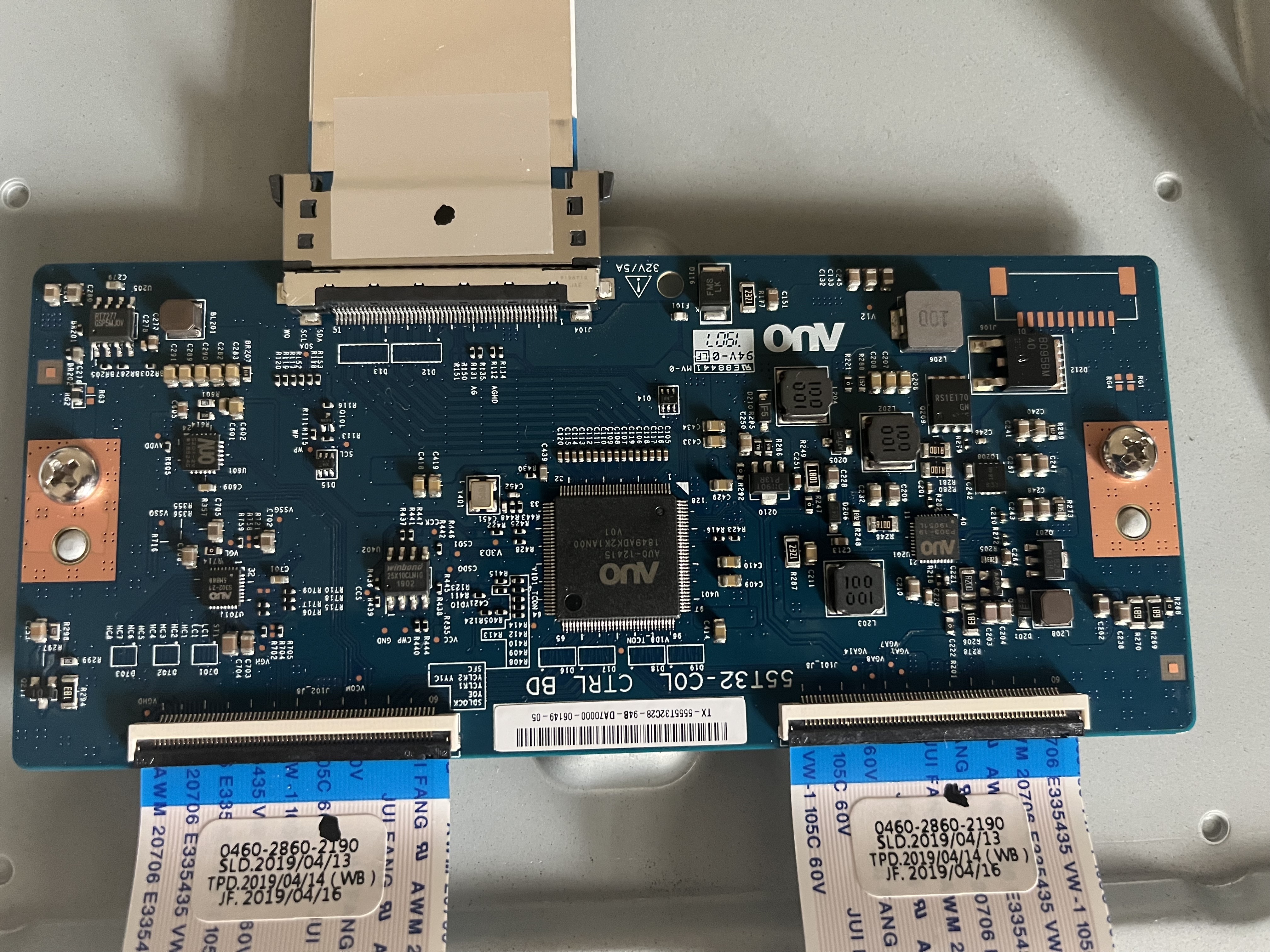

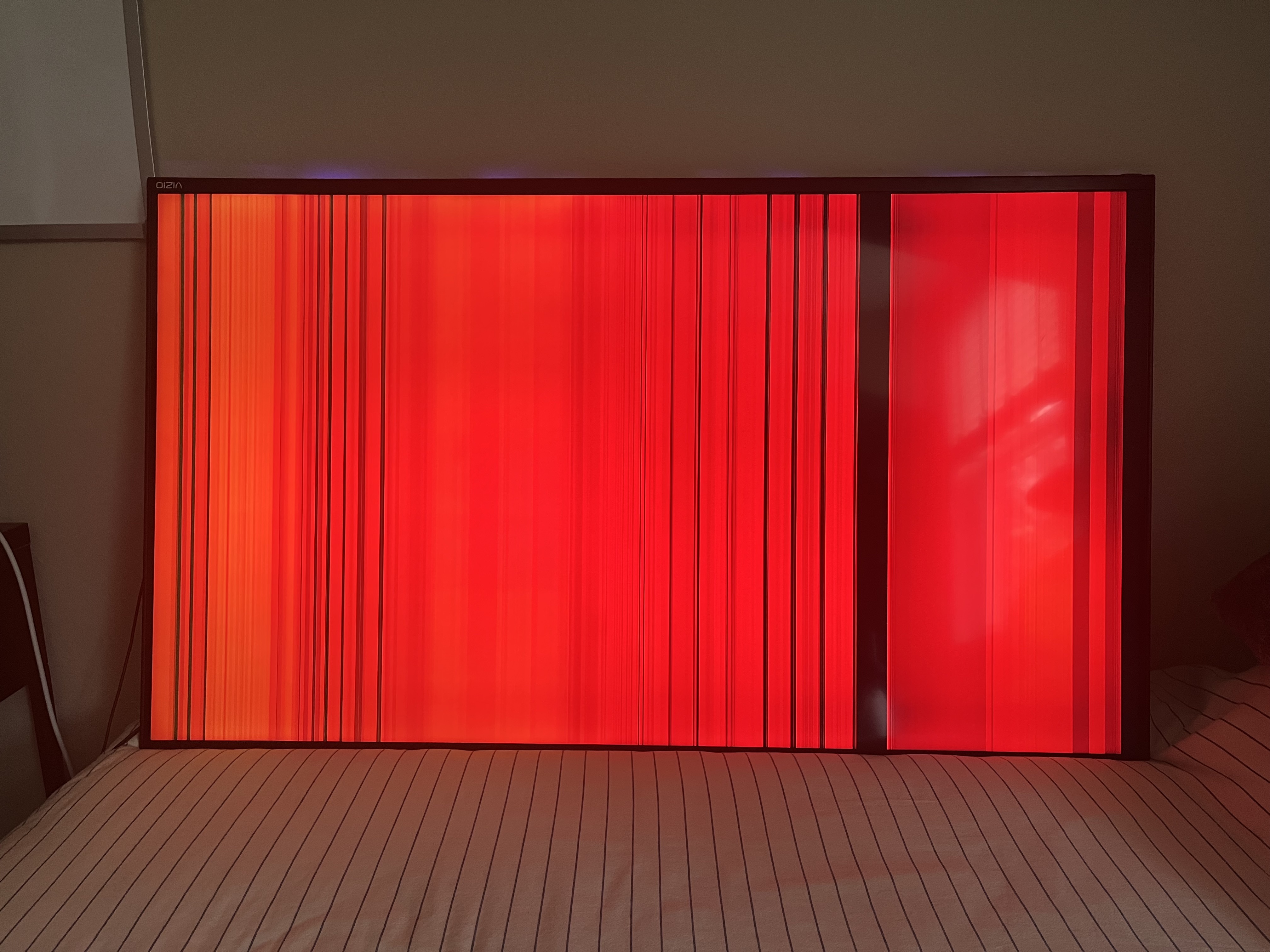

    Failure Symptom
    No Display. Just random blocks of grouped vertical red lines.
    Disconnect right 1/2 panel (rear view), left 1/2 displays properly
    Masking T-Con Signal Diagnostic
    Reduced masking to 5 signals on right 1/2 panel and get perfect picture
    Pins are
    1 GND
    2 VGHD
    3 XON
    4 VSSQ
    5 LC2
    6 LC1
    VGHD and LC1 masking is absolutely necessary to get working panel. Didn't unmask 3-5 individually.

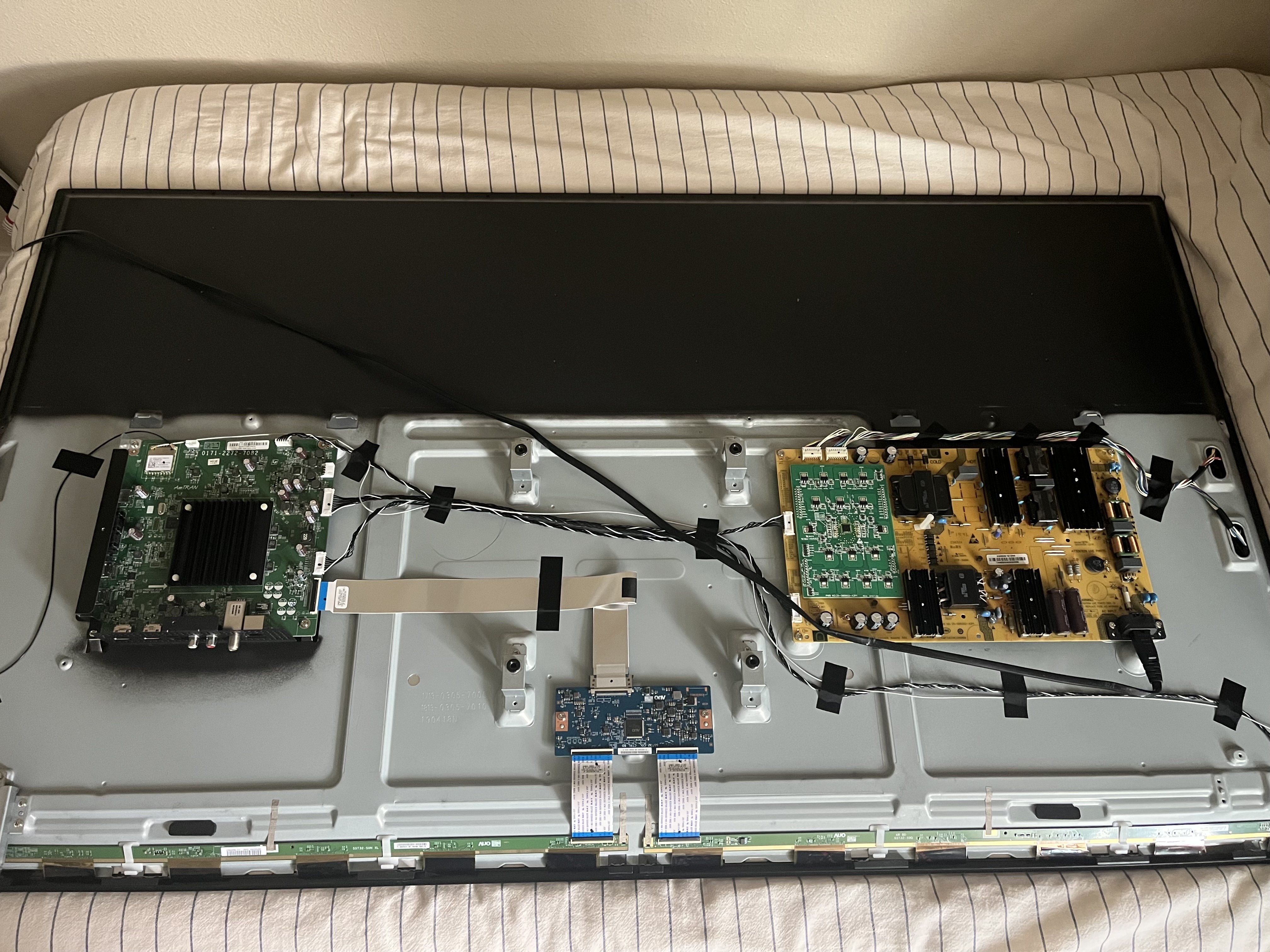

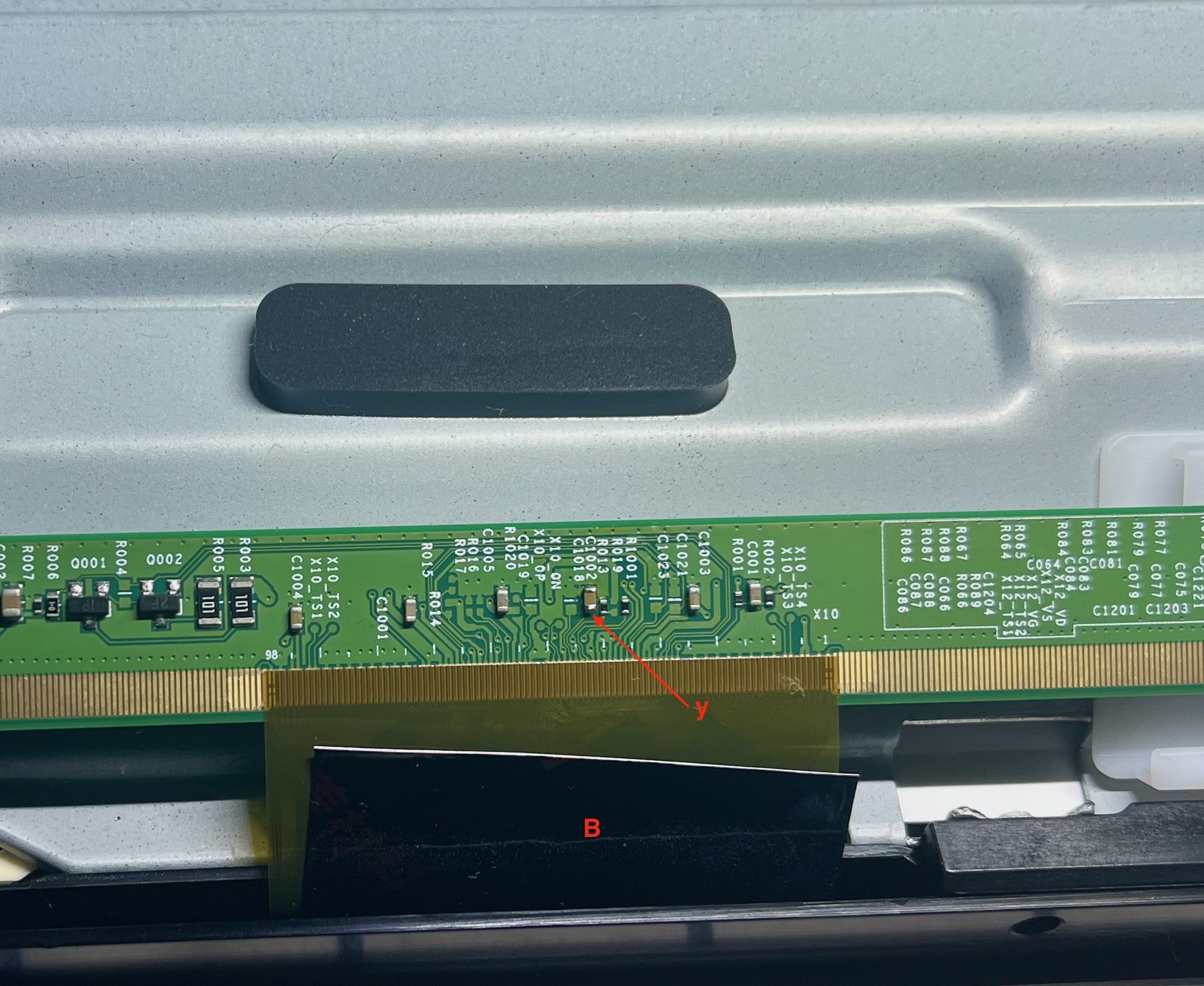

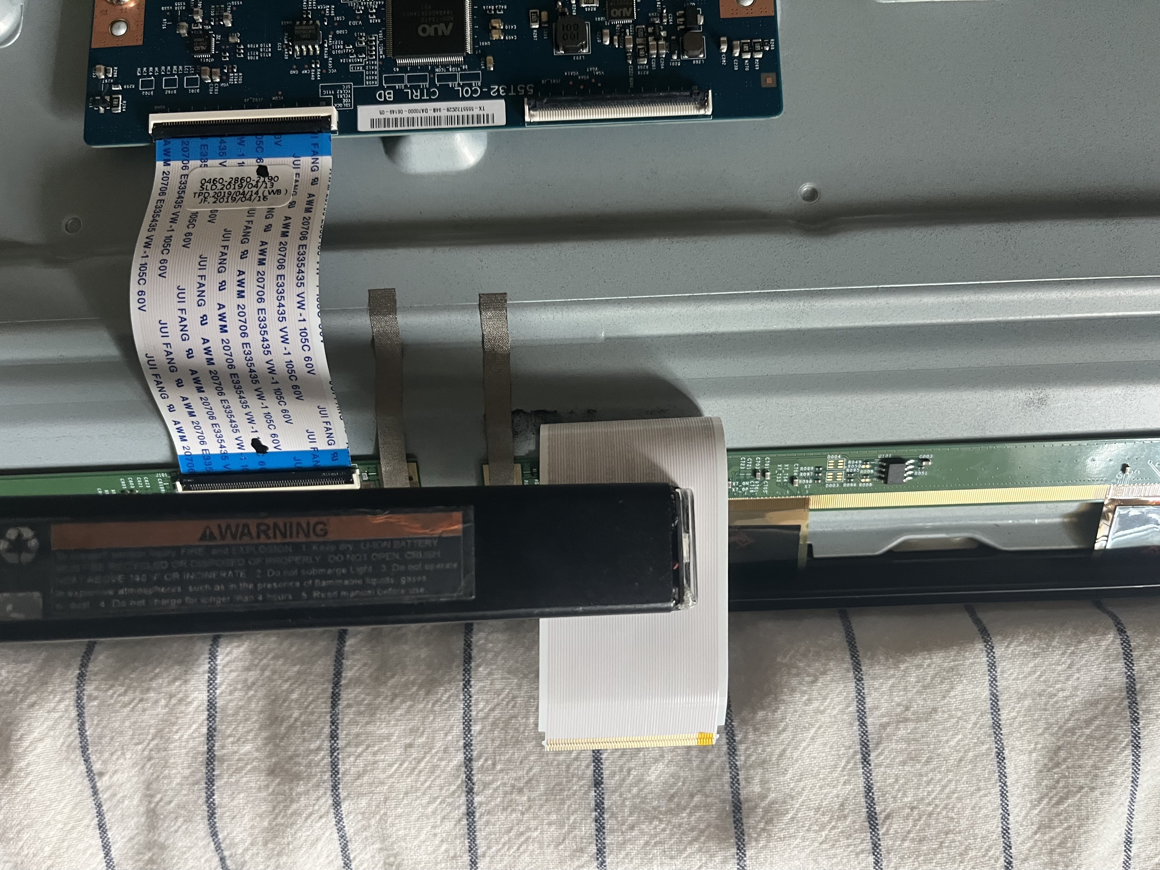

    Pictures and Schematic
    XON, LC2, LC1 are on AUO s302-21 32pin QFN (PDF pg 66 of this HiSense service manual link has pin out)
    Click image for larger version  Name:	IMG_3305.jpg Views:	0 Size:	4.30 MB ID:	3483727 Click image for larger version  Name:	IMG_3304.jpg Views:	0 Size:	2.83 MB ID:	3483721 Click image for larger version  Name:	IMG_3303.jpg Views:	0 Size:	3.27 MB ID:	3483723 Click image for larger version  Name:	IMG_3306.jpg Views:	0 Size:	3.85 MB ID:	3483724 Click image for larger version  Name:	IMG_3310.jpg Views:	0 Size:	3.07 MB ID:	3483722 Click image for larger version  Name:	IMG_3309.jpg Views:	0 Size:	4.21 MB ID:	3483726 Click image for larger version  Name:	IMG_3308.jpg Views:	0 Size:	4.16 MB ID:	3483725 Click image for larger version  Name:	IMG_3313.jpg Views:	0 Size:	3.87 MB ID:	3483732
    Any Better Repair than 5pin Mask?
    3 caps on the lower left rectangle labeled "A" on buffer board are connected to the masked pins. Removing these might produce same repair results. If same, I'll just keep the 5pin mask repair.
    I guess right 1/2 panel higher voltage gate potential line circuit have problems which is why masking them off fixed the TV

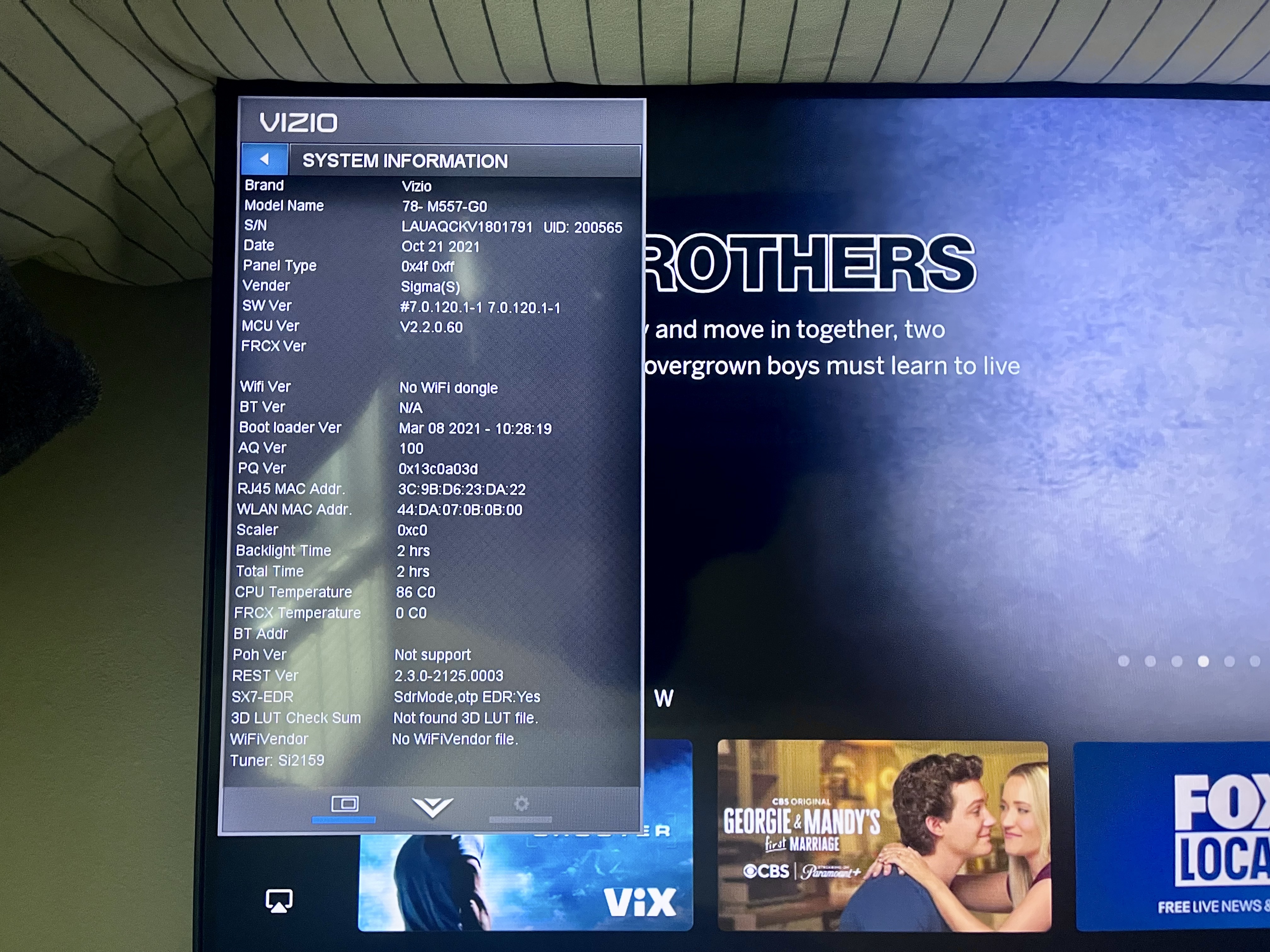

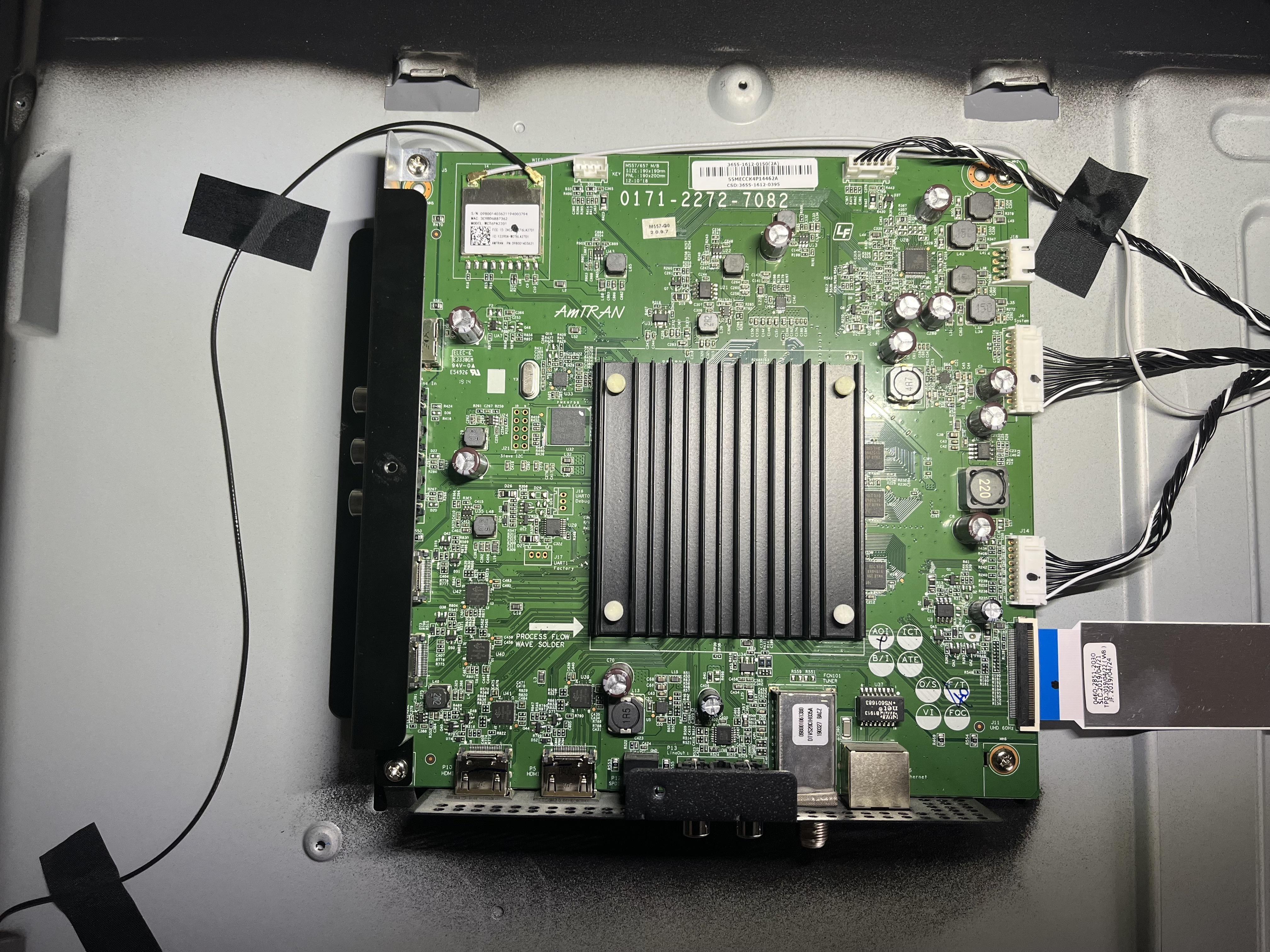

    WiFi/Bt also doesn't work
    Service Mode TV Info seems to show no WiFi/Bt HW. But HW is present on the main board. Factory reset and update to latest firmware did not resolve.

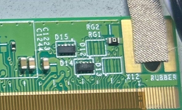

    Diah
    • Feb 2013
    • 6499

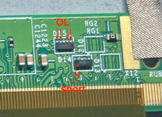

    the most common ESD diode got defect as this section

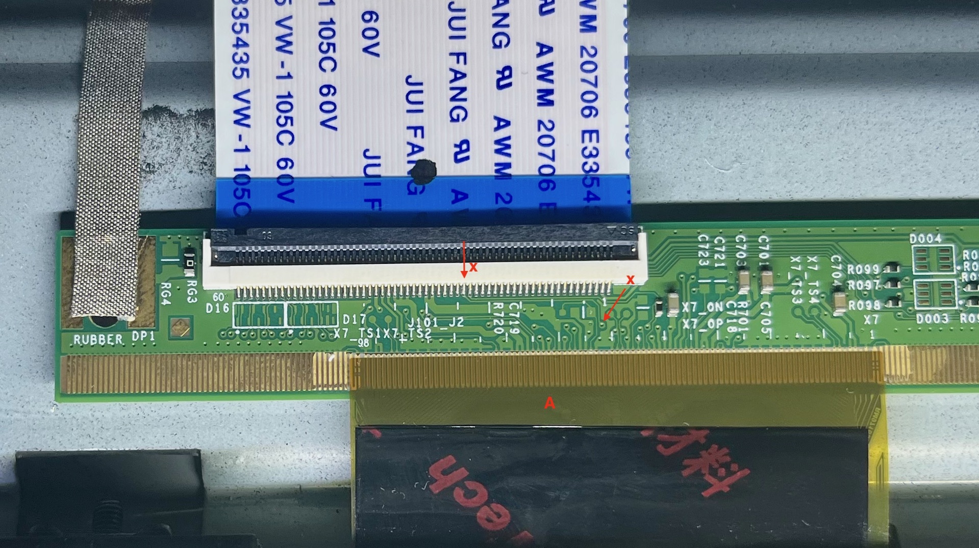

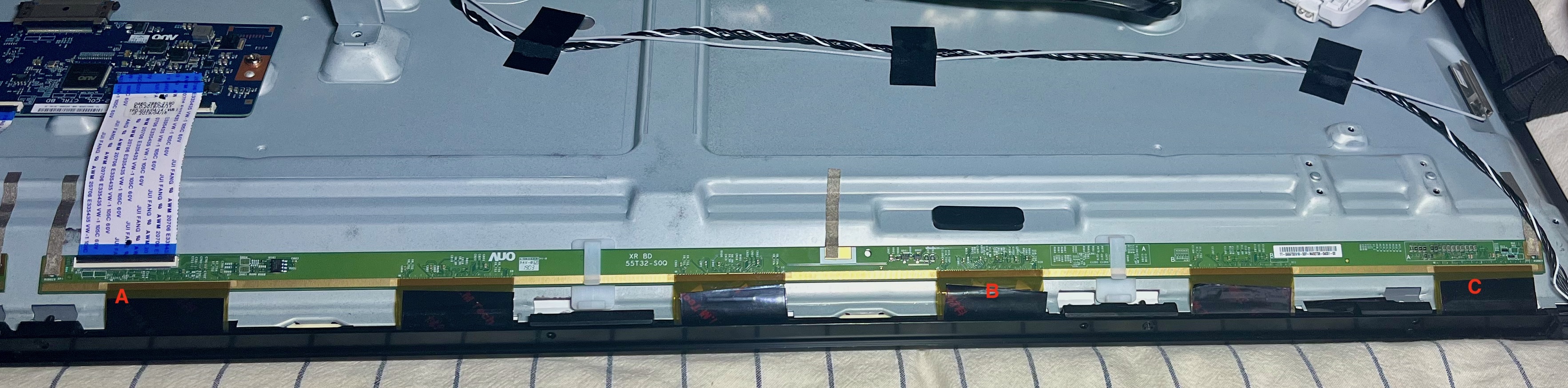

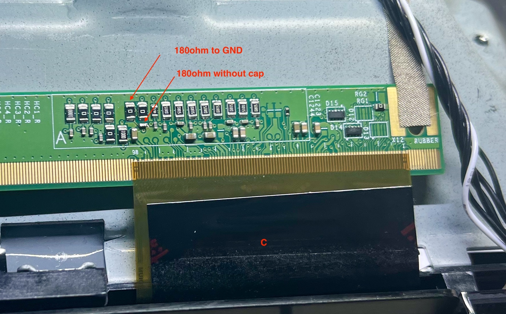

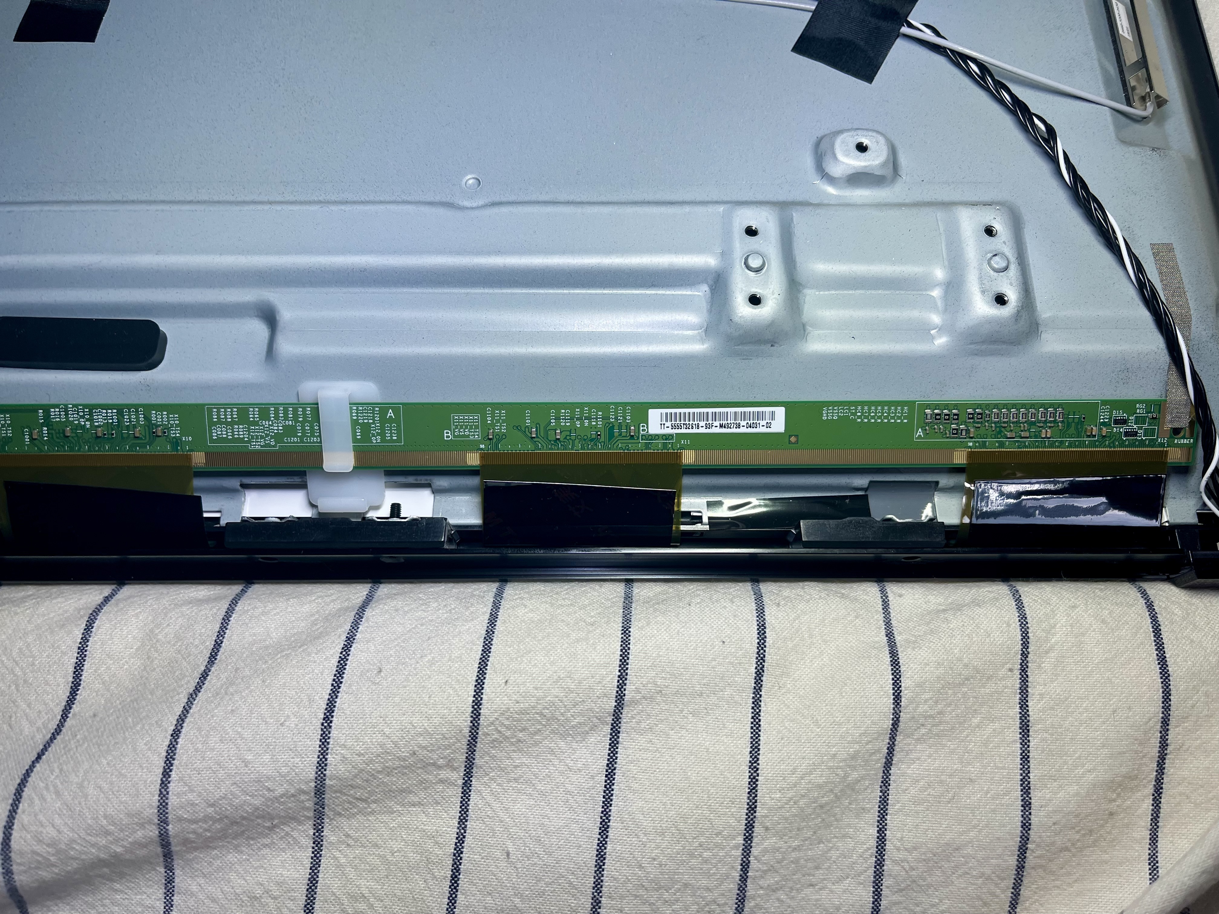

            Found 2 caps with low ohm / short to GND on both sides. Removed the cap and low ohm/short is still present. No short on both cap. No other short / low ohm caps on buffer board.
            • Section A, B, C on buffer board are examined
            • Section B y is 5.2 ohm to Section A x. x pin on flex connects to GND on T-Con. Cap is not short.
            • Section C cap pads measure 180ohms without cap. Cap is not short
            • Examined COF in section A,B,C. No burn marks on flex or COF.

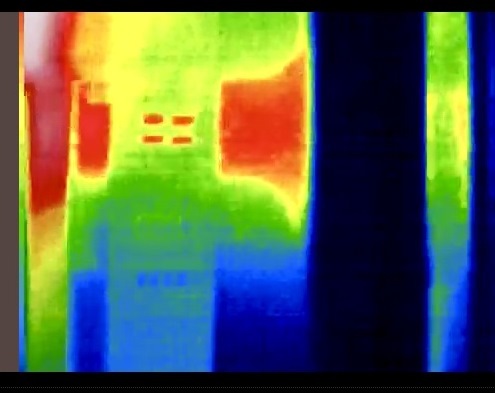

            • FLIR video of buffer board shows only hot spots are COF and occasional metal reflections.
            Click image for larger version  Name:	IMG_3317.jpg Views:	0 Size:	1.00 MB ID:	3483841 Click image for larger version  Name:	IMG_3316.jpg Views:	0 Size:	848.8 KB ID:	3483840 Click image for larger version  Name:	IMG_3319.jpg Views:	0 Size:	667.3 KB ID:	3483839 Click image for larger version  Name:	IMG_3318.jpg Views:	0 Size:	679.2 KB ID:	3483842
            • Diah
              • Feb 2013
              • 6499
              Originally posted by howardc64
              What is CAO?
              look on yours keyboards you will see O are close to P LOL.... fast writing
              yours photo which show 180 ohm...they are not caps just 0 coil R --- put them back
              check the area of this section at yours FLIR section
              • Diah
                • Feb 2013
                • 6499
                • howardc64
                  • Jun 2017
                  • 653
                  Click image for larger version  Name:	IMG_3319.jpg Views:	4 Size:	87.5 KB ID:	3483857

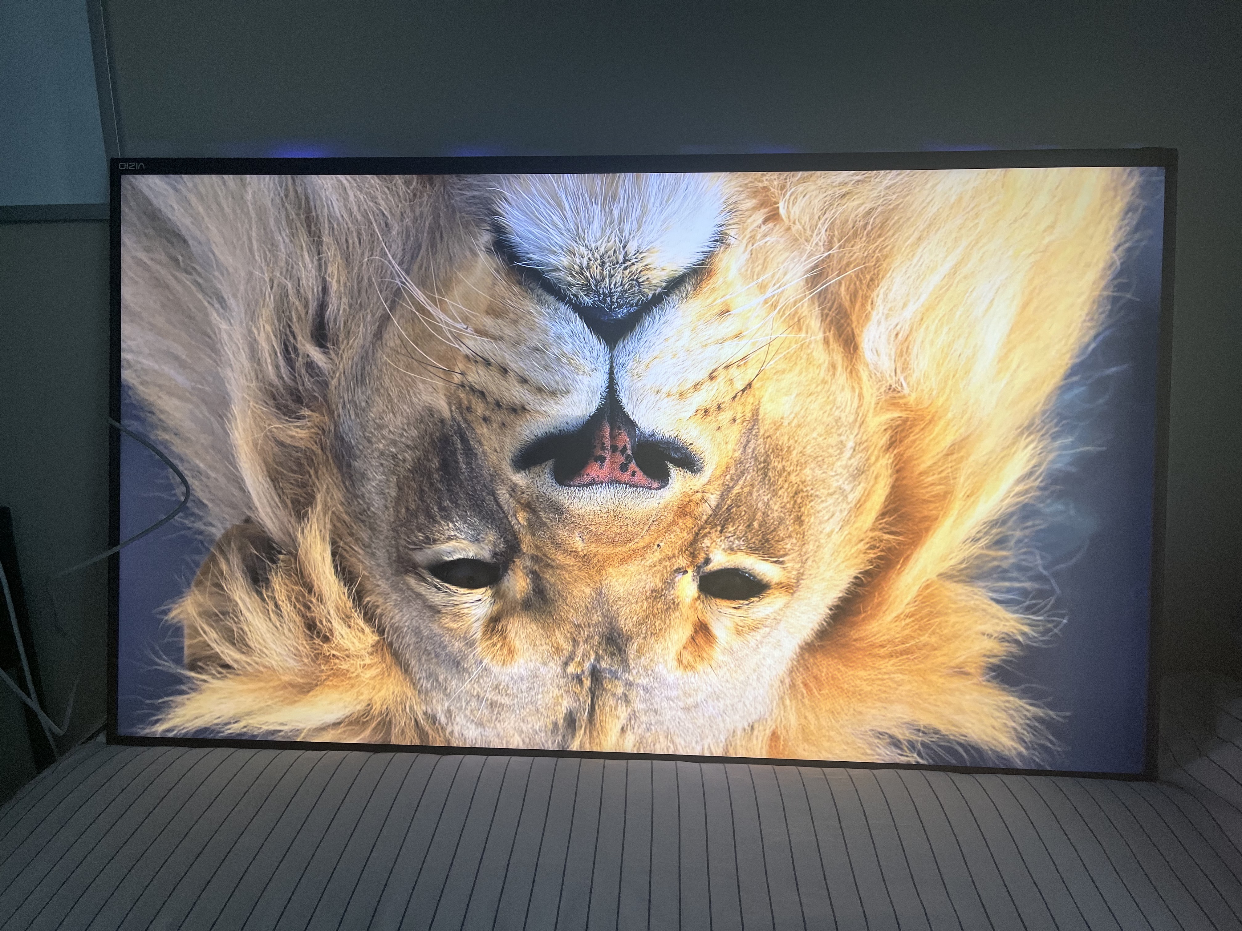

                  Thank you much for the hint. Fixed, 2x diode shorts on D14 ESD diodes was culprit. Removed and shorted cap circuit nearby disappeared. TV works with no t-con signal masking. Also found same fix in this thread ( link ) Don't have 4264H ESD diode array ( link from prior thread ) in my donor buffer board pile. Seems unnecessary but probably good to put good one back for ESD protection?
                  4x thermal rectangles in post #6 are just 4x groups copper pads reflections.

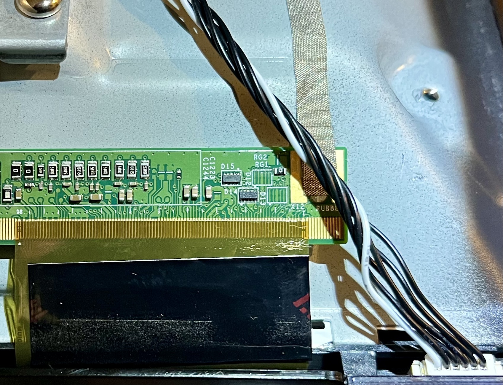

                  • howardc64
                    • Jun 2017
                    • 653
                    UPDATE
                    Replacement ESD diode array ( link ) came in. Replace D14. TV continues to work as if it was removed before but now with ESD protection. D15 had no OL issues and works. Was a mistake in prior measurement. Some people claim can remove and put on by soldering iron. Would need a really good micro pencil with a knife tip and probably some low melt solder. I just used hot air station (should protect the gold flex connection below from hot air).
                    These are commonly called TVS (Transient Voltage Suppressor). Note there are other TVS with same form factor and pin out but most are for low voltage high speed communication signals such as USB3 and HDMI. These can't handle > 5-6v. D14 handles close to 30v with VGH so need to get TVS with higher breakdown voltage rating such as the link above.
                    Click image for larger version  Name:	IMG_3360.jpg Views:	0 Size:	755.0 KB ID:	3489098
