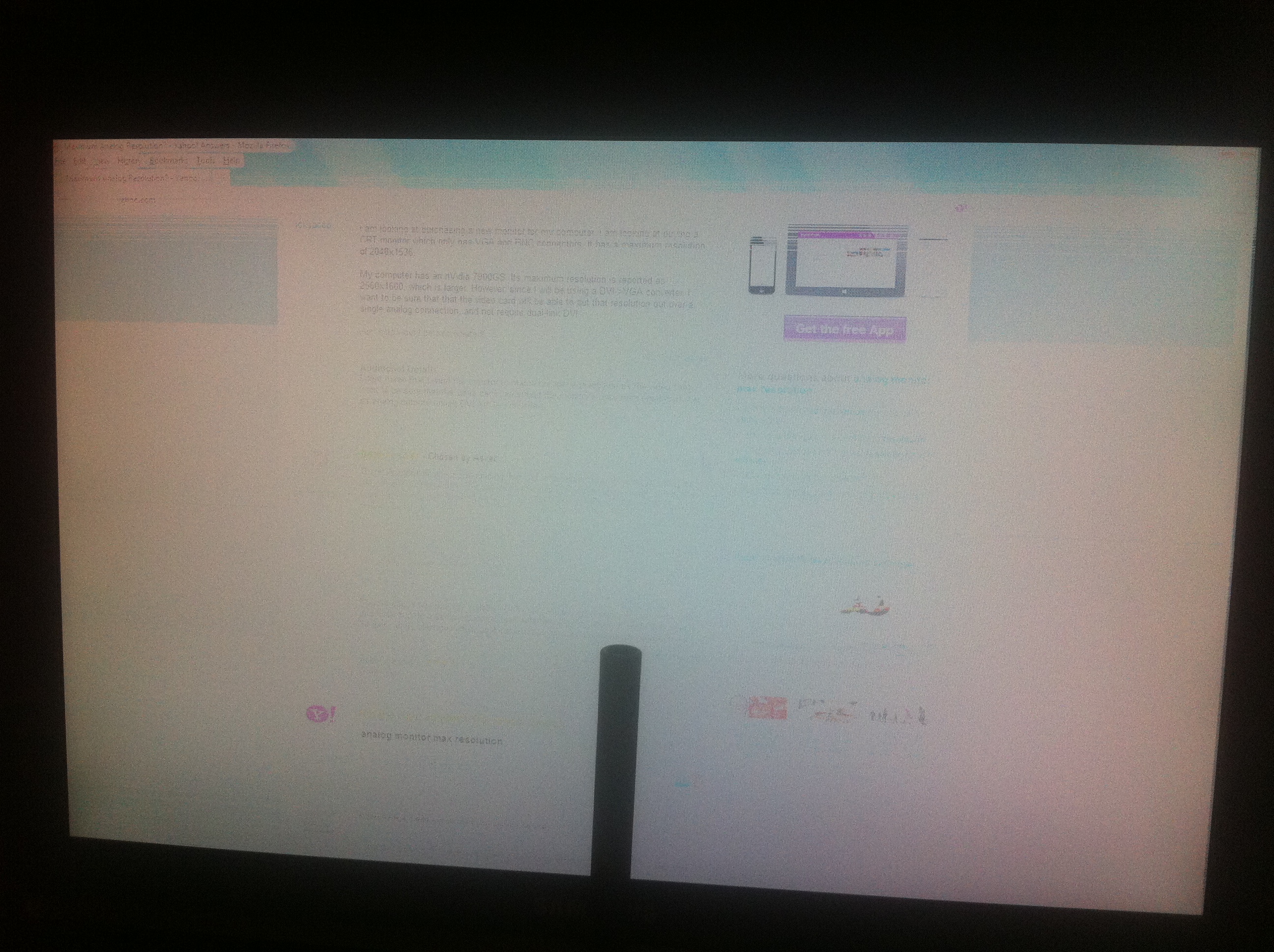

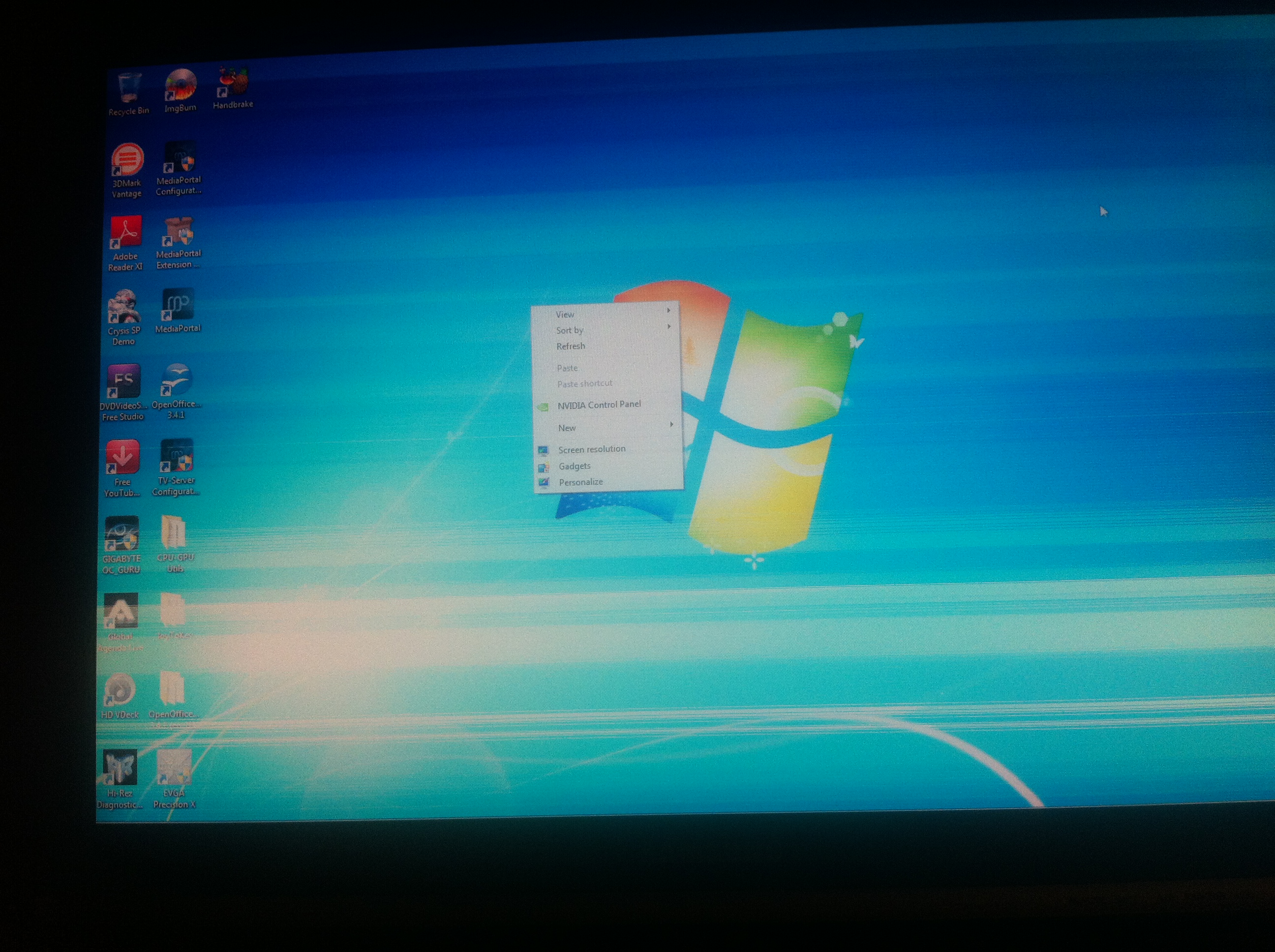

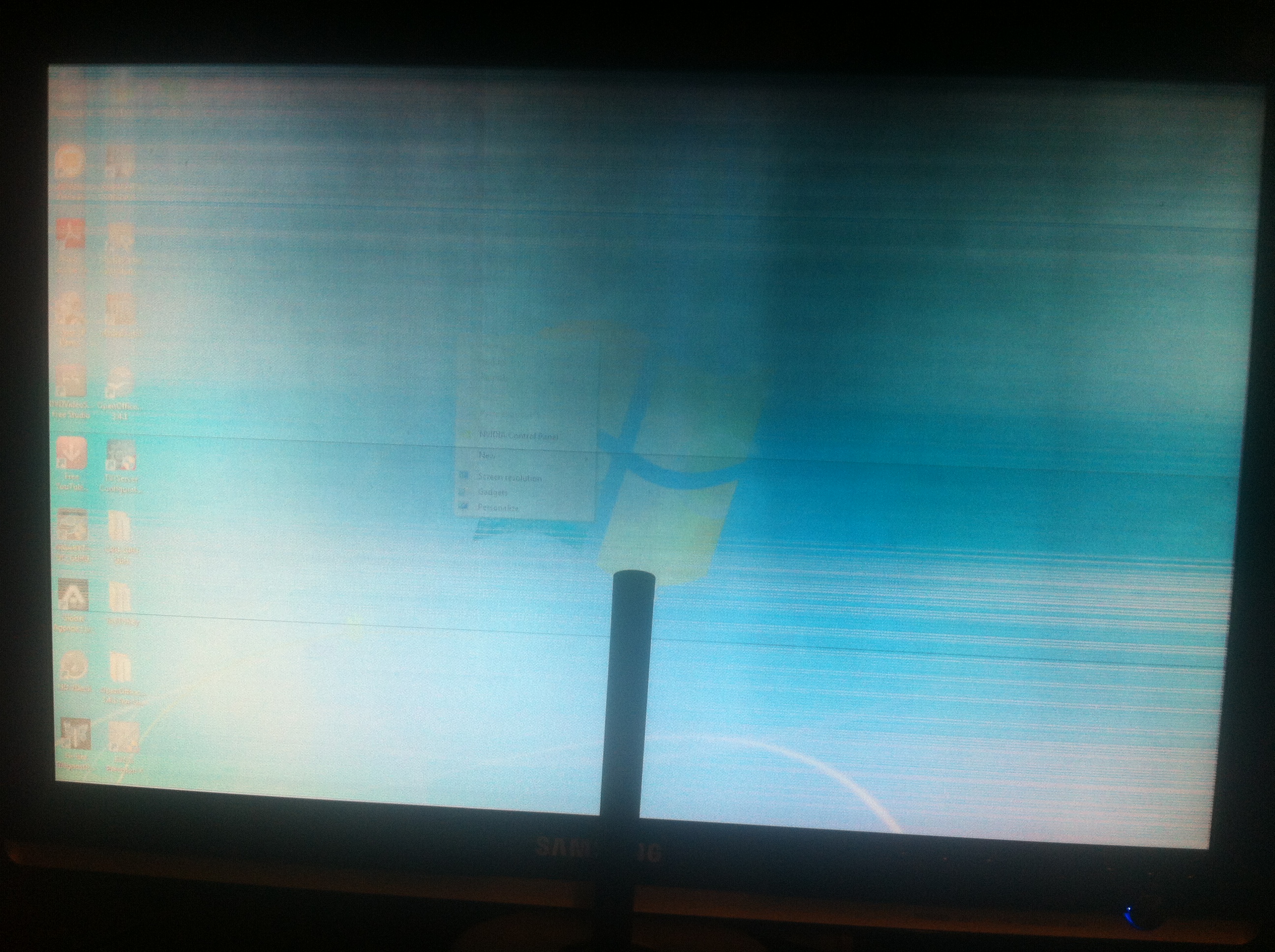

    I'd like to start off by saying I'm glad I found this site.
    I have a Sammy 216BW and the enclosed pictures is what it was doing prior to the cap replacement. and after replacing the 22uf, 5x820uf, 330uf, 2.2uf, and I didn't have an extra 47uf but it looks ok.
    After the cap replacement, I thought it was working as I tested it with the back off the monitor. when I put the back on the monitor, it acts just like it did before. (as seen in the attached images.
    I've had the monitor without the back on for the past 30 minutes and no hiccups.
    Any ideas what could be the culprit?

    Re: 216BW after cap replacement
    Put the back on and the monitor is acting up again.

      Hi, welcome to Badcaps!
      I can't say much about the specific symptoms, but my opinion is if it works with the cover off, and messes up with it on, it's one of 2 things.
      Mechanical - cover torques the board(s) and makes a cracked trace or bad solder joint act up.
      Heat- cover on causes heat to rise, and plays havoc with a component that's borderline.
      While the back is off try prodding /bending the boards with an insulated tool, or try a heat gun or hair dryer to see if you can isolate it.
      Could also be a bad bond from the tcon to the panel.
      That would be bad news. You could try gently touching/flexing that area.

                      Ok, does the distortion happen immediately after you put the cover back on. Or does it take awhile?
                      The reason I ask is because if it happens immediately, it's some sort of compression or pinching issue. But if it takes awhile, it's probably a heat issue.

                          Wow, Thanks all for the replies!
                          I have Nichicon Caps for all, the only one I didn't replace (I was an idiot and got a 4.7 instead of a 47uf cap so the capx crap is still there, but doesn't appear to be in bad condition when I removed it.
                          I completely disassembled the monitor and reassembled it and it is working without a hitch (so far).
                          Had used it for 5 hours last night and no problems arose. Thinking maybe a wire may have gotten crimped. Plus the monitor I got had no base as it was used as a wall mount. Cant complain as I got it for free. Will wall mount it at home after testing another 5 hours on it. If all is good, I suspect it will be fine going forward.
