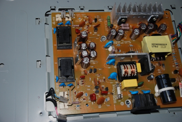

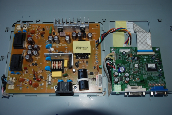

    Hello All, good to learn that there are people like you guys out there! I am a handyman but new to electronics. This is an area I try to stay away. Stated yesterday while working on my pc my VX2235WM went blank on me. The LED stay blue but no picture; as I move the mouse around I notice a white line pops in/out horizontally on the screen. I have checked all connections and they are fine. Same thing happen to a laptop I hookup to the monitor. While I check on line there are many suggestions about the problem with the power inverter. Also, there are the following links shown the service manual and a place you can purchase a repair kit.
    http://www.go-gddq.com/upload/2011-0...1517538124.pdf
    https://www.hobbymods.com/store/inde...ken-parts.html
    My question to you all is that; do you think I am looking into the right area for the fixes or should I seek elsewhere? Any comments or suggestions are welcome.

                        Thanks for your help. I didn't see the two covers over the neck supporting bracket. Once I pull those out everything is easy.

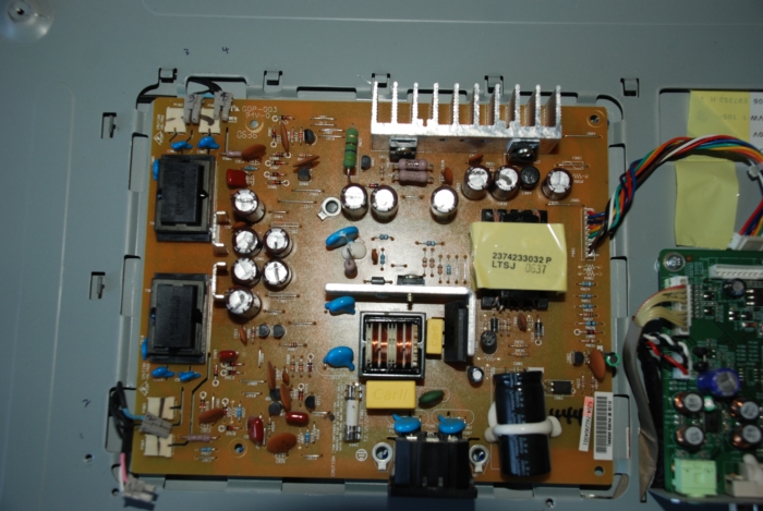

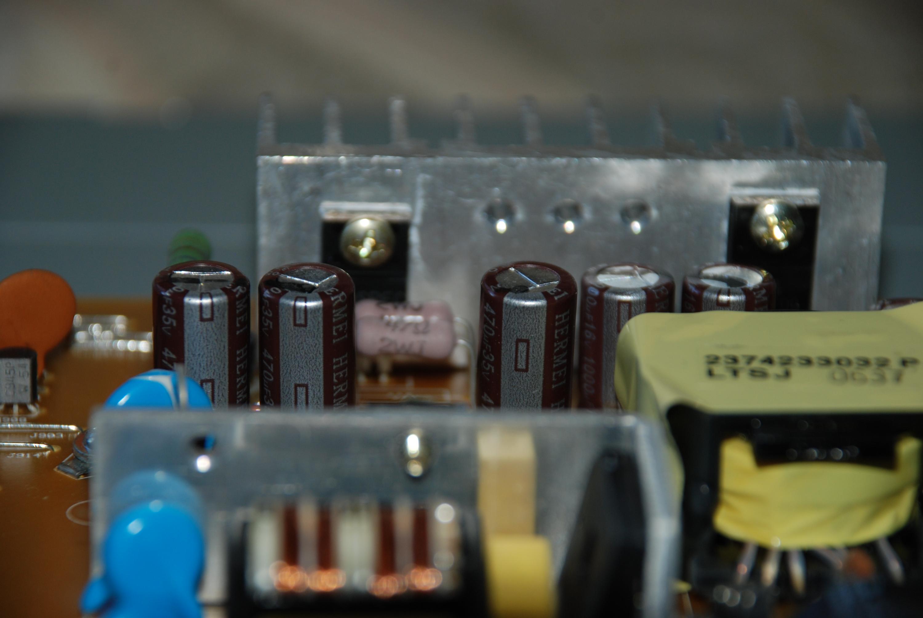

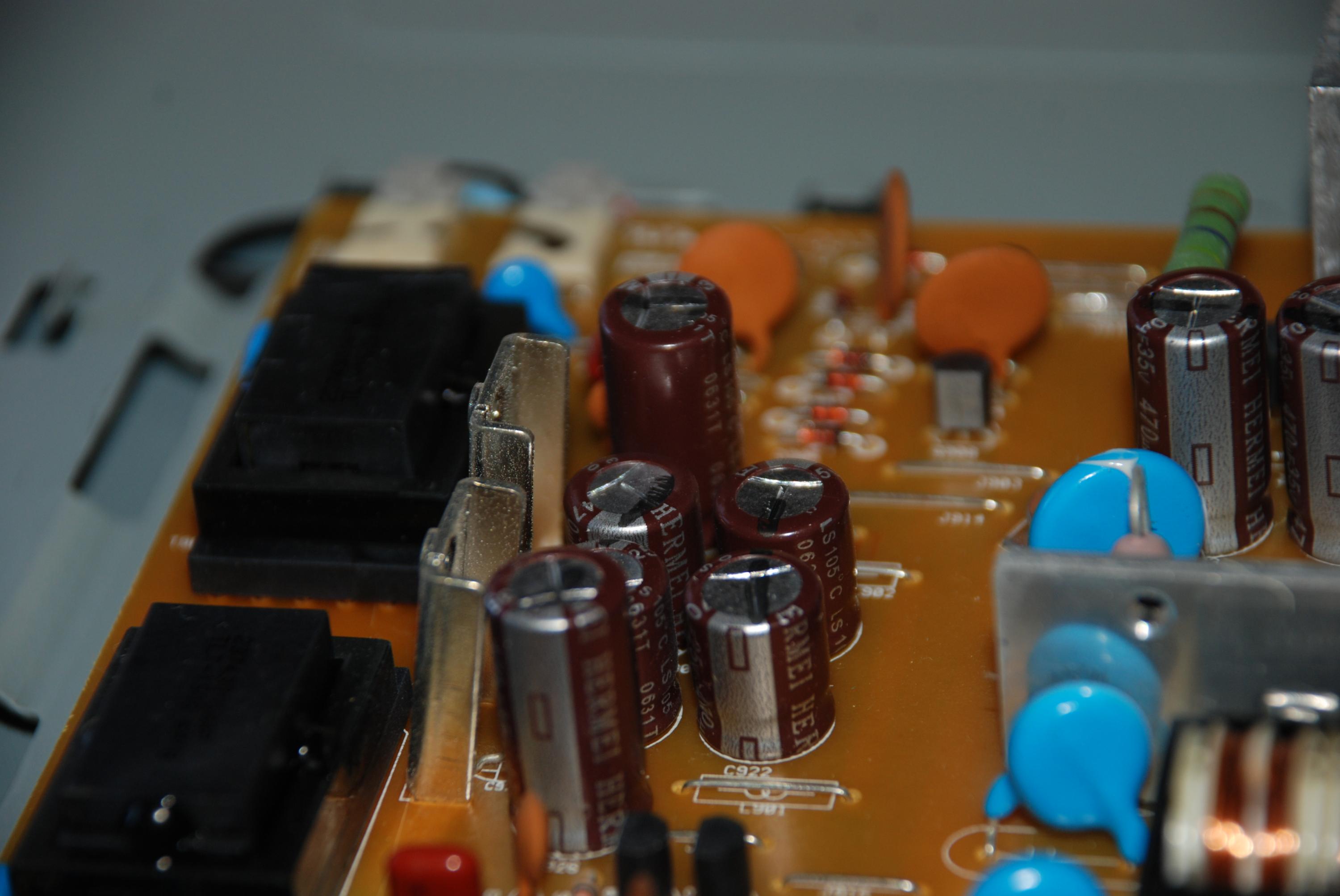

                        I checked the pcb and didn't notice any swollen caps. Am I looking the right parts? I can only counted 12 brown caps in the pcb. Any suggestion on what to check next? I have a voltmeter should I be checking for any values between each of those caps? Thanks.

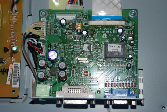

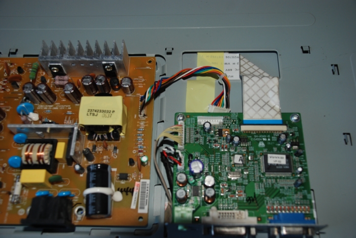

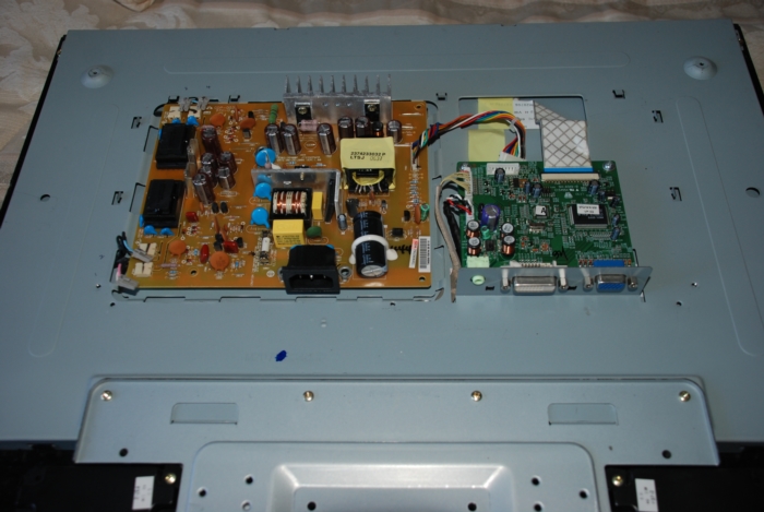

                            Re: Viewsonic VX2235WM - blank screen on/off
                            can you do some straight on full pics of your boards.
                            Welcome to the forum-
                            We can help a lot more if you please post good clear pictures of the whole chassis, and then pictures of each board, front and back (in the same orientation) and close up of connectors, (max resolution 2000x2000 and 2MB) using the manage attachments button, which is found by clicking "go advanced" under quick reply.
                            Examples of what is needed
                            https://www.badcaps.net/forum/attachm...1&d=1290283049
                            https://www.badcaps.net/forum/attachm...7&d=1280167246

                                  Seems to be another apparent case of 2secs-to-black. Kindly take a peek at the sticky post #19 : https://www.badcaps.net/forum/showthread.php?t=10419
                                  1. If you're not equipped to check out the ESR then replace all the secondary caps irregardless. Caps does not have to be swollen/domed to be borked.
                                  2. Look under the PCB for Q905+Q906 and Q911+Q912. These are N channel and P channel mosfets. Test 'em out based on the sticky above. Report result and wait for someone to verify their status.
