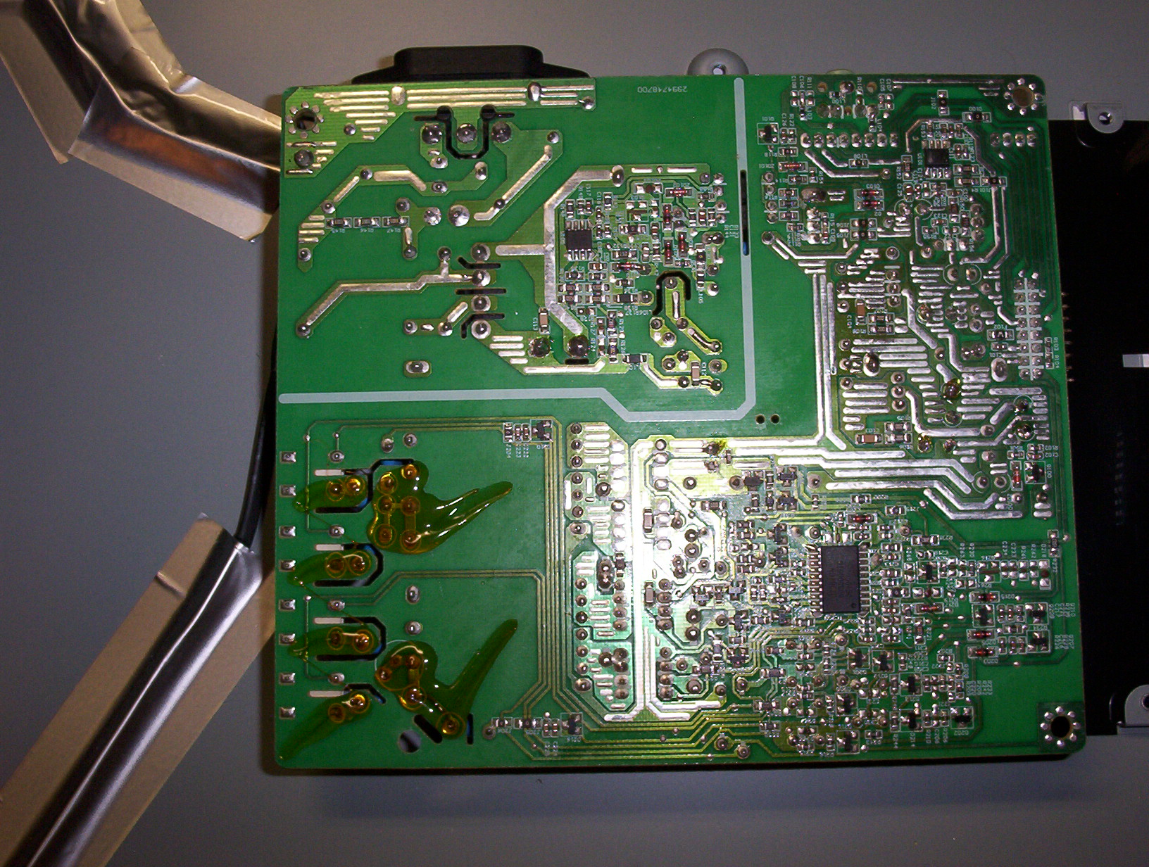

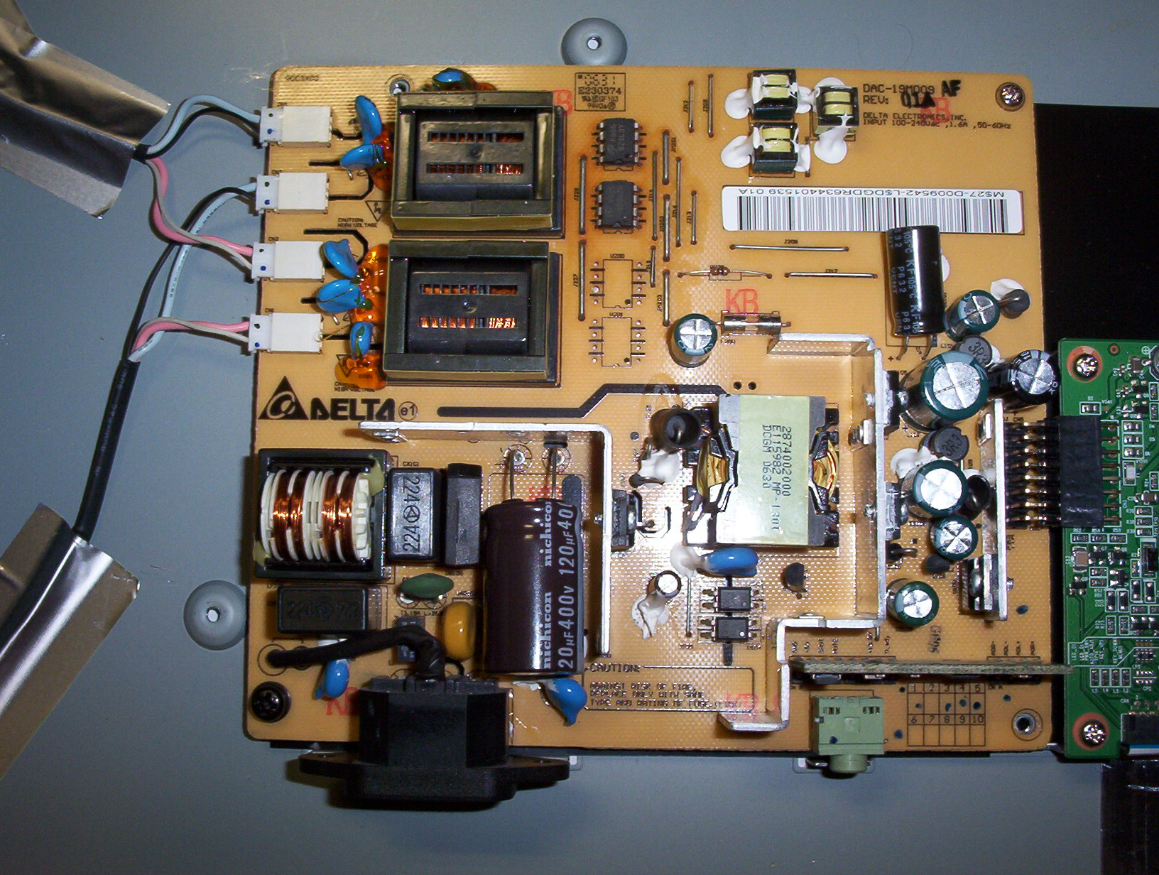

                    Attached is a shot of the power supply hooked up, and a picture of the underside of the power supply.
                    Most of the capacitors have been tested using my capacitance meter, and a few were replaced just because I had known good replacements on hand, and wanted to rule them out as a problem. It's gonna be a bit tricky, but where should I connect the multimeter leads, and what voltages should I look for?

                      OK, on the multi-pin connector, the pins are labeled, on my pictures I did not take good pictures that show all the label of the pins. Can you write down what they are?

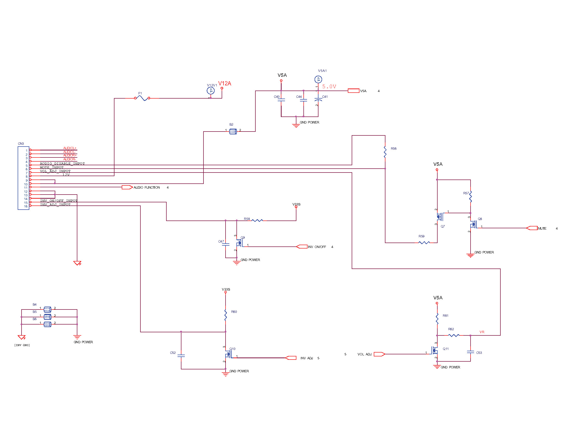

                                OK, pin 15 on the main board is the INverter on/off pin, it should change state when the monitor is on and when it is off, black probe on the chassis, red probe on pin 15.
                                I believe this should match your main board.

                                  Ah. Embarrassingly, I'm not that good with schematics. Could you point out pin 15, say in the picture I took?

                                    See picture of PIN 15 on the POWER SUPPLY BOARD.

                                      The plot thickens.
                                      I rigged up a jumper wire to pin 15 on the power supply so I could connect my multimeter, and plugged it in. The connector is slightly off kilter now but all pins still make contact. I read 3.01 volts from pin 15 when the display is lit.

                                        I looked more at the pin out, not sure if it is using pin to pin between main board and the power supply board or not, if it is not pin 15 on the main board may be connected to pin 16 on the power supply board, not 15 to 15, you can get to pin 16 on the top side of the board and check the voltage on that pin also.
