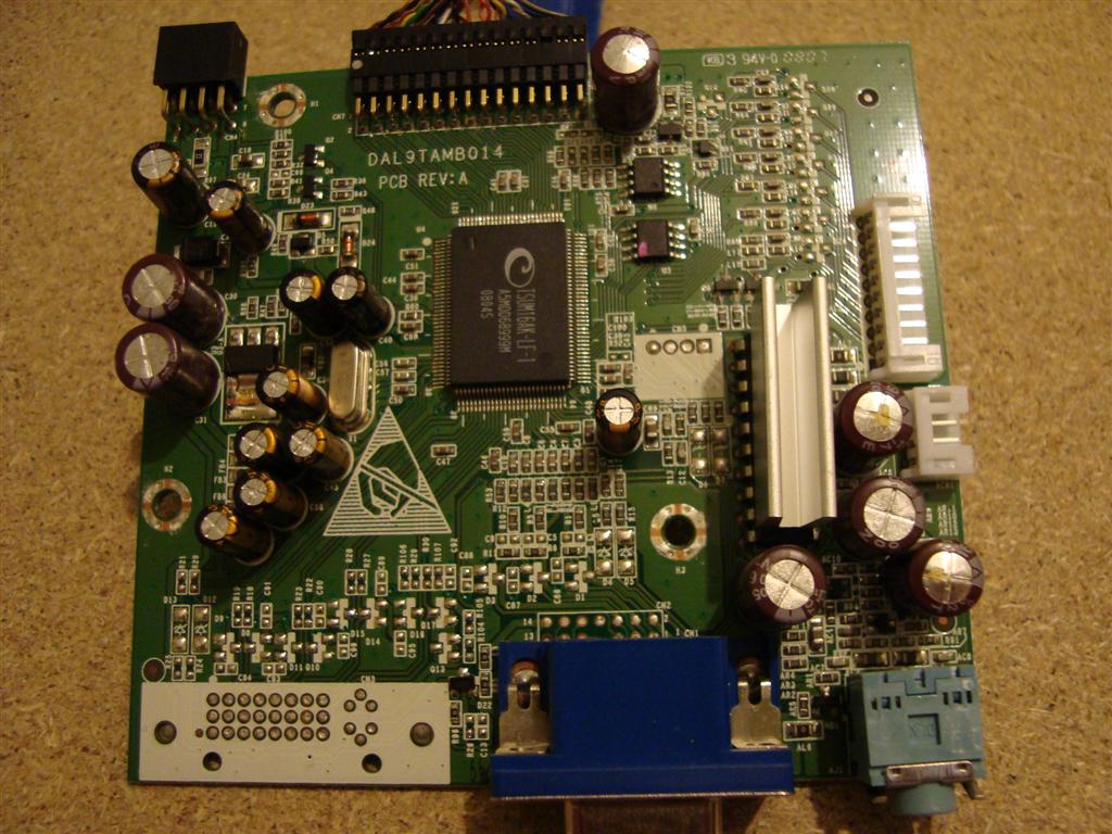

        Update-
        I had a better look at the boards and I've noticed swollen caps on the main board.
        The one at the top (next to screen connector) and two of the group of four to the lower right.
        All are "CapXon" 330microfarad 16v.
        They look like they may be leaking.
        Is this likely to be the fault and will replacing them cure it?

          Bottom line is probably we dont know. The faulty caps may have damaged another
          component - voltage regulator for example.
