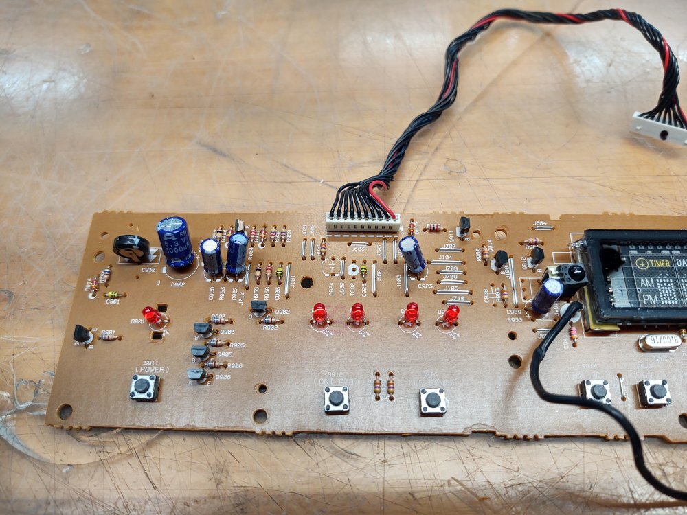

                      • Mark R
                        • Oct 2023
                        • 92
                        Originally posted by sam_sam_sam
                        Let us know if you are able to fix the issue with the display

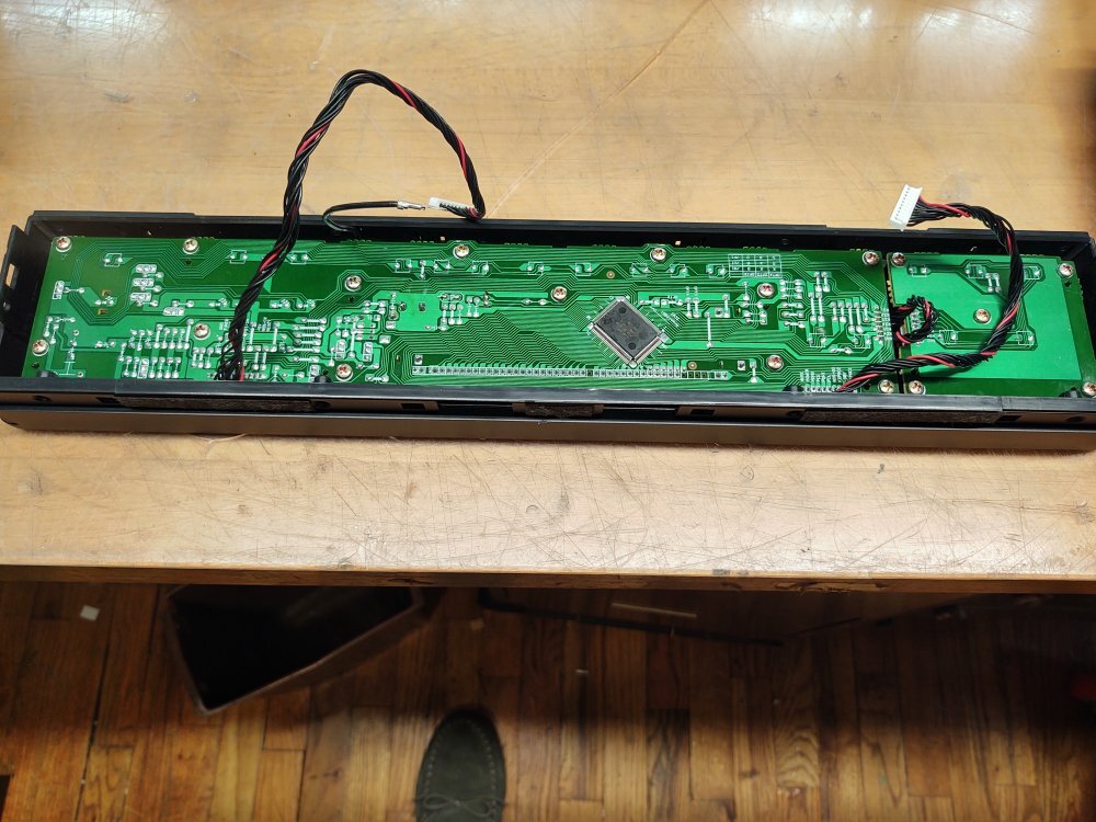

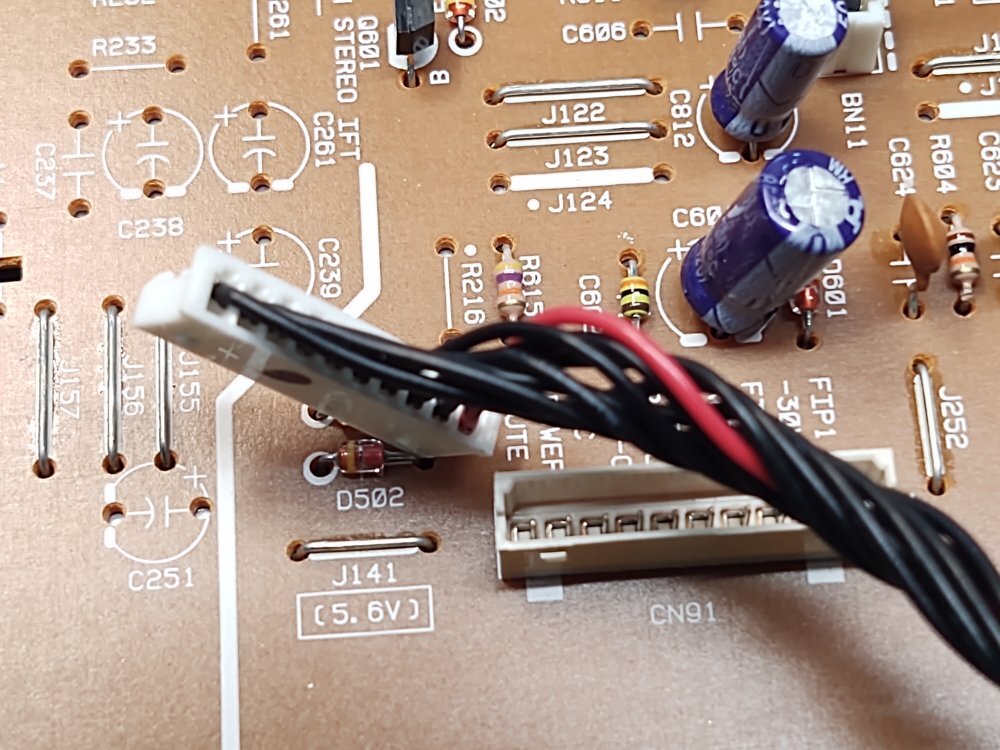

                        Ok Sam Sam Sam.. Here are some Pic's showing the unit broken down. There are a bunch of caps on one side of the board. Also I don't see any indication of 3 Volts A C on the board . Just 5 Volts and I think 31Volts. But it does read as DC Voltage.
                        So Next step is to get out the LC103 Cap Checker and Fire up The MBT-250 De solder station.
                        I'll check back after I check these caps.
                        Regards: Mark R Click image for larger version

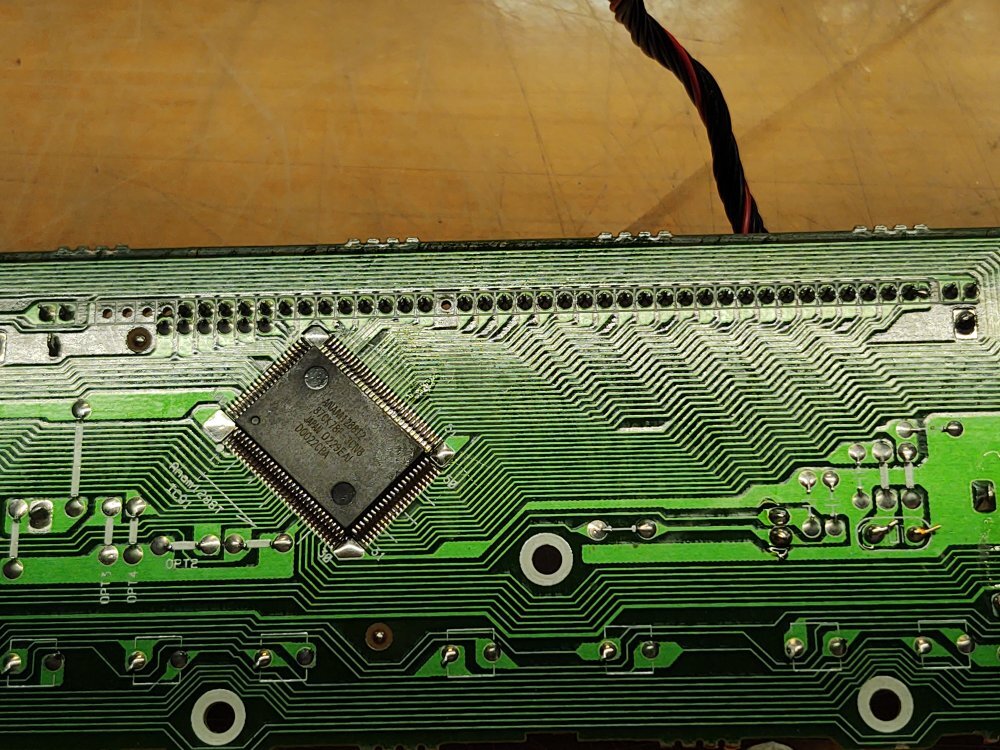

                          you need to clean up that potential solder-bridge you created on the display pcb
                          • Mark R
                            • Oct 2023
                            • 92
                            At the time of the pictures I had not touched or soldered anything. Where are you indicating?
                            As of this time 12:05 AM EST I located the problem. It was a 6.3 Volt 1000 MFD cap on the display board. The LC103 showed Leakage and also showed high Dielectric Absorption. I replaced the cap and the display now is much brighter. I used a 1000 MFD @10 Volt cap. Seems to be working ok.
                            Now what is really ticking me off is one button fell out of the front panel which I have been looking for over 1 hour. Can't reassemble the unit until I find the button!!!!!!!!!!!
                            I'll report back with Pic's if I can find the dam thing!!
                            Thanks for the help to All. I'm not done here. I will tare my shop apart till I find it. LMAO Back soon.
                            sigpichttps://www.badcaps.net/forum/image....ine=1697924519
                              • 31304

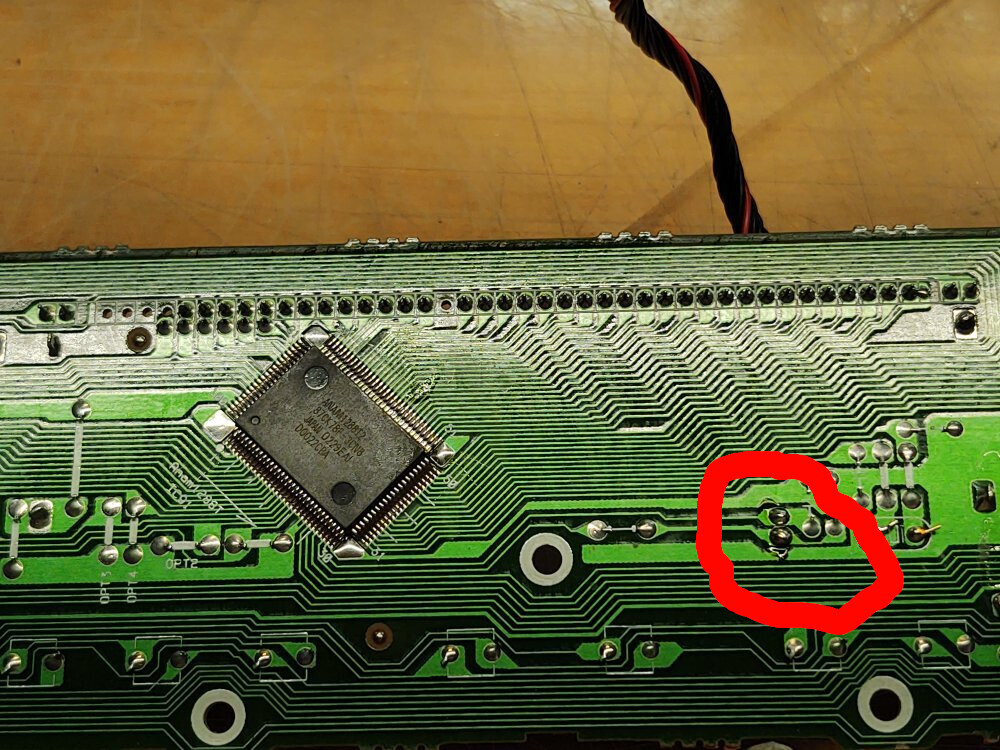

                              look at the right side of the display controller in your pictures - there are 2 joints manually soldered - the lower one has some "splash" effect

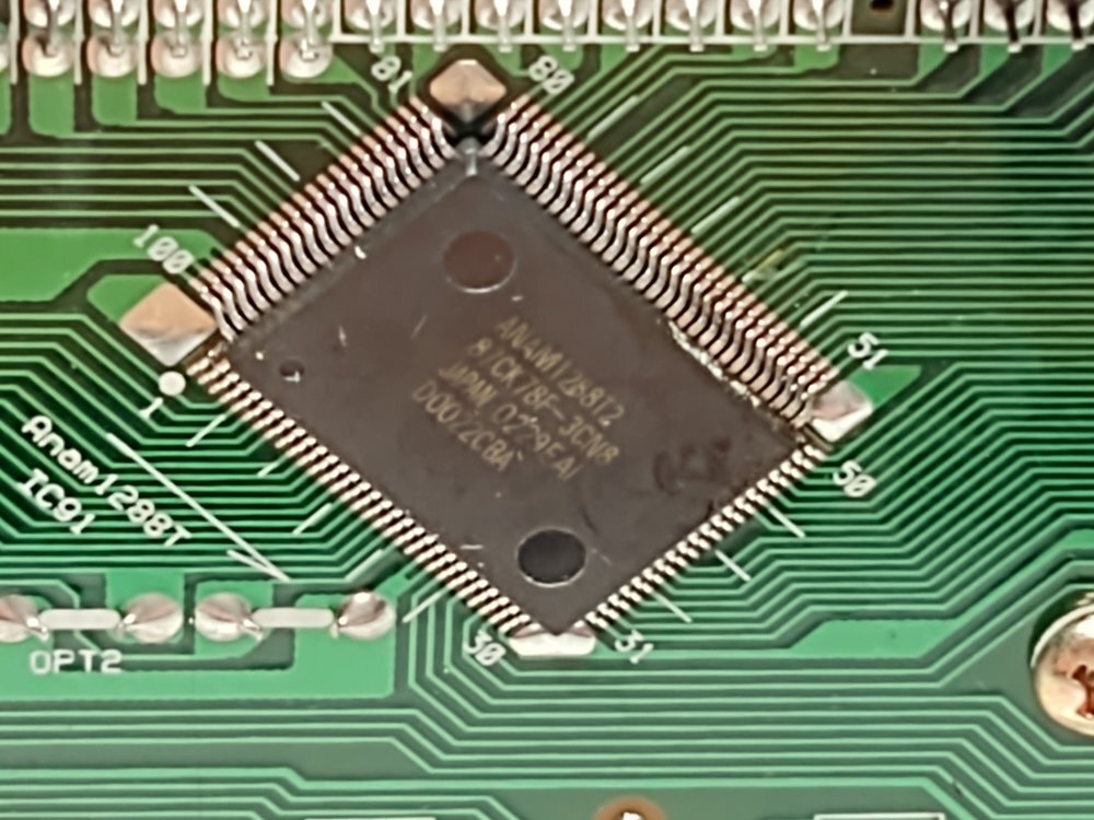

                                Are you speaking about the Main Multi pin IC? Between Pin 51 and 50? Post a picture from mine so I know which photo your speaking about.
                                Also: The unit seems to be working now since I changed out two caps... Thanks for leading me to that area and the link to The VFD display site and every one here who helped me.

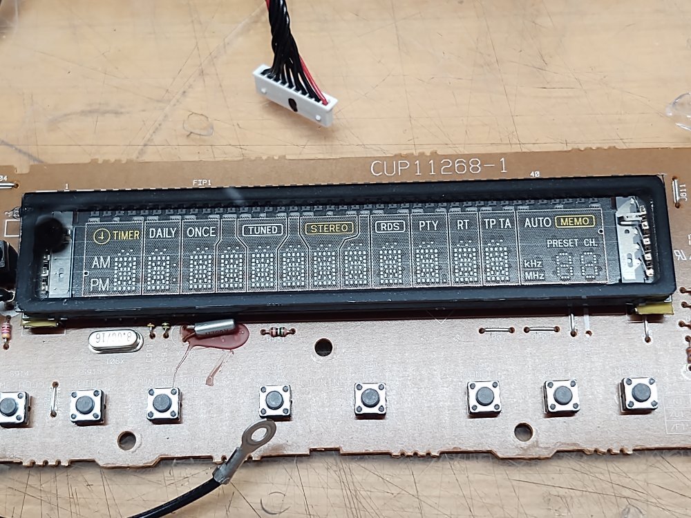

                                Here is a pic of the now brighter display. Why they shove a Hunk of Red filter in front doesn't make sense to me. I guess they want to hide the circuitry in and around the VFD. It looks better in it's Natural color.
Name:	Marantz PMD800 Display Repaired 1.jpg

                                  Probably still a good idea very closely look at the soldering joints on the VFD display and any of them that look questionable redo them so you do not to revisit this issue again I would also recommend that you replace the capacitors around the VFD display and the display ic chip for good measure especially if the this device has a lot of use and age because both are hard on capacitors for this type of use
                                  I am not suggesting that you recap the tuner section or anything like that because then you would have to have special equipment to be realigned tuner
                                  The reason for the red filters is so it is easier to read in the dark and very low light settings I would recommend reinstalling them so it be like it originally was when new

                                    You call it the display Controller???? Are you speaking about the large Postage stamp IC Chip? Can you post a pic from mine that indicate what you are talking about?
                                    Also All solder joints on the VFD are perfect. They were looked at with a Jewelers Loop. All caps were changed out after testing. Two were bad. All solder joints are perfect on the front panel control board.

                                      this - or is it flux?

                                        Ok..Now Ise what your talking about. Ok I'll pop the cover since it's back together and take a Look. Thanks for the Photo and location. Get back to you soon
