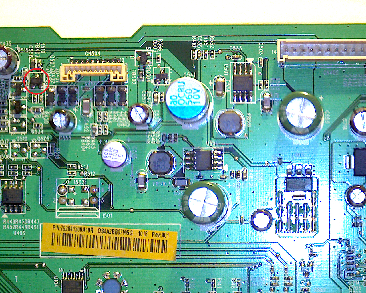

                                      @selldoor I traced pin2 and found it at this pin marked in red in pictures. What is this component?
                                      I retested the power board with a 24volt 24w bulb on the 5v rail and the supply voltage held steady at 5.14volts.
                                      Attaching the mainboard pulls the voltage down to 3.7v but the recovery to 5.14 is immediate when disconected.

                                        Re: No Power Dell U2410 Monitor
                                        Hi - Probably need Budm or Tom to confirm but I think it is a sot23 mosfet.
                                        I have looked for the markings to try and find a datasheet but no joy.
                                        Perhaps post a pic of it in general electronics forum - someone might recognise.
                                        Note the board markings on it for source drain and gate. - You could always
                                        test it for shorts. Problem could also be with the linked transistor which might
                                        switch on/off the gate?
