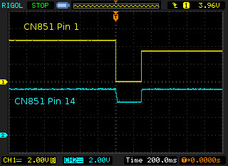

        #83
        Re: No Power Dell U2410 Monitor
        I also have a dead U2410, however, mine occasionally works. I have had it on several times while working on it and I have taken voltage measurements at CN851 and CN852. When mine is working, I have 5.15V on pins 11-14 on CN851. When it quits, there will be 5V until I hit the power button and then it will drop to 3.7V. At that point, I have to unplug it for a minute and try again. So the 3.7V reading may not indicate a bad firmware or dead micro. I'll post more as I dig deeper.
        Merc
        • Merc
          • Jan 2015
          • 18
          #84
          During power-on, the signal on CN851 pin 1 goes from 4.68V down to 0V for 300ms. It then goes up to 3.48V and holds there. During this same time CN851 pin 14 (5V) goes from 5V down to 3.76 then back up to 5V and holds there. I'll try to attach a picture.

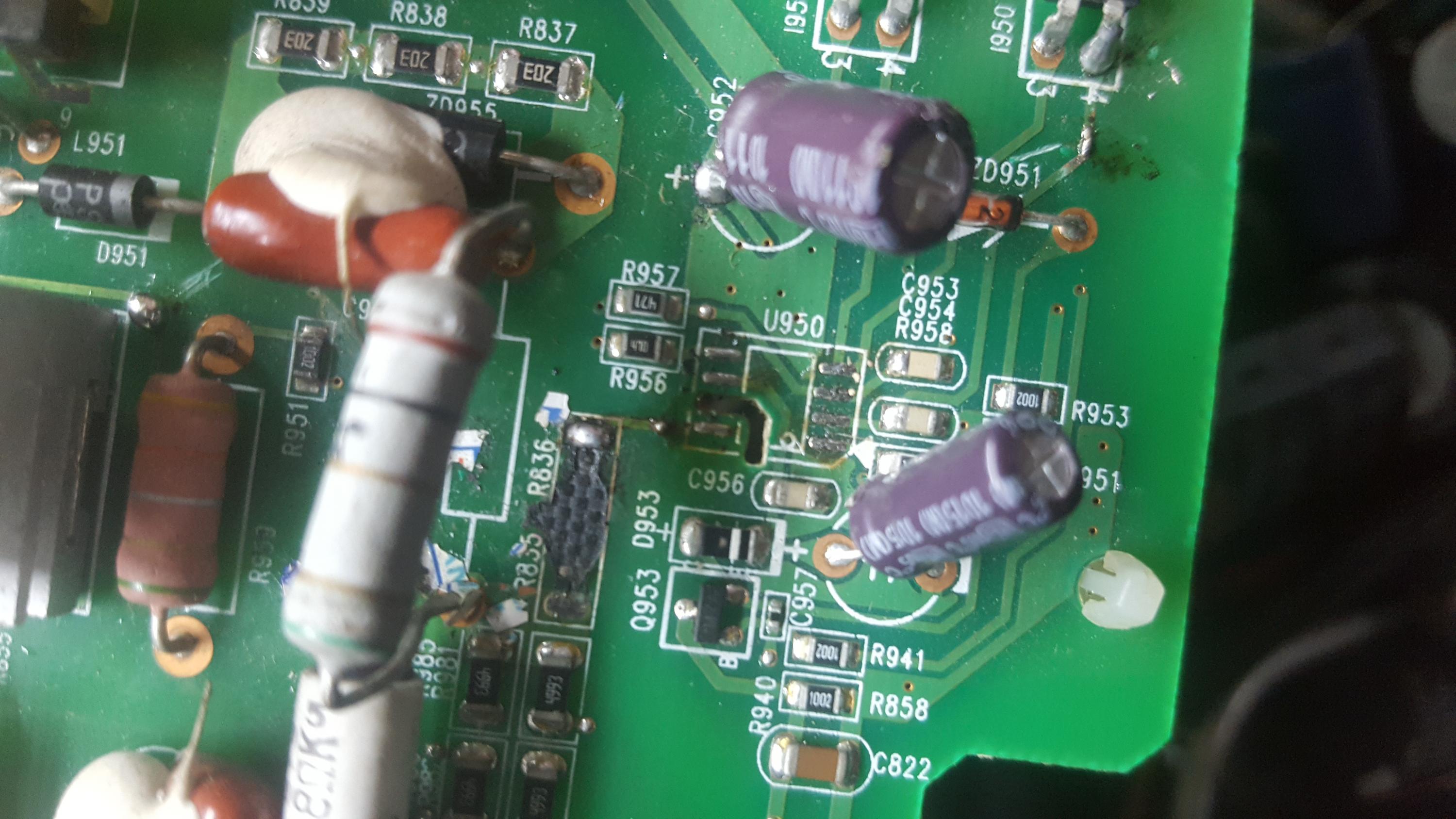

                Hi, guys. Now I have dead U2410F to.
                Symptoms are very similar that described above.
                Not switching On at all. Buttons light very bright and bezel going hot after short time. Power button have no any light.
                High voltage capacitor hold 300V. Pins 11-14 on mainboard side has 5.16V. Pin 10 -no power, 8,9 - no power. Pin 1 - 4.8V. Pins 2-4 float.
                If I short optocoupler I952 output on Pins 8,9 rise 12V and from back light side socket has 24V. But pin 10 stay down.
                I have red all posts. But looks like no solution found.

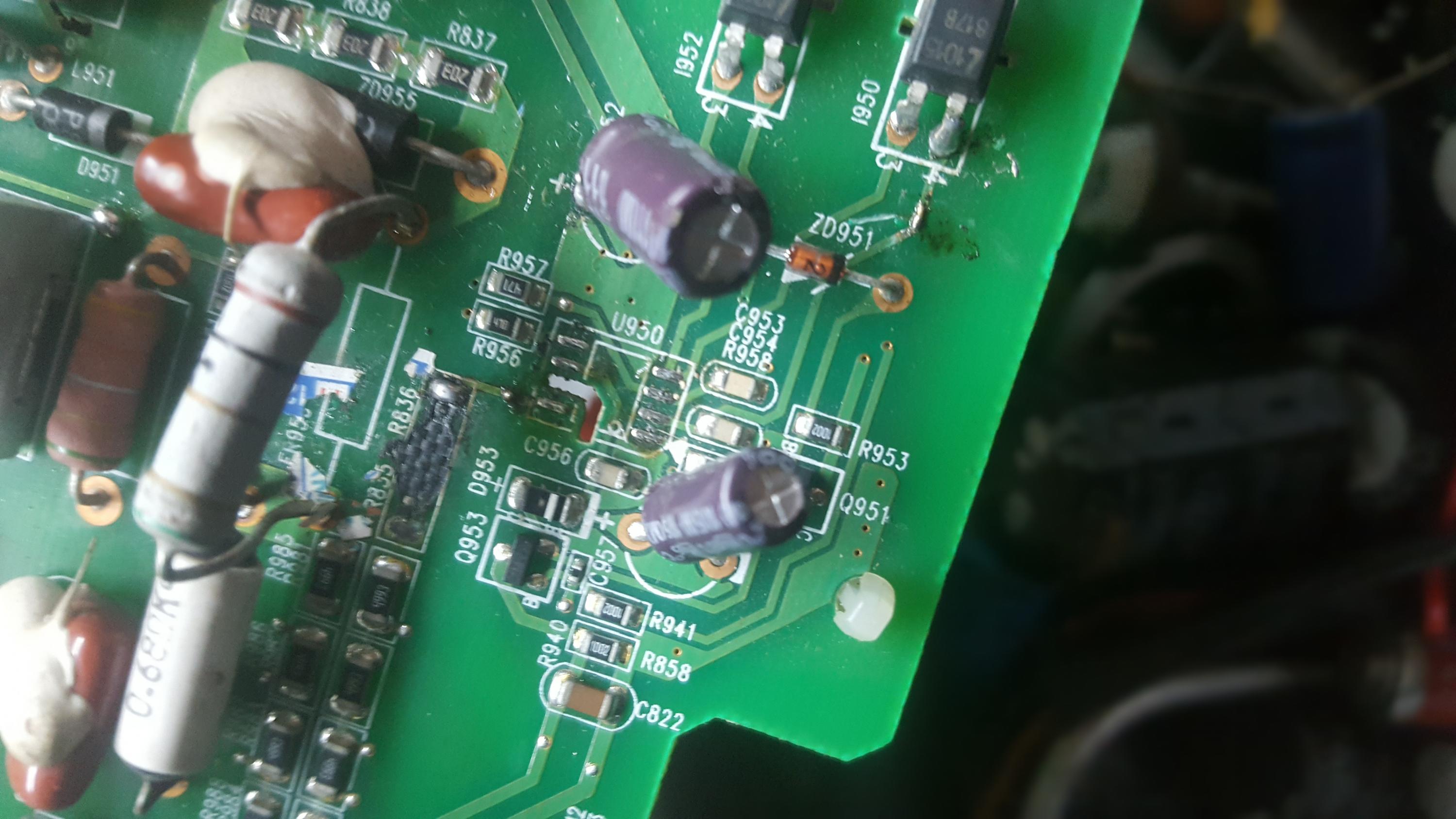

                      Originally posted by Hampus
                      Hi Guys!
                      Starting my monitor during normal usage (front button poweroff), a short loud humming sound ended in a bang and black smoke.
                      The only casualty I can find (looking at the non-component side) seem to be diode D856.
                      From pics and the remains I pieced it together as an 1N5406.
                      A) Does any of you think this is caused by a broken component elsewere that I should replace so that it does not happen again (or something worse does)?
                      B) Any quality issues I should consider when I pick up a new 1N5406?
                      I have a basic understanding of electronics, but most of the electronics design here is beyond me at this point.
                      Hampus
                      Hi Hamspus,
                      My Dell U2410 was on fire today, and just burn with black smoke. I listen some burn noise and see the black smoke at the top of monitor and then hung up. And never turn on again.
                      How did you fix it?
                      I haven't disassembled de monitor yet, someone can help me how open it without damage?

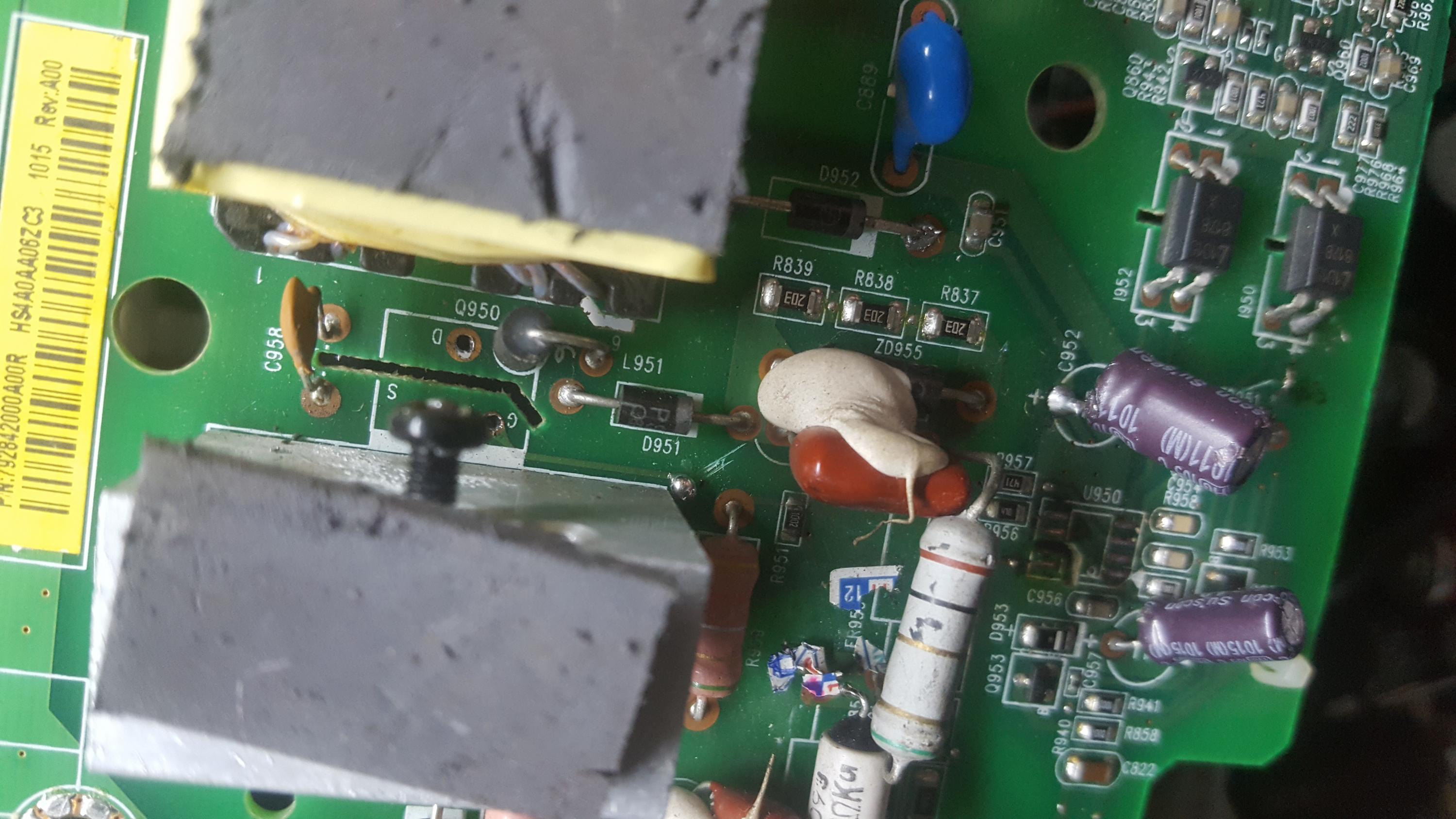

                        Hi all.
                        I have a Dell U2410f with broken Q950 and U950, no way to read anything on them as they are exploded/burned completely.
                        could some kind person please tell me and ficobel what values
                        Q950 and U950 have?
                        So please help, thanks!

                            #93
                            Put a image of circuit, where is the componente if I can help you.

                                #95
                                Give me your email to send you some photos.
                                It's not very visible, but you might see it.
                                I just can not find the Q950. Mark on the circuit please.
                                • luissm
                                  • Aug 2016
                                  • 8
                                  • Portugal
                                  #96
                                  I find the Q950.
                                  I've prepared an email to send you.

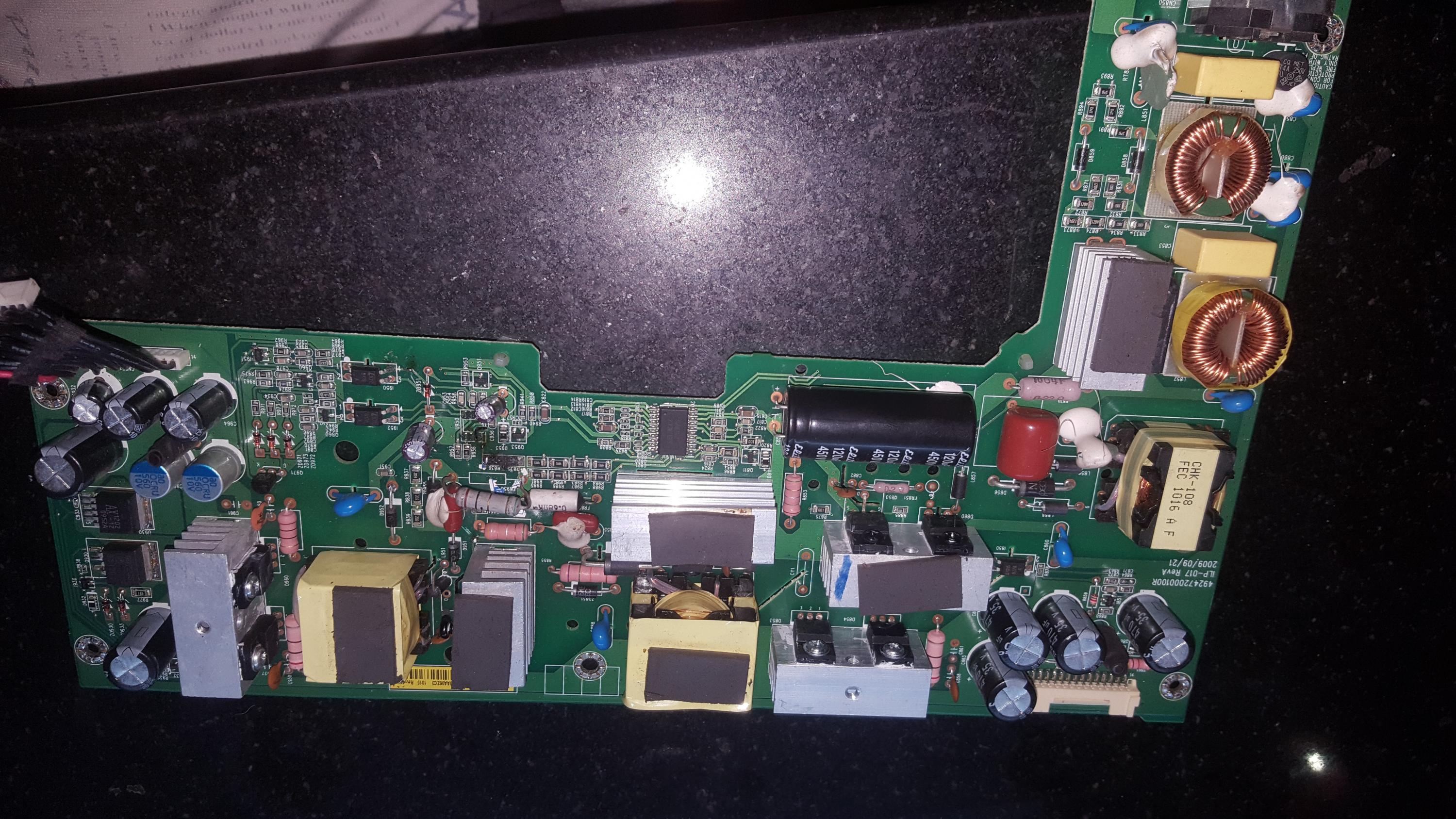

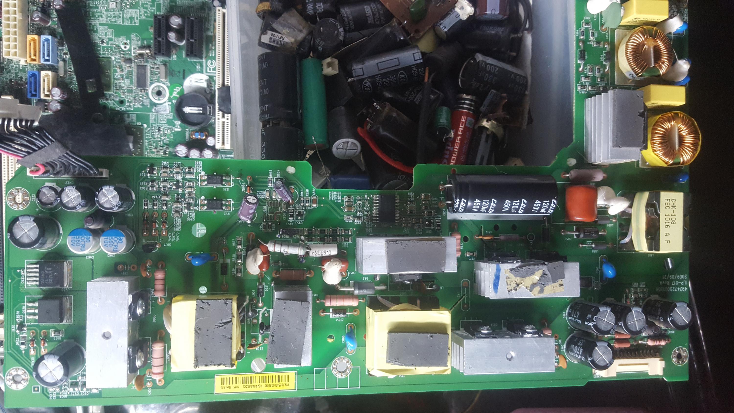

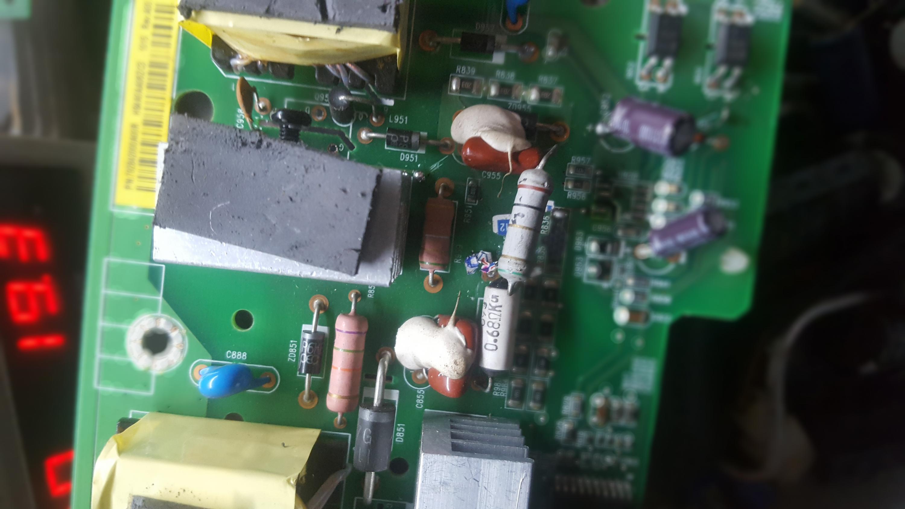

                                      Hi everyone! I'm also trying to fix a U2410.
                                      • No power when power button pressed
                                      • Opened case, inspected board. Found F850 (round black fuse next to IED socket) blown and open.
                                      • Replaced with identical fuse.
                                      • Unsurprisingly, popped again
                                      • Further inspection showed FR851 blown, and D860 blown
                                      • Sourced replacement for D860 (BYC8X-600)
                                      I can't for the life of me work out what FR851 is - fusible resistor? But what is the resistance? It is coded as 208, but the remaining two "good" ones in the circuit measure at 600mOhm (with two different cheap multimeters)
                                      Can someone please point me at a suitable replacement part from RS/digikey/mouser? It's driving me crazy!
                                      https://theducks.org/pictures/noinde...0/u2410-01.jpg
                                      https://theducks.org/pictures/noinde...0/u2410-02.jpg
                                      https://theducks.org/pictures/noinde...0/u2410-03.jpg

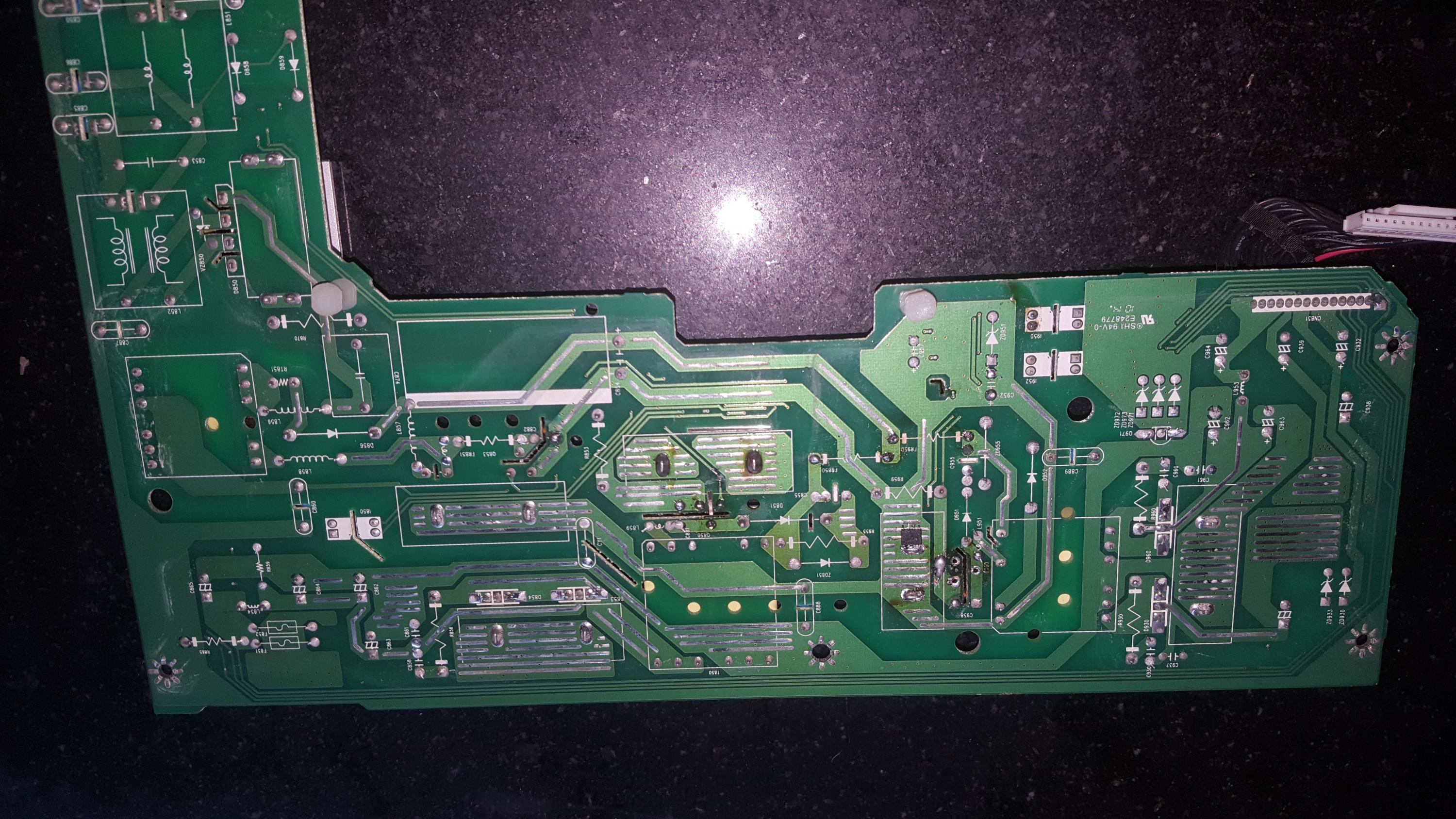

                                        #99
                                        0.2 Ohms fusible resistor.
                                        When you try to measure very very low resistance, you will have to subtract the meter probes wire resistance from the the reading unless your meter have the probes resistance null function.
                                        • luissm
                                          • Aug 2016
                                          • 8
                                          • Portugal
                                          #100
                                          That's the problem with this power supply.
                                          The resistance you refer to is 0.2 Ohm as referenced by budm.
                                          But you will not need to replace only this component, there will be several including the MOSFET 15N60C3 HAF024 Transistor. And be careful that it has to be insulated base otherwise short circuit and burn again the fuse (CQ MET T4A 250V ) and the bridge rectifier.
                                          List of components I've replaced
                                          Fusible Resistor
                                          - 0.22 W 1W 5%
                                          - CQ MET T4A 250V
                                          Resistor SMD
                                          - SMD 10KOhm 1/16W Pakage 0603
                                          Diodes
                                          - ISL9R860PF2 8 A, 600 V, STEALTHTM
                                          - IN5406
                                          Transistors
                                          - MOSFET 15N60C3 HAF024
                                          I leave a scheme I made when I've repair mine.
                                          If you need more help, let me know.
                                          You can see more images in this post
                                          Good luck.
