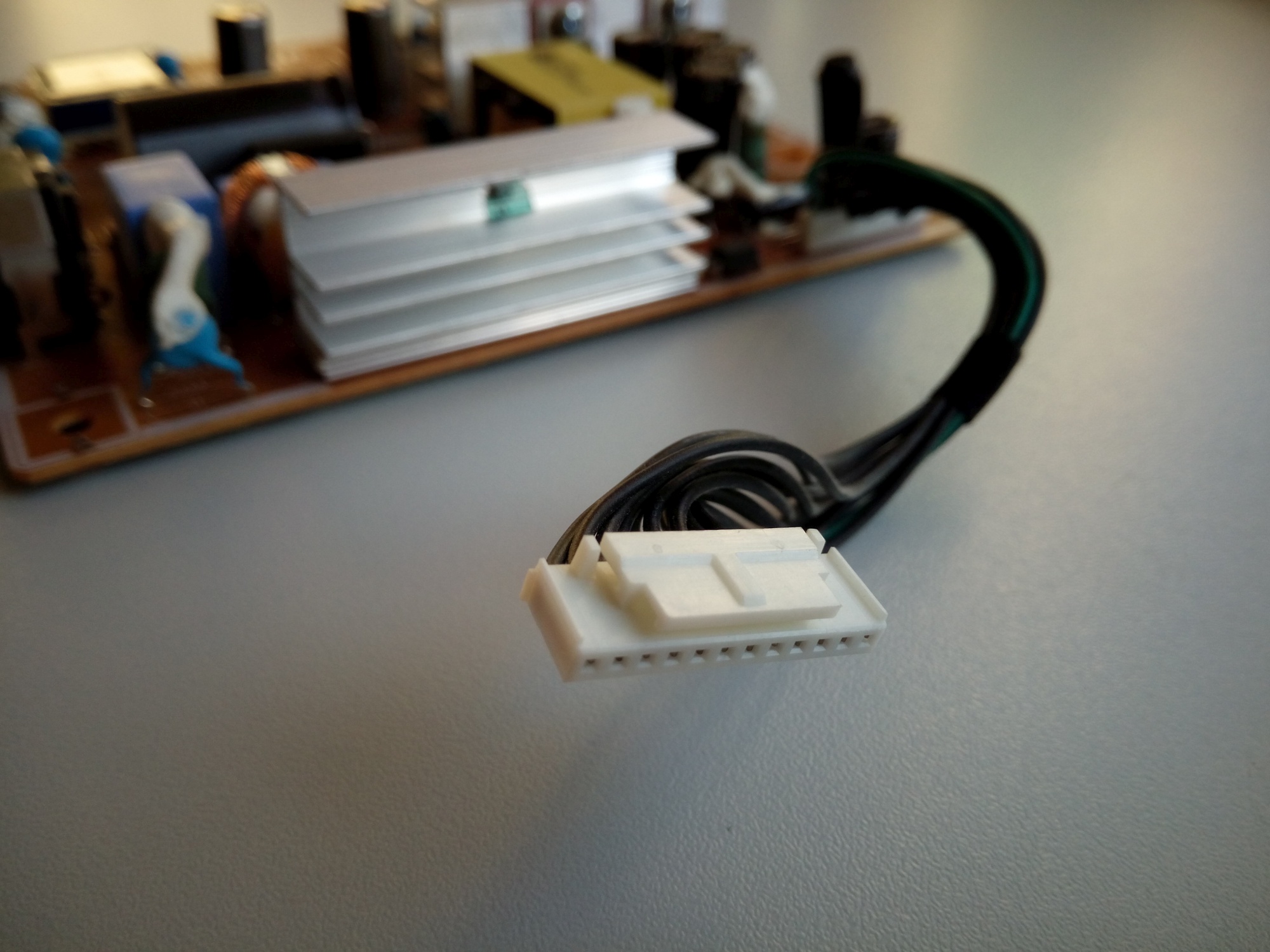

        Is the BL_ON (ON/OFF) signal still present when the backlights go out?
        12-PIN connector
        1- b-dim
        2- 13v
        3- gnd
        4- gnd
        5- 5.1v
        6- 5.1v
        7- a-dim
        8- on/off
        9- 3.3v
        10- led
        11- key 1
        12- key 2

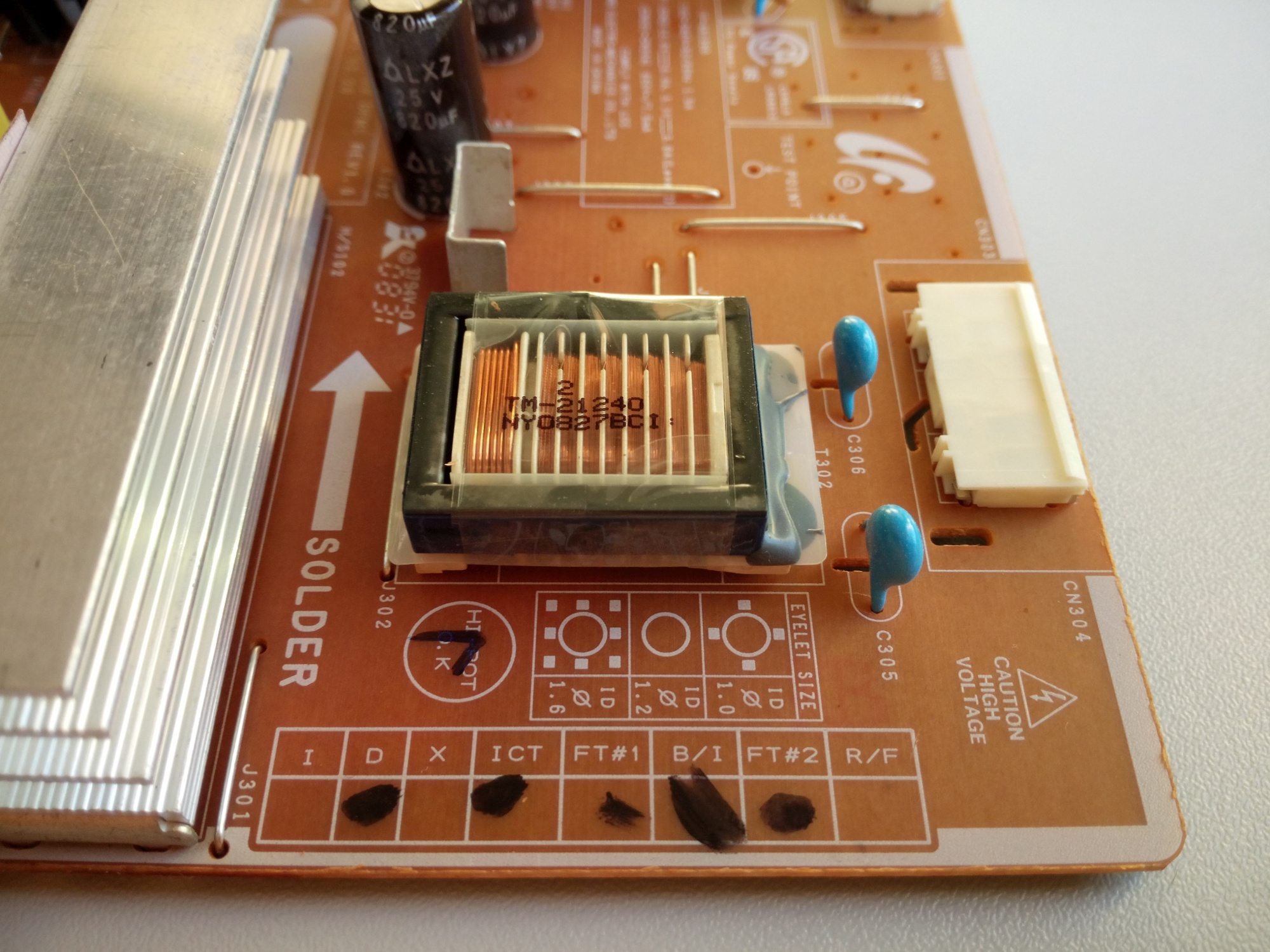

                    I have faulty 2233BW monitor and would like to repair the PSU board rather then buy the new one. Capacitors looks good but I changed them with low ESR models and problem is still here. After switching monitor on, CCFL works for about few seconds, then turns off. I can see the picture with flashlight and I hear some squeaking from board. I did some readings while monitor was turned on:
                    Resistance on inverter secondary trafo: around 1100 Ohm
                    Voltage on inverter primary trafo: 0 V
                    Resistance between MOSFET pins: I could't measure it with my meter, scale was on 2 MOhm and it showed up just number 1
                    Voltage between F301 fuse and ground: around 14.6 V
                    I have only basic experience with servicing electronics. Can you help me? What's wrong with PSU board? Thank you.

                              #74
                              Re: Samsung 2253bw black screen
                              That looks like your problem- they should be within 3% - what is the number on the
                              transformer/s
                              • domy_os
                                • Jan 2015
                                • 6
                                • Croatia

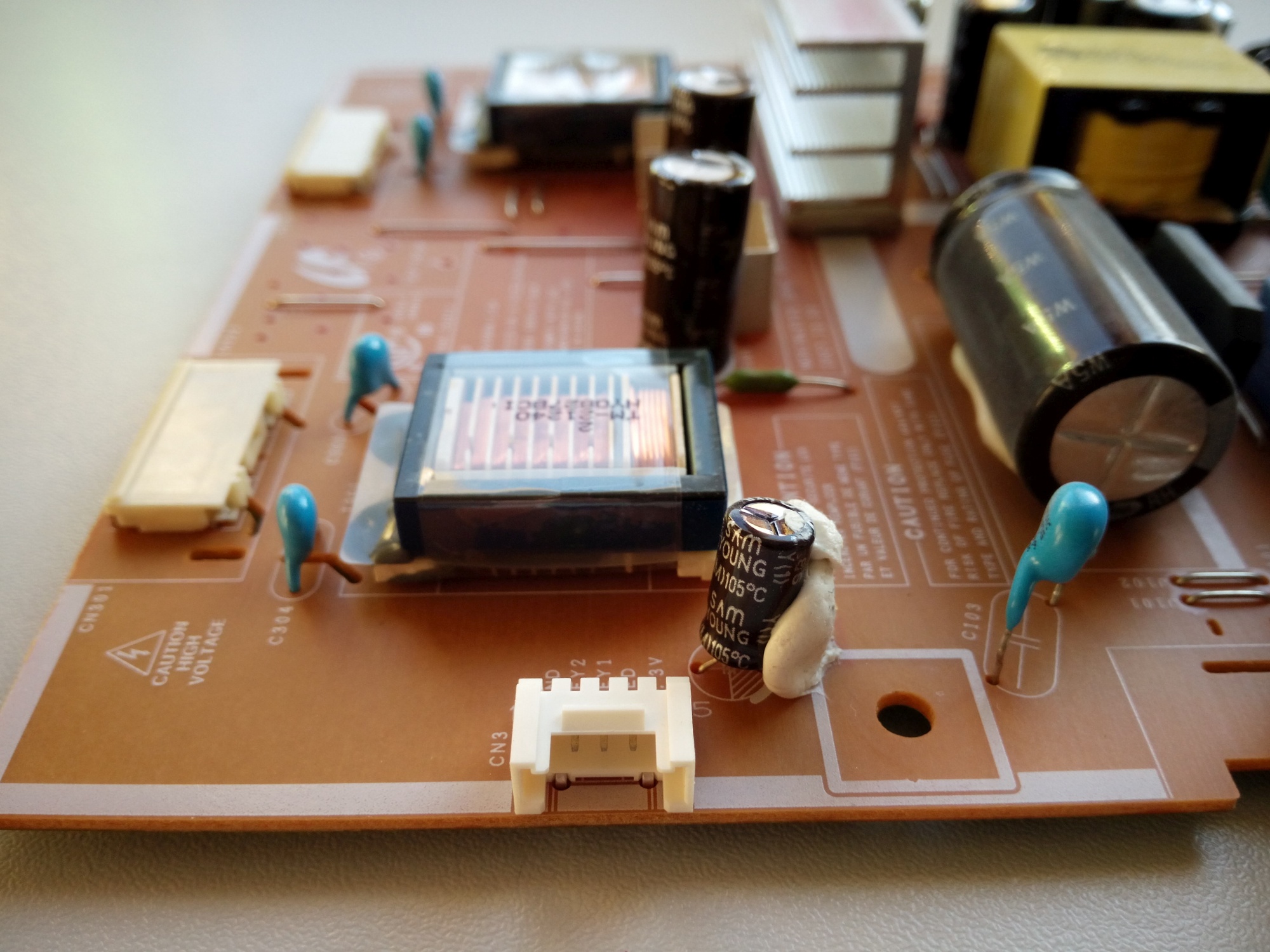

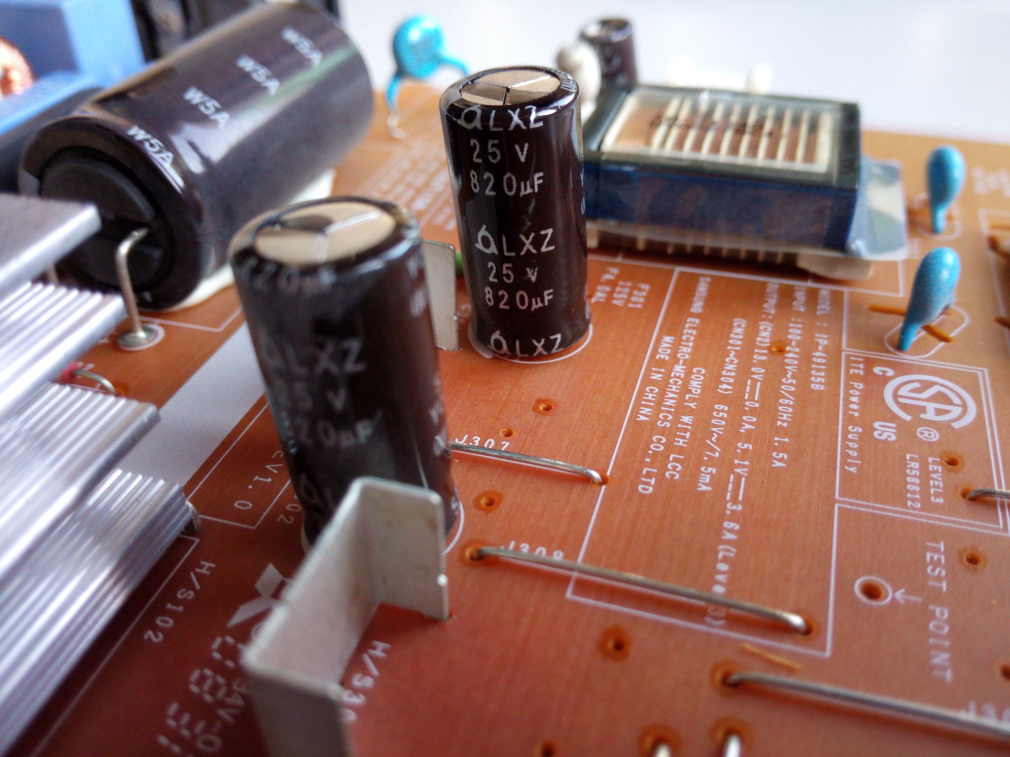

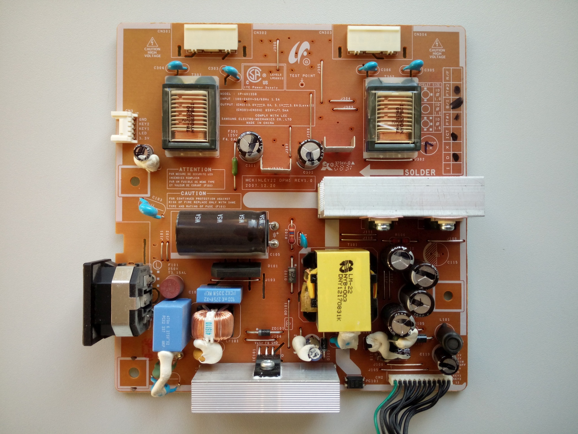

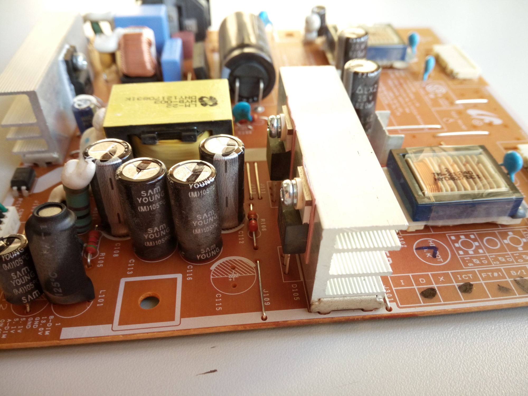

                                #75
                                TM-21240. I made a few pictures with old caps...
                                EDIT: Deleted Dropbox link and photos uploaded as attachment.
                                        Secondary resistence should be around 1380 ohm.
                                          My experience with Inverter transformers,is that the 3% supposed error limit is certainly not sacrsanct !! I have seen many with more than 5% which were not faulty,and others approaching the 10% also.However Samsung ones do seem to fail at the lower levels,for whatever reason,and in various of their Models it is a standard fault...is this one of the Monitors that has the latter ??
