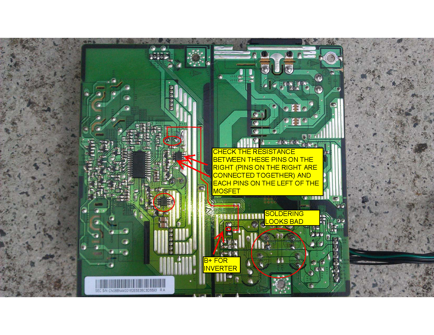

                                  14V is low for 22" monitor. Please see attached picture for some testing you need to see, the soldering works on the caps look pretty bad also. I expect the lamps to flash ON for seconds at least with 14V.

                                    Q202 and Q203 i thought were the two 8 pin chips on the bottom, they drive the Inverter transformers..or am i having a Blonde moment ??

                                      right just checked them and i am getting on U202 with pins on right shorted
                                      from the top
                                      244.6 ohms
                                      439.8k
                                      0.1 ohms
                                      5.4 ohms
                                      on q203 i get the same only on pin 4 i am reading 161.5ohms
                                      I will go and resolder the caps now.
                                        i think you are on about U202 and U203 they are 8 pin chips.

                                          The 8-pin chips on the bottom side are Dual MOSFET's
                                          "244.6 ohms
                                          439.8k
                                          0.1 ohms
                                          5.4 ohms"
                                          Are these the resistance reading that I asked to check by leave one probe on any one of the pins on the right side of the chip (pins on the right are connected together) as shown in my redlined picture, then another probe on each pin top read the resistance? If that's the case, then you have bad chip (shorted).
                                          Can you read the numbers on them?
